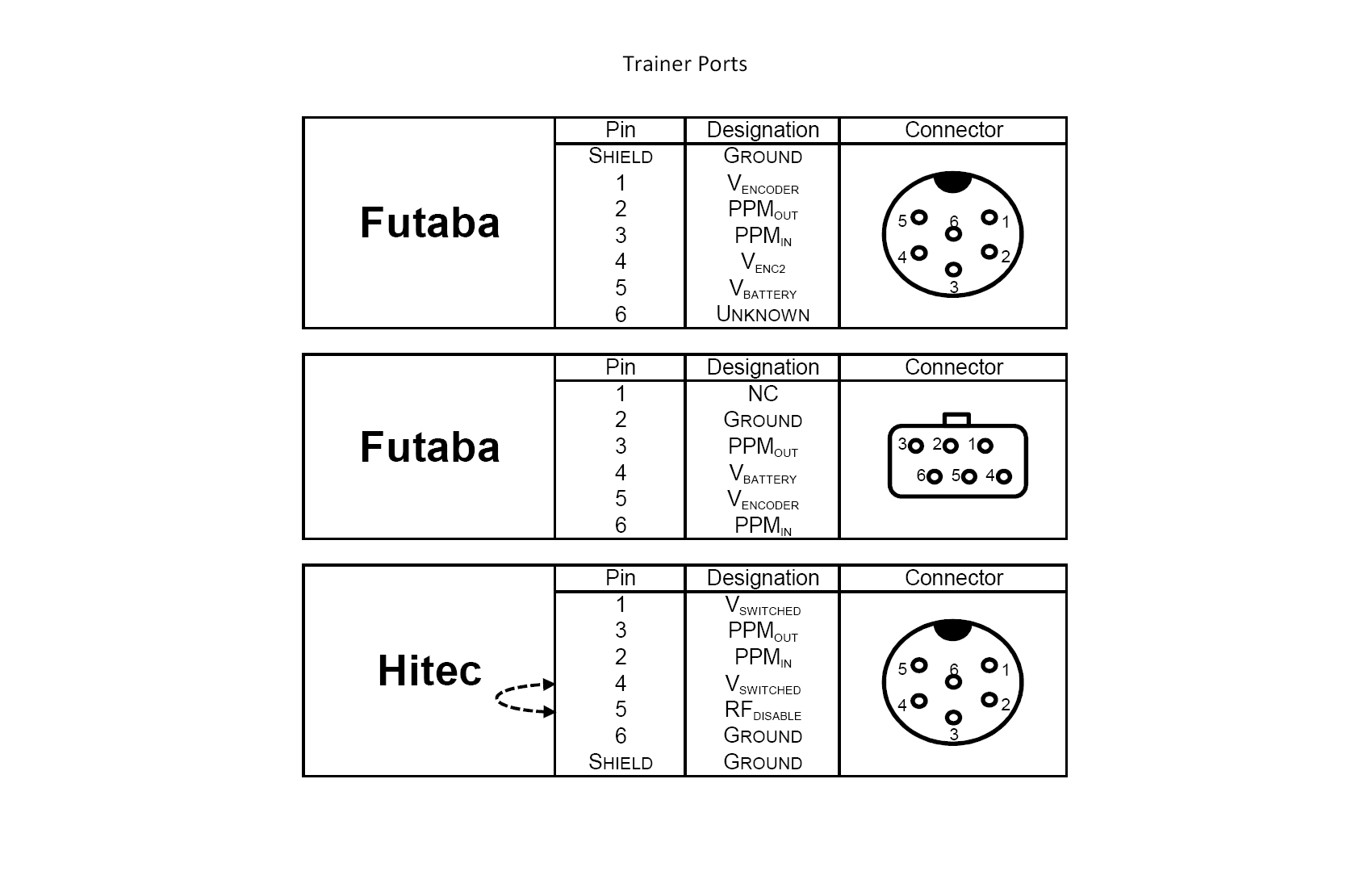

The easiest way on most Futaba sets is to pick up the ppm on the buddy box connector. The buddy box ppm signal has proper high and low logic levels so will work with just about all modules including the FrSky hack and LemonRx. I think the 6EX has the more modern rectangular connector which are a little more tricky to connect to as they are smaller than the 1980s round DIN connector, but in the early days of 2.4GHz, I converted a few sets for clubmates.

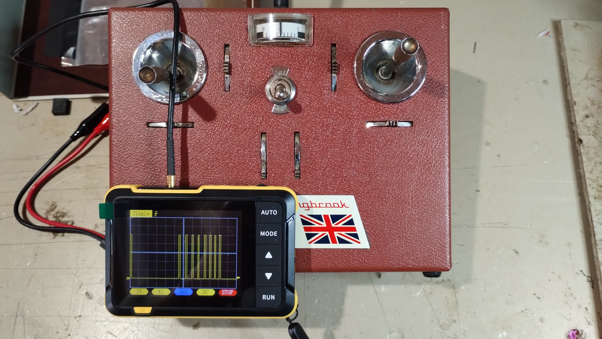

A cheap & cheerful pocket-scope like the one pictured below.
These can be bought for as little as £15, you dont need a posh high-bandwidth scope.
Of course I have a posh scope too but this pocket scope is only 200k B/W and displays PPM perfectly, for £20.
Either the scope or PPM meter will show the PPM stream generated by your encoder and can of course be used to find a PPM source.
