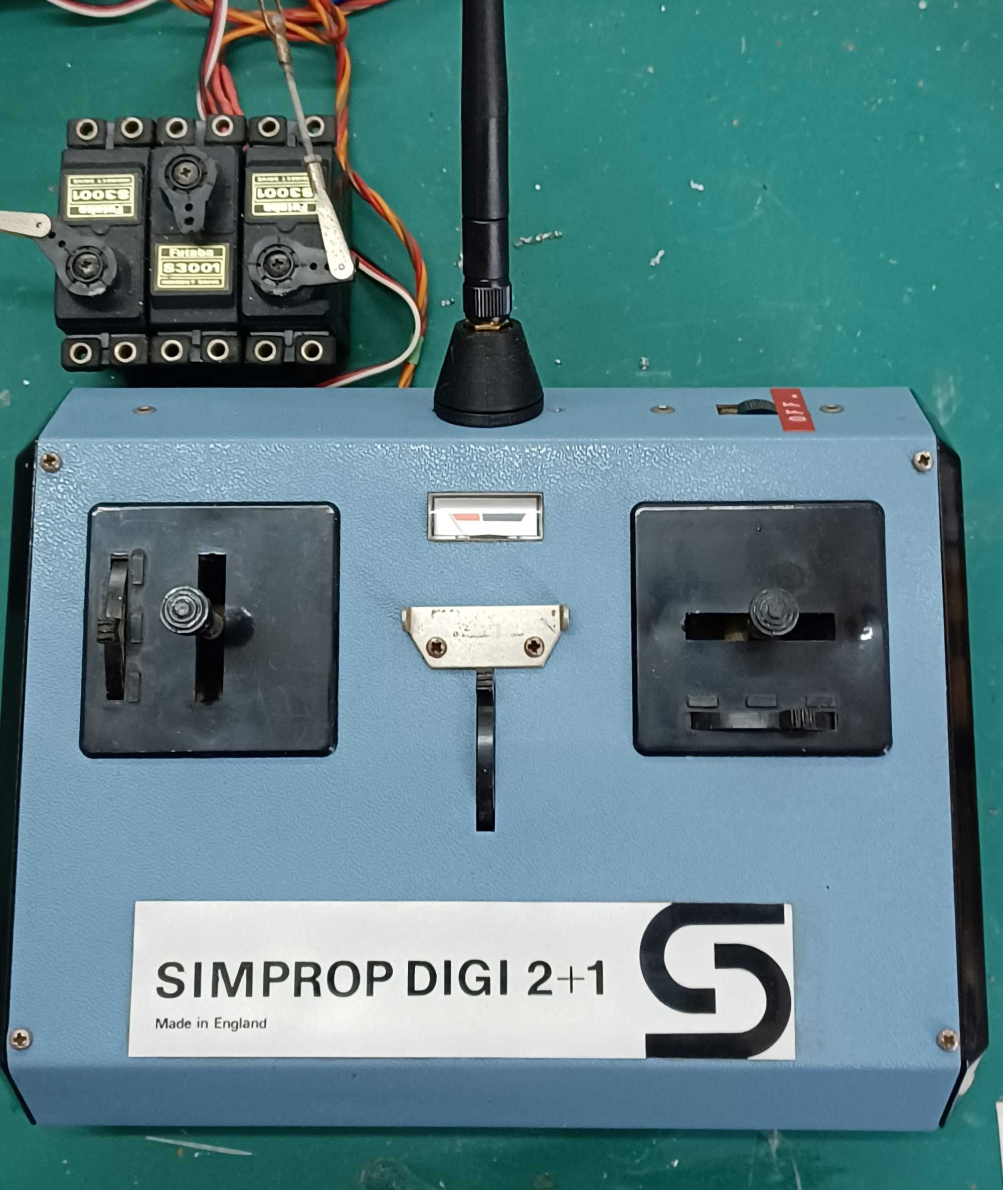

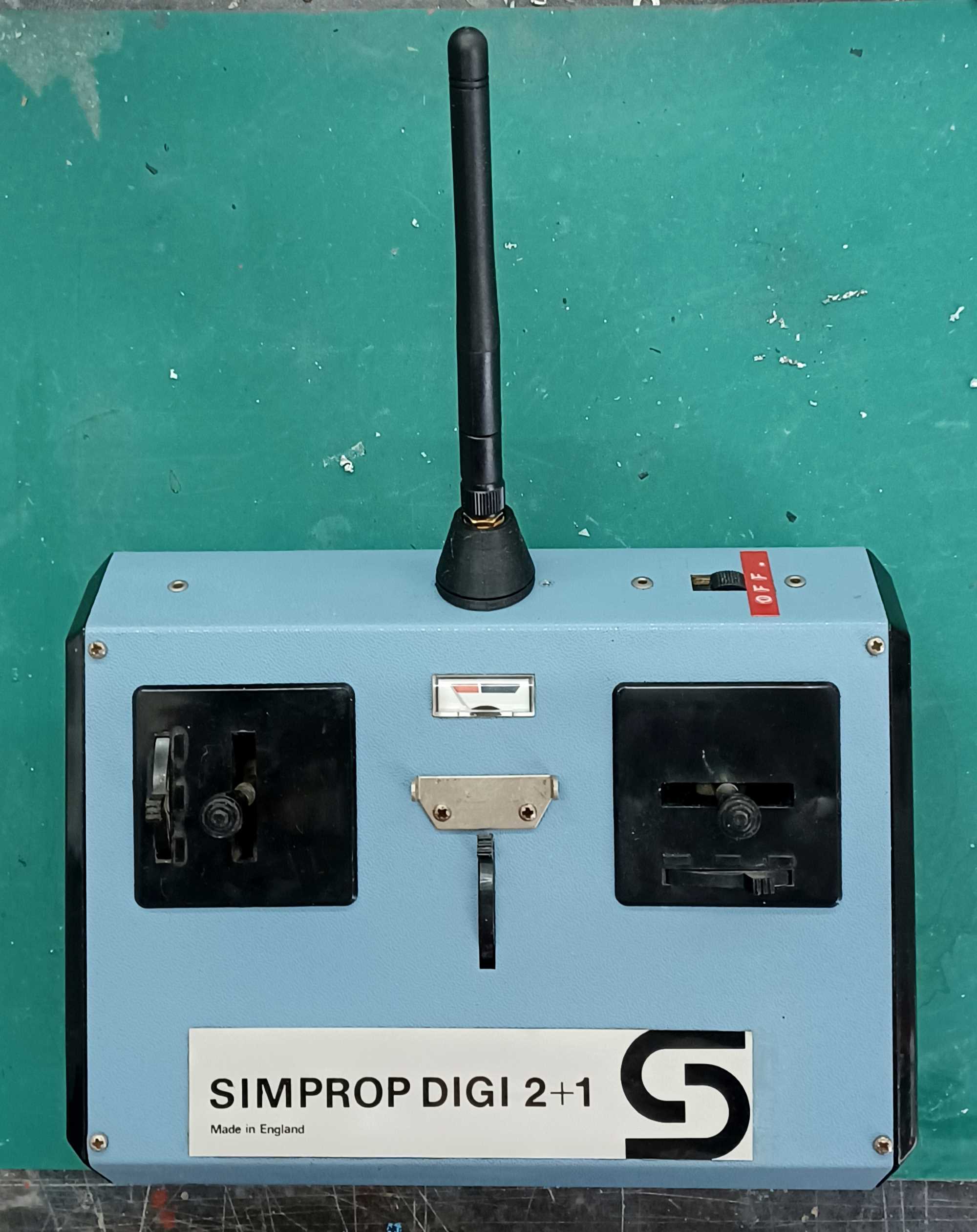

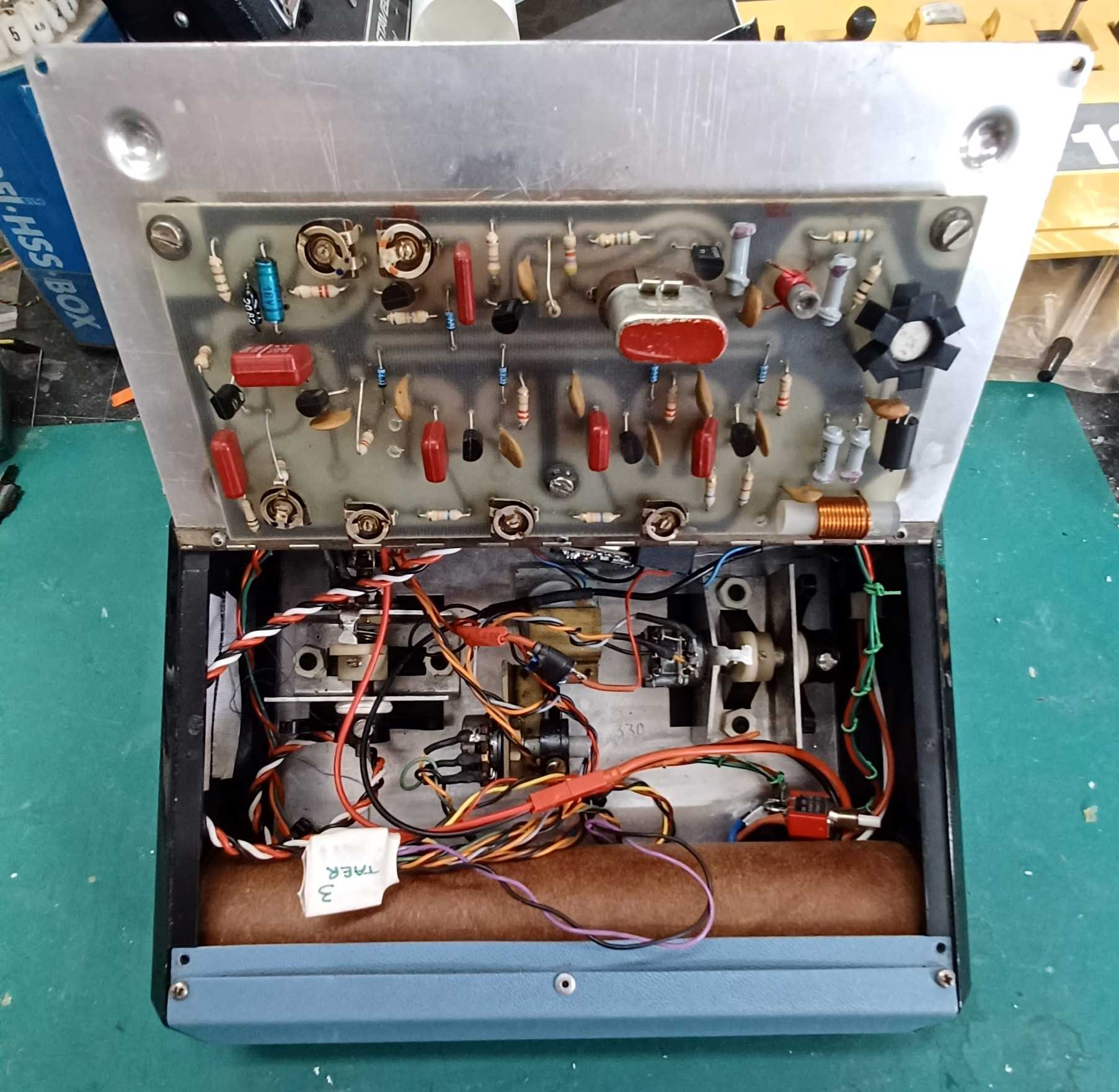

Some of you will remember this conversion that was started a few years back from a transmitter supplied by Mike Kitchen and then stalled because of a faulty potentiometer on the elevator control. Thanks to Pete Christy who rescued my call for a spare pot and sent me two stick units, the conversion was completed today and here it is for all to see.
Encoder is a 3 channel Digispark and RF module is the ubiquitous LemonRx from Swaffham Aircraft Works! https://www.ebay.co.uk/itm/133704108565
These are a very rare set these days and I was unable to find any spares in their homeland of Germany, so was so fortunate that Pete came to the rescue!

Glad to be of assistance! Mine was in pretty poor condition, so its good to see at least some of the parts came in useful!
Well done! It looks really good!
