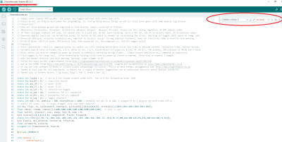

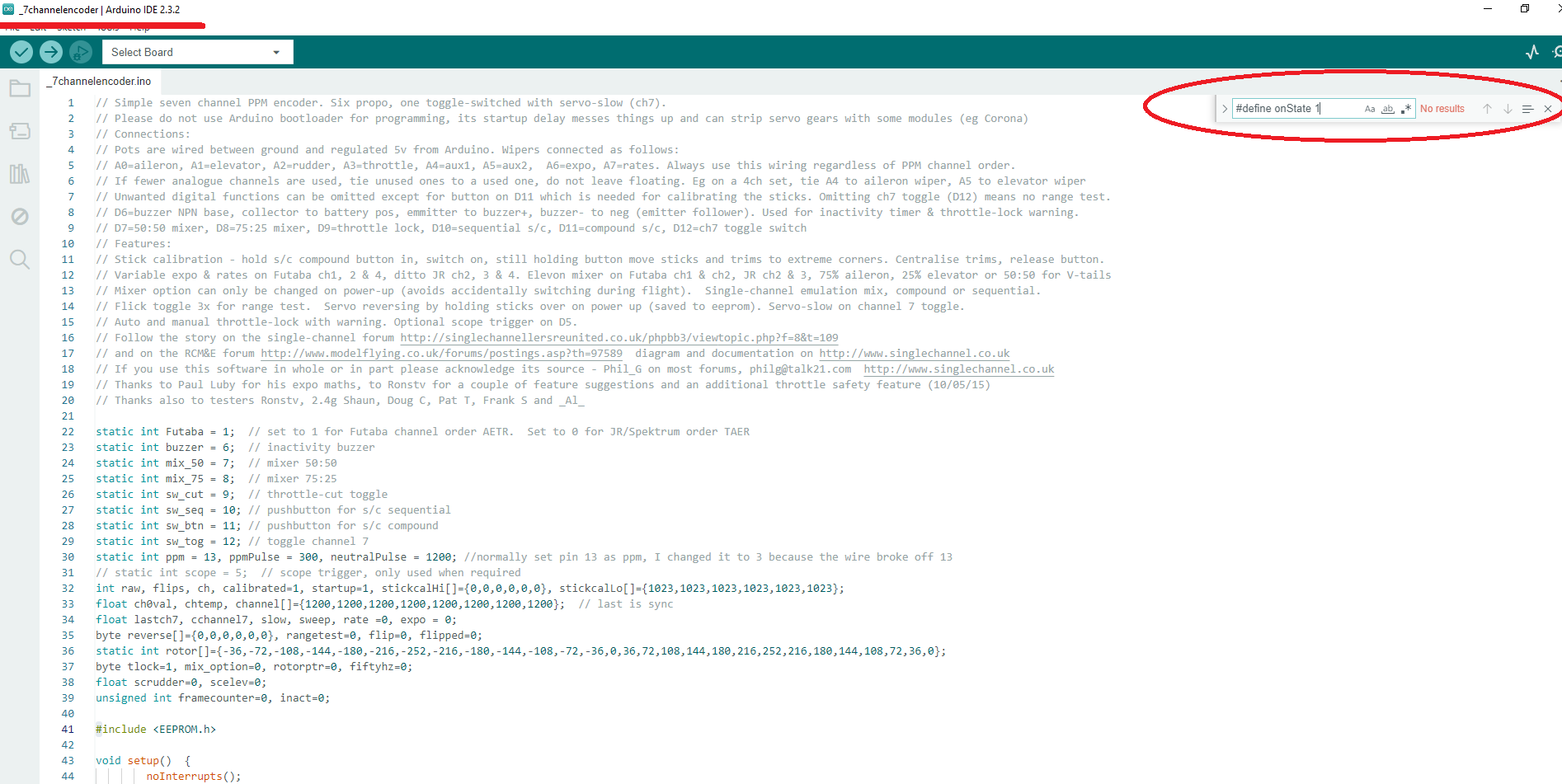

OK. I guess I must be using an older version and this is something you added later because that #define doesn't exist in the sketch I'm using ....or do you mean if I add that line to the existing unmodified sketch it will invert the ppm pulse train? This is the post from F2B that seemingly fixed the issue for me -Phil_G wrote: 05 May 2024, 00:23 On the 7ch + S/C mix encoder its one line:
Code: Select all
#define onState 1 //set polarity of the pulses: 1 is positive, 0 is negative
Then I changed this line:
//send ppm frame, last channel holds sync value
for (int ch=0; ch<7; ch++) {digitalWrite(ppm, HIGH); delayMicroseconds(ppmPulse); digitalWrite(ppm, LOW); delayMicroseconds(channel[ch]);}
into:
for (int ch=0; ch<7; ch++) {digitalWrite(ppm, LOW); delayMicroseconds(ppmPulse); digitalWrite(ppm, HIGH); delayMicroseconds(channel[ch]);}
and all sprang to life....
