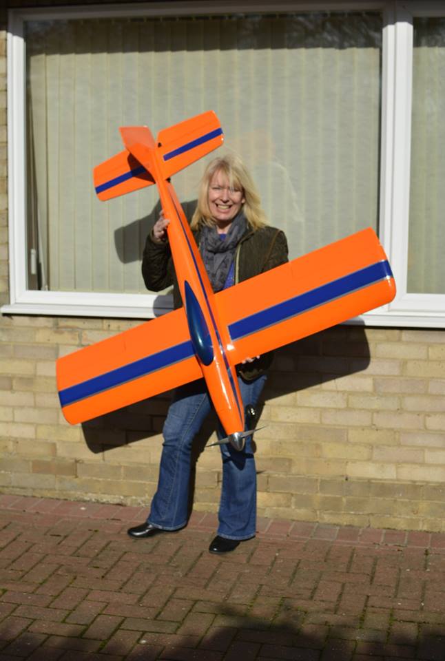

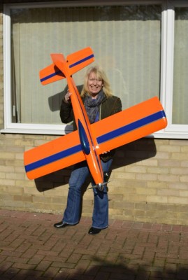

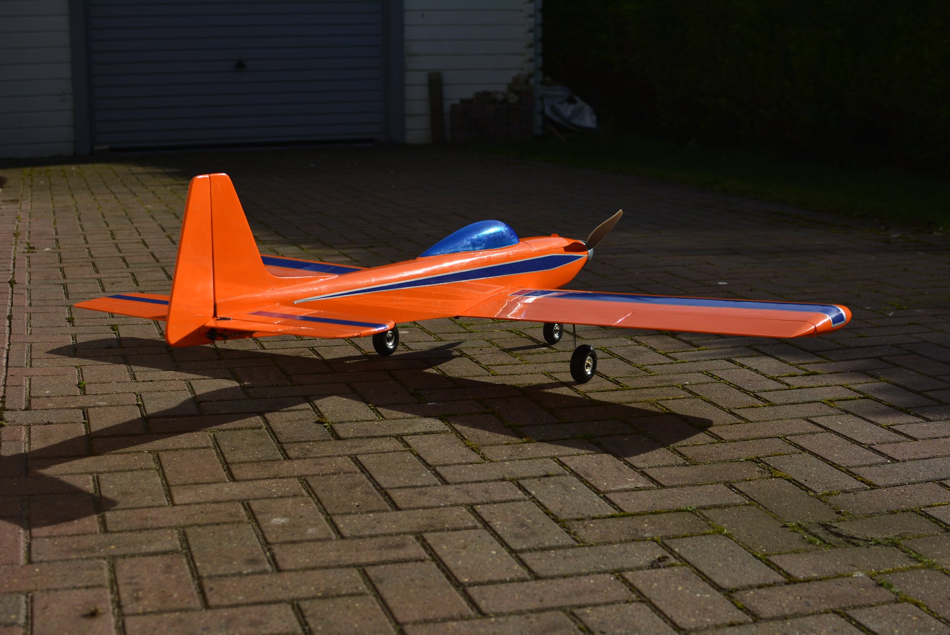

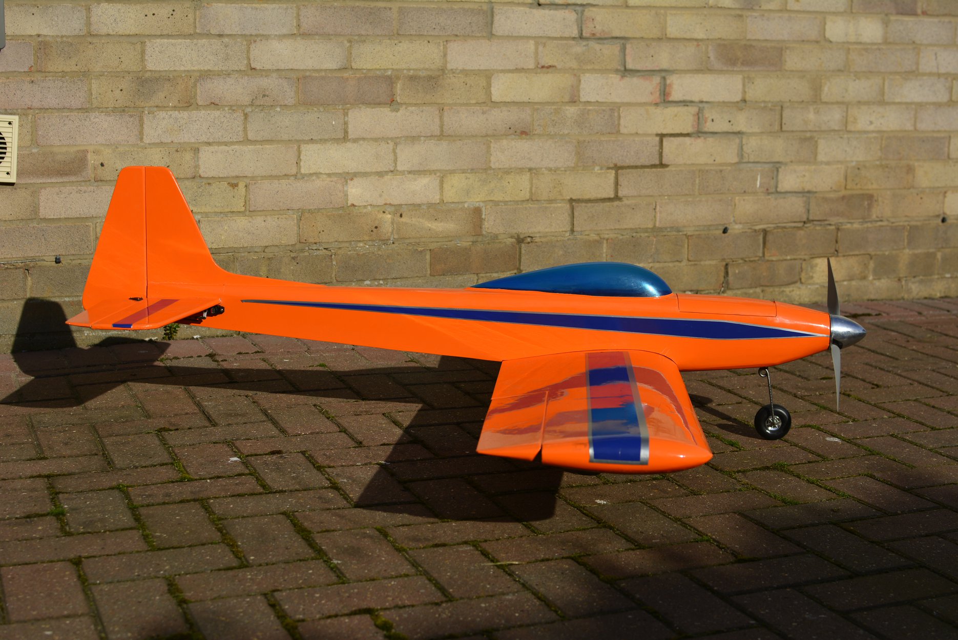

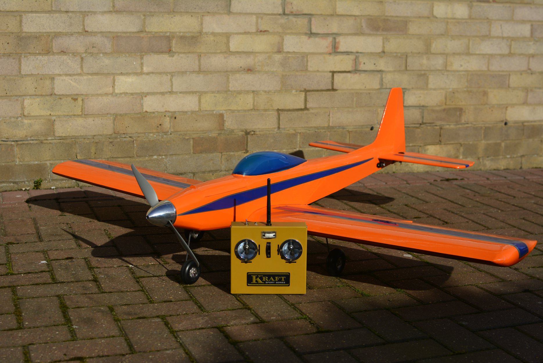

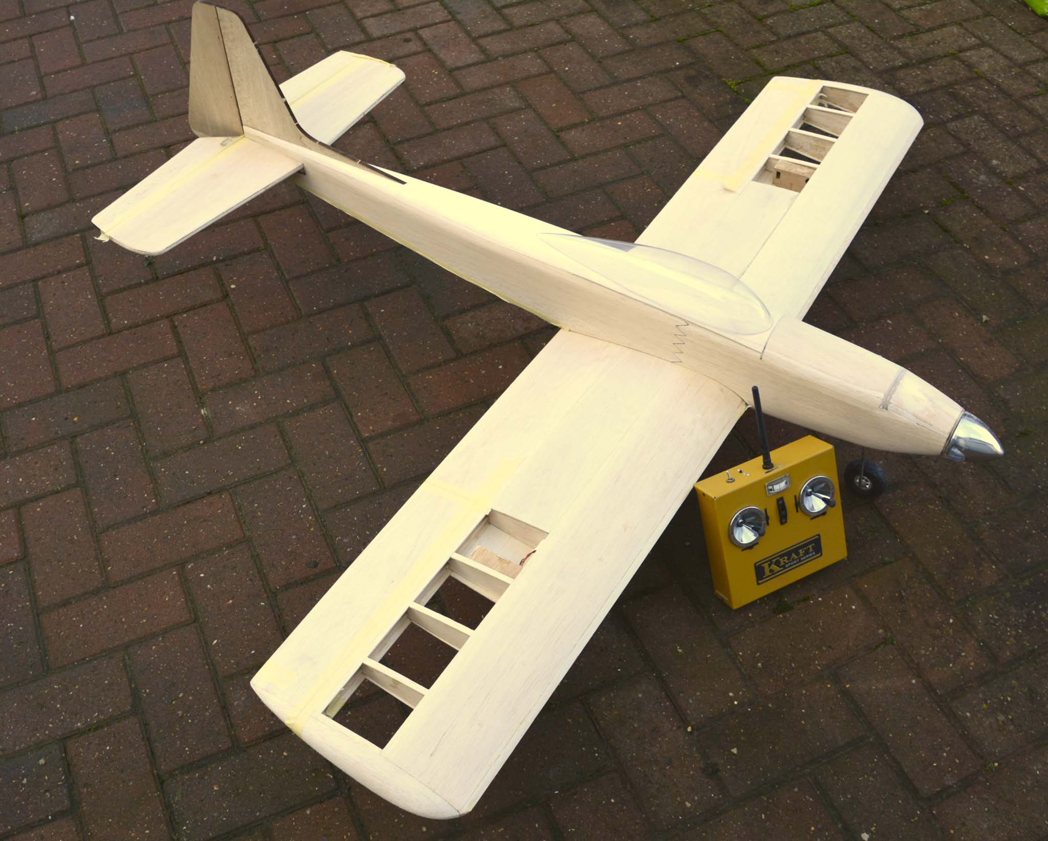

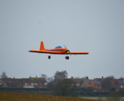

Here are some pics to my homage to Mr Kraft's finest.
Kwik Fli 3 built from original Feb 1968 MAN plans from Outerzone.
Now 5 -6S electric with my original Kraft Tx converted to FrSky 2.4.
Ailerons and elevator servos on Y leads, weight 5 1/2 lbs.
Am 3D printing an Enya 60 to bolt on the nose.

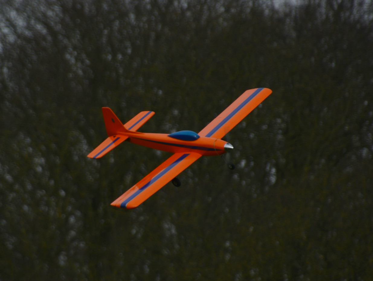

Re: 50 years ago Phil Kraft published this

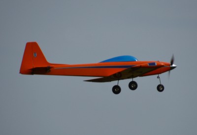

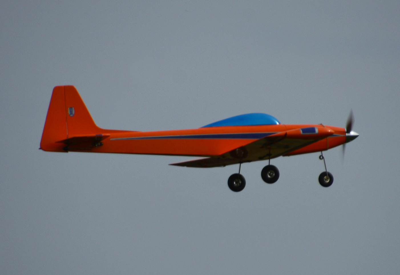

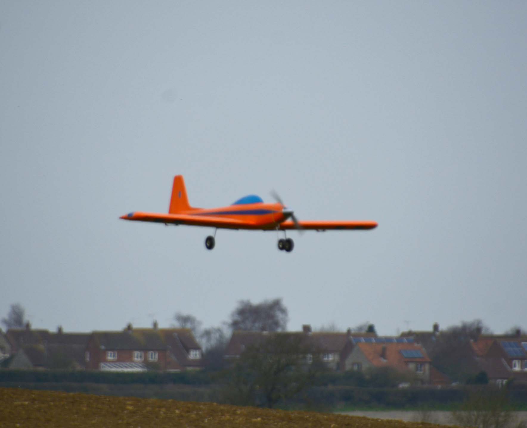

The KF3 had air under under its wings for the first time this afternoon at the local field, flew perfectly on 6S, and was only drawing 28 A on the 11 x 7 APC E prop, have got a 12 x 10 to try and that draws 50 A on 6S.
Otherwise, nothing dramatic to report, roll rate and controls all well harmonised, couple of turns on one aileron clevis and flies just like I remember in the 70's, but just quiet! Will start moving C.G back from plan position on next flights over Easter as I have a small amount of down trim on the Kraft Tx.
Happy Bunny here :P

stuart mackay wrote: 26 Mar 2018, 18:16 flew perfectly on 6S, and was only drawing 28 A on the 11 x 7 APC E prop, have got a 12 x 10 to try and that draws 50 A on 6S.
Looks really nice Stuart, what motor did you fit, be interesting to run it through ecalc ?
BTW, a 3D printed Enya will just melt with all that methanol about :mrgreen:

this is the one in the KF3
https://www.der-schweighofer.net/Electr ... 0KV-a90289

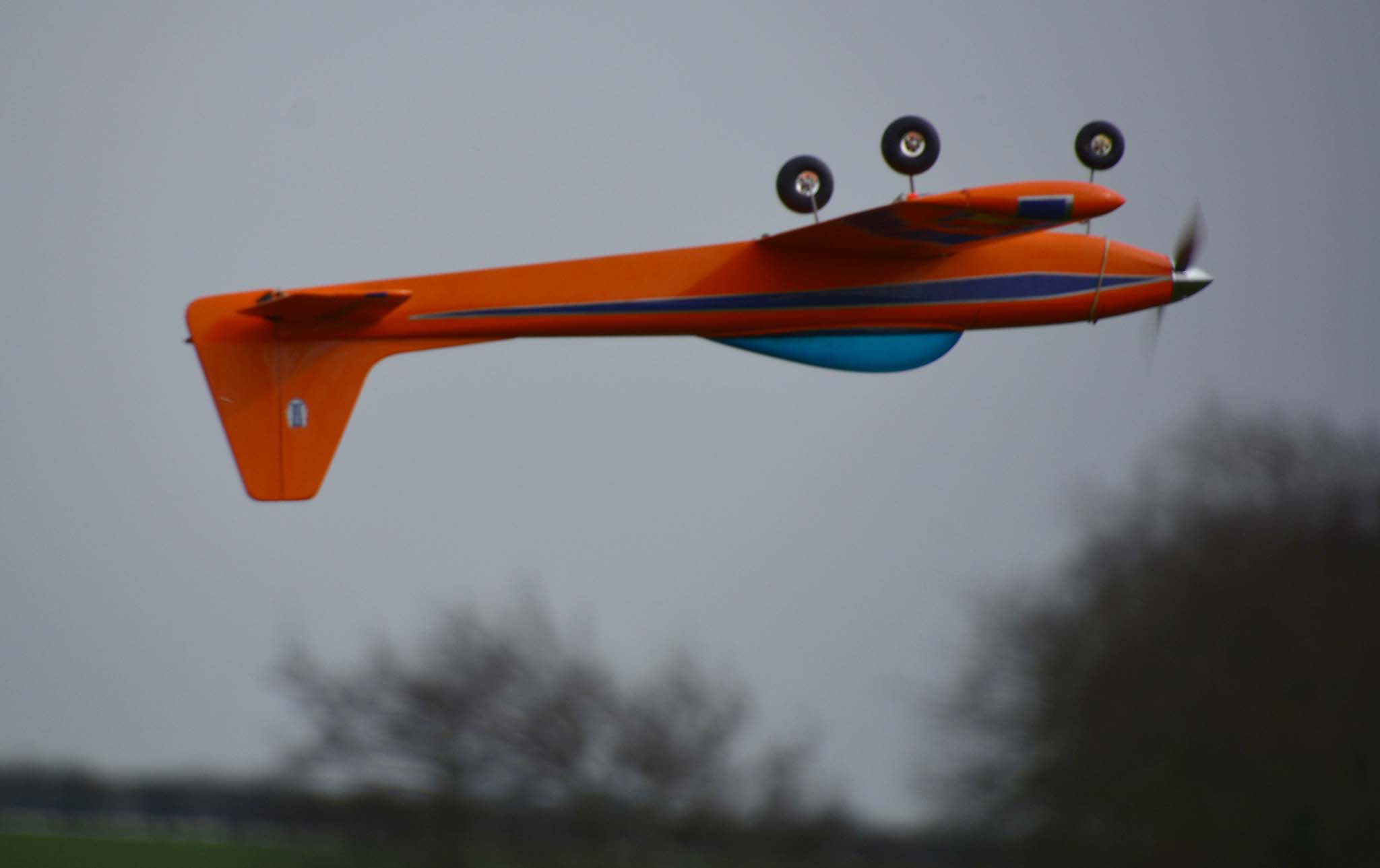

Got some air under her wings at weekend
