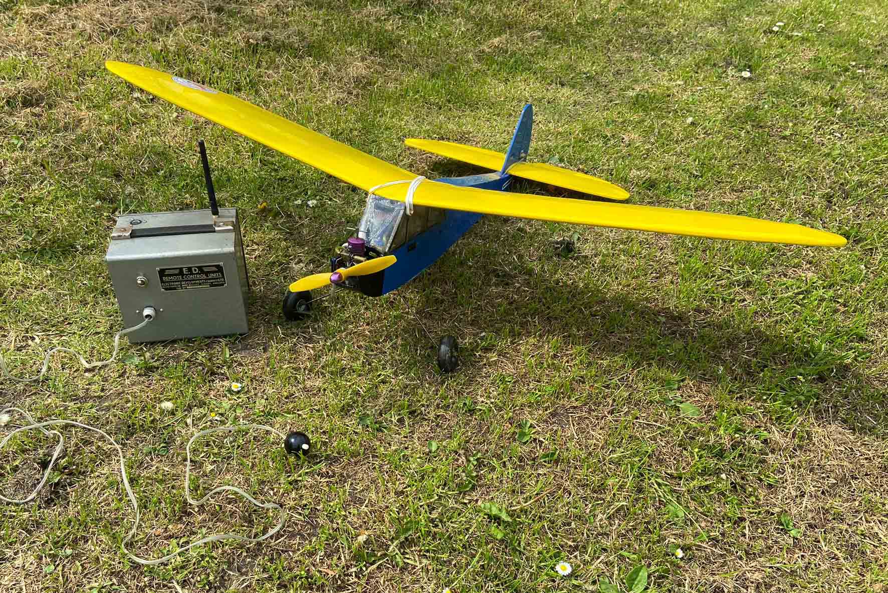

Lemon DIY module customer converted early ED single channel using Phil's single channel encoder, model has now flown successfully and builder very happy with the conversion!

ED converted using a PhilG encoder and lemon DIY module

Very nice but his rudder is reversed !
To reverse the rudder servo, switch on whilst briefly holding the button down. Observe the current settings of the 8 switches, particularly note the colour of the fifth flash. Wait for the ‘di di dit’ and the repetition of the 8 flashes. This time, count the pips and immediately after the fifth pip & flash, press & release the button. The cycle will start again from switch one – again observe the settings of the 8 switches, and note that the colour of the fifth flash has changed. Wait for the “di-di-dit” sound as the new config is saved.
Switch off, switch on again and note that the rudder servo is reversed and you should have one for right, two for left.
All in the manual
All in the manual

Thanks Phil, have told him!
