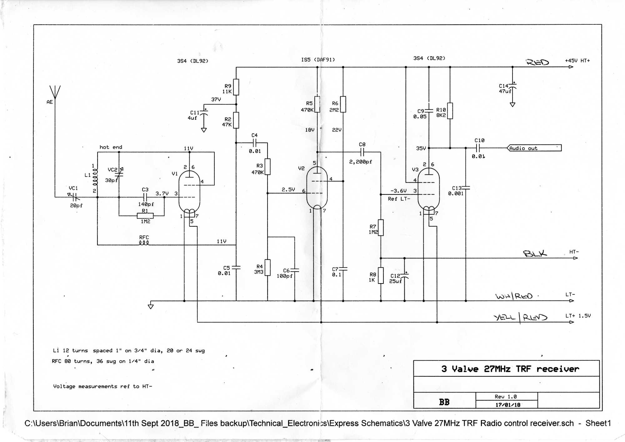

I have a few questions:
1 - Are the inverted triangles that end some lines Earth/Ground markers? If so, I assume that the earth is LT- ?
2 - Why is HT- not also connected directly to Earth?
3 - Does 'Audio Out' on the right hand side feed tones out and is it positive with respect to LT-?
4 - If so, would it therefore be possible to connect one end of a reed bank coil to the Audio Out and the other end direcly to LT-?
5 - If so, what resistance should that coil be?
I can feel a coil winding exercise coming on....
DG
- Posts: 479
Re: Help making a reed receiver?
1) Yes!
2) HT- is connected to ground via a 1K resistor and 25uF decoupling capacitor. This is probably to ensure the grid (pin 3) of the output valve is properly biased with respect to ground. (Should be a small negative voltage.)
3) Yes, but there is a blocking capacitor in series. Capacitors pass AC and block DC. There should be no DC component after the capacitor.
4) Yes. But always check with a voltmeter first! (you don't want to short the HT to ground because of a leaky capacitor!)
5) (Holding a wet finger in the air!) I would have thought that a few K should be OK, but you may need to experiment. The DL92 is regarded as a low output device, hence the need for a high impedance load. However, it was designed for portable radio use, so their definition of "low-output" may not tie in with ours!

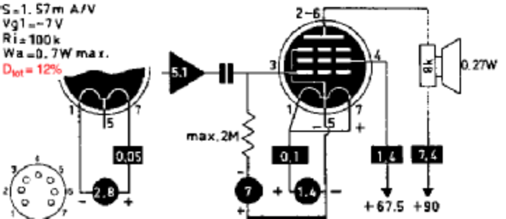

Here is a sample circuit for a DL92, showing a speaker impedance of 8K for a quarter watt output, but it is DC coupled, so the speaker actually forms the anode load. Not a good idea, I would have thought, but cheap!
TRF receivers are notorious for marginal stability, and I'm guessing the strange connection between the HT- and ground is an attempt to improve this, as well as providing the necessary bias for the output device.
Best of luck!

- Posts: 90
- Joined: 17 Jun 2018, 09:54
Thanks for the comprehensive and infornative answer! Looking at a valve circuit must remind you of the old days...
One thing looks a little odd, though. You talk about a speaker with a 8k impedence? Most speakers I see come with 4 or 8 ohm resistance. I understand that impedence is dependent on frequency, but would an 8 ohm speaker really hit 8k impedence at audio frequencies? If not, where would you find an 8k impedence speaker? And the inductance calculators on the net seem to be very complex...

Yes, but an 8ohm speaker would usually be coupled to a valve output stage via a transformer. Remember, that circuit is for a portable radio, and only 1/4 watt output.Dodgy Geezer wrote: 23 Jun 2024, 16:54 One thing looks a little odd, though. You talk about a speaker with a 8k impedence? Most speakers I see come with 4 or 8 ohm resistance.
Having said that, I thought 8K sounded a bit high, but I do have some 2K headphones that I used for crystal sets back in the day...
