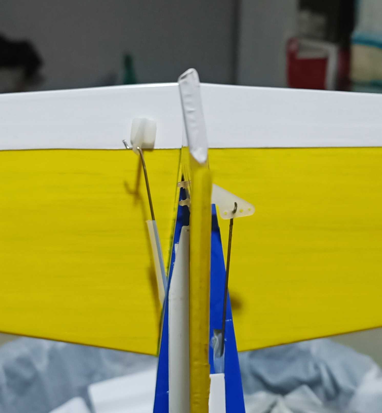

Even when applying full right trim (See attached photo), I could not tamed it. In the end it went down without much damaged. My question are as follows :-

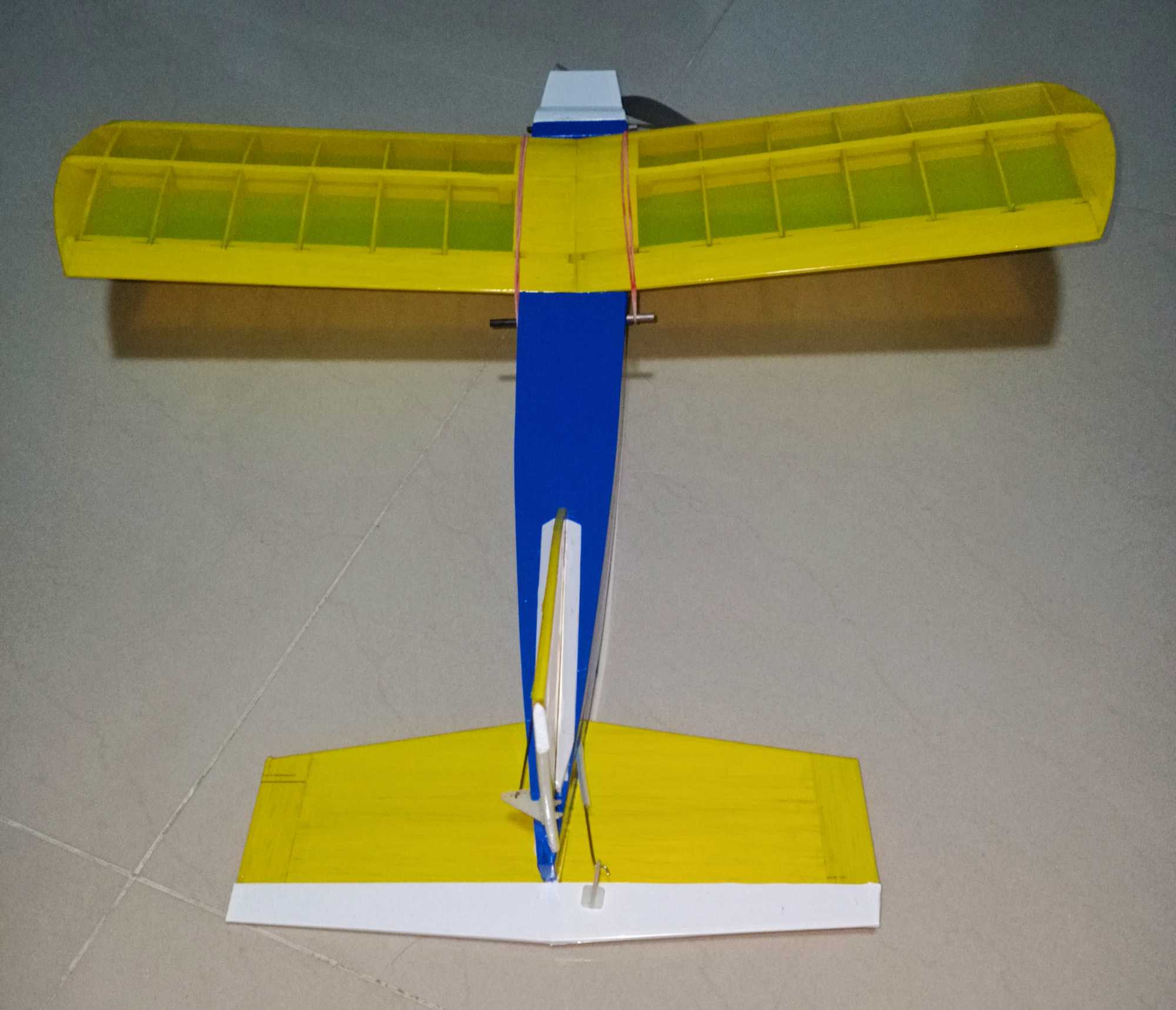

My Shark Face was built stock according to the plan.bluejets wrote: 31 Jul 2024, 04:10 Those wings look REAL short.
Did you run out of materials...???
Could be the angle of the photo but the one below looks more in proportion.![]()

Can only be a build error or the pilot then......
