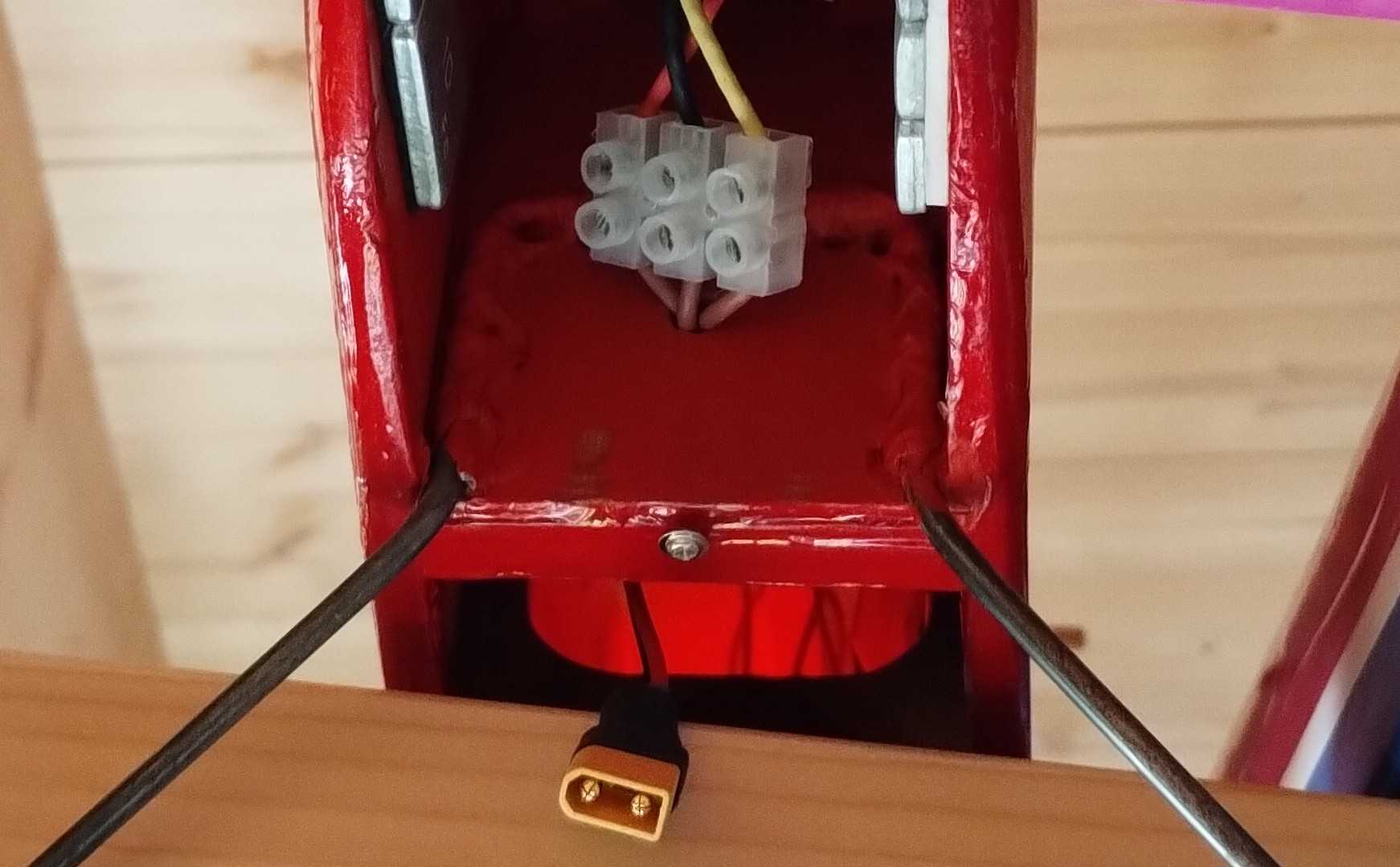

Heres mine, looking from under the prop (note the noseweight!)
Re: Sewing piano wire undercarriage to fuselage former
Phil_G wrote: 24 Sep 2024, 15:31 Heres mine, looking from under the prop (note the noseweight!)
Gotta love that connector Phil :lol:
