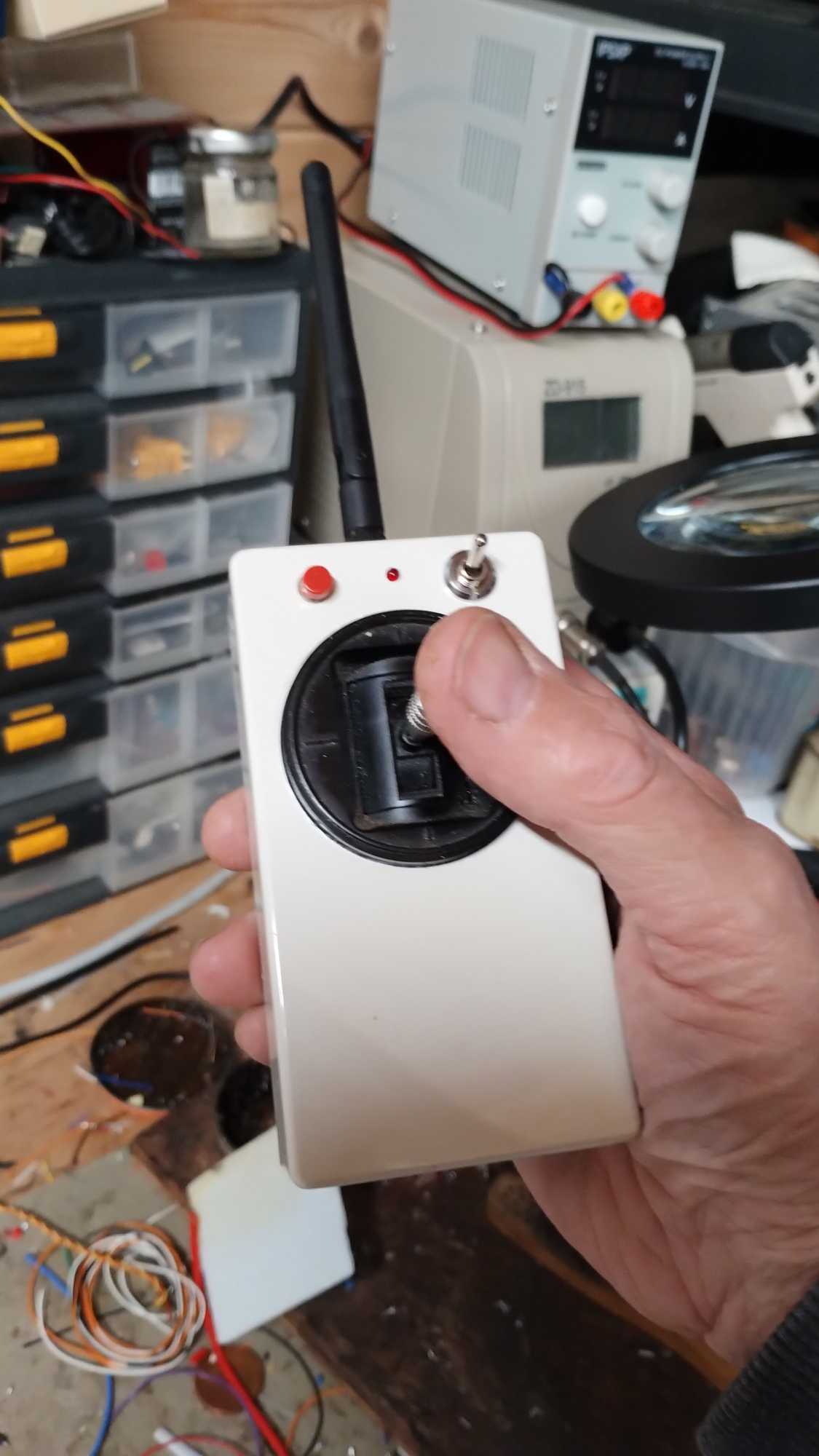

I've just finished a new 'pocket' transmitter, this one uses the same ABS case as a couple of previous 'handie-trannies'.
This is a lovely case, very solid and super quality but unfortunately number 3 is my last in this format as RS have upped the price to £18 !!!

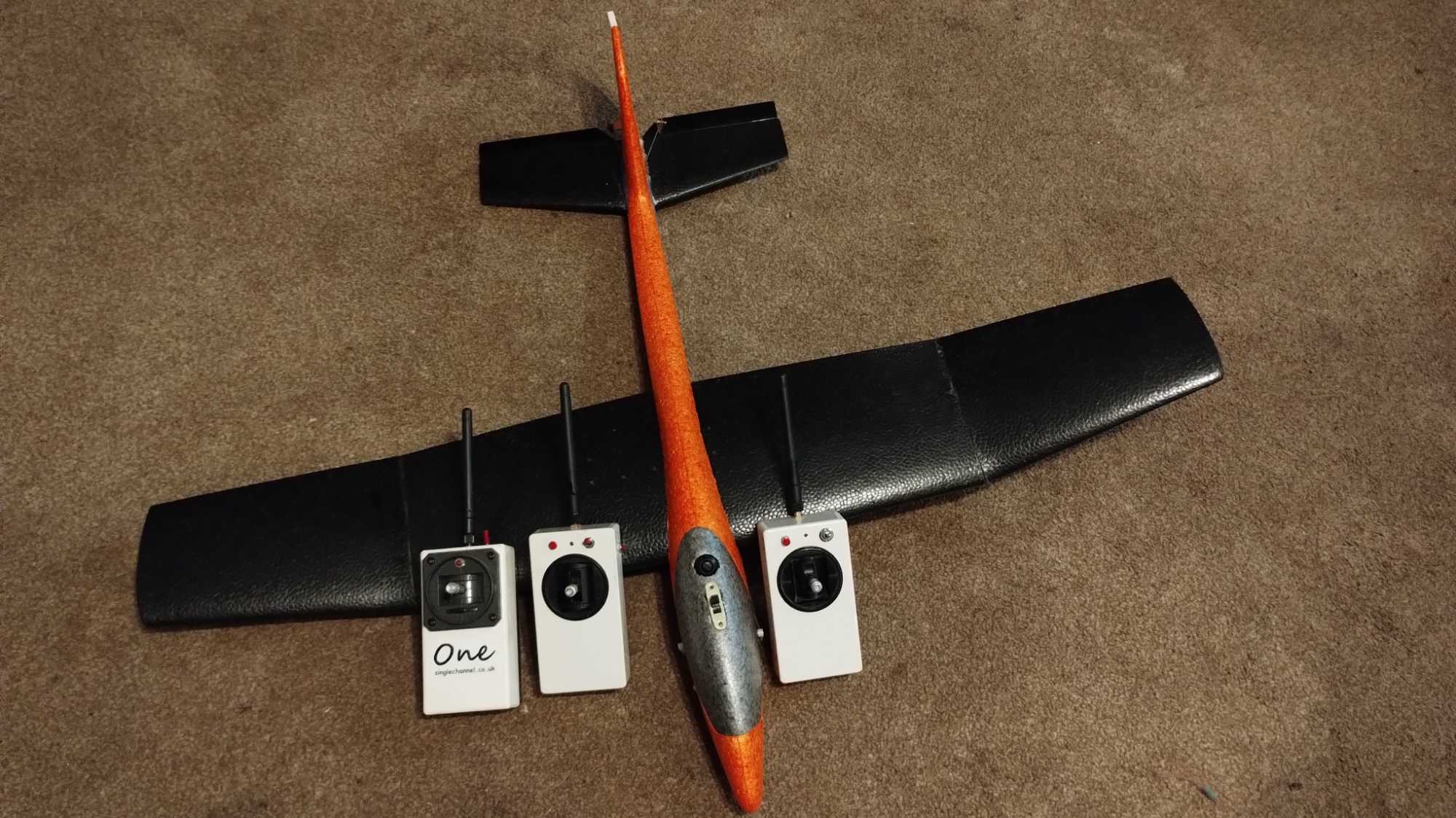

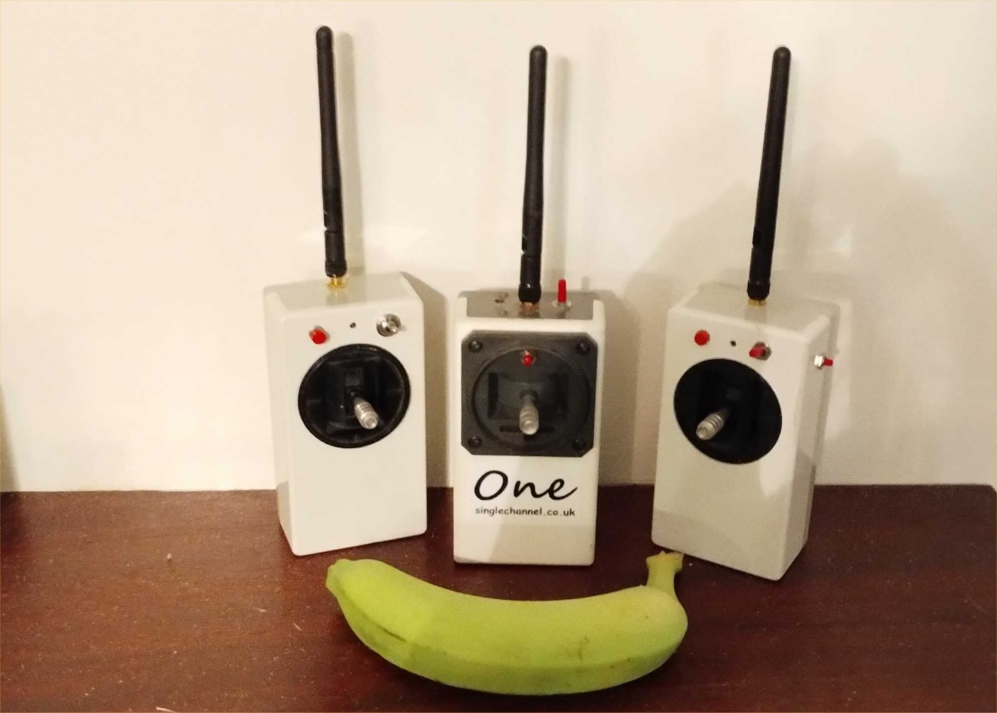

Heres the family photo, new one on the left, old PIC 1+1 in the middle and the 'van' Frsky 2+1 from 5 years ago.
New FHSS 2+1, oldest 1+1, old Frsky 2+1
(Banana for size reference :D )
...and with the rudder/elevator Lidl Glider (you cant have too many Impalas or Lidl gliders!):

The stick unit is Futaba so its a nice 'full size' stick, yet you can fly comfortably with one hand whilst the other is keeping warm in your pocket - and since its symmetrical, you can swap and fly left-handed whilst you warm your right!
The circular 50mm hole for the stick unit was cut with the stationery compass used backwards as before (thanks again for the tip Neil!)
The NRF and Promini are mounted inside the rear cover whic connects to the front panel pots, switch, button & led via a 7-way connector
so the halves can be easily parted. Theres not an awful lot of room in there!
Power is the usual EBL lithium PP3 and the aerial is on a 90° SMA extension from Amazon: https://www.amazon.co.uk/dp/B0CJRFT5W1
