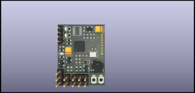

The PCB has arrived from JLCPCB, so for now, here’s the rendering.
As I mentioned before, the module has a bind function. The unique ID and 41 channels are set using the processor’s ID, making programming easy since no parameters need to be manually configured. The packet is also compressed and divided into two parts to stay within the legal 10% duty cycle. Shorter packets improve range by reducing interference risk, and the module listens before transmitting.
The module can be controlled via serial commands. The pipe generator algorithm includes a hash value option, enabling different settings by switching the hash. This creates a unique link between the Rx and the module, based on the model ID in the encoder, giving you true model matching.
Additional functions include setting failsafe and low power for range checks. The Rx is one of my standard receivers, as most functions are in the Tx module, making it fully compatible with my older system so no necessary hardware changes for the RX and Encoders just the add one of the RF module like any commercial one. The RF module also works with just the PPM input and no serial connection to the encoder, using just the two buttons on the board or an extension of them to control Bind-Fail-Safe and Range-Check .
Other features that are included are now a sounder, a low-voltage alarm and "ppm-handling", which add smart functions especially when paired with older encoders like Control Revers, Expo and dual rate.

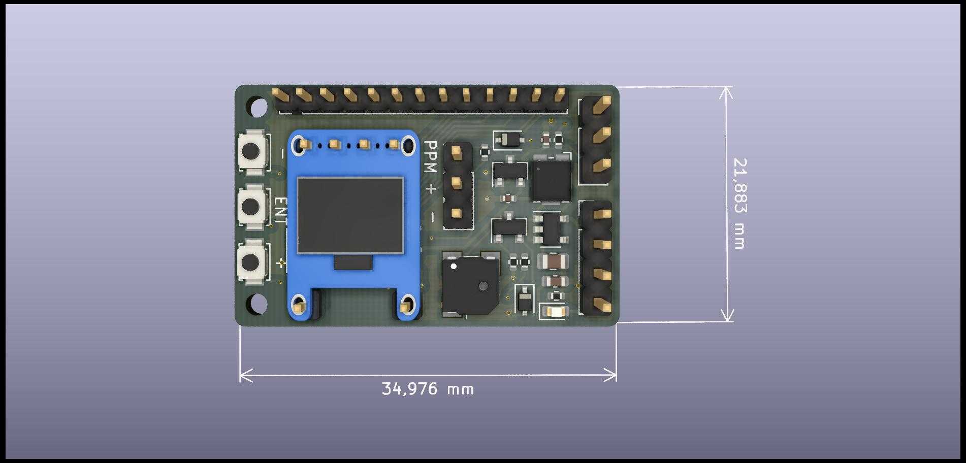

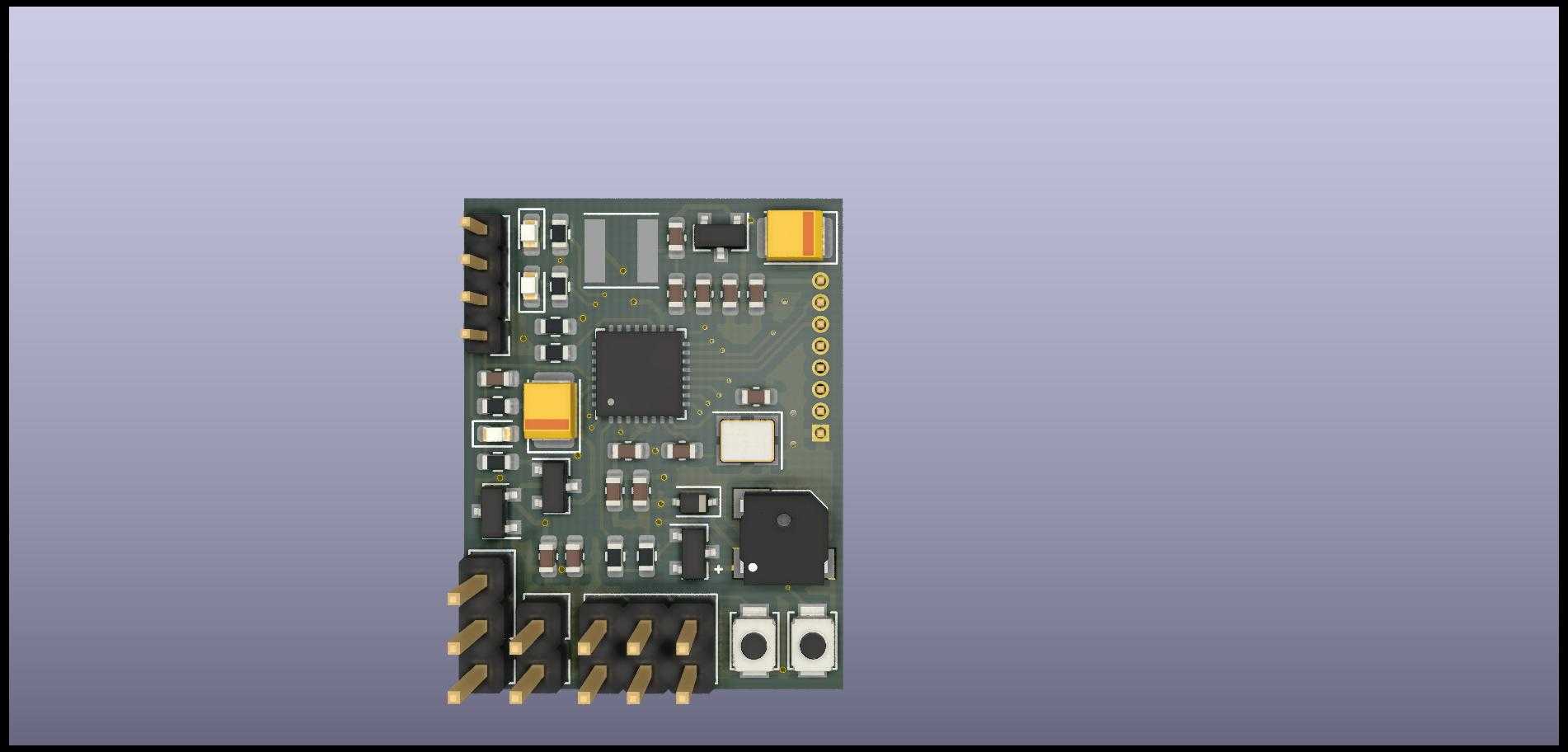

To all this there are a few new Encoders but all based on Mike's work so not anything really mine, here is my version of the....(my size is 22 x 35 mm
so slightly larger than Mike's in square mm.
