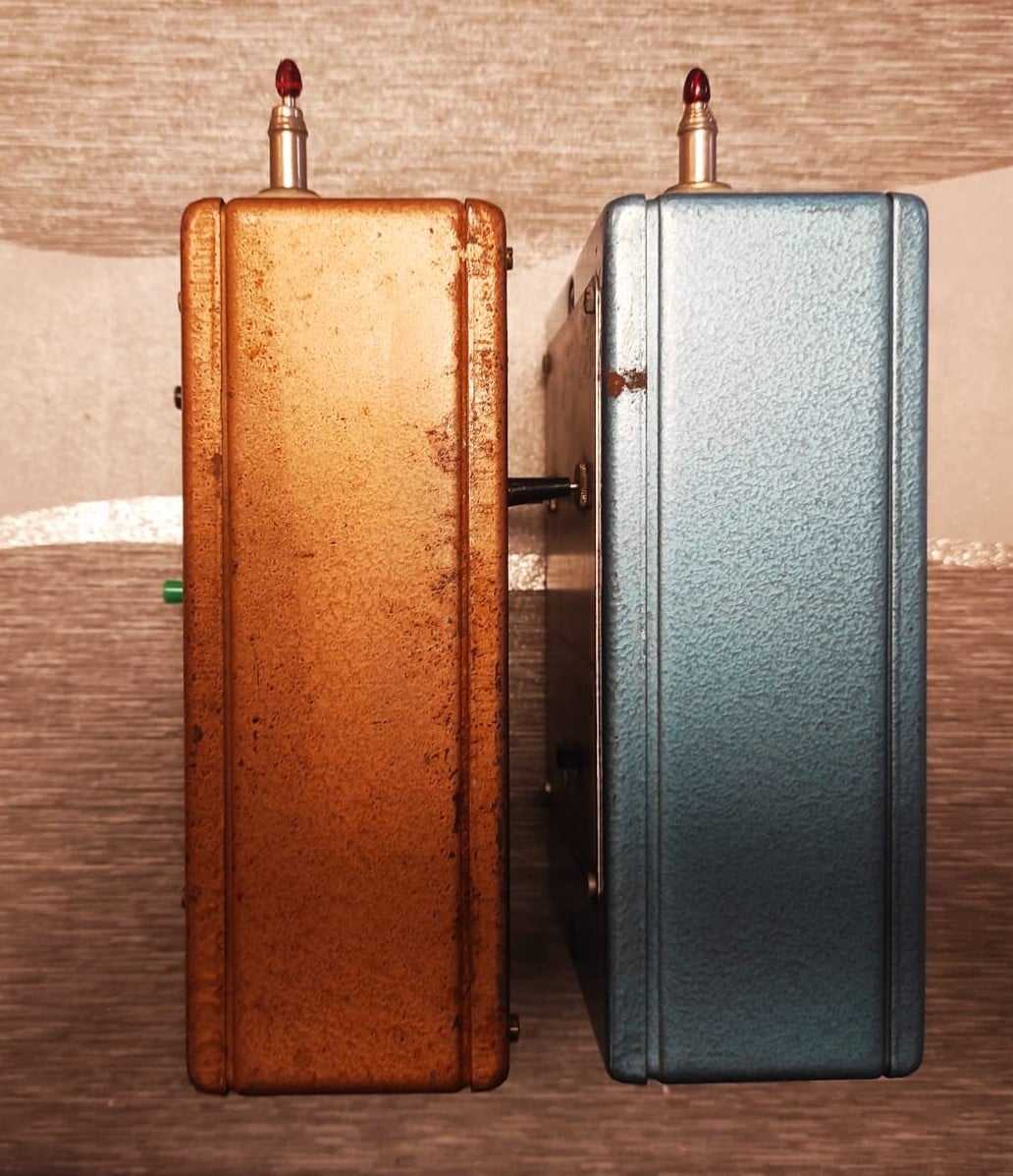

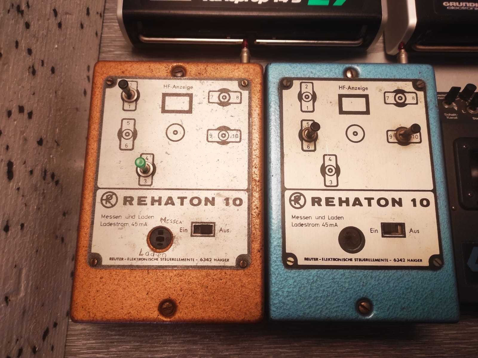

Any of our German friends shed some more light on the Rehaton?
Rehaton 10
- Posts: 596
Rehaton 10
Re: Rehaton 10

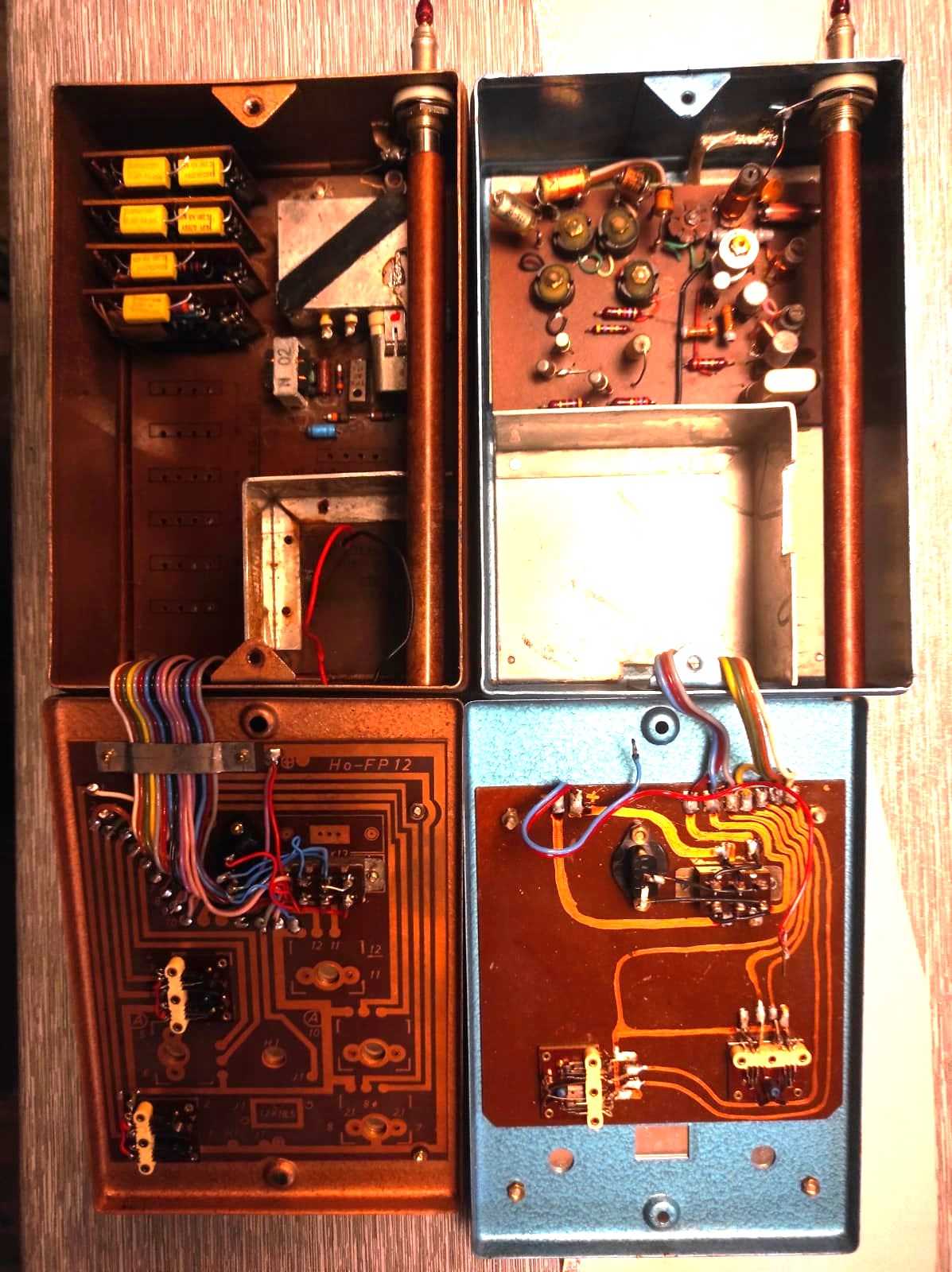

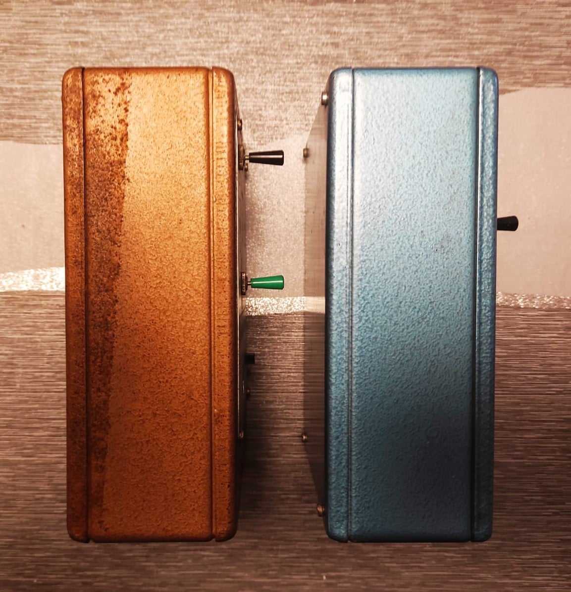

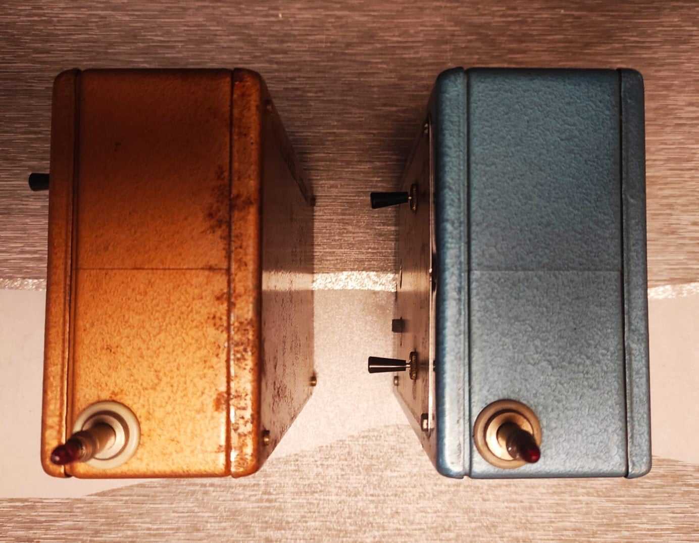

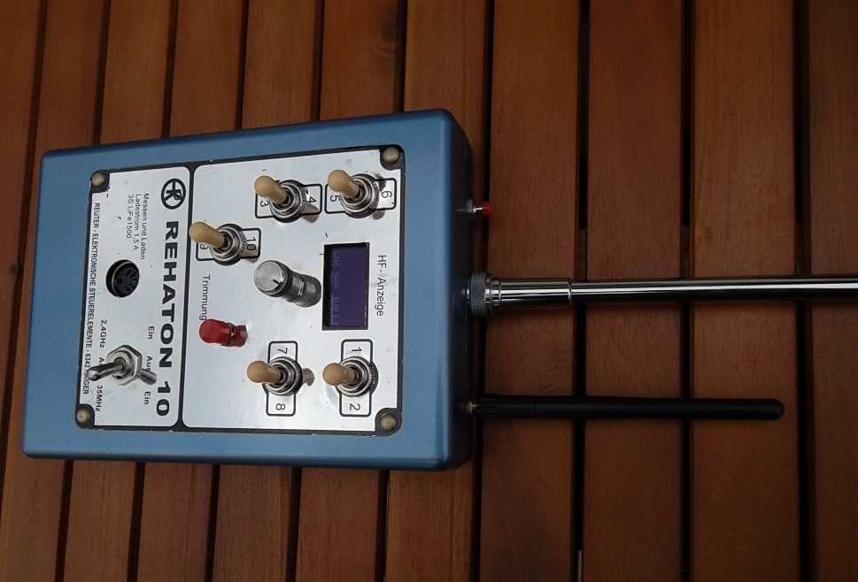

Frank built a Rehaton replica a while ago Stu...
The one on the left looks unusual, just two vertical toggles which conventionally would be throttle & elevator trim?
Does the 'throttle' toggle actually go left-right, maybe is was made for a left-handed flyer?
- Posts: 596
Re: Rehaton 10
Dunno Phil, I ll let you know when they arrive in Swaffham!Phil_G wrote: 04 Nov 2024, 21:12 Frank built a Rehaton replica a while ago Stu...

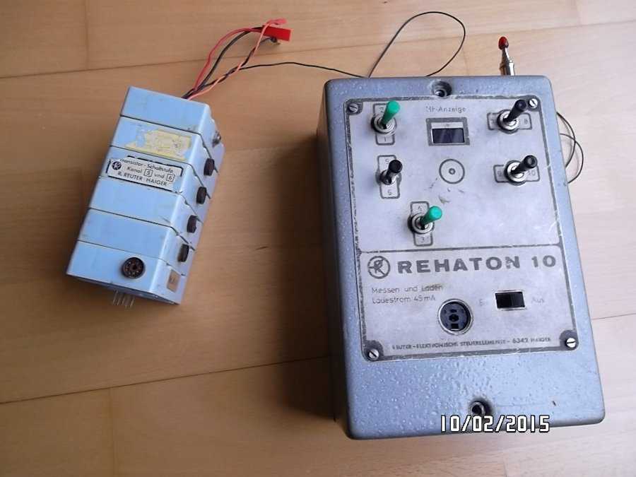

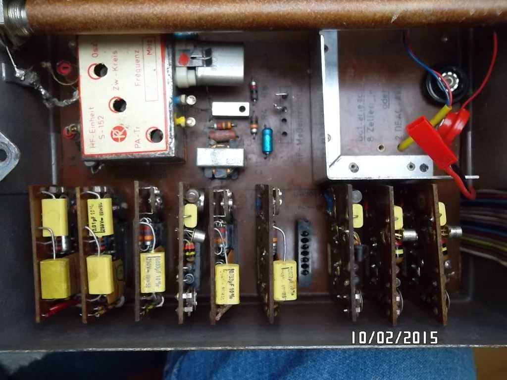

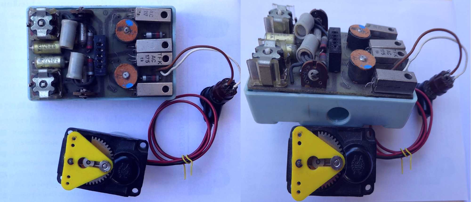

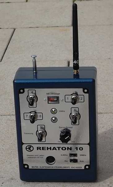

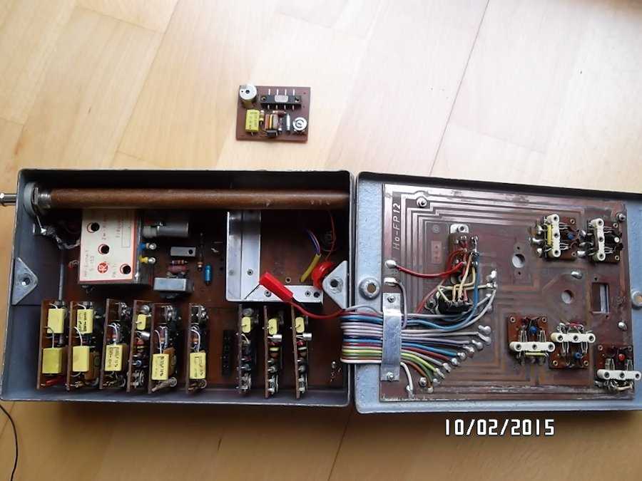

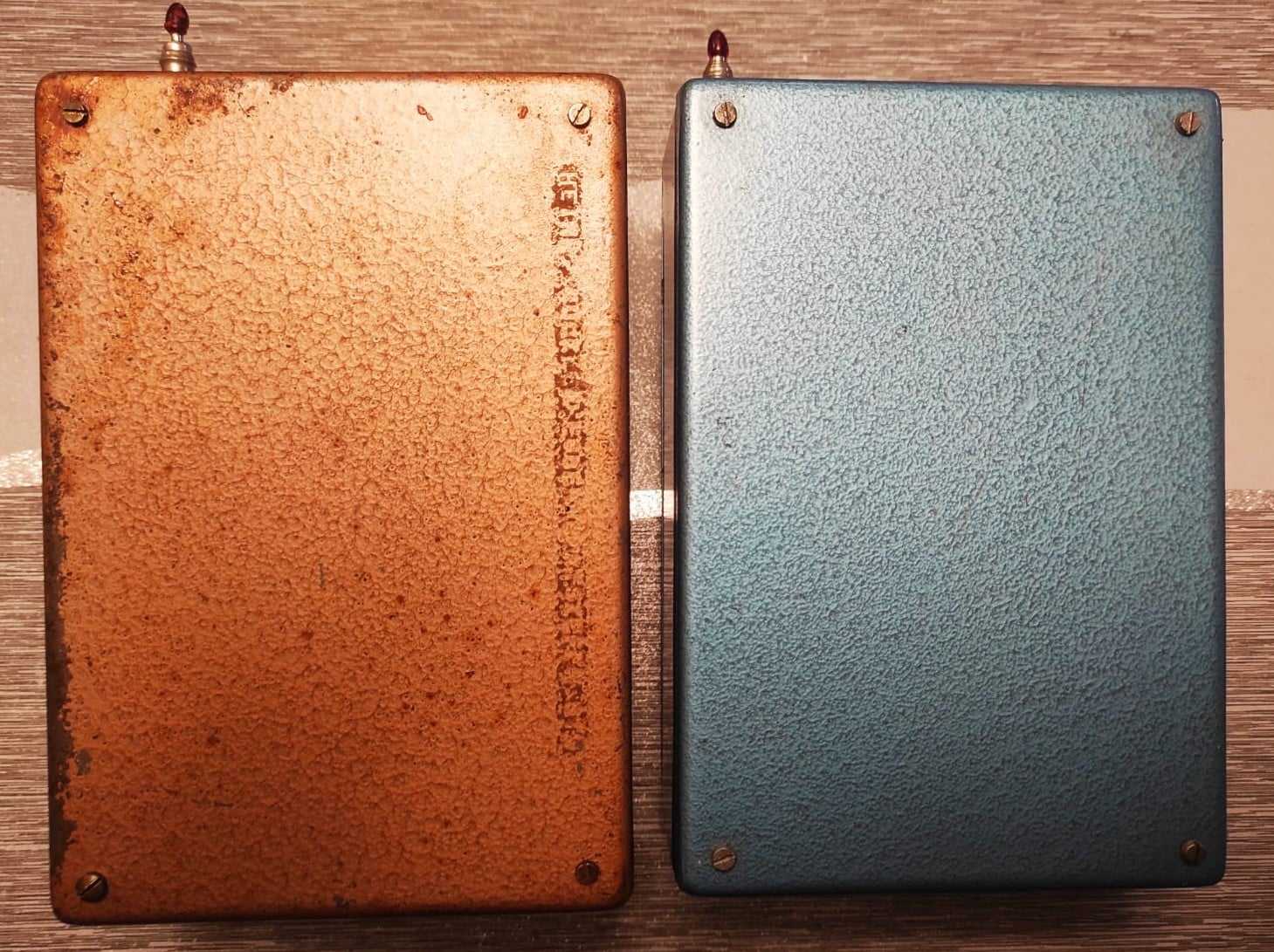

The Rehaton 10 was a home build reeds radio with a maximum of 10 channels very similar to the Multiplex 3x4 radio from a company called Engel.
It was offered in kit form by Reuter, a German company offering kits for several radio sets.
I might have more information and maybe circuit diagrams, if I dig deeper in my shed.
The Rehaton receiver consists of several stages like the Grundig Variophon receivers.
Here are some pictures of my original Reuter Rehaton 10 incl. the receiver (mostly in working condition)
and my two replicas of it. If you need more information, don´t hesitate to ask.

...amazing engineering and the attention to details!
Would be nice, if possible to see the inside of one of the Rx-modules as if it would be reed and not tone there should be a "reed-bank" in each module.

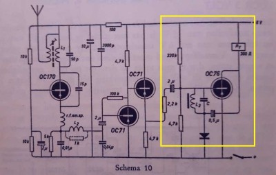

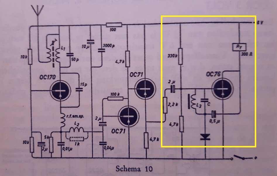

No, no reeds.
Reuter always used the Schumacher tone filter circuit.
Similar to this circuit, but with 2 filter stages. Clever use of the transistor as a tuned AC amp and then again as a DC switch.
I used Reuter's pot cores and capacitor sets to build my first RC set from scratch, a 2 channel tone filter unit.
Got it working, though never enough range (being age 17, I had no clue about HF back then).
In hindsight the oscillator probably wasn't feeding enough signal to the power stage...
Hence not driving it into saturation, eventually killing any Class C stage.
I blew up several AF 118 while trying to improve this.
After 3 fly aways I had enough and started on a Classic Custom that ended up with almost the same range...
But then with the telescope antenna all the way in.

Thank you for this clarification and it's like I thought but was confused by Frank mentioning reeds ... if it would have been reed it sure would have called for an even more clever solution being modular!
