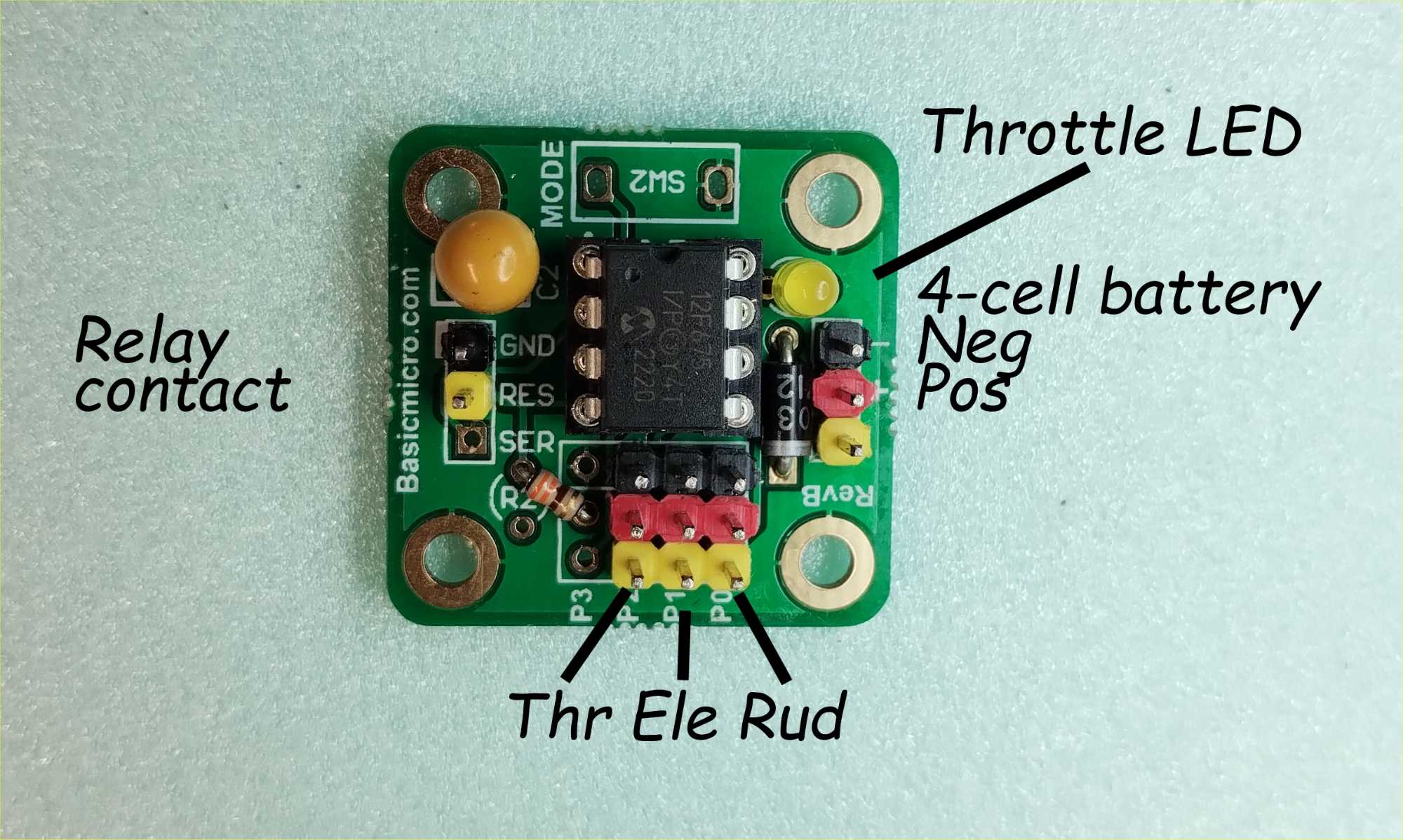

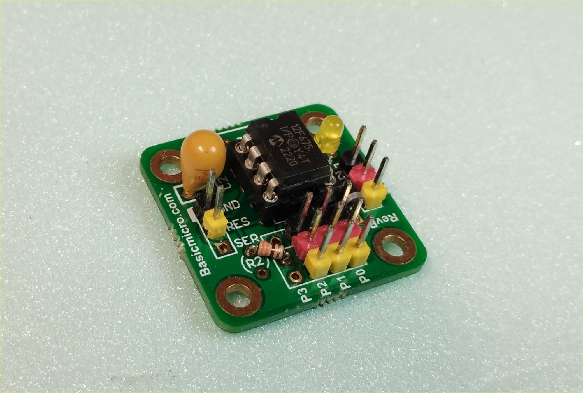

The buyer, David, has asked for a Single-Channel Actuator Emulator, which I assembled yesterday
and I was pondering methods of connecting it to Davids Pathfinder receiver. Relay? Optocoupler?

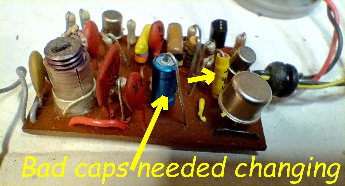

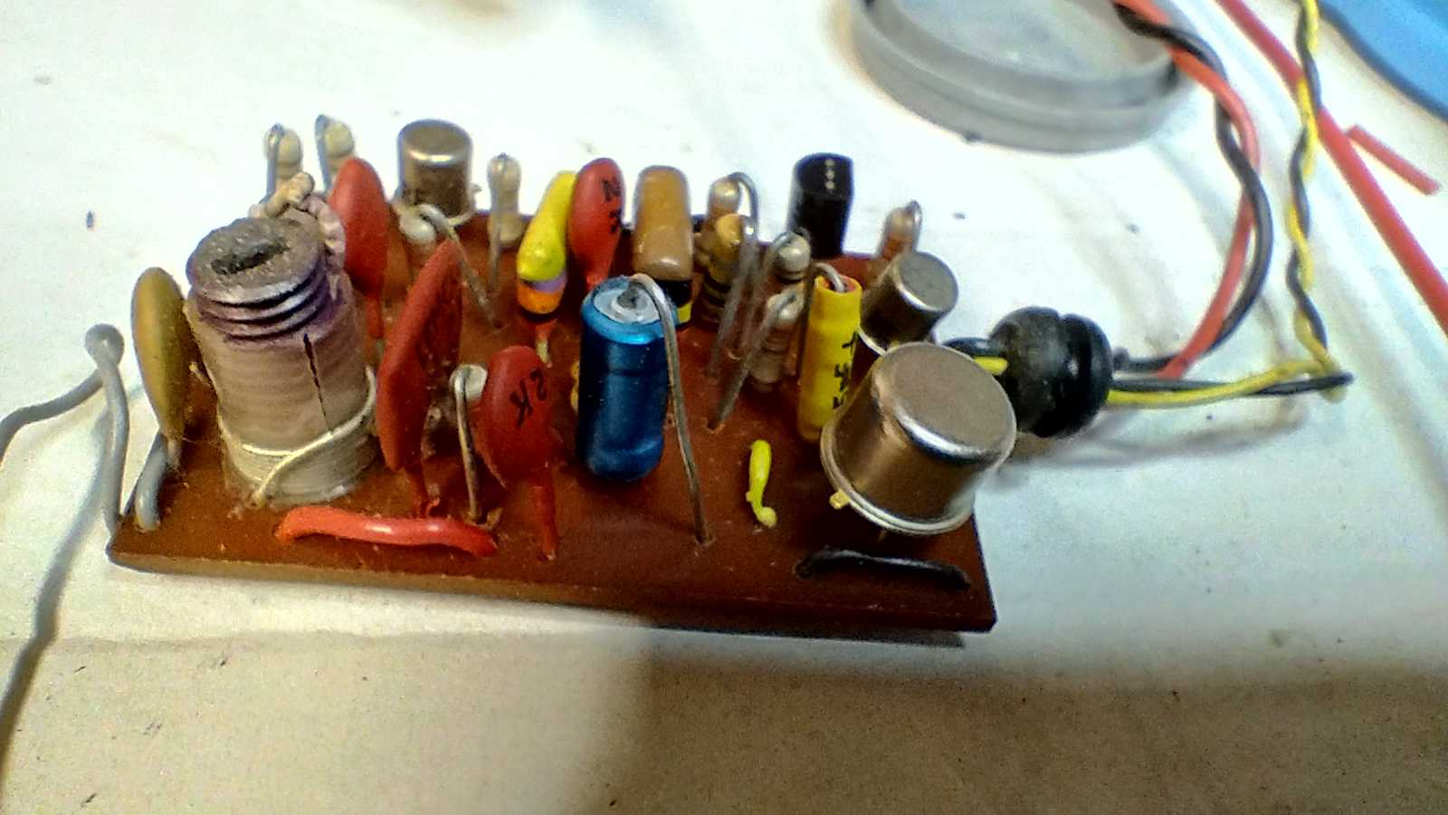

I had an idea that somewhere in my stash there might be a Pathfinder transmitter, and did some digging.
Sure enough, I found it, and - bonus - inside the case was a Pathfinder receiver I didnt know I had !
Of course the receiver didnt work, but after swapping a couple of duff electrolytics, it works perfectly at over 50 years old !
The transmitter worked right away, they always do, a good quiet carrier on the Yaesu comms receiver and a clean & solid tone.
I found the Pathfinder receiver has an open-collector output so is able to drive the emulator directly - previously we've had to use either a relay
or an optocoupler, but in this case everything works perfectly wired directly to the Pathfinder receiver with no need for either!

I posted Davids S/C Actuator Emulator today but I was so chuffed to discover I had a (now) working Pathfinder outfit, I assembled another one for it, so its now a fully functional demo set

Davids ebay Pathfinder set didnt work so he sent it to me. Testing showed the tx is ok, but the rx was locked on.
I changed a couple of electrolytics and its working now but the range is only about 30 feet. It tunes nicely but thats it.
I checked my own Pathfinder and - guess what - range is also about 30 feet !
The regen hiss is there but very quiet and I suspect its not oscillating/squegging properly.
I'm going to change out all the transistors, apart from the BFY51 output they're all common-or-garden BC108s or 'TUNs' as Elektor would say.
I'd change the C280s but my stock is probably as old as the Pathfinder
A schematic would be nice but I cant find one anywhere, might have to trace it out. Its not (as many were) Terrytone-based as it has no Ardente transformers. The BFY51 output is open-collector so it can drive the actuator emulator directly with no interface. Which is nice
