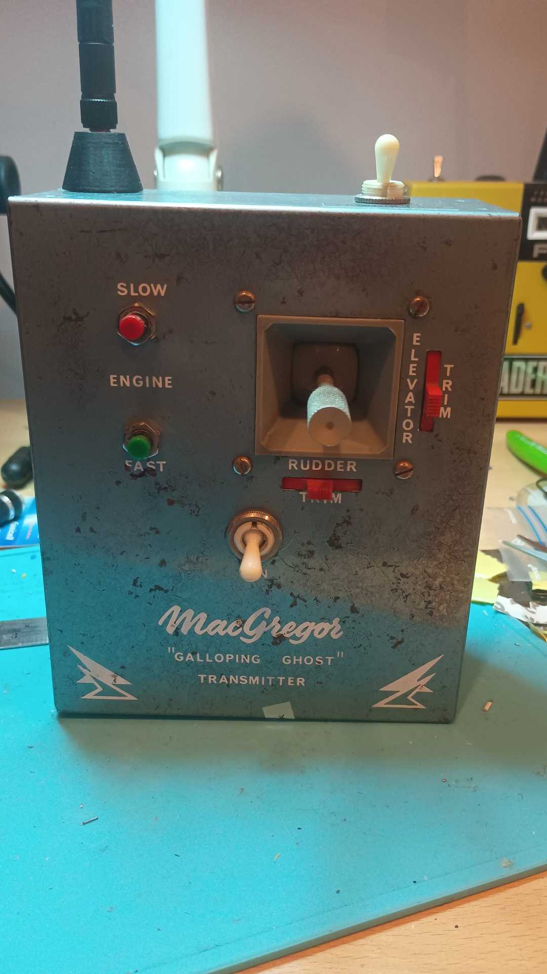

Anyway this ghostly memory is of my original Macgregor GG set. All pristine and shiny.

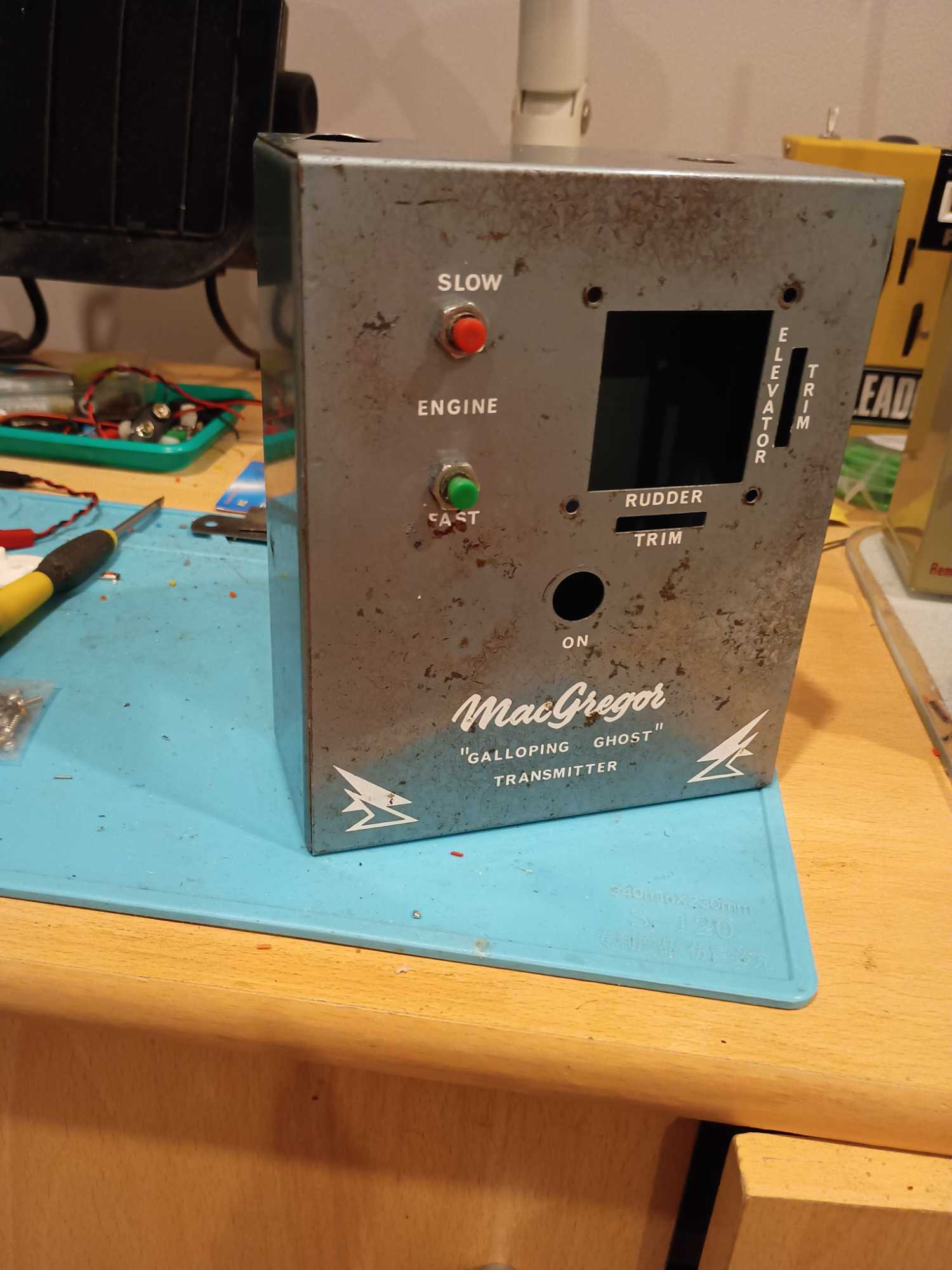

Well this one is a shadow of it's former self.... decidedly tatty.
Totally out of character I'm converting it as is and not repainting it.
Rustoration or oily rag I believe it's called in the car world.
I'm not sure I can live with with this level of tattiness but we shall see. Internals and stick unit are like new, but it's obviously had a life.

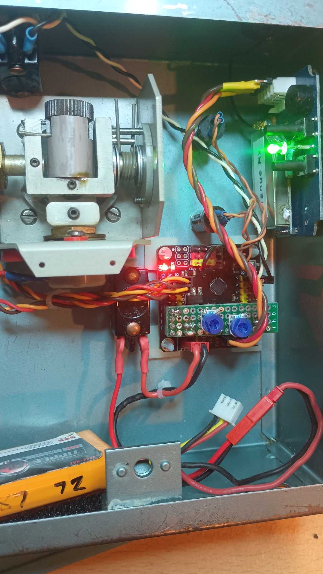

Phil fettled the Arduino propo s/w for me a year or so ago. It has rudder , ele, throttle up and down on the buttons and a throttle cut/ lock plus
rates on the ele and rudder to accommodate various actuators such as Tobes or an original rand etc.

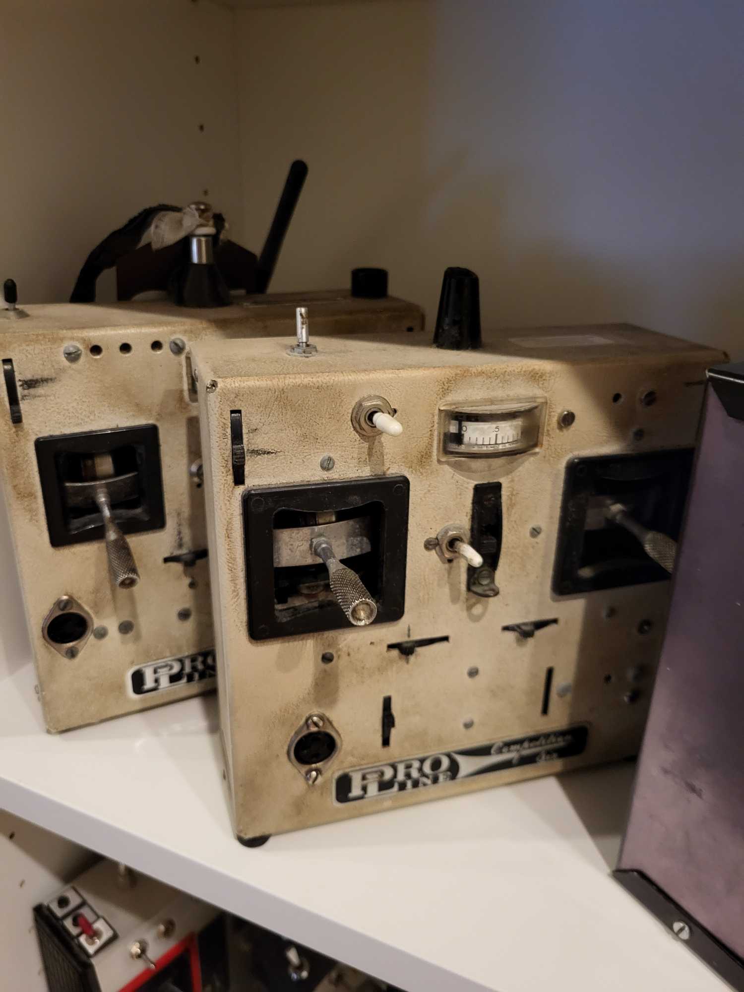

....or my ProLine, almost as new!

All done and working. My first rustoration project. The MacG lives again.
The 2 blue preset pots on the daughter board are to adjust ele and rudder rates
Switch on top right is for throttle cut.
