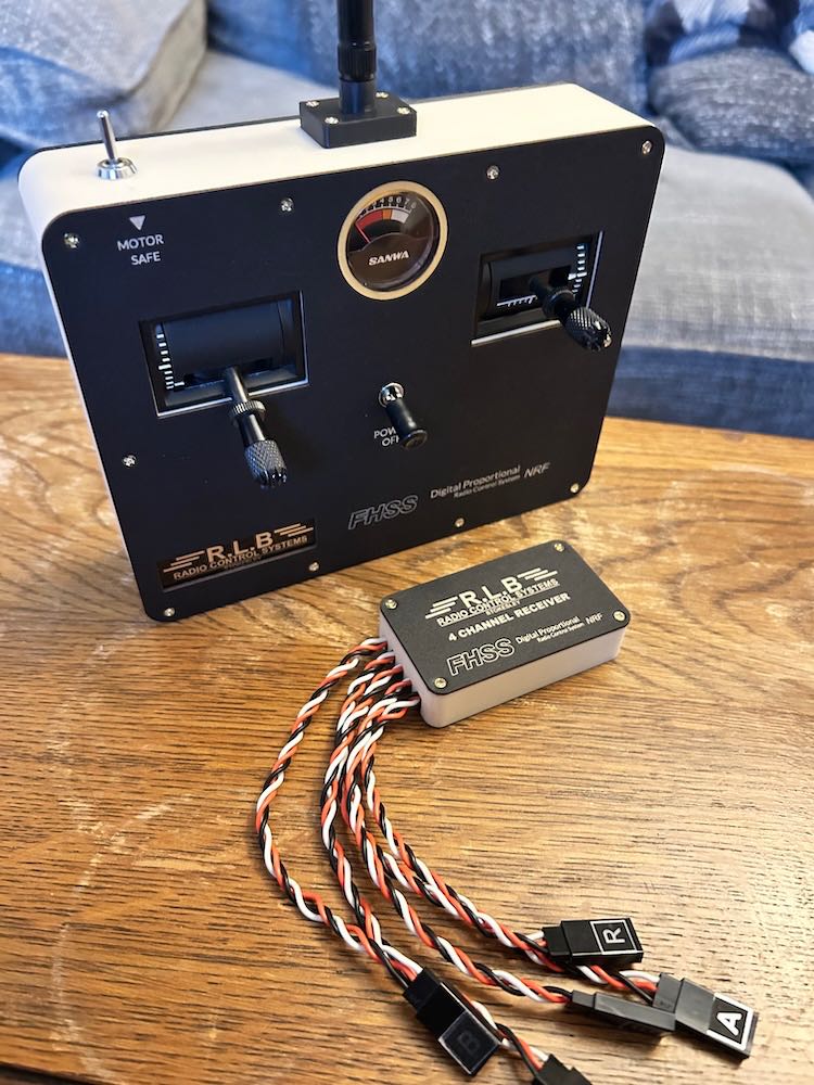

Here's another little project ive been busy with,
I had an old Sanwa custom 6 channel transmitter for spares, had it years and thought I could make a nice transmitter using the stick units and the meter. The sticks on them old Sanwa's are really nice, very smooth and accurate, not bad for an early 80s set.

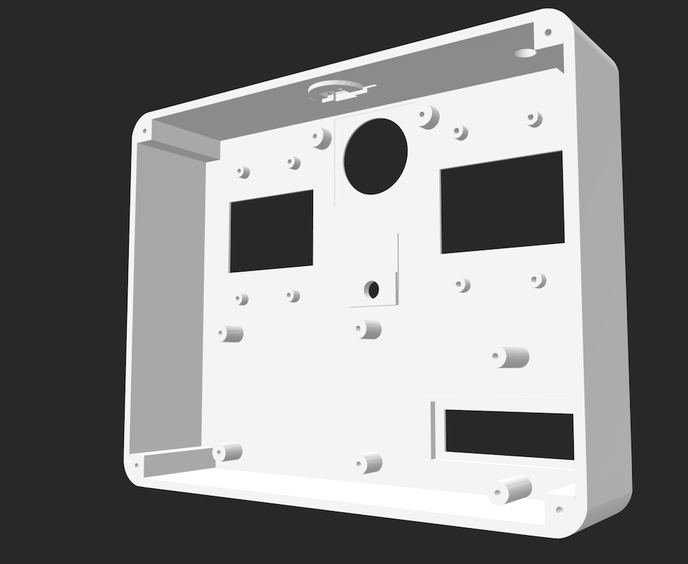

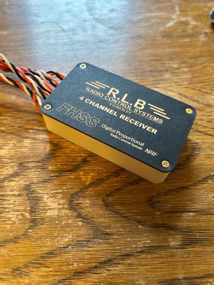

The casings are 3D printed and the front/top panels are laser engraved.
Electronics are NRF.
I do prefer the fly lead type rx, im just old school I guess.
PS- Those stick units were a devil to measure up and get the mounting lugs in exactly the correct place.
If anyone has a spare meter from one of these sets id really appreciate it, as I had to borrow this one from my single channel Sanwa project.
Only the Sanwa custom or black custom has the same meter. Thanks
Thanks for looking

Re: 4 Channel Tx/Rx
Jeti gear made in Stokesley. Excellent.
- Posts: 1238
Re: 4 Channel Tx/Rx
The laser engraved labels and case details are truly exquisite Ron.
