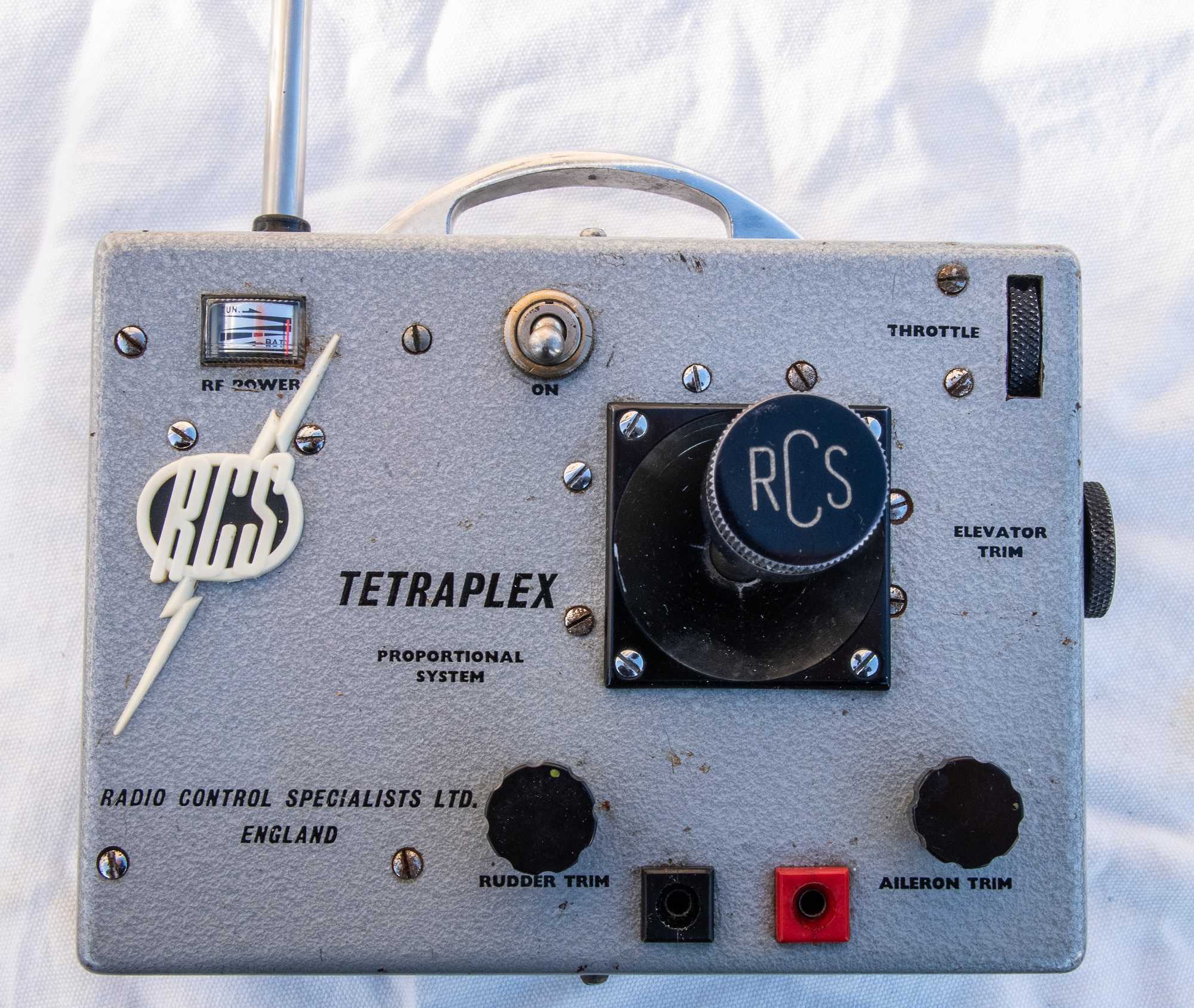

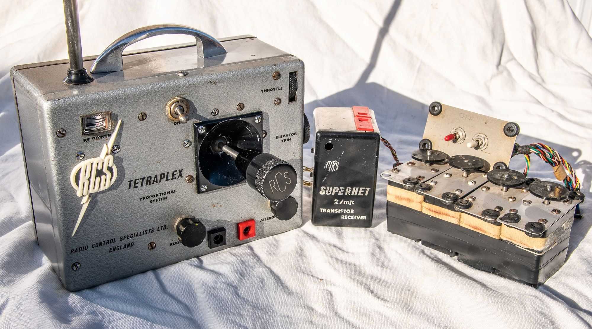

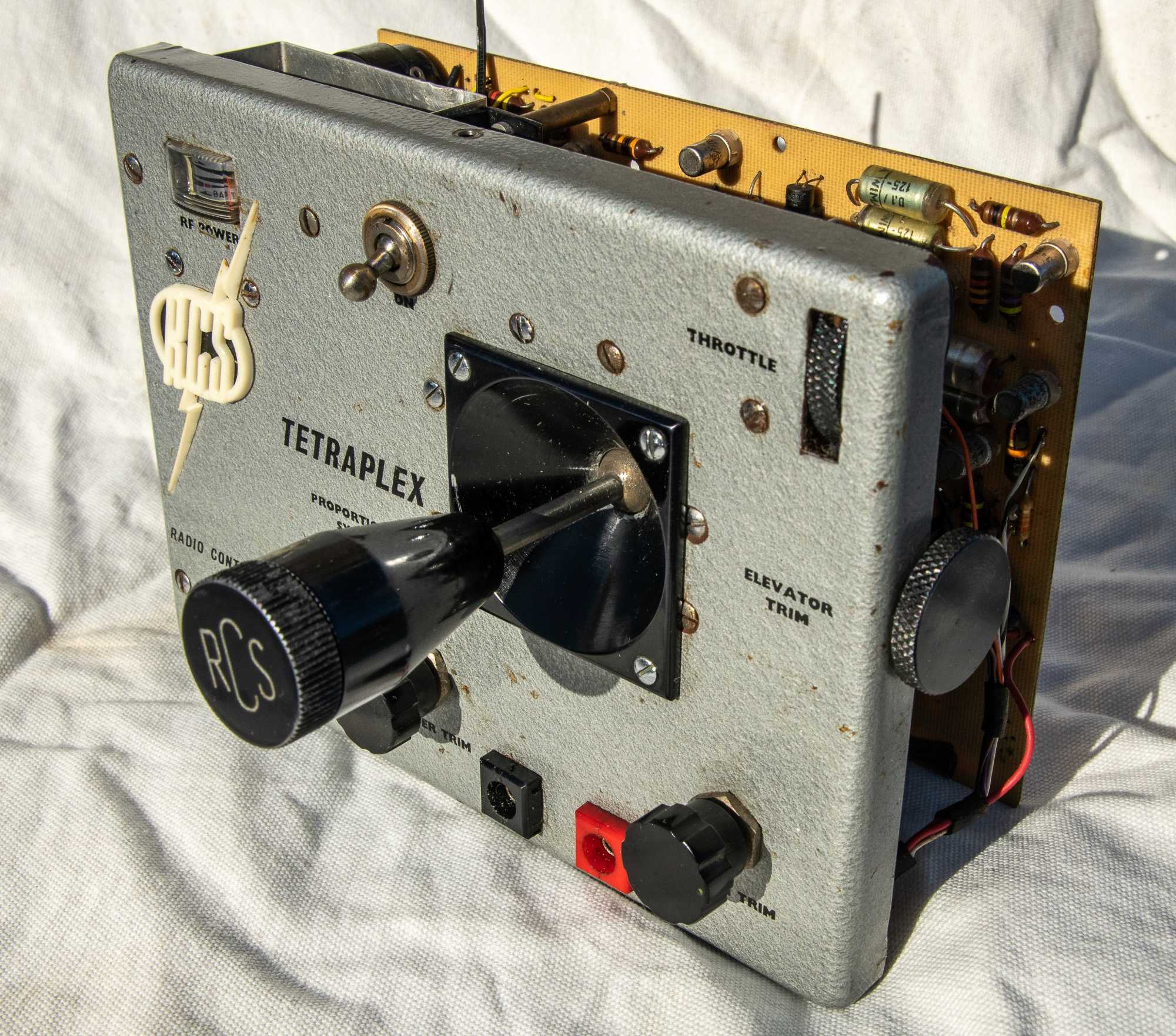

Pete mentioned the RCS Tetraplex in his explanation above, thought it would be useful to share with you guys what it looks like with my example, (which I am so fortunate to have found) from my collection:
You will note the almost military look to the set, it certainly has a 1950s old electronics smell!

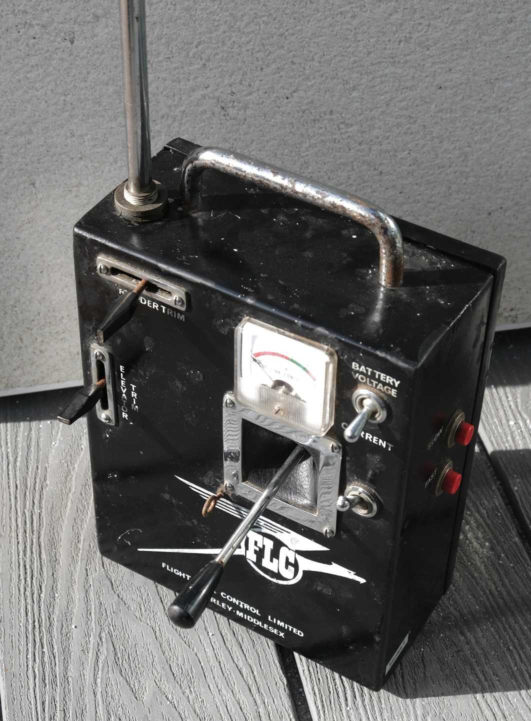

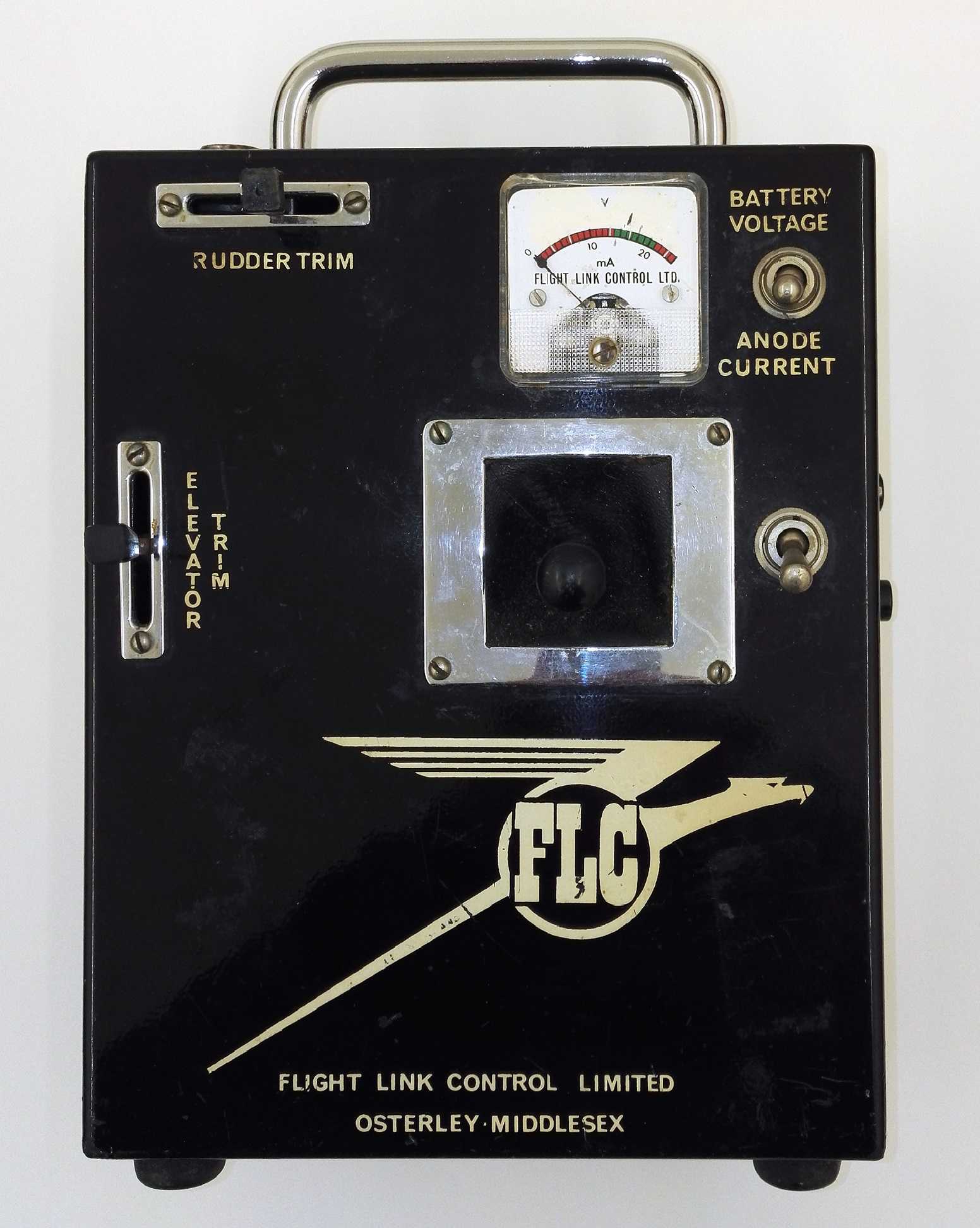

As mentioned by Pete above, here is a somewhat used and abused Series 1 Flight Link from my collection. It is a 2+1 system with a faster frame rate than the Galloping Ghost systems of the time. It was designed to be operated as a "cuddle box" single stick unit with the throttle controls mounted on the right hand face and be operated by the pilot's left hand.
The lower pic shows Mike Kitchen's pristine example showing subtle differences in the stick bezel to my example. I believe Mike's is a very early example, while mine shows serial number 105. I think this illustrates the cottage industry style of manufacture and was probably made in Idris Francis back bedroom while he was at University!?!

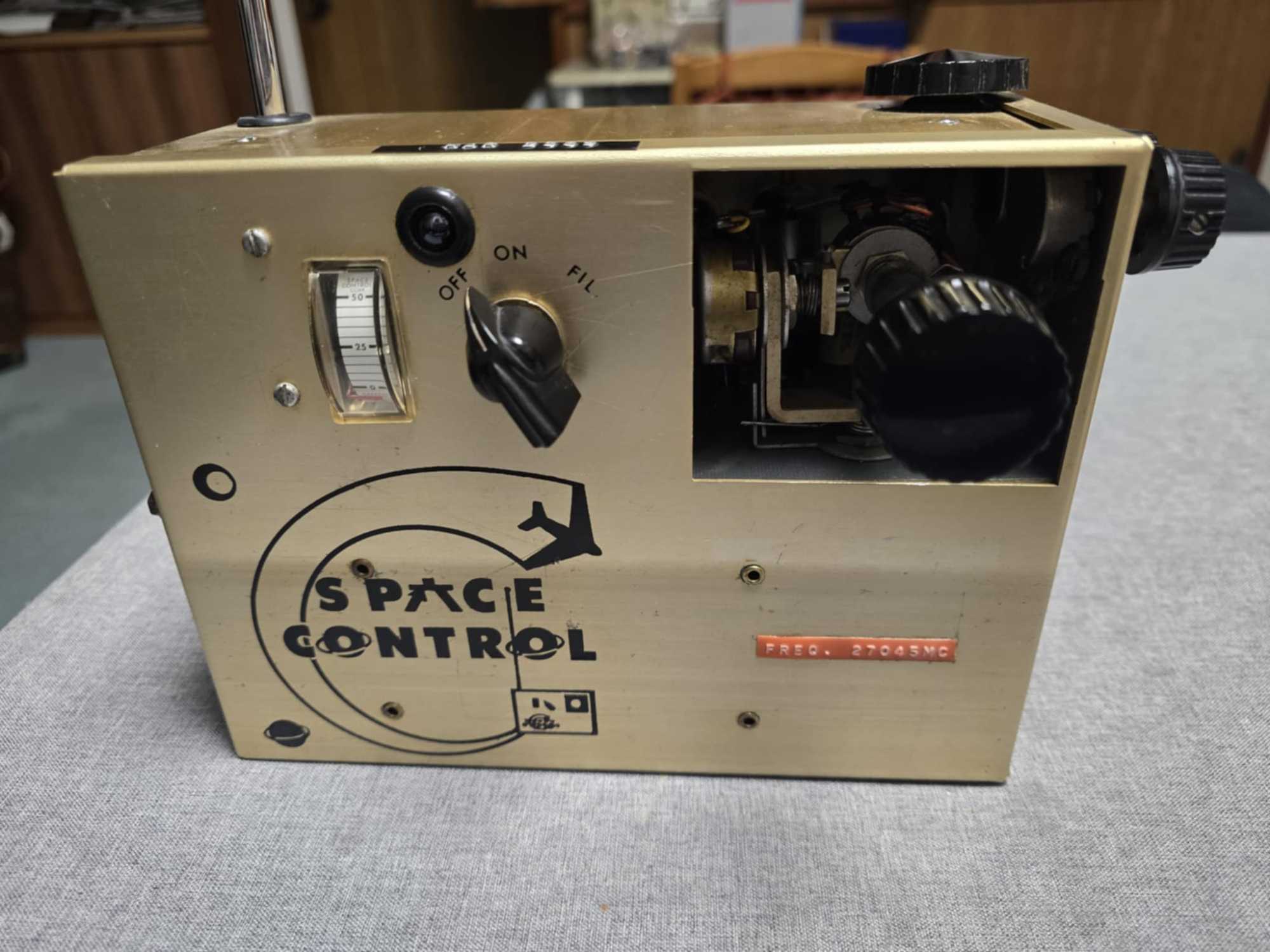

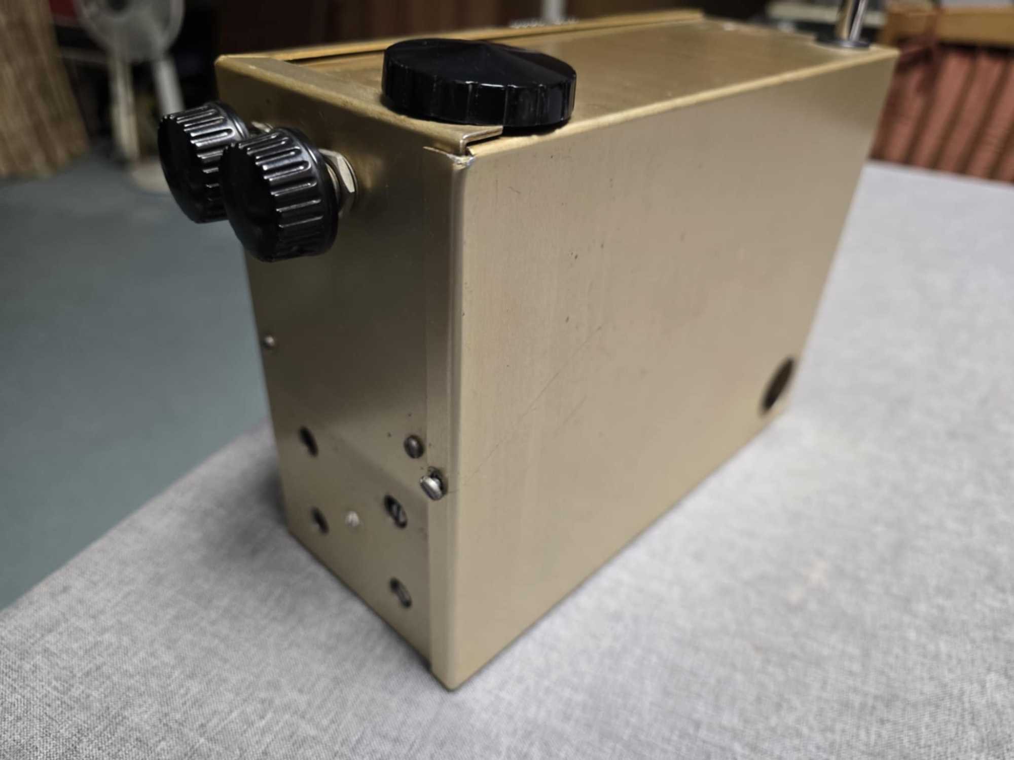

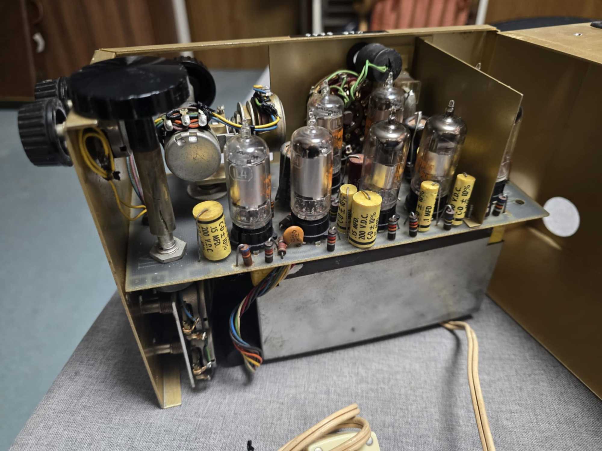

And to complete the trio of radios, Pete mentioned, here is a pic of what the Space Control transmitter looked like. Thanks to my friend Gen Hirose from Japan who supplied the photos of his example from his extensive vintage RC collection!
