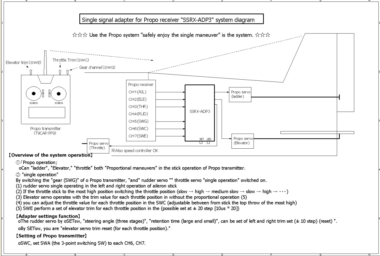

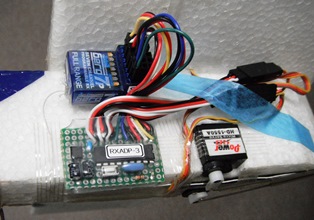

Single signal adapter 'SSRX-ADP 3' completed in December 2015
(PIC16F628A)
The adapter connects to the propo receiver and the propo servo.
In the "stick operation" of the propo transmitter
· Single channel operation of "rudder Servo"
· Single channel operation of "Speed controller"
To do.
"Single button" can enjoy a "atmosphere" by a difficult person.
It can enjoy "flight waving the tail wings".
It is safe because it can be switched between "propo motion control" and "single button control".
