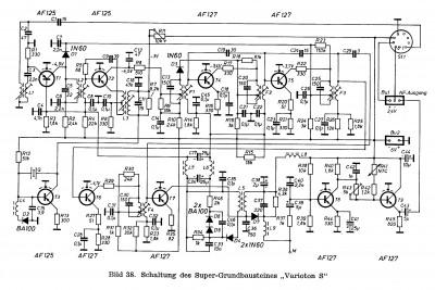

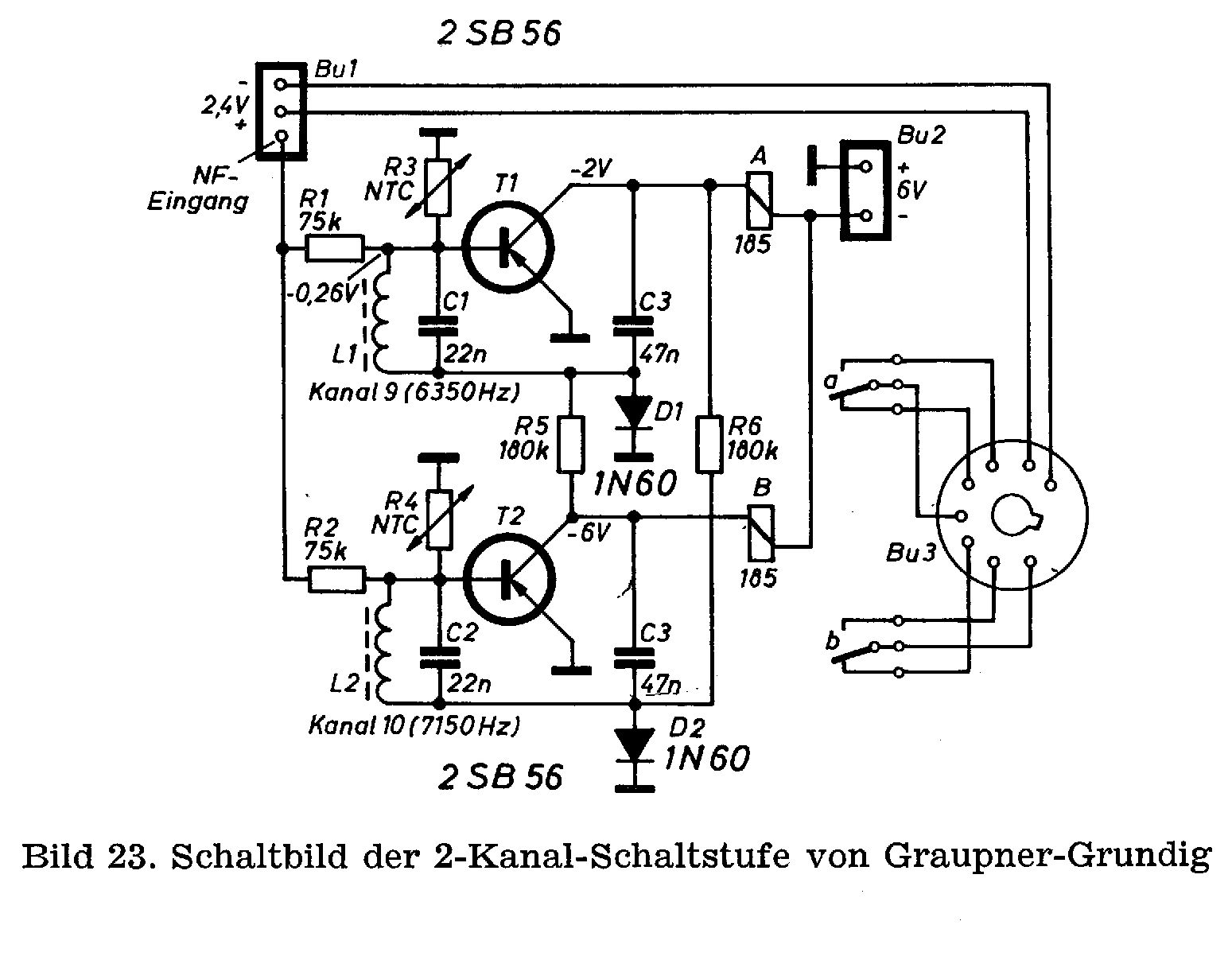

Hi Jay,

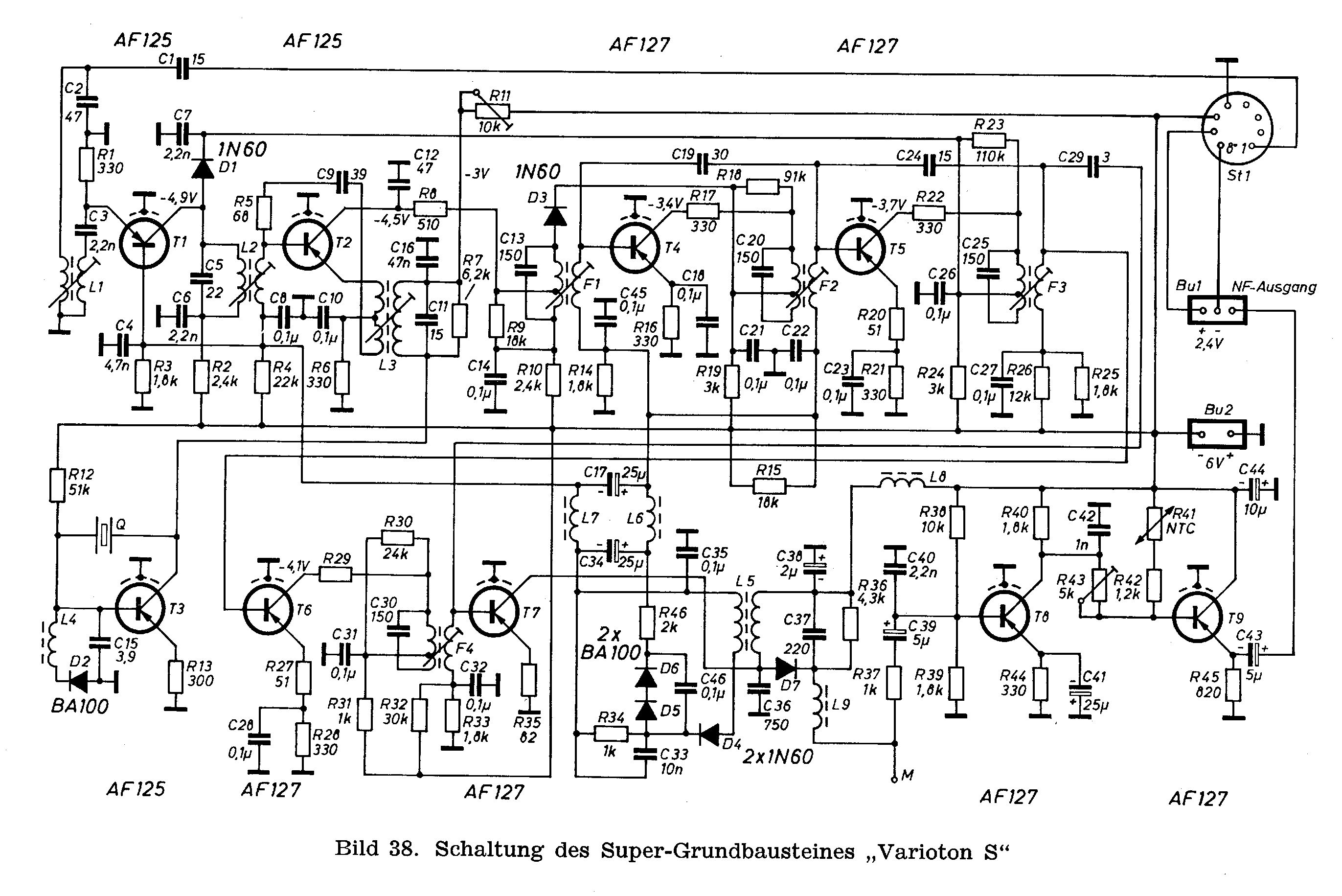

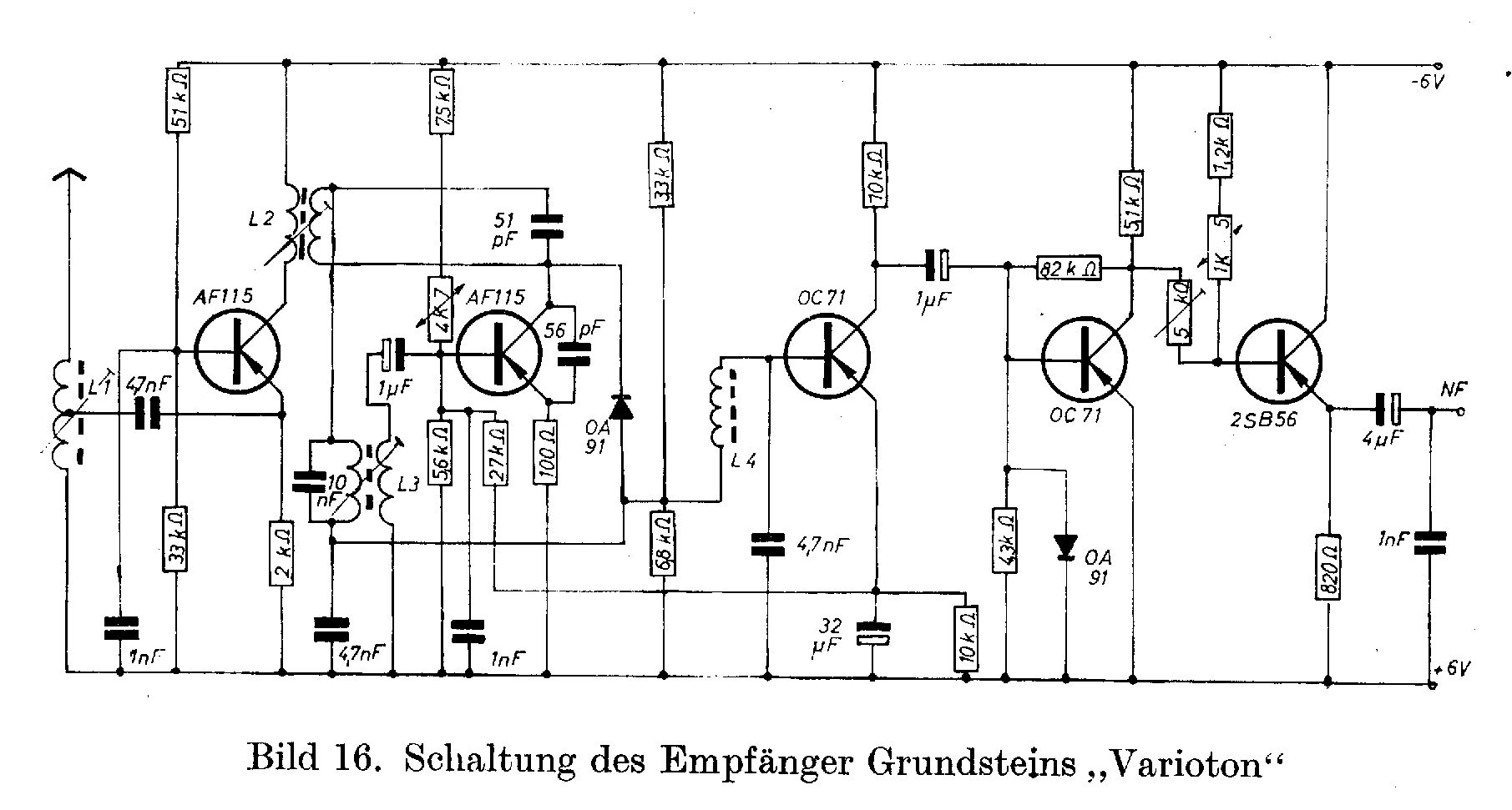

here you find some scematics:
First is the basic receiver next is the superheterodyne receiver then come the channel modules If you need transmitter scematics, just tell me which one, I have almost all of them.

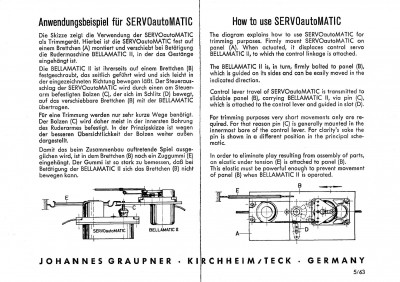

Most of the documentation I have only in German language, but a few I have in english like this ones:
If you need something special, let me know.Frank

Jay,
A few hints: In the superhet receiver, there are a number of very fine wires connecting the two boards (its a double-deck design). If these fracture, the receiver stops working - not surprisingly! They can be a pig to replace due to the proximity of adjacent lands when soldering. (Guess how I found out! Luckily without doing any permanent damage!)
Yes, the relays can be an issue and are very difficult to clean. But before jumping to conclusions that the relays are faulty, clean the connections between the plug-in modules. I spent ages cleaning the relay contacts only to discover the culprit was one of the module inter-connects.....!
Here's the schematics I have.....
Best of luck!
P.S. You'll probably find that they weren't popular in the US because they didn't comply with FCC requirements! The range of audio frequencies used are much wider than in a traditional "reed" set, and don't fit inside a 10KHz channel spacing.....
P.P.S. I have a feeling that the IF frequency isn't 455 KHz. I'm not sure, but I have this nagging suspicion that it is 470KHz. It probably won't work with "industry standard" 27 MHz crystals.
Best of luck!

- Posts: 406
Re: Variphone help needed!
The Variophon S IF frequency is 460 kHz. Keep that in mind when choosing your crystals for the superhet-receiver Varioton S.
So if you have a transmitter with the popular 27.120MHz crystal, the receiver crystal needs to be at 26.660MHz.

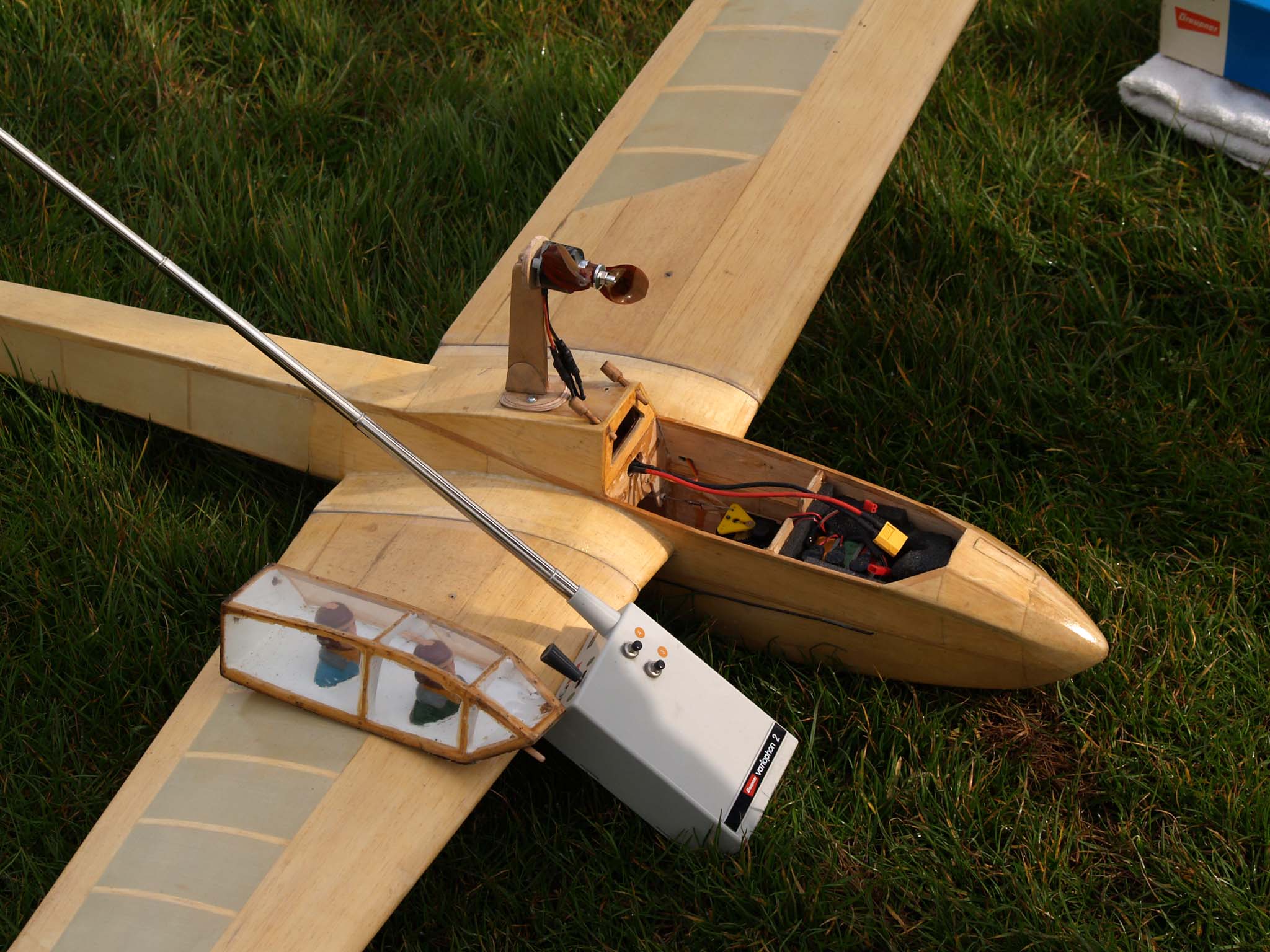

- Posts: 4
- Joined: 31 Mar 2018, 19:27

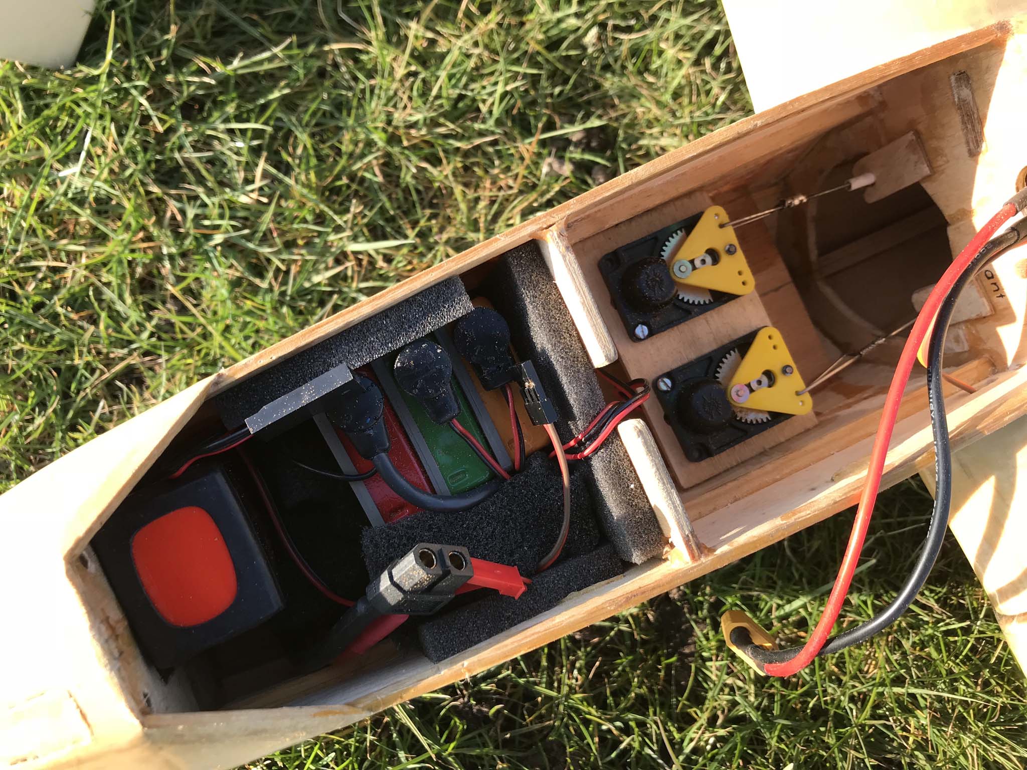

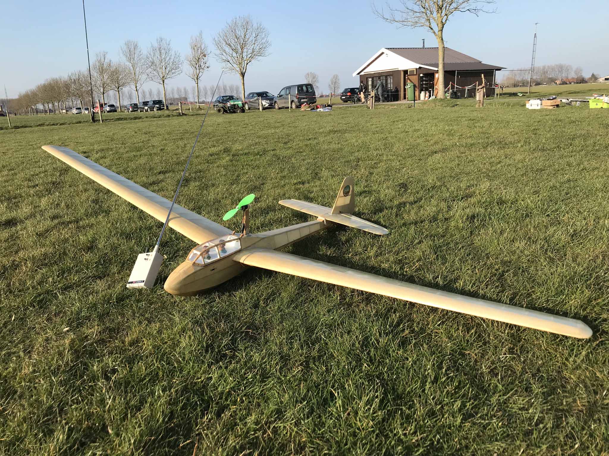

I did get a variphone working recently . The receiver module was ok, but the tone modules (in the TX) did not work out well. I replaced the condensors (according to schematics above, checking frequency with an oscilloscope), cleaned the stick and push button contacts from oxidation , in the tone modules I had to clean the contacts of the relays with very fine sandpaper. The bellamatics are plenty available on ebay, and I built two good ones out of a bunch of not so good ones. Variphone is now working great and did tens of flights in a foamy to test it out on reliability, and to get used to the 'morse' style of control inputs. Never had a glitch. Two weeks ago I did a maiden flight with the radio built into an (era built, silk cover etc) Bergfalke from SchucoHegi. The only compromise was an electric motor on a pylon with an esc timer module. Flight was fabulous. This was my first rc plane almost 50 years ago, it flew 50 meters and then crashed due to radio failure. This is my revenge
- Posts: 406
Great post, I am glad, that you got the Variophon working. Most of the time it´s only a matter of contact problems (relais and/or connectors) and old capacitors. The Variophon is a very reliable old radio, I have them all from the 4channel to the 10channel unit and all are working great.
Yesterday I was flying the original Amigo with the small 4 channel transmitter, however converted to 35MHz.
The Hegi Bergfalke is a fantastic vintage glider, I have a worn out 50 year old one in my basement waiting for restauration.
