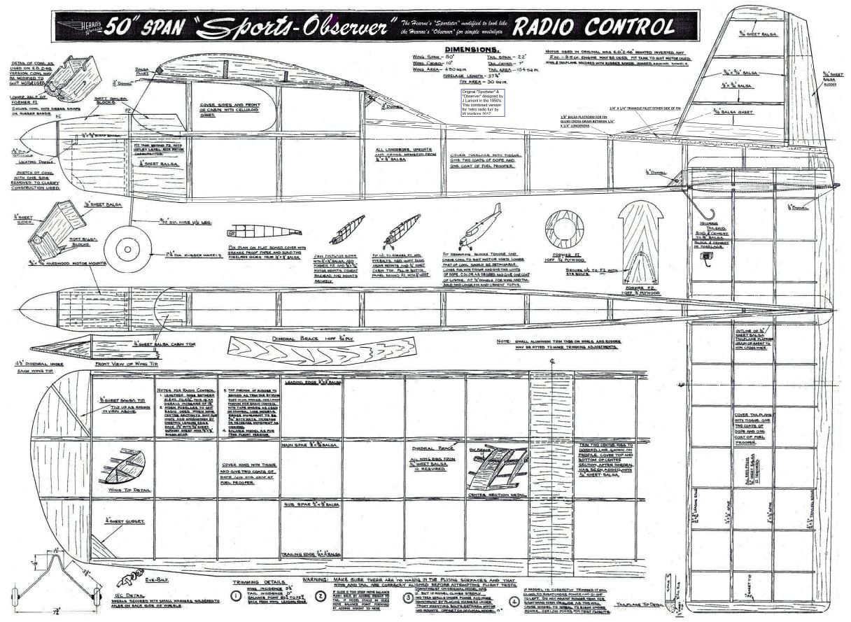

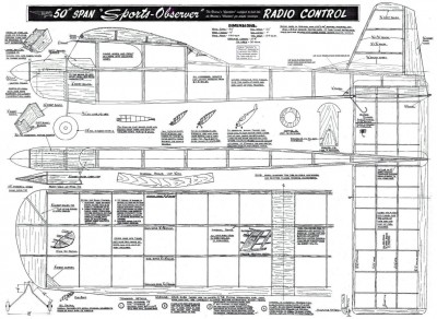

Alas, I have never been able to track down an electronic copy of the Observer plan, but I do have a hard copy carefully packed away somewhere in storage :roll: . Last year, while relaxing on a cruise, I started converting the Sporster plan to make it look as much like the Observer as my memory could recall. While at it, I made a few minor mods to improve the single channel performance --> increased the fin area to reduce spiral instability, added a rudder, moved the CofG forward, thinned down the tail-plane and made it symmetrical.
screen grab of the "Sports Observer". The wing TE mods are not yet finished (hint - look closely at the photo)
Hearnes_Sportster_single channel.pdf
(812.79 KiB) Downloaded 273 times
With Dad's passing, this project has moved right up the list. I think it would be an absolute delight puttering around at low altitude on a calm day or evening with a 1+1 or bang-bang radio. I shall keep you periodically updated on my progress........

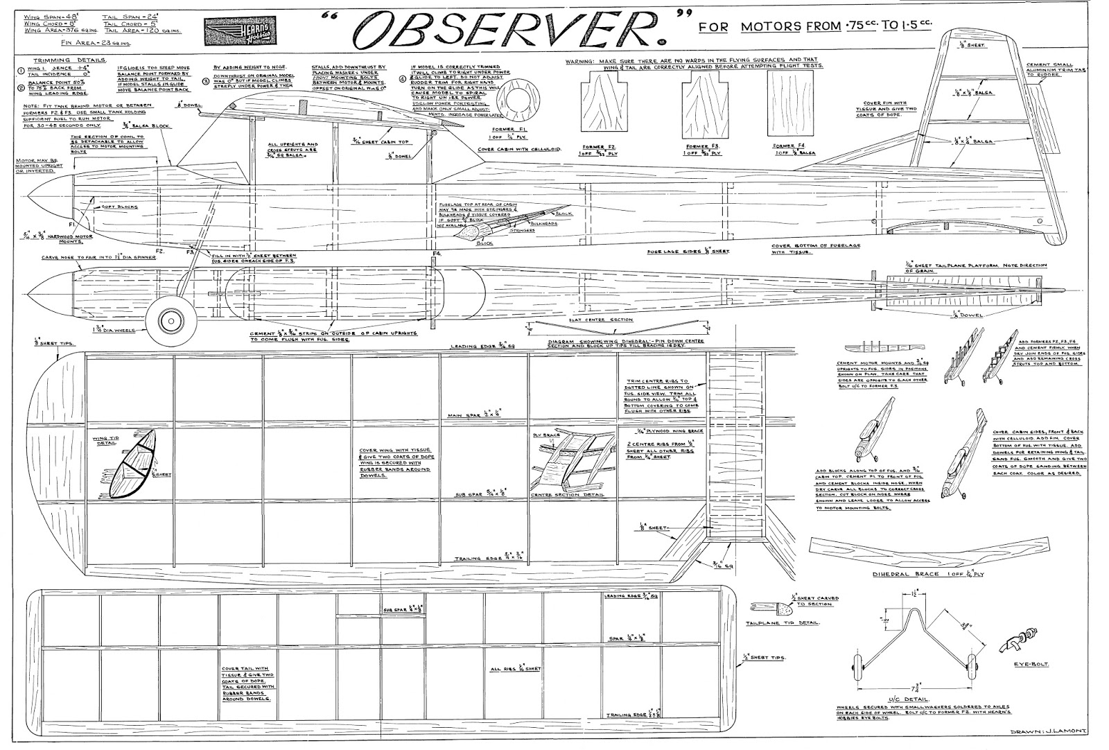

Dave & anybody else interested in Australian vintage model designs:
Doing some more searching tonight I found this page - https://fullcircleflyers.blogspot.com.a ... bilia.html
which has plans for many Hearns kits as well as kit box artwork and a detailed history of the Hearn brothers. It even has the plan for the Observer that my Dad built which of course I have downloaded - you rippa!!
