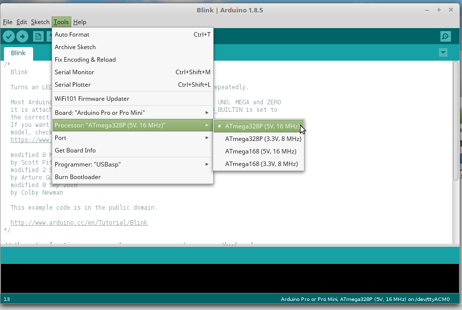

Try setting the Board: as "Arduino Pro or Pro Mini" and the Processor: as "ATmega328P (5V, 16MHz)" as shown in the screen capture below (click on image for larger view). If your board is the 8MHz type, then you should select "ATmega328P (3.3V 8MHz)" as the Processor type.

Select USBAsp and Upload Using Programmer?
- Posts: 787
Re: Diy pro mini uploading
Yes - that's right: "Programmer:" should be set to USBasp, and then upload using programmer. By the way, I forgot to mention that the "Port" setting is irrelevant when using a USBasp programmer.
