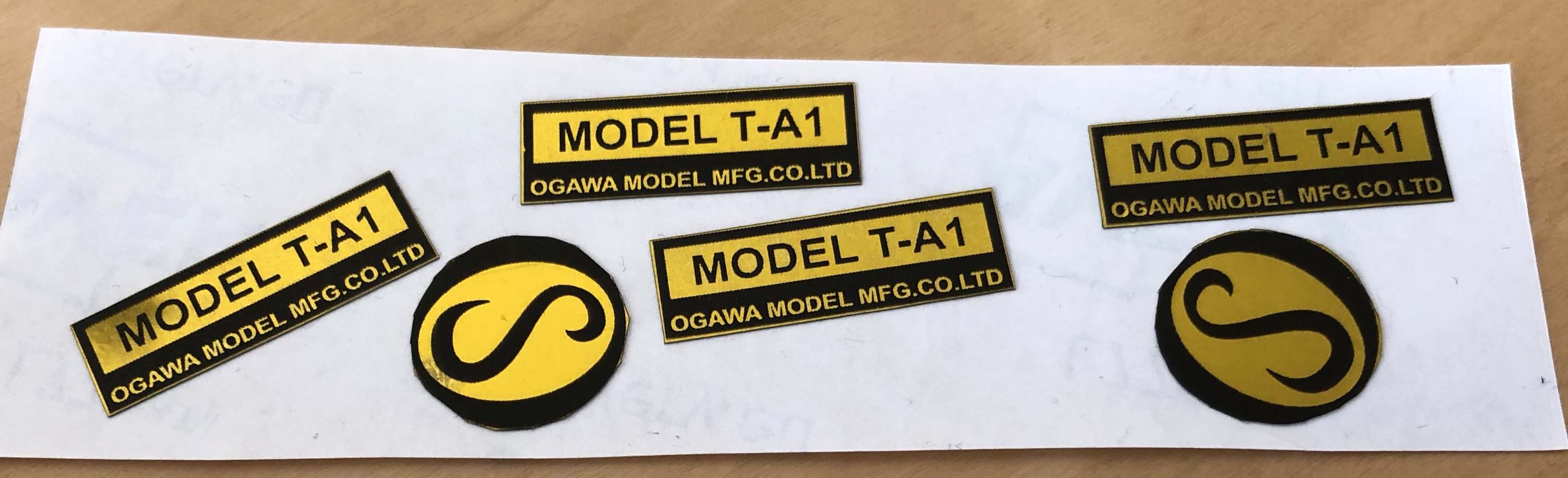

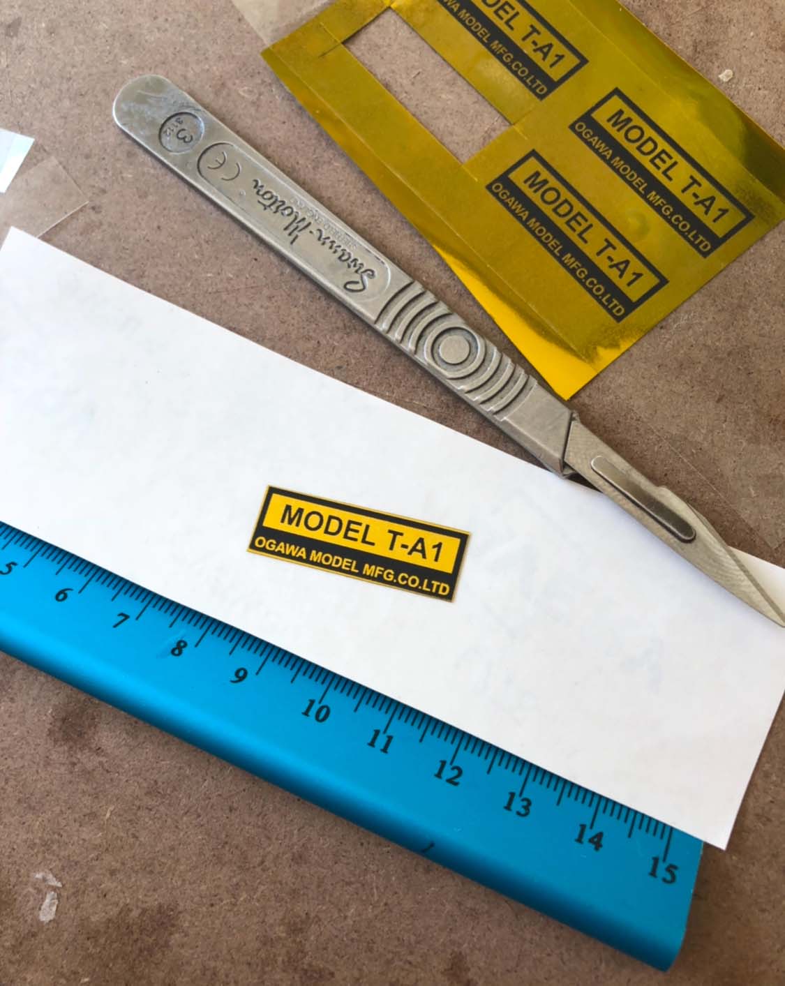

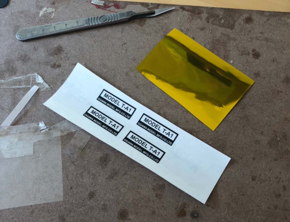

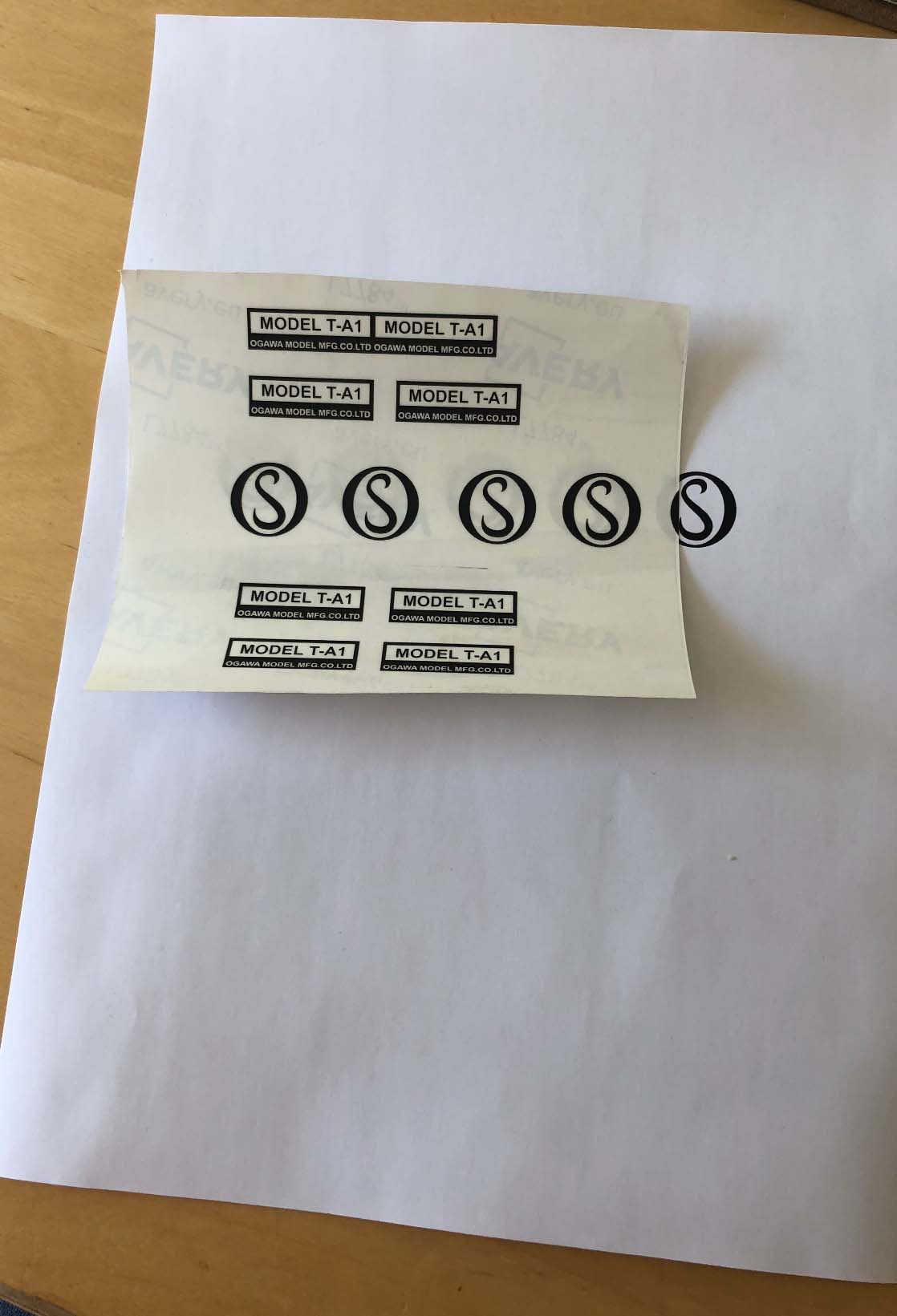

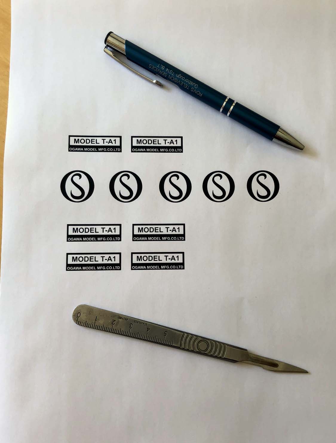

Firstly, print your decal on some ordinary white paper, this is so you can check the exact size it prints, when happy simply use a small piece of sellotape to fix your clear vinyl over the top of the image having firstly cut the clear vinyl to the approx size, this saves on the vinyl, no point using a full A4 sheet to do small decal.
Put the white sheet back in the printer not forgetting to adjust the printer setting for labels instead of plain paper, then print.

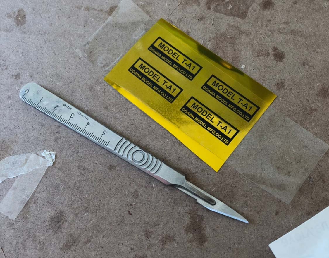

Now, take the top protective layer off the mirror vinyl and stick the printed clear vinyl image to it.
Rub all the air out so it’s nice and flat.
Cut the newly made decal out and hey presto, I sometimes use a clear lacquer lightly sprayed over the top depending on what the decal is used for. This makes it last longer and won’t scratch.

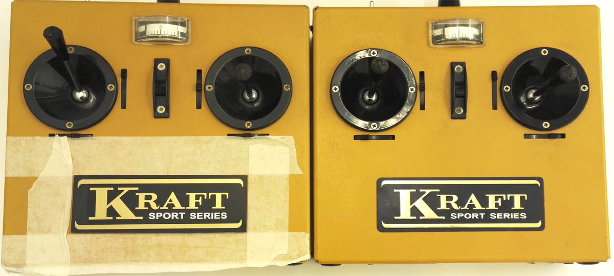

But I needed to print the label for a Kraft Sports Series for a conversion I'm doing, as the label was missing. The problem is that the "SPORTS SERIES" is in silver and the Kraft and top/bottom pattern in gold. After a bit of trial and error I found if I used silver/aluminium label material and printed a "light gold-ish" colour for the Kraft, the laser printer toner is opaque enough to show the shiny silver through and look like gold. While it isn't perfect and I can't replicate the slightly raised Kraft and sports series text, its better than no label.
