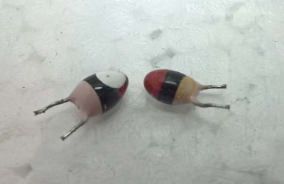

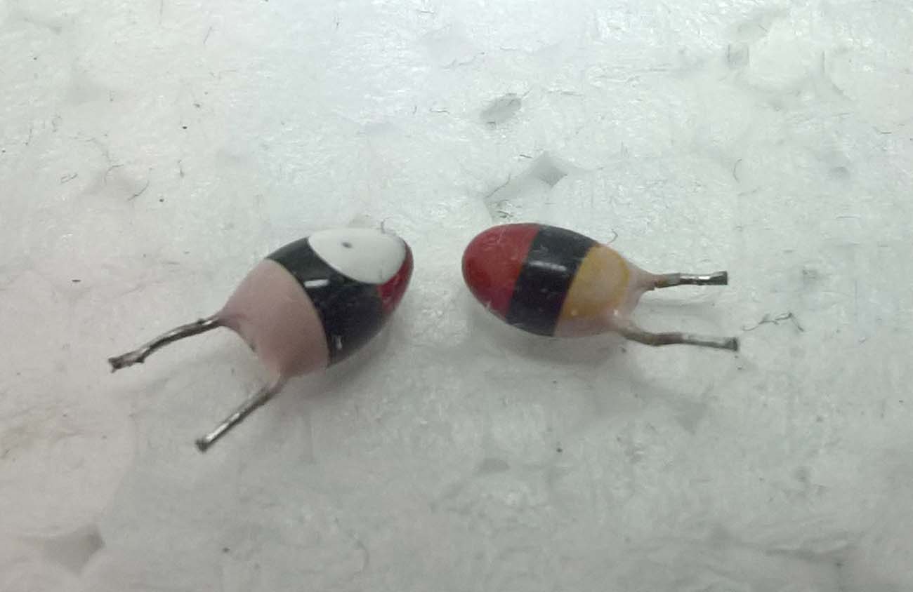

The pulser circuit on my Mattel has stopped pulsing and I found that one of these tantalum capacitors has failed - tested as open circuit.
I just need to be sure of the value. It's brown and black bands with a white dot. So is that 0.1uf? The band that indicates the voltage rating is a tan colour but can't find a value for it. Any ideas? Looks more grey in the photo.

Thanks Phil for the info. My brain was working backwards last nightPhil_G wrote: 22 Apr 2018, 00:32 How are you testing it Carl, with a multimeter a capacitor should test open circuit....
Brown black with a white dot is 1uF
Never exceed a tants max voltage, they catch fire! I'd suggest 16v if its a 9v battery.
One capacitor shows open and the other a resistance. I did another test by applying a voltage to each and then checked the voltage stored. The one that shows as open gave a voltage reading on the multimeter and the one with a resistance doesn't give a voltage reading and guess this second capacitor is the faulty one.
So it looks as tough we've found the culprit. Hopefully replacing the two capacitors will bring the pulser circuit back to life

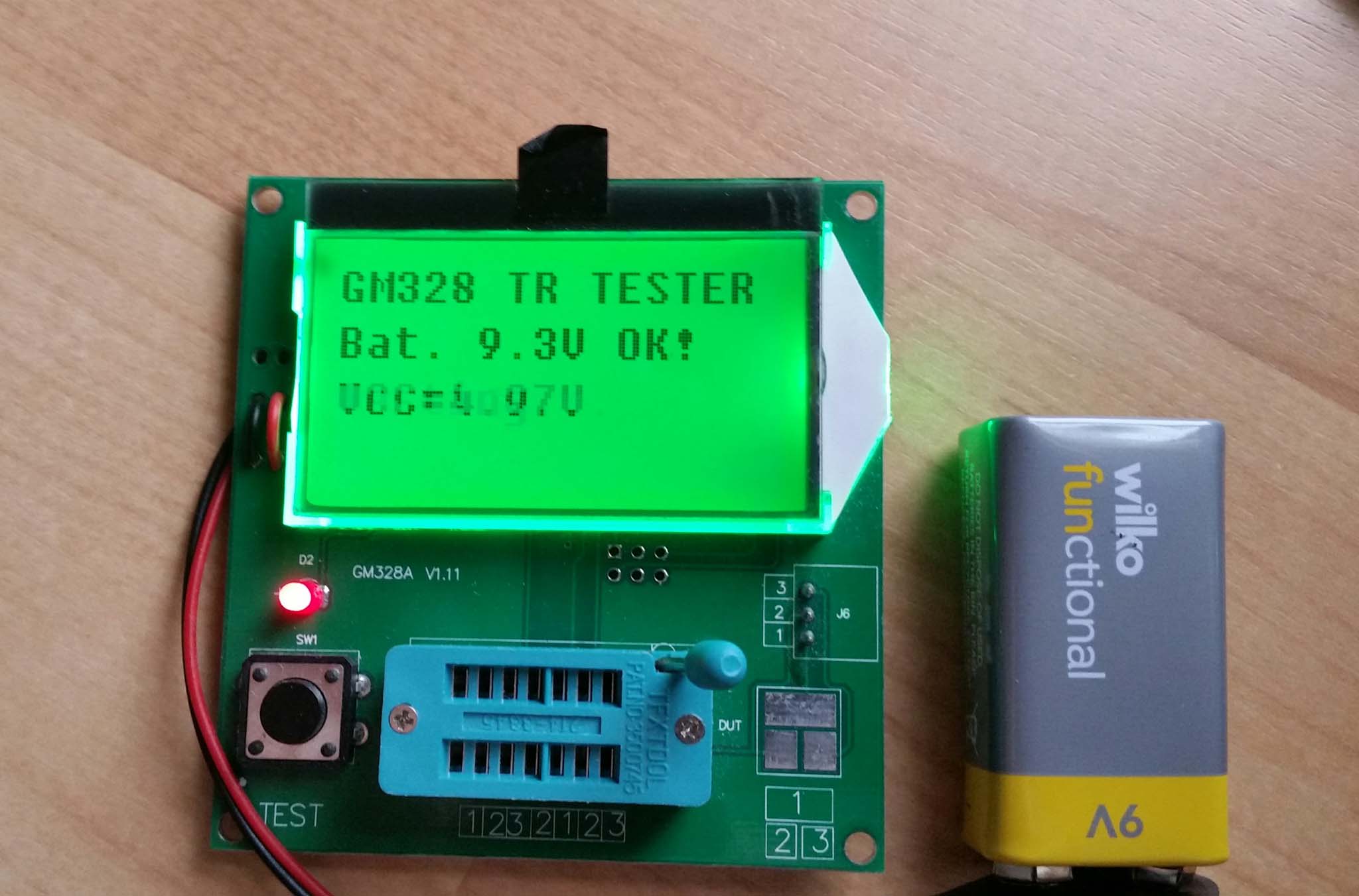

A while back I purchased a cheap component tester that can be used to check a variety of components such as resistors, transistors and yes you've guessed it capacitors. It may be worth considering purchasing one if you plan on more renovations.
A quick search on Ebay should result in a wide choice to suit depth of pocket.
