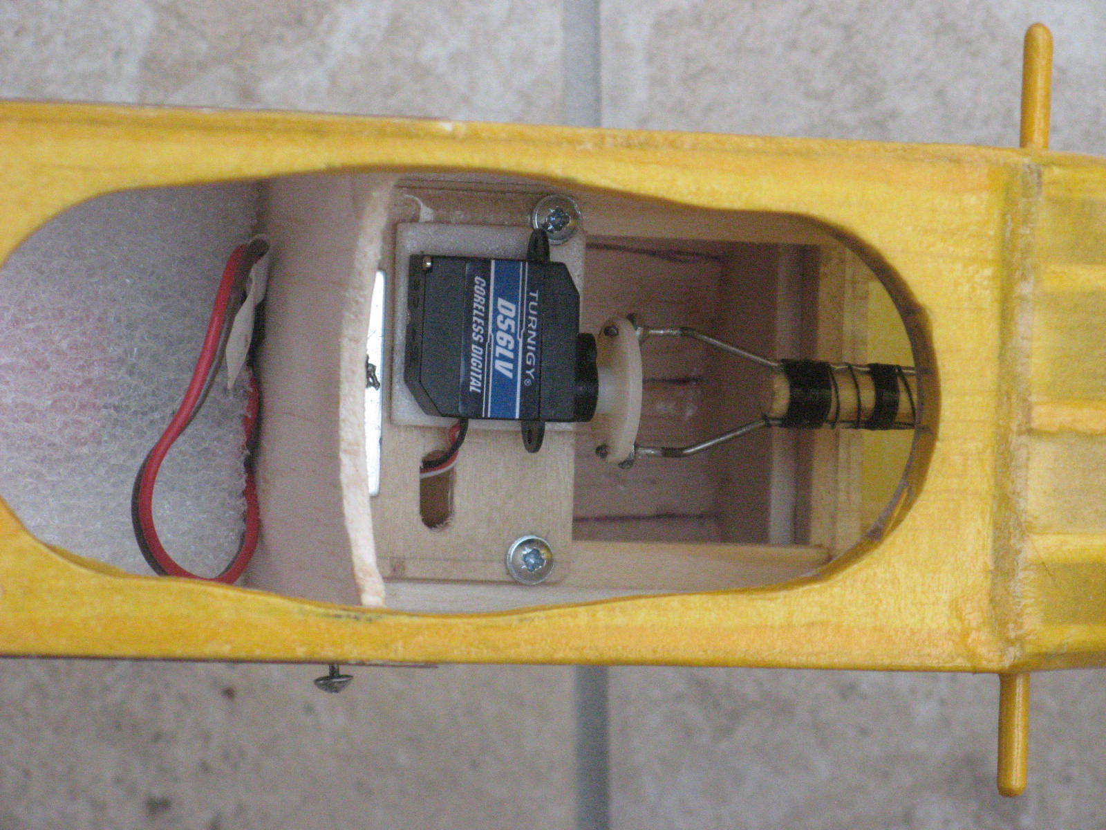

I can only second what Phil has said about using a servo........ My first two "new age" single channel models, a Veron Robot and a Sharkface both started out with escapements, I used and Elmic Commander, a Conquest and a Compact and had trouble with all of them. I had umpteen crashes due to the wrong command going in and the problem was that I never knew whether the problem was due to the escapement skipping or finger trouble on my part! Eventually I nearly decapitated someone and realised that this was not a joke so both models, and all subsequent s/c models use a servo and miraculously the unreliability has disappeared! By laying the servo on it's side you can still use a torque rod to control the rudder and from the outside, nobody will know the difference!
If you haven't flown s/c for 50yrs, give yourself a chance and use a servo.....
PS. Wanna buy three unreliable escapements?
PPS. There is very little difference in weight between modern miniature servos and an escapement, particularly if you add in the weight of the switcher unit.
