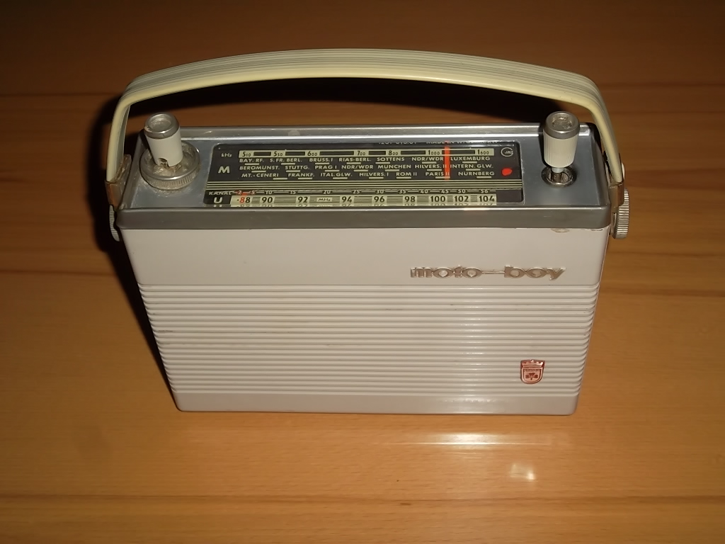

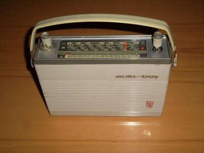

I am using my converted Variophon for more than three years now flying everything from a Topsy, Taxi, Consul, Floride up to a Taurus. Never had a problem. I am using Phils old 10channel reeds encoder and a Futaba 35MHz module on the original antenna. The servo-speed pot is hidden in the battery compartment.
Most people know, that the enclosure of the Variophon used to be a AM/FM radio called "Grundig Moto Boy", here is a picture of it.

Hi Frank! Thanks for the kind words! Yes, you can see where the speaker was meant to fit in the plastic casings on the Variophon, but that is the first time I've seen a picture of the original radio! :)
