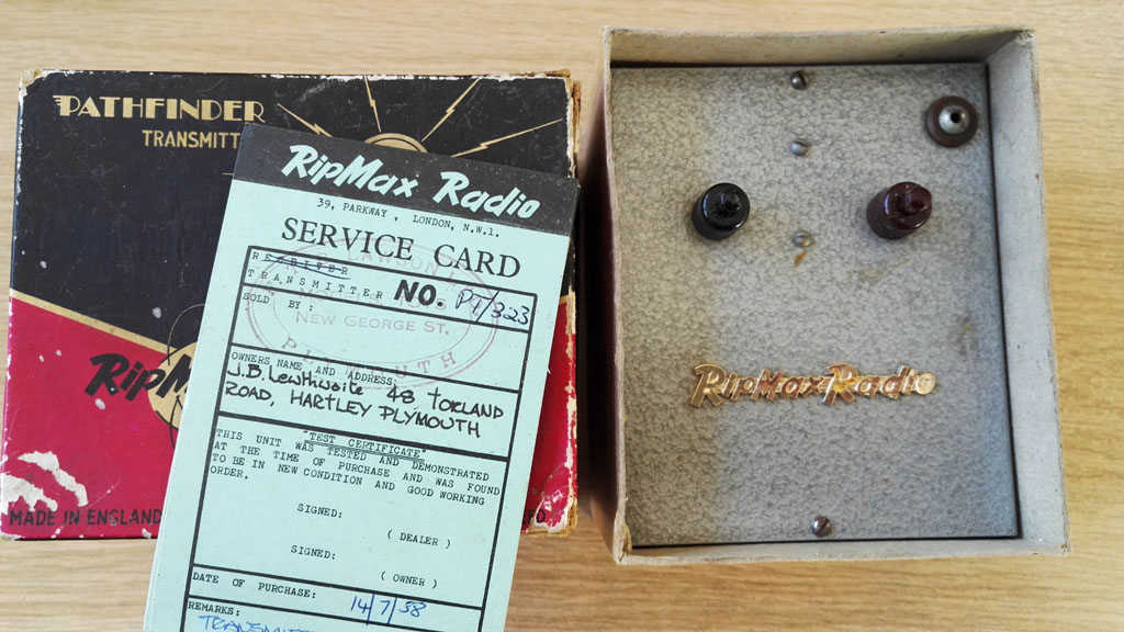

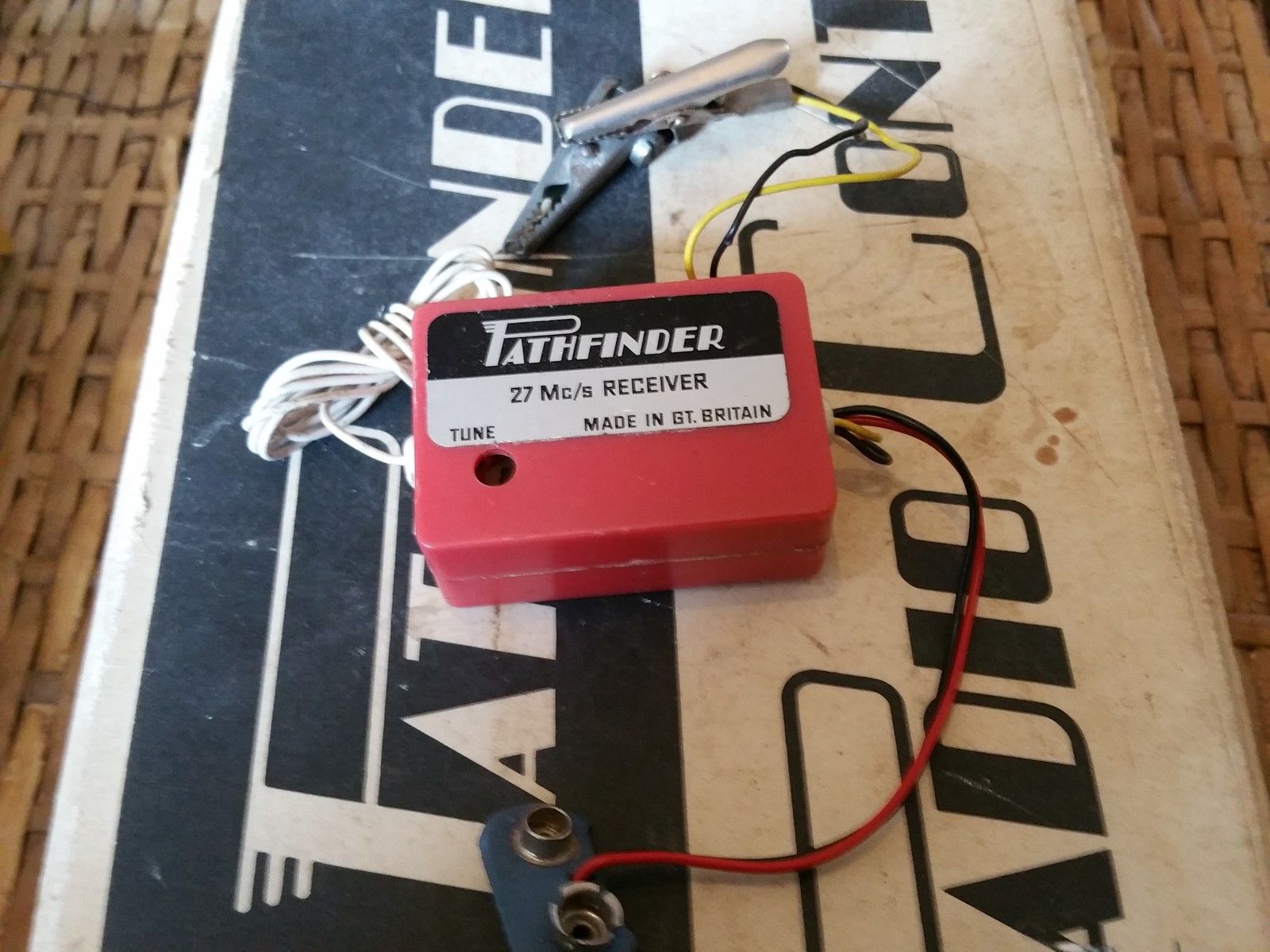

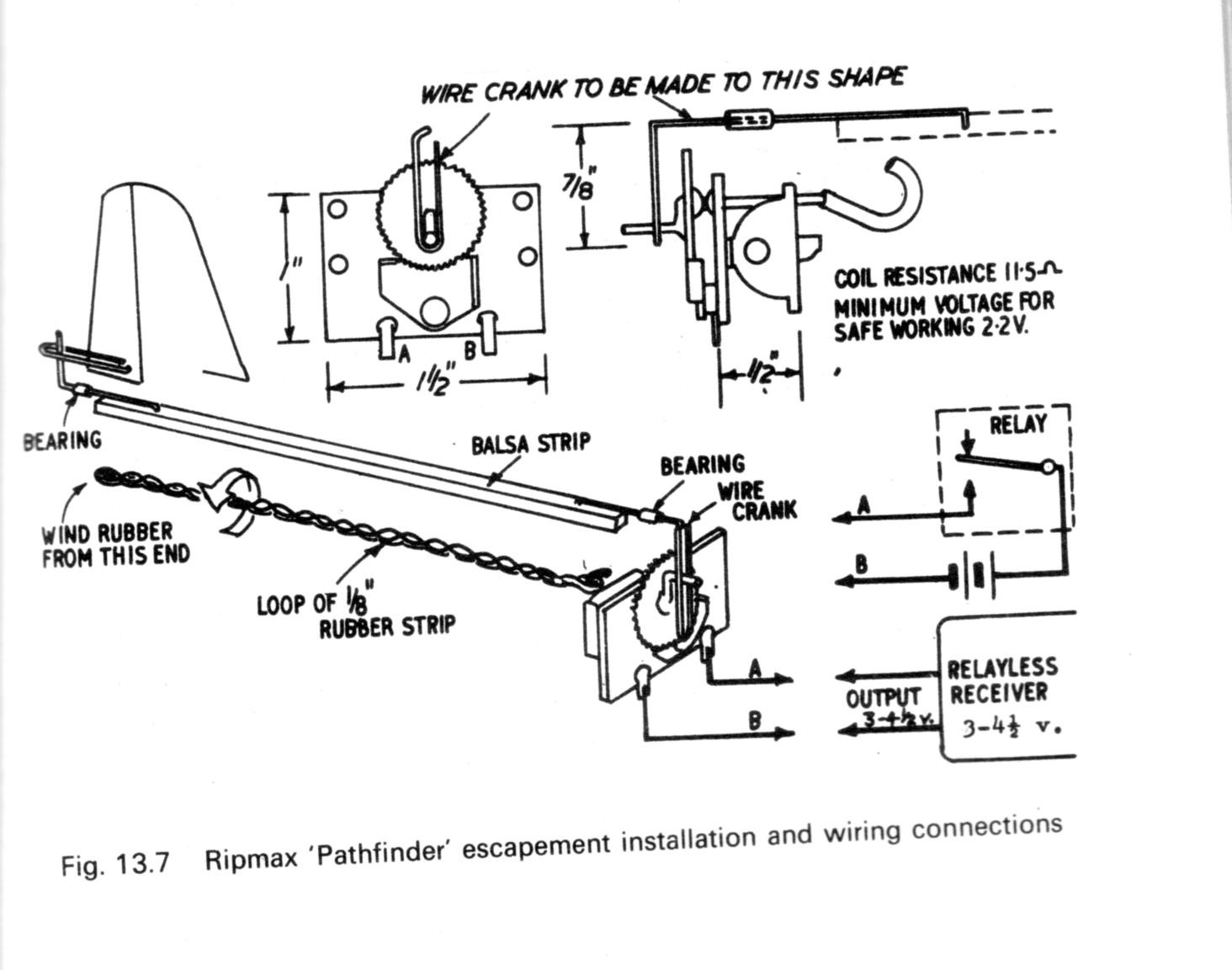

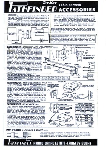

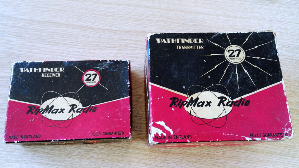

Here you go, some pictures of both the MK1 and MK2 versions of the Ripmax Pathfinder. The MK1 version is in my collection, the MK2 pictures were from one that sold on eBay a while back that somebody else won. But I have a Pathfinder MK2 in my collection if you need dimensions of either.

Brilliant Mike, Thanks very much. it's nice to see what it actually looked like.

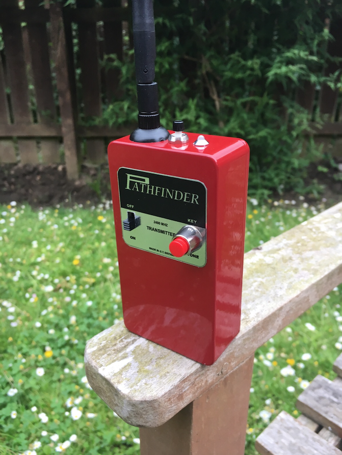

Ive made my own modernised version, It's my take on it, here you go...

Stunning Work Ron!
