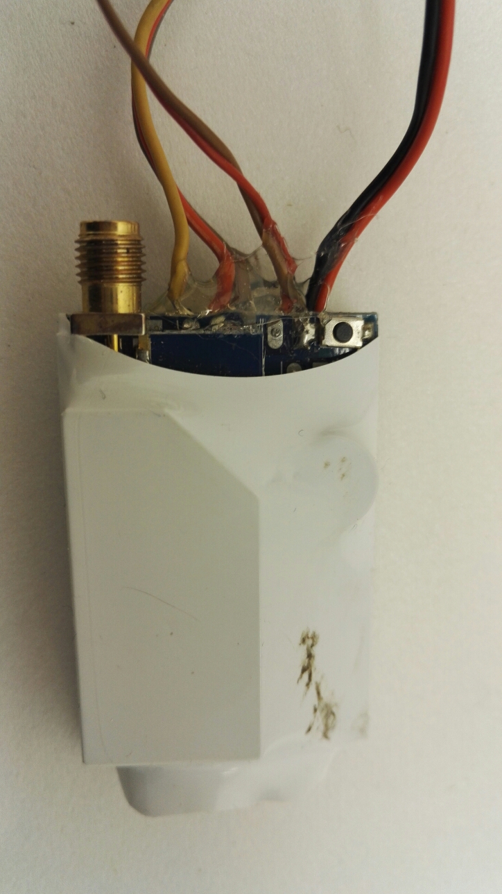

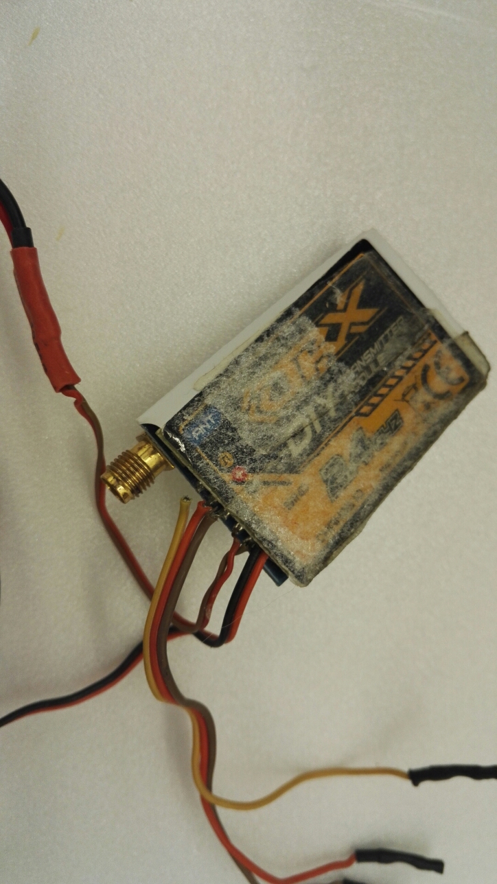

I had my first "failure" with an OrangeRx module in my converted Skyleader on Saturday. I was flying DLG gliders at the time and launched only to find the glider was at a very unusual attitude and not responding to my commands. Luckily I had set the failsafe to put the flaperons fully down and the elevator beyond the normal full up and it came down like a free flight glider with a de-thermaliser and no damage was done.
But what had gone wrong? I tried another model without success so it was obviously a transmitter fault. Back in the workshop I found that the ppm wire soldered onto the module had fatigued and broken off. Looking at the pcb, there was no support for the wires, relying on all the wires supporting each other (the wires are all tie-wrapped together). Both power leads were also badly frayed and about to break of as well. It was an easy job to strip back all the wires and re-solder them and to support them I've used hot melt glue .
So if you fly with an OrangeRx DIY, please check the wires coming off the module.

I always try to provide some strain relief for wires soldered to PCBs by covering the first few millimetres of wire and a bit of the PCB they're attached to, with hot glue from a hot glue gun. It doesn't look pretty but it adds reliability.
Hot glue is better for this than some glues which set rock hard. It's better for the support material to have a slight 'give' when it tapers down to the wire - you don't want a hard edge where the support ends or any vibration will eventually cause the wire to crack there.
Also, if you later need to replace the wire - perhaps after years of use - the hot glue can be peeled away leaving the PCB fairly clean for easy re-soldering: some other materials that can be used for wire support aren't as easy to remove.
