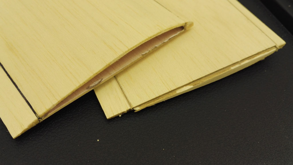

I've flown, crashed and repaired mine already!
I cheated a bit as I bought the iGull prototype from Neil, so only had a few minutes work to do. I hadn't got a suitable electric motor at the time so used my Cox TD .020 as per the original. I double sided taped the Rx and servo on the fuselage side and didn't bother with a fairing behind the engine (a mistake with hindsight - see later). I did recess the battery pack into the nose (a 4x 1/3AAA from my Alula glider). And I didn't cover it, just sprayed it with polyurethane varnish. Not pretty but it kept the weight down.
Shaun is spot on when he says it's really a powered glider. Actually I'd say a free flight glider with radio assistance, just enough to keep it in the field. I put about 30 seconds worth of fuel in, it climbs fairly fast under power then just glides down with lethargic rudder response.
After one evening session I got a bit bored with it, so modified it with a bigger rudder and and put some down thrust in so it didn't climb quite so steeply under power. That was far more fun. Later I tried spiralling it to get speed for a loop and it was too much for it, it suddenly had 90 degrees dihedral and it was coming down with the engine still flat out. Luckily not much damage as it came down in long grass, both dihedral braces had broken, the nose had a little split and I'd broken the prop. Five minutes with the razor saw had the old braces out and new 1/16" ply braces fitted (stronger than original and also the slot I'd cut was wider so had to be filled). A few seconds with the cyano had the nose fixed and it was ready again except I hadn't a spare 3-bladed prop. I've got some new ones now, but have to decide if I change it to electric so I can close the throttle if it goes pear shaped again.
Shaun suggested my wings were weaker than normal as I hadn't fitted the engine fairing on the wing, so that is a warning for everybody, build it like the plan... And it isn't really designed for looping.
I think there's potential to the model, both as a single channel model and as a multi with an elevator but with bigger control surfaces. I'm building a couple more from depron to test some ideas out, if they work I'll be on the phone to Neil for some laser cut balsa.
