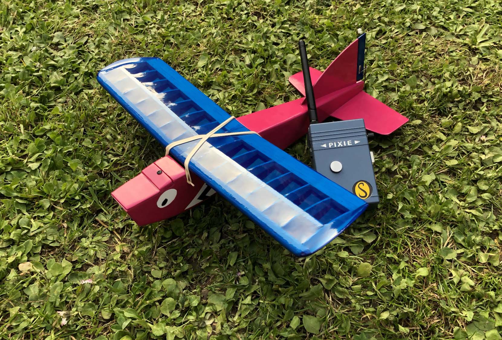

Just on with a micro size sharkface. 14” span
Scale is 65%

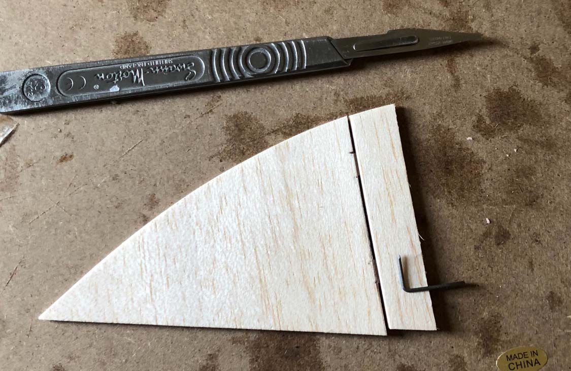

What do you recommend for the hinges? It’s on 16th balsa. Was thinking of solorfilm.

After practicing the hinging I decided to go fuzzy Mylar method. No splits after been very careful.

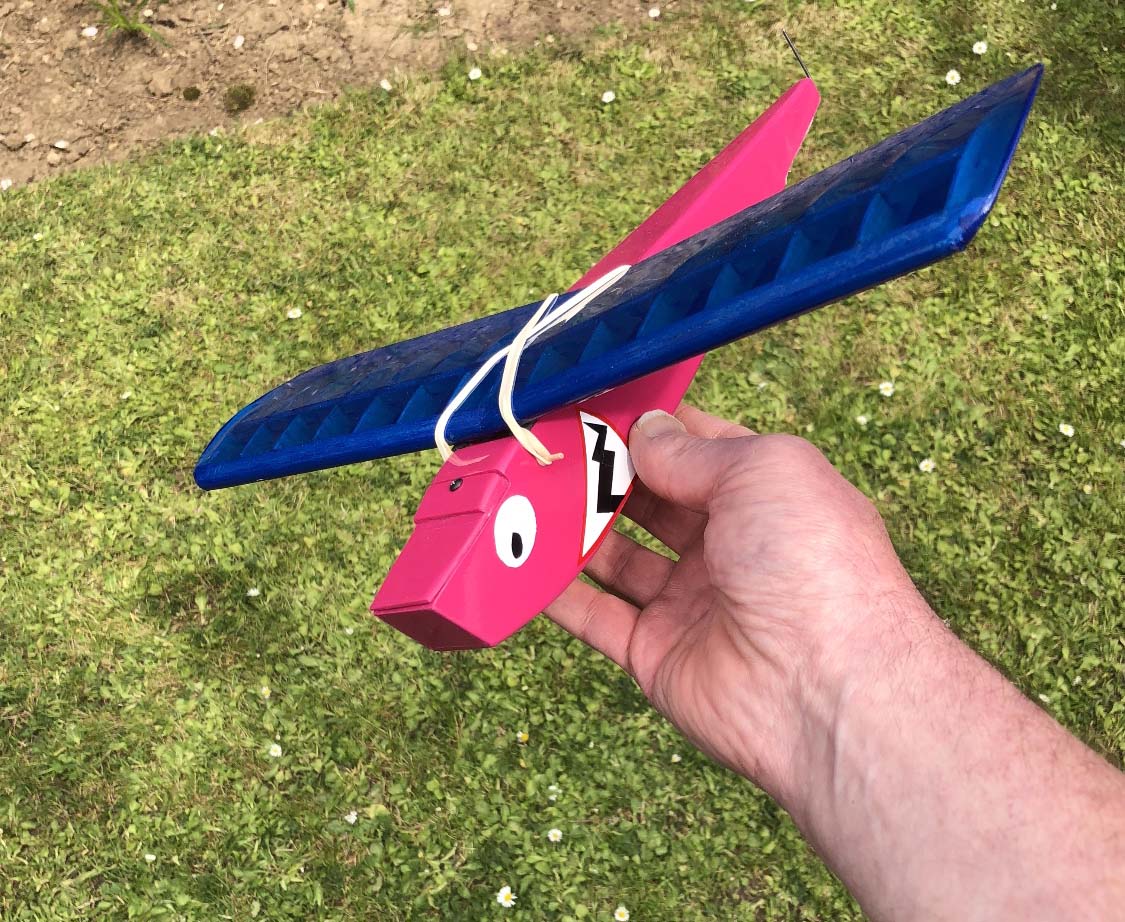

That’s it, it’s complete apart from a motor, which I need to source yet.
It should be interesting flying it if nothing else.
