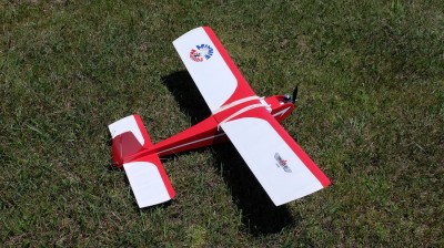

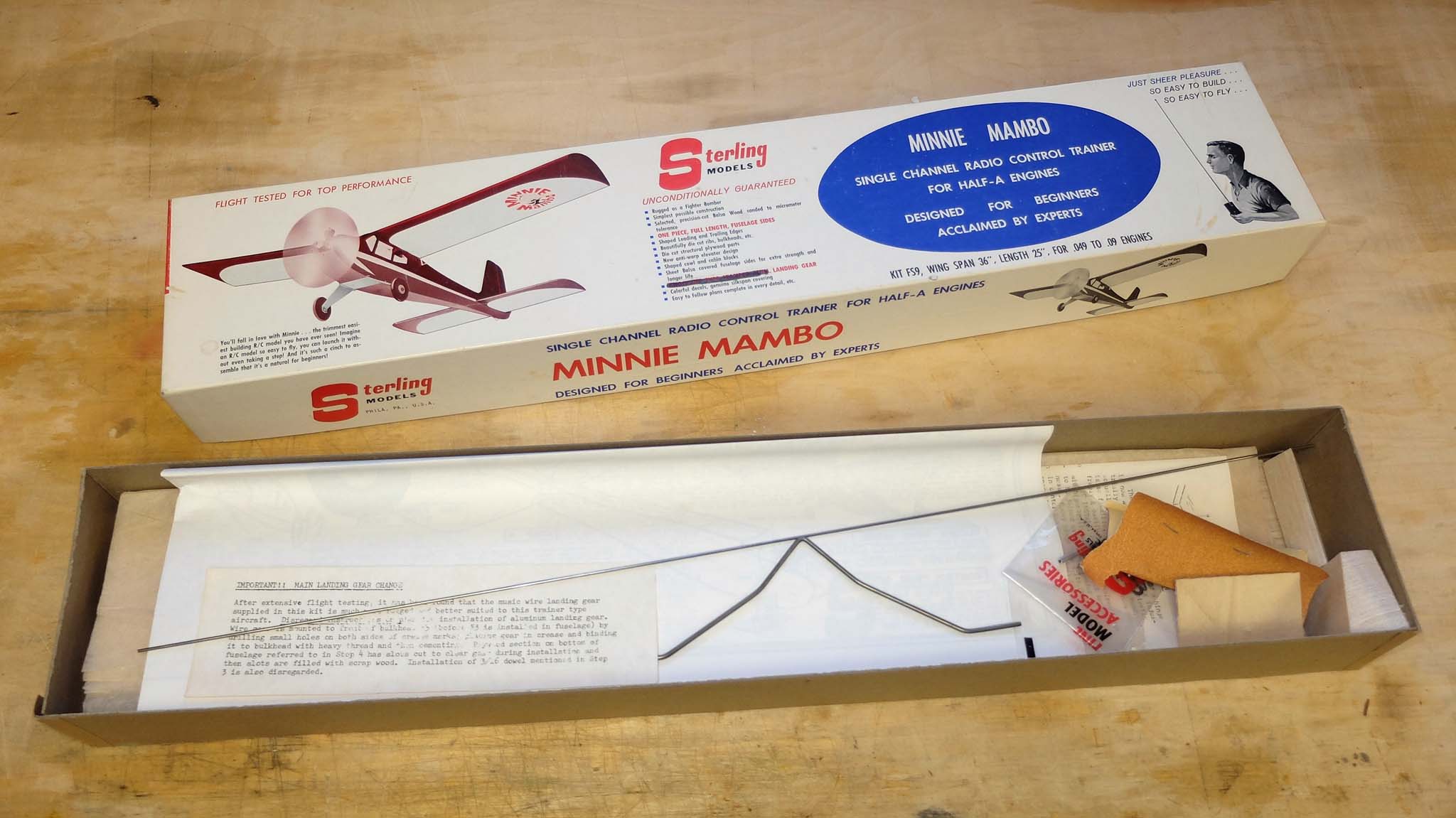

My first RC plane was a Sterling Mini Mambo equipped with a Cox .049, Controlaire 5 single channel receiver and an Elmic Commander escapement. I will never forget what a thrill it was to be able to actually steer the model back to the flying field and not have to run after it all of the time.
I came across a NIB kit of one 30 plus years ago at a swap meet intending on building and flying it. Better late than never I guess.

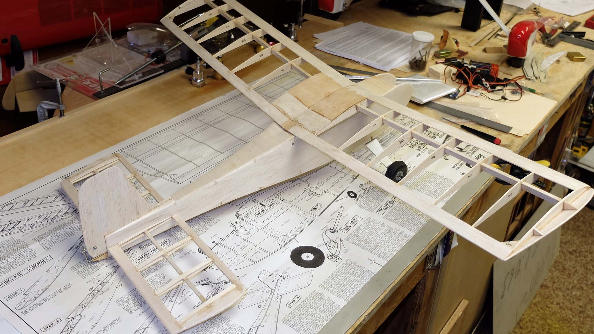

I built up the airframe over the past winter.

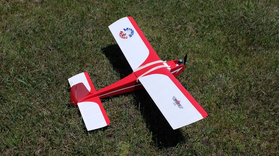

I covered the fuselage with "00" silk span and dope. The wings are covered in Coverite CoverLite a synthetic tissue like material. The package says "Made In England"
The entire plane received several coats of clear dope followed red & white dope.

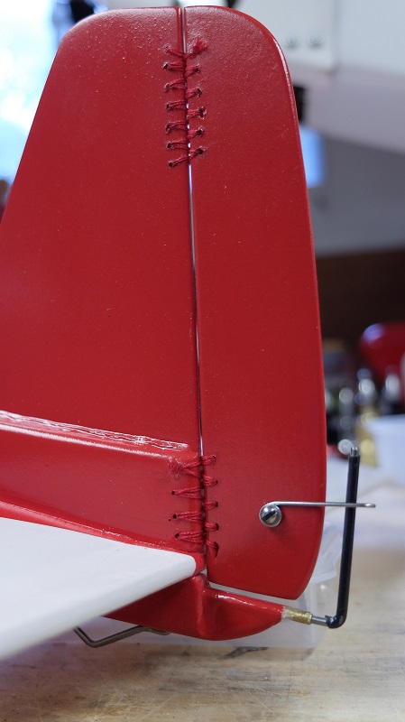

The rudder uses sewn hinges which are very strong and friction free. All up weight 17 ounces

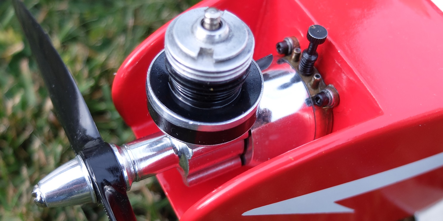

Power is a Cox .049 equipped with a muffler and an 8 cc fuel tank.
Sterling kit of a Mini Mambo

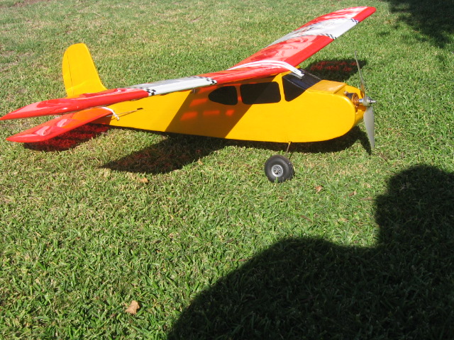

Hope you Mini flies as well as my electric powered full size Mambo built from Outerzone plans and patterns.
I tried a Tobe GG actuator but it didn't have enough "grunt" for my full sized Mambo. I installed two HS-55 servos and enlarged the added-on elevators and it is amazingly maneuverable, loves to thermal, great minutes per milliamp. Uses old Thunder Power .10 brushless motor and 2200 mah 3S lipo, stays airborne at 1/4 throttle, gets very lively on full throttle. Only problem is ground steering with only wire tail skid, need to blast model with full rudder to sorta steer it to return to the pits.
