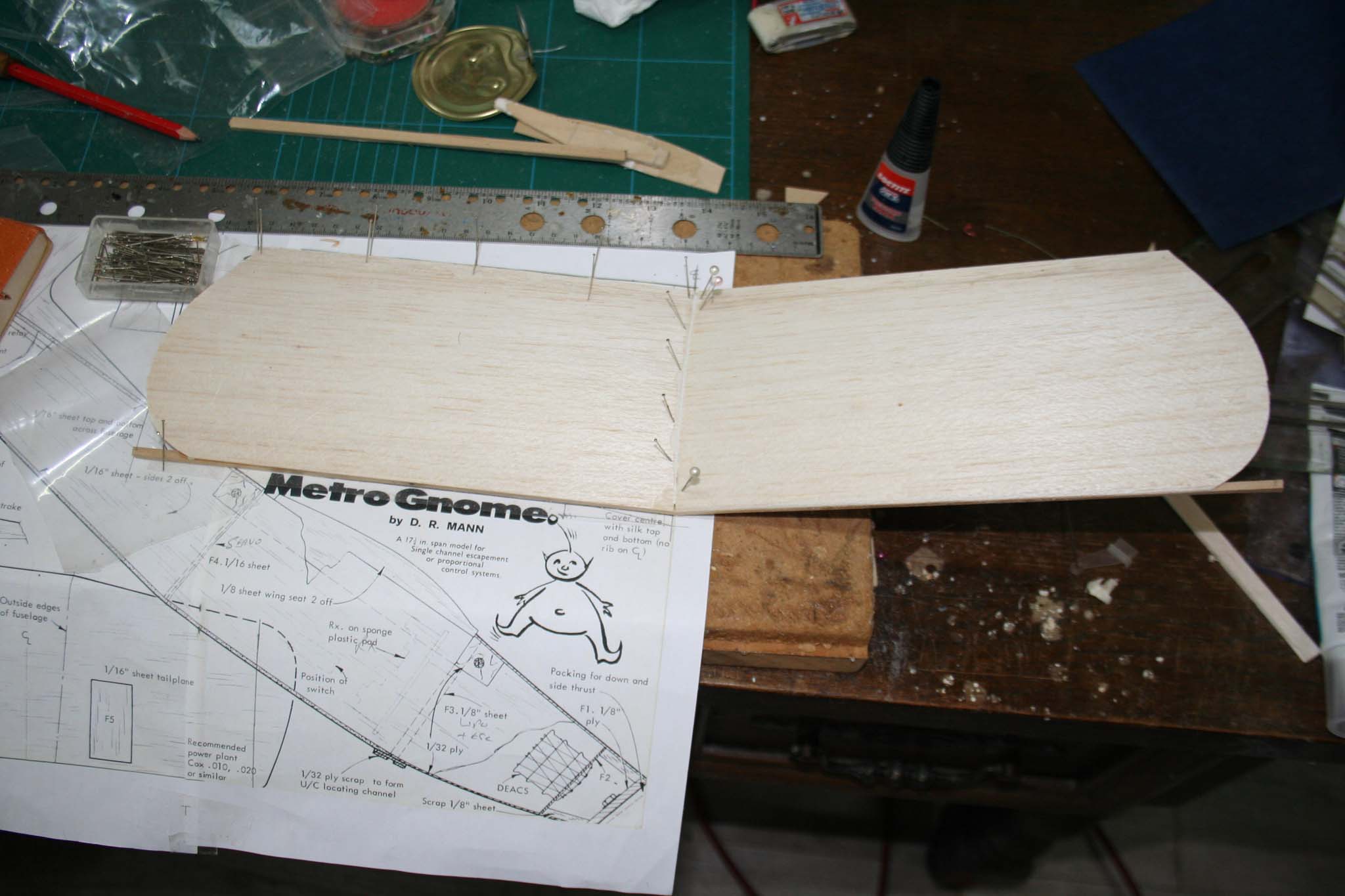

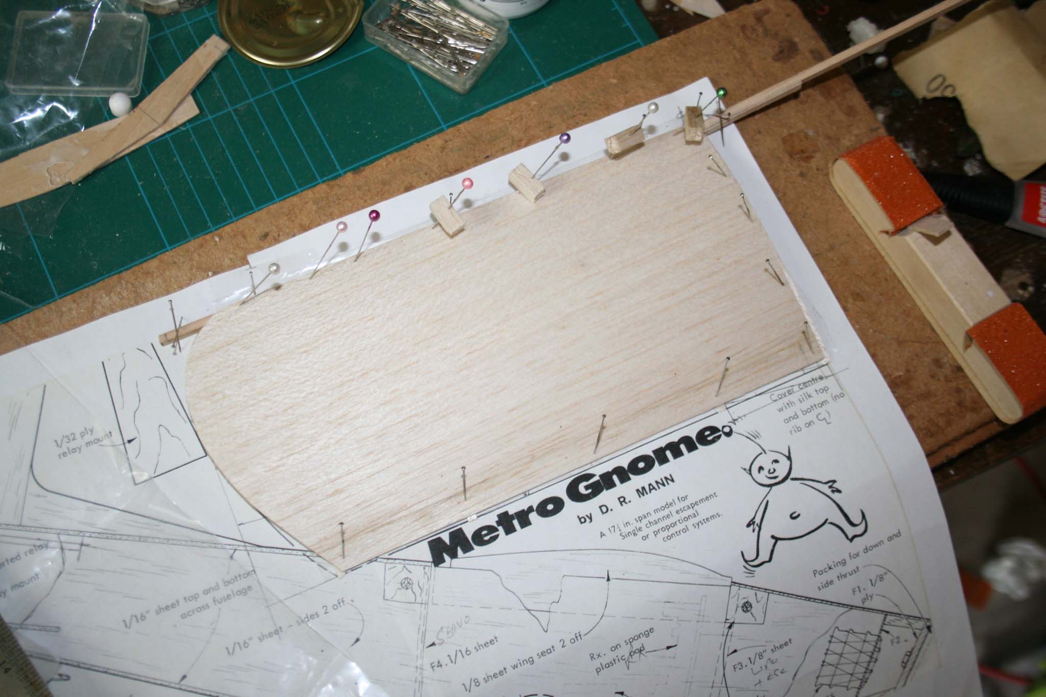

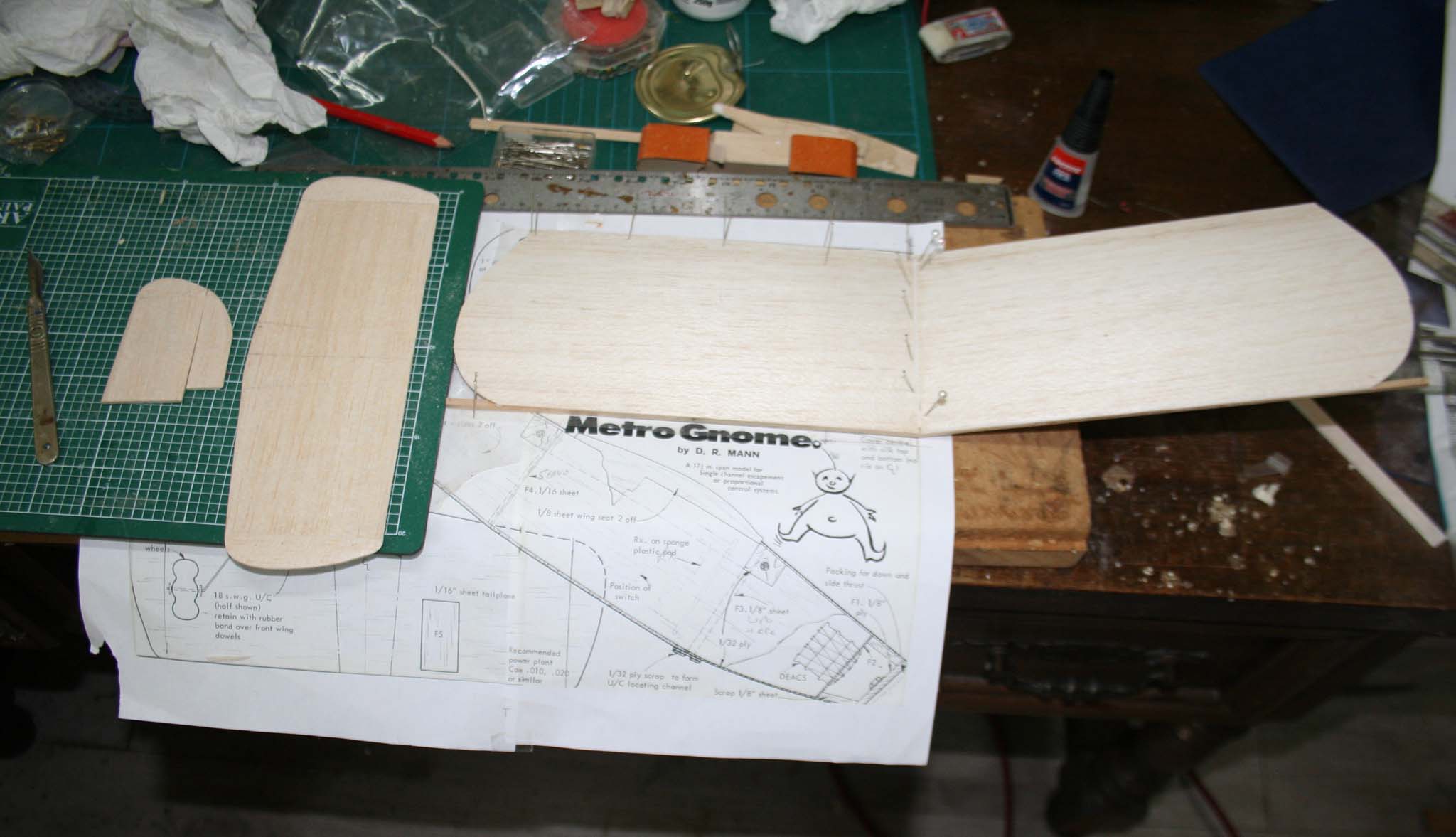

Thanks to the weather here (S-W France) blighting flying outings for the last few days with pretty well constant 20 knot winds which don't drop, as they usually do, in the evenings (well, not until it is too dark to fly) I have managed some workshop time and after a very few hours of effort have a complete set of flying surfaces. As is my habit I couldn't resist a few mods. I didn't fancy 1/16" tail surfaces and used instead some lovely light and stiff "C" grain 3/32" which was in the last delivery from Balsa Cabin, adding anti-warp tips. Apart from the ribs having flat bottoms to enable more secure pinning down the only mod to the wing was to pre-join the leading edge (1/8" x 3/16" spruce in my case not beech) with a 1/16" ply brace at the correct dihedral angle, although I did fudge this to 1.1/4 inches a side instead of 1 inch, which seemed a trifle minimalist to me. The wings were then built one panel at a time onto the leading edge. Oh yes, and I also used a centre rib as an aid to getting a better join.
Fuselage tomorrow. The only significant change I am planning here is to move the tailplane to the top of the fuselage and slot the fin into it. I dislike low mounted tailplanes, probably because I keep knocking the one on my Sharkface off, despite having RET control on this, it just lands too fast. I'll be using a vertically mounted servo with a torque rod, Orange 6 Rx and a 50 watt motor and 450 2S lipo. The wing and tail weigh nothing, so the finished thing should end up pretty light.

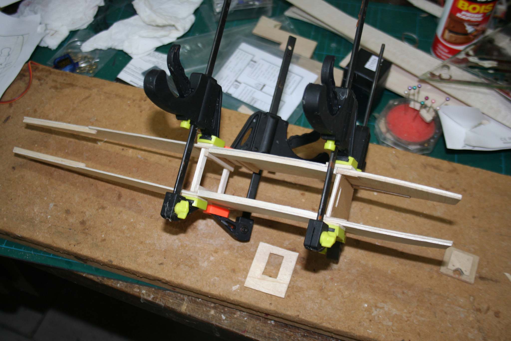

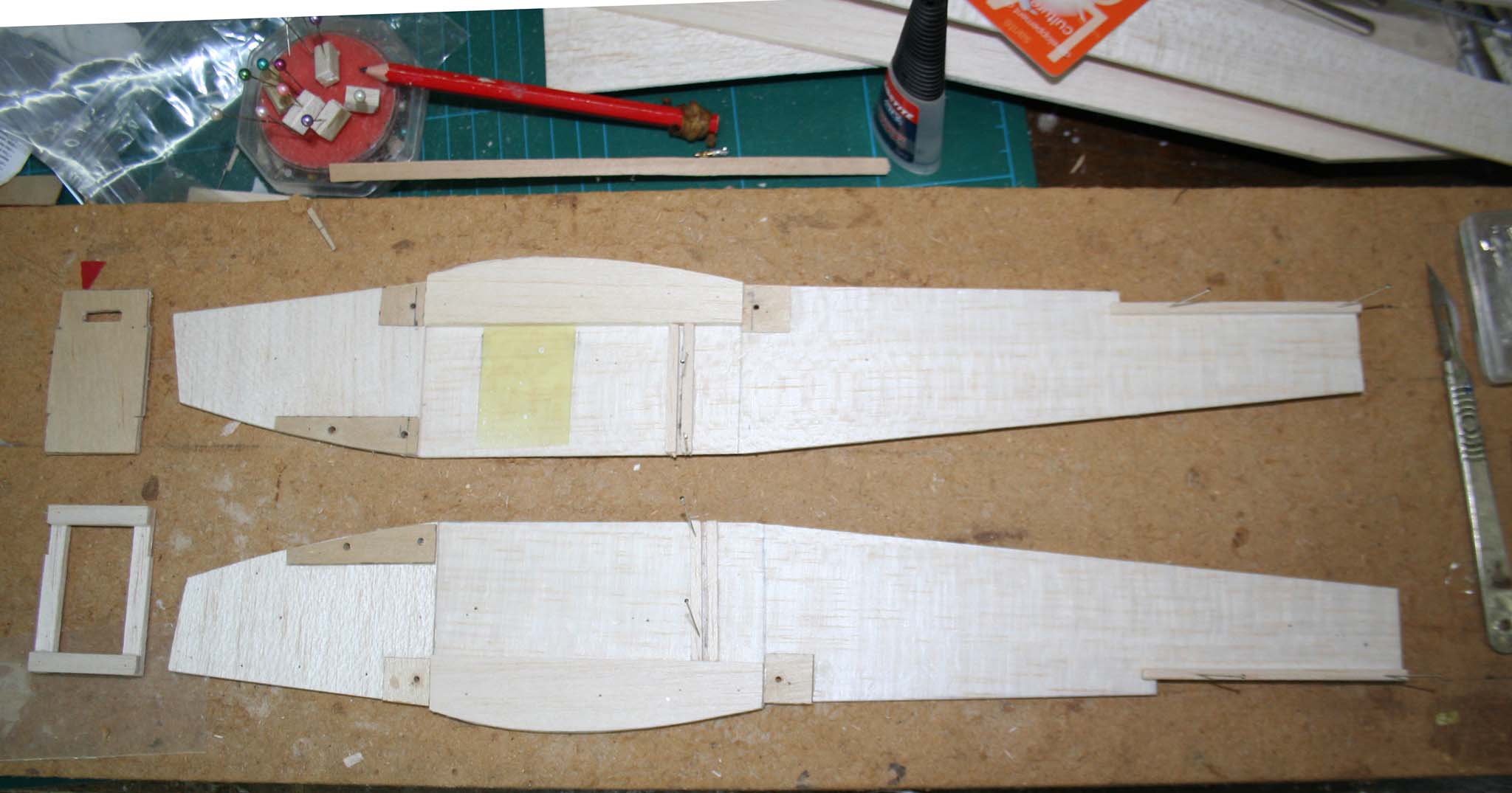

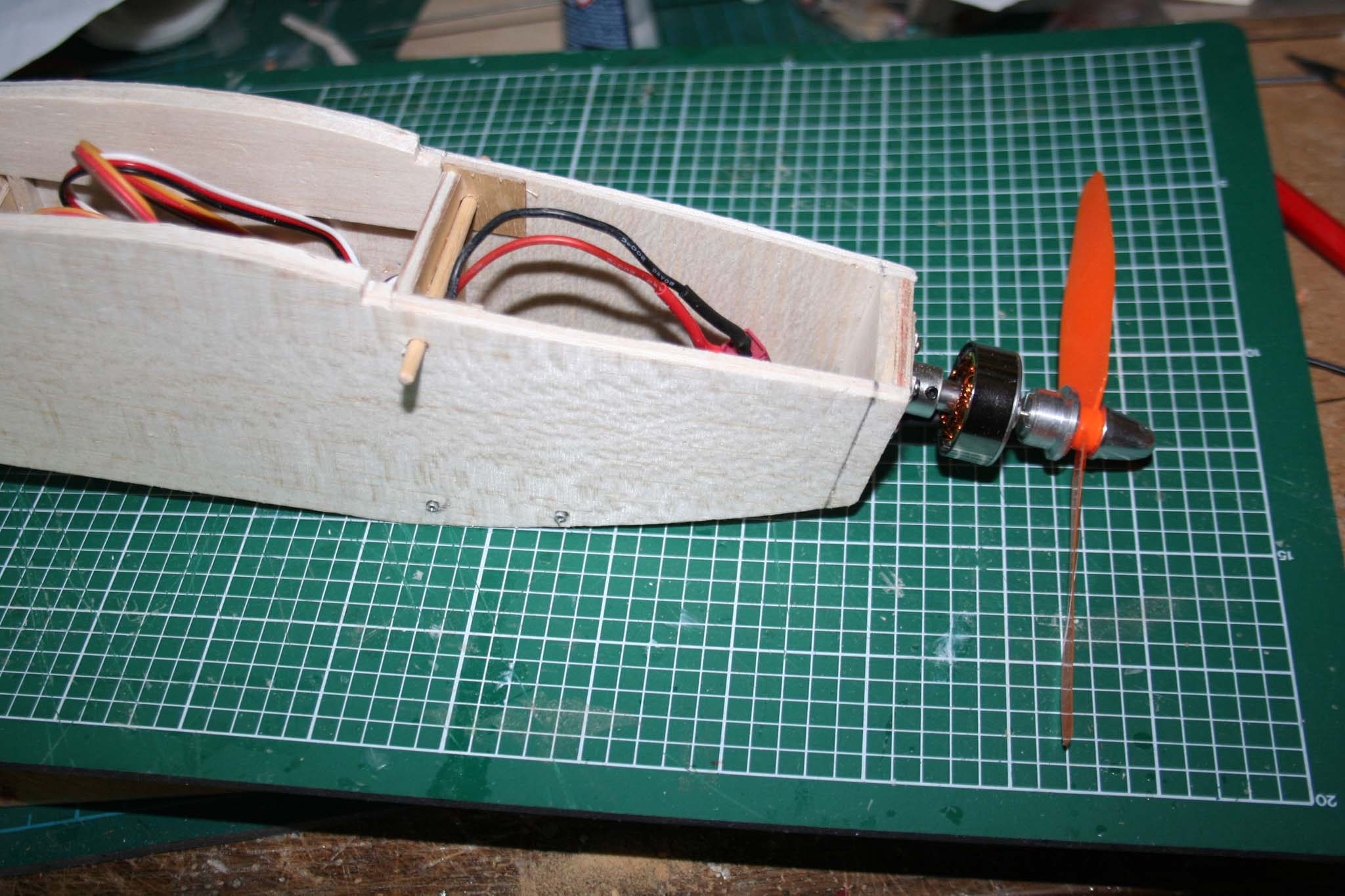

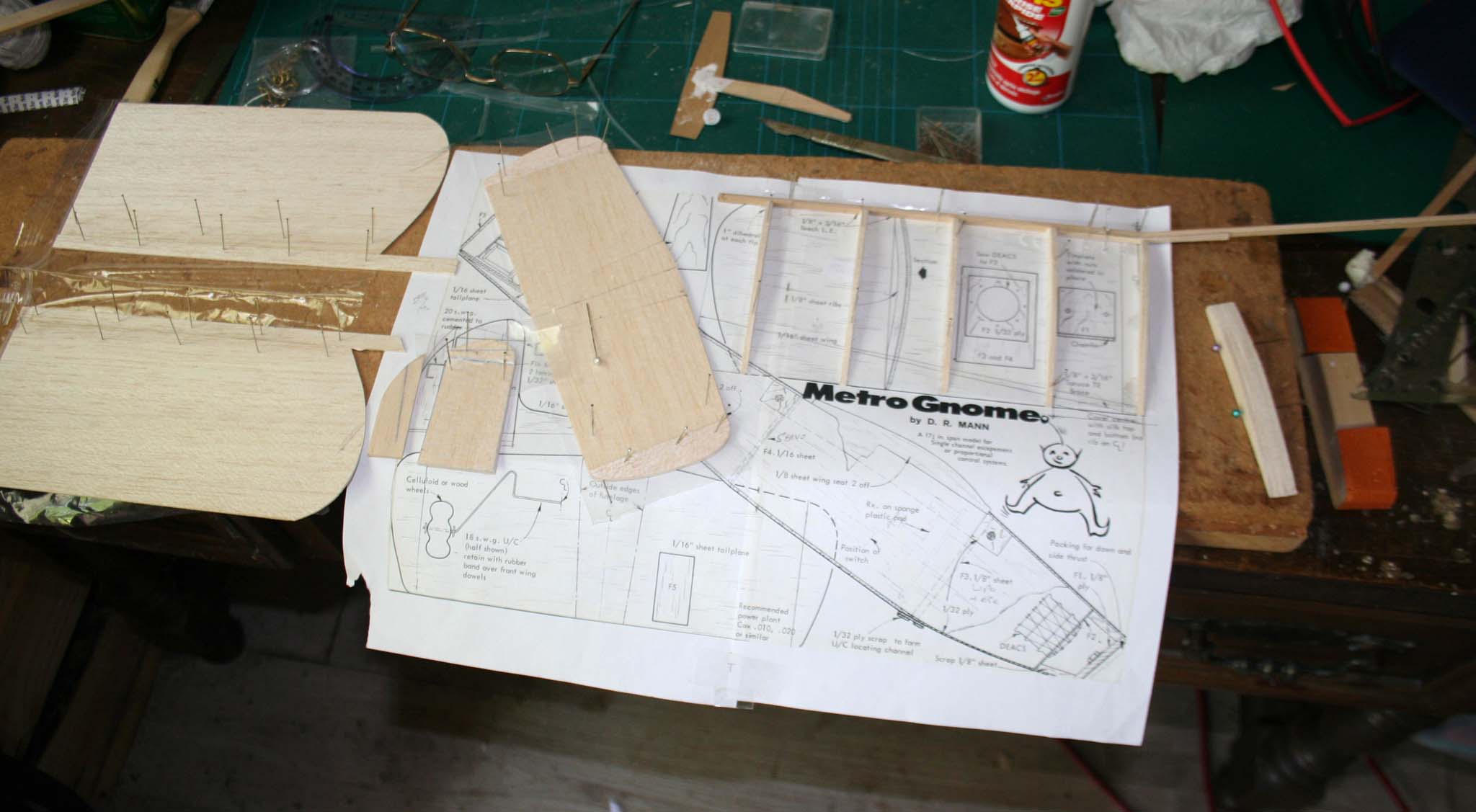

Further progress has seen the fuselage assembled and, yesterday, all the gear and the torque rod assembly installed. At this point three things became apparent;
First, after carefully testing and installing the servo, this promptly went u/s. $$**£$**& and similar expletives, as it was glued in. Nothing for it, some surgery later a replacement was in and this did work.
Secondly, on running up the little motor on a 2S 450 lipo and 5 x 3 GWS prop the amount of power at full throttle was clearly WAY in excess of that which a TD 010 or Pee-Wee would produce, if it weighed the expected 5 ounces we were looking at something north of 150 watts per pound, at which level it would almost certainly be an uncontrollable missile. I don't have a smaller prop to tame this, no problem when flying on the propo Tx, just keep off the loud pedal, but careful adjustment of the mid throttle position on the single button Tx would be needed, probably around the 40% mark and care will be required to make sure, when flying, that the next throttle command is "off" not "full"!
Thirdly, on roughly assembling the bits it became apparent that, even substituting a 320 lipo (the only space for the battery is in front of the wing), it was horrendously nose heavy. This is contrary to the usual case when building an IC model for electric. I had thought the nose looked a bit long but stuck to the plan, but with only the rear top and bottom sheeting to add behind the wing the CG is actually IN FRONT of the leading edge! So, short of adding a lump of lead to the back, which I definitely do not want to do, drastic action is required and when I go back in the workshop this afternoon the plan is to remove the firewall and hack at least an inch off the nose, leaving just enough space to get the ESC and 320 lipo in the nose bay.
So, to anyone deciding to build one for electric; either shorten the nose or rearrange things so the lipo can go under the wing, preferably behind the CG position. And use a motor you can prop down to 20 watts or so.

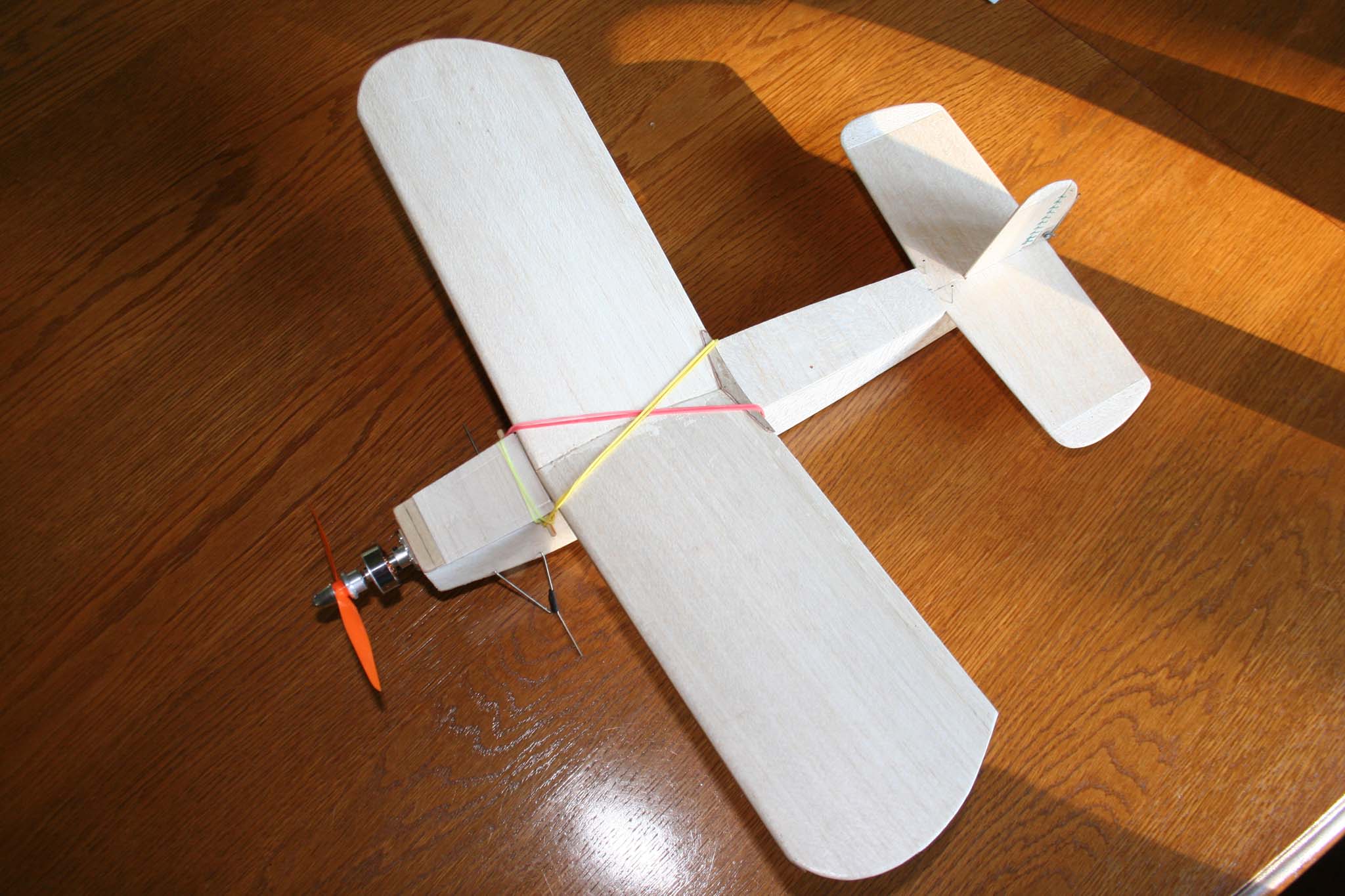

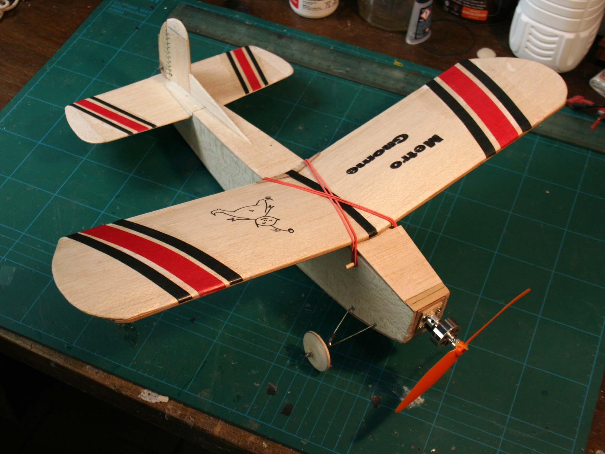

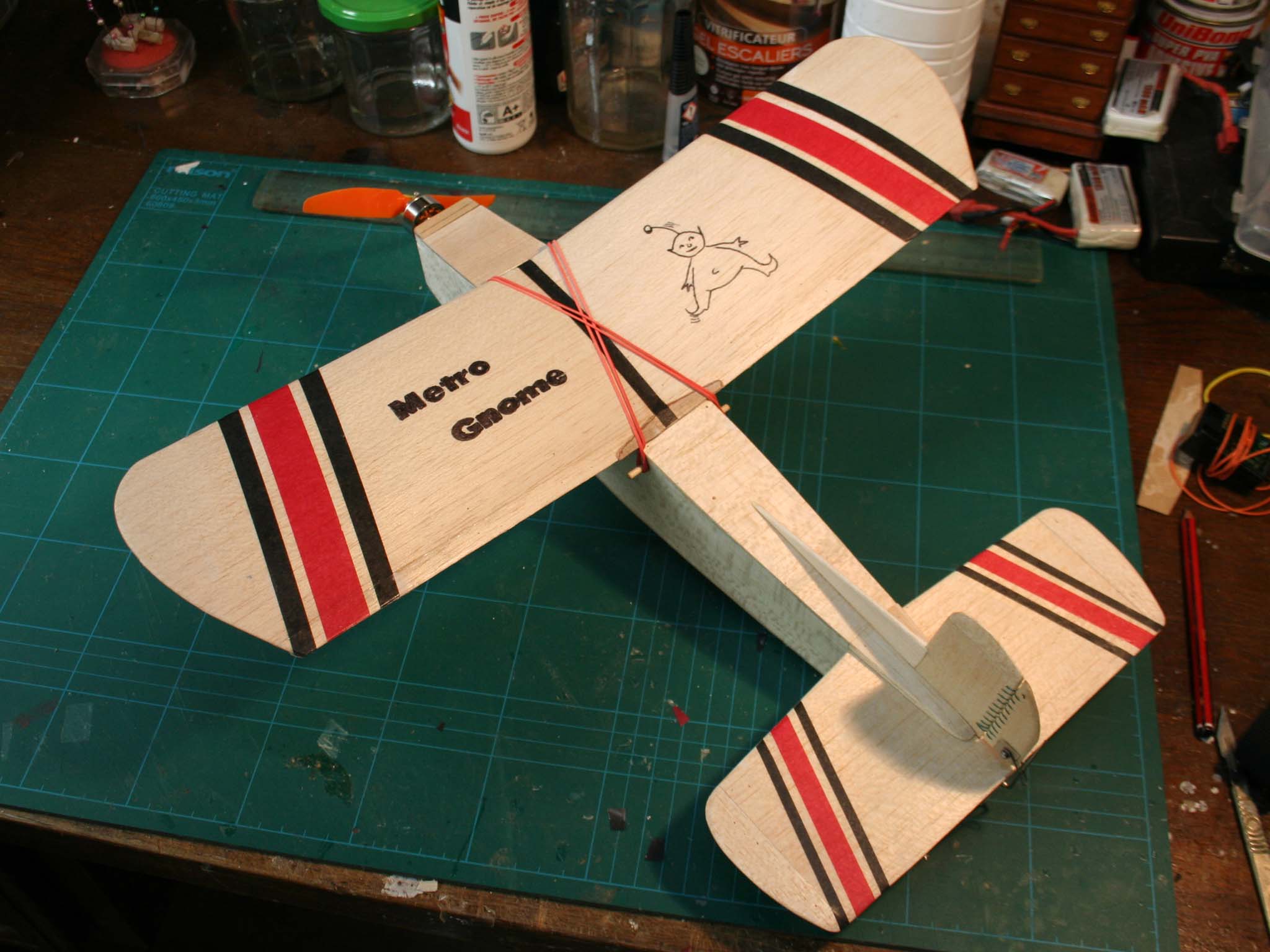

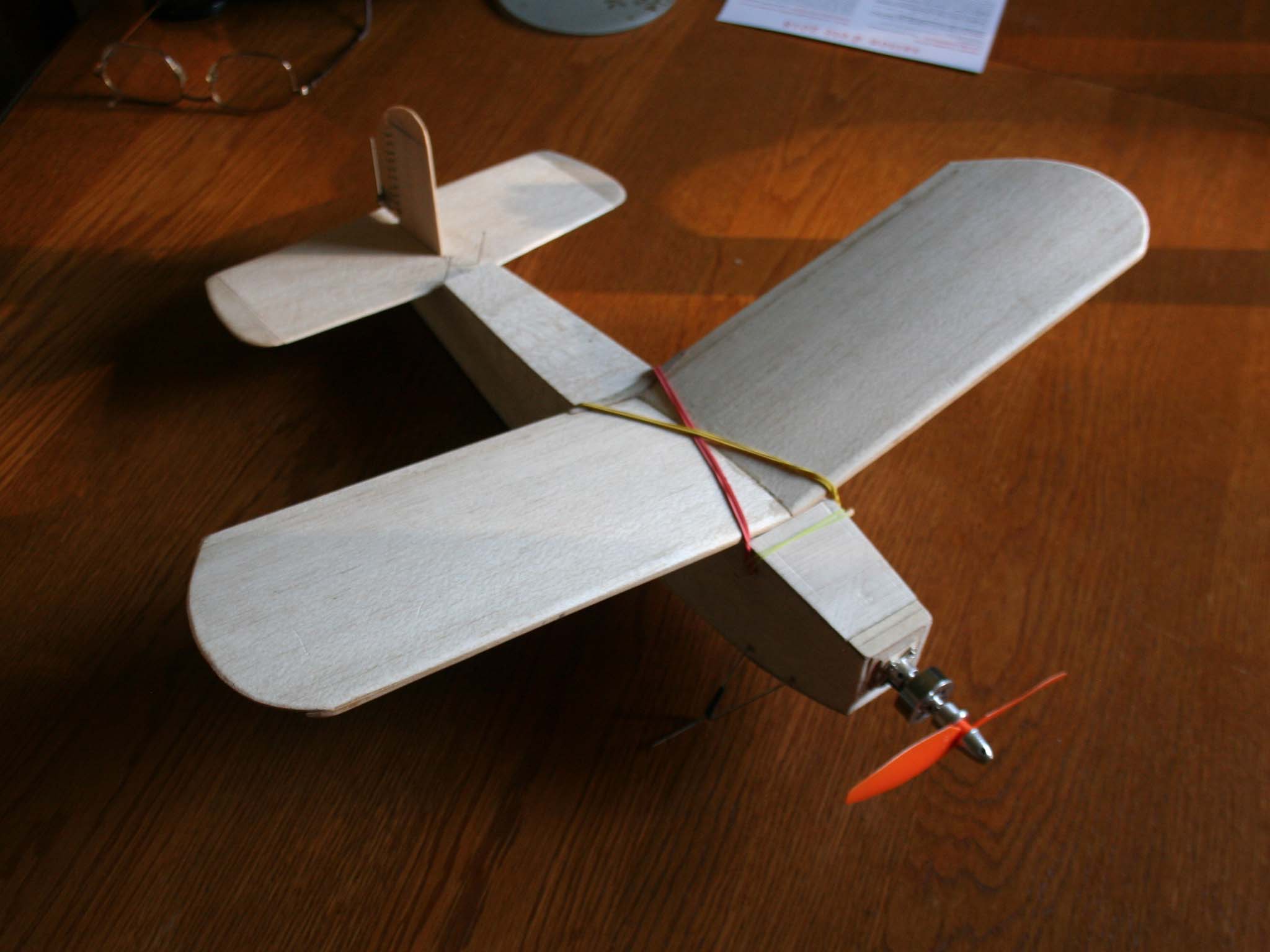

Re: Metro Gnome

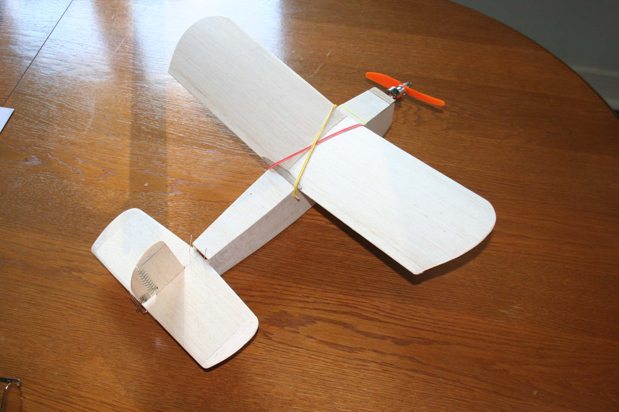

Completed the "nose job" and changed the 320 lipo for 220 30C type and the CG is now around 25% - still a bit forward for my taste but as the model, complete except for light balsa wheels, some tissue trim and a fin strake and tailplane fairing comes in at 122 grams - less than 4.1/2 ounces - it won't hurt to add a few grams of lead at the back if necessary.
The second photo shows the long nose prior to the "nosectomy" the others are of the model as it is tonight prior to the little finishing jobs
