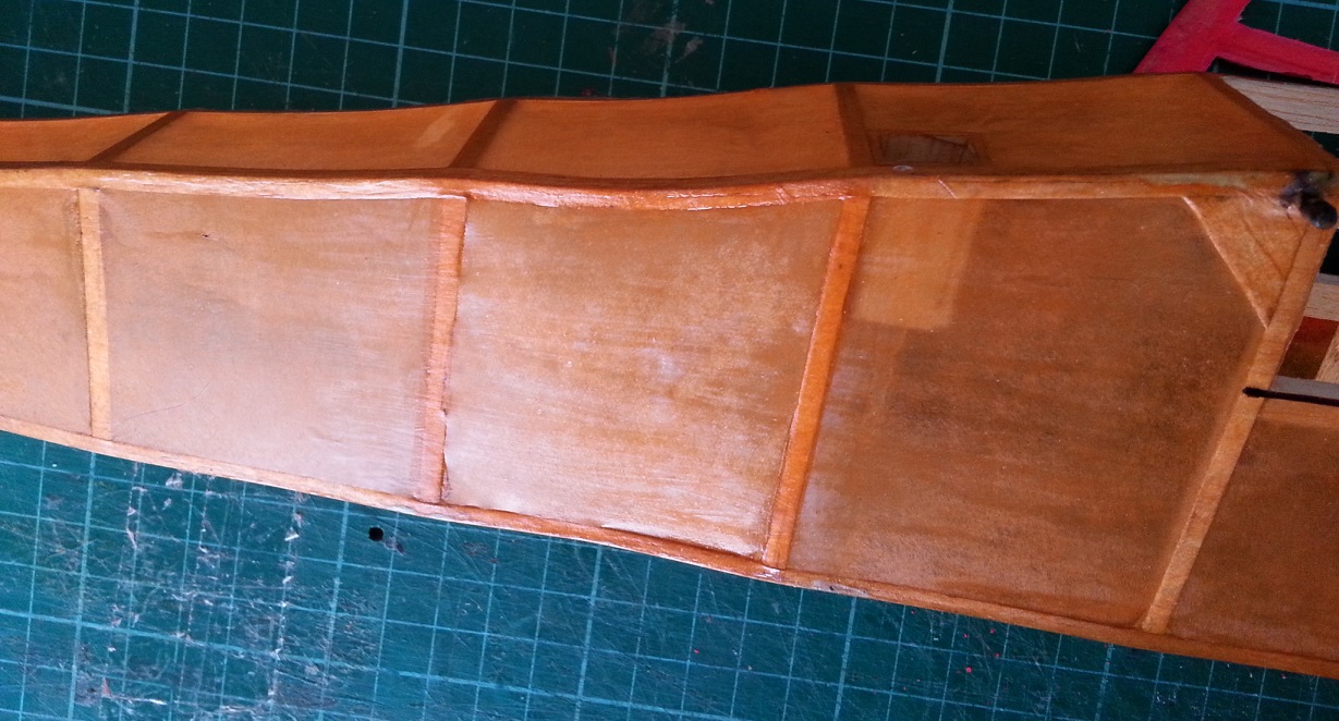

The wing:

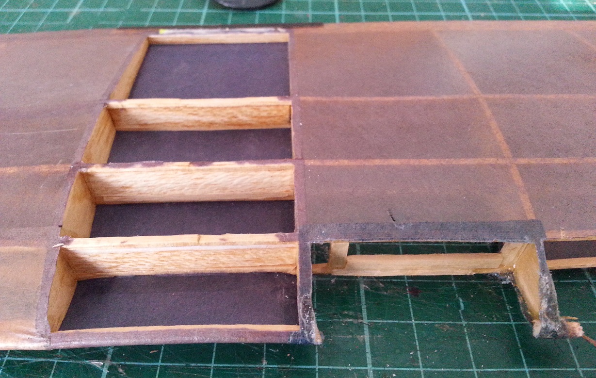

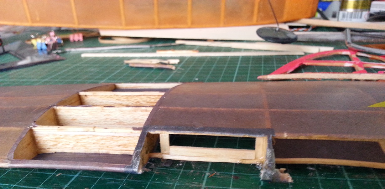

  • The spars (1/16" sq.) were all broken in the centre bay, probably due to this being where the wing bands passed over the wing, combined with compressive loads from flying and/or knocks to the wing tips. The spars were straightened and reinforced with 1/16" sheet webs. Light weight transverse sheeting will be added to better distribute forces from the rubber bands to the wing ribs.
  • The centre panel of the wing has a warp in it, so is strapped to a flat rigid board while repairs are underway. The 1/8" sq. L.E. had multiple repairs on one inboard panel, so it is currently being replaced.

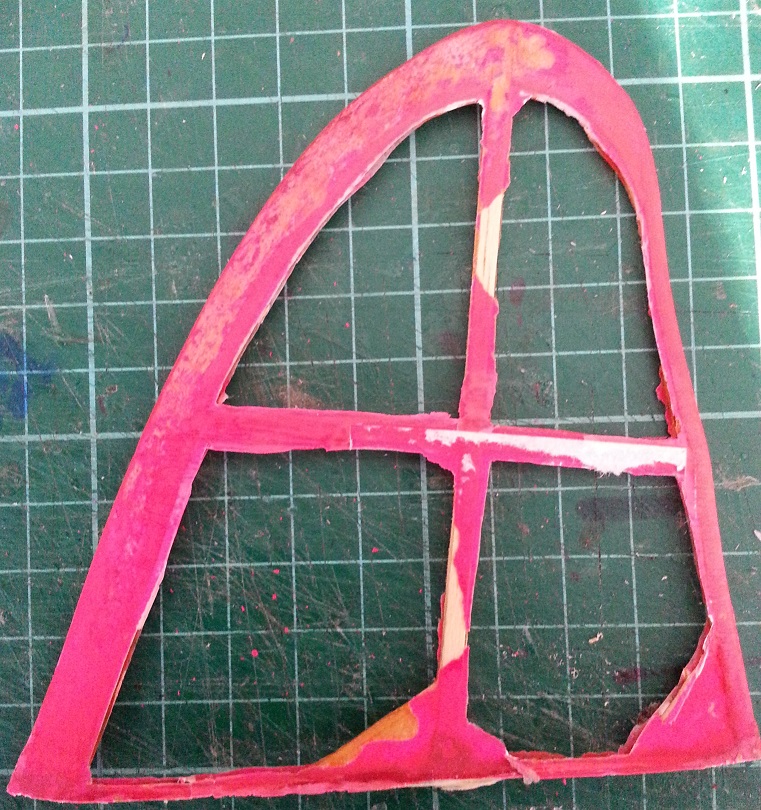

  • The 'propeller'(?) like fin has been removed, to be replaced with a new straight version which includes a rudder (of course).
destined for the bin!

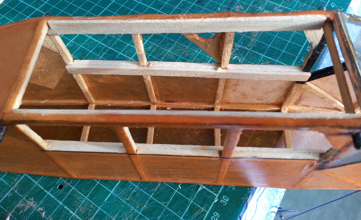

  • The cross pieces and associated tissue covering on top of the fuse at the wing mount have been removed to allow access to the radio installation. The top longerons have been reinforced with a 1/16" x 3/8" doubler.

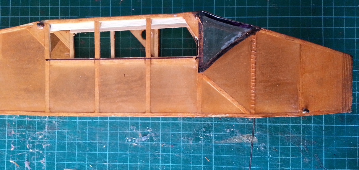

  • The "cabin" has been extended to the rear of the wing using 1/8"sq. longitudinal inserts backed by another 1/16" x 3/8" doubler. Thin clear plastic has then been glued on as the side cabin "windows".

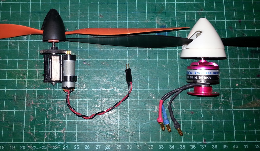

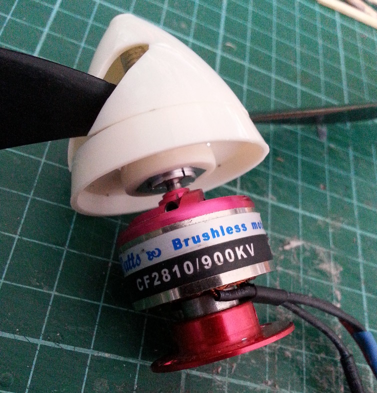

  • The only low KV motor I have is really too big & powerful, but I'll utilise it in the absence of anything else :x It does fit inside the nose just 8-)
    more than enough power, but a low cell count and smaller prop should tame it.
    Power will be a 2 cell pack

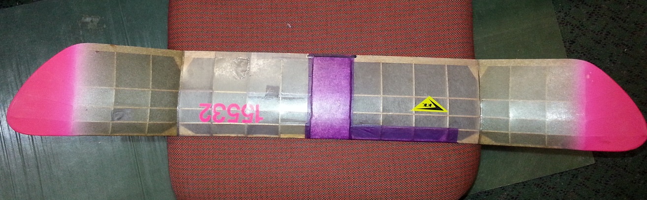

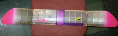

The Wing repairs have been completed & the warp successfully removed. As I said in the previous post, my coloured tissue and dope are as still hiding in the 'undiscovered country'. Consequently, I've had to resort to off-cuts of coloured tissue from the florist/gift-shop (yes, it was expensive tissue!) and hair spray from the $2 shop instead of dope. Amazingly, it all worked surprisingly well - I even managed to match the brittleness of the original old tissue.... :o
I expect the purple tissue to fade quickly...

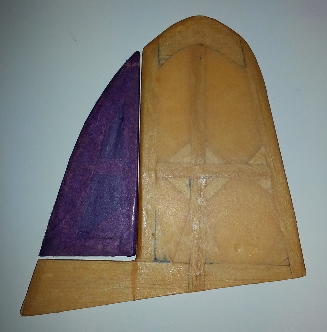

A new fin & rudder have been built & covered. The rudder needs to be hinged & the assembly glued back onto the fuselage.
rudder yet to be hinged

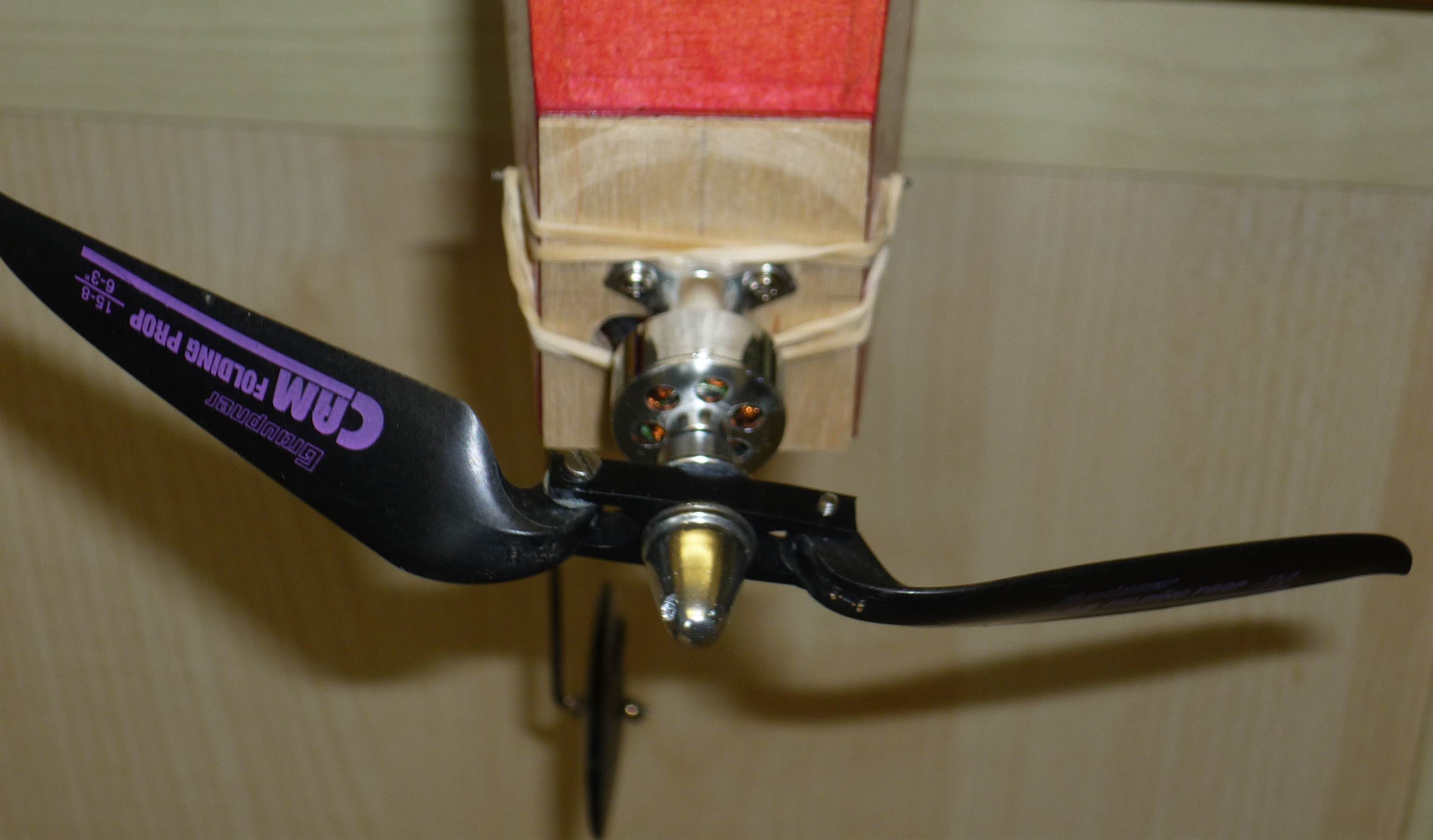

  • I re-visited the motor option & decided to re-task the GWS drive from my GG actuator experiments back into a propulsion system. The previous motor+prop option weighed 68g with spinner while the GWS unit weighs 38g with prop & spinner.
The old  GWS unit ( brushed motor) on the left is the chosen propulsion unit.

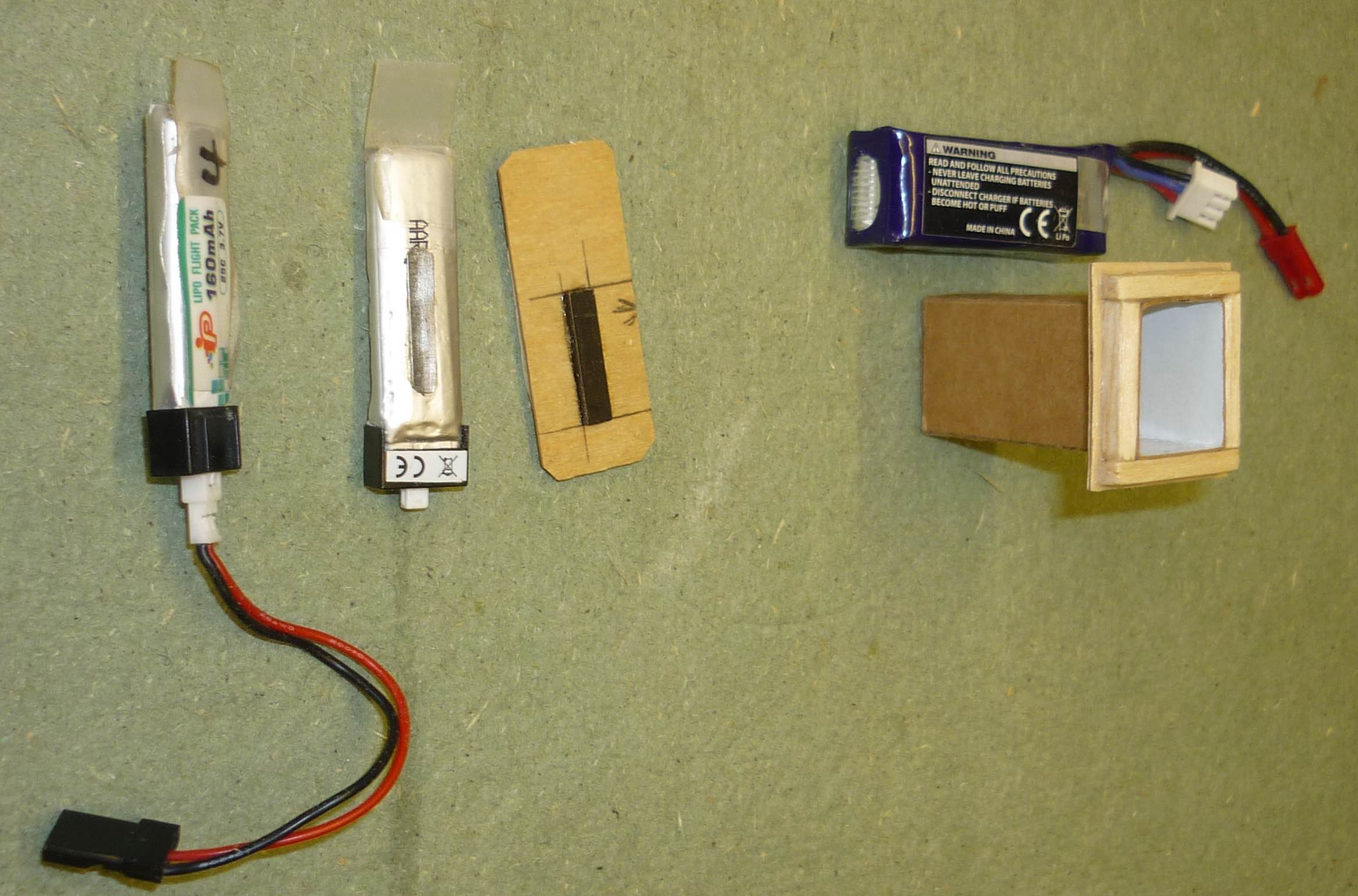

  • I have a choice of either a 2S 610mah 20C (39g) or a 2S 500mah 35C (31g) battery. I'll probably try both, with the 610 mah for breezy conditions & the 500mah pack for calmer conditions.
  • AUW should come in about 145-150g.

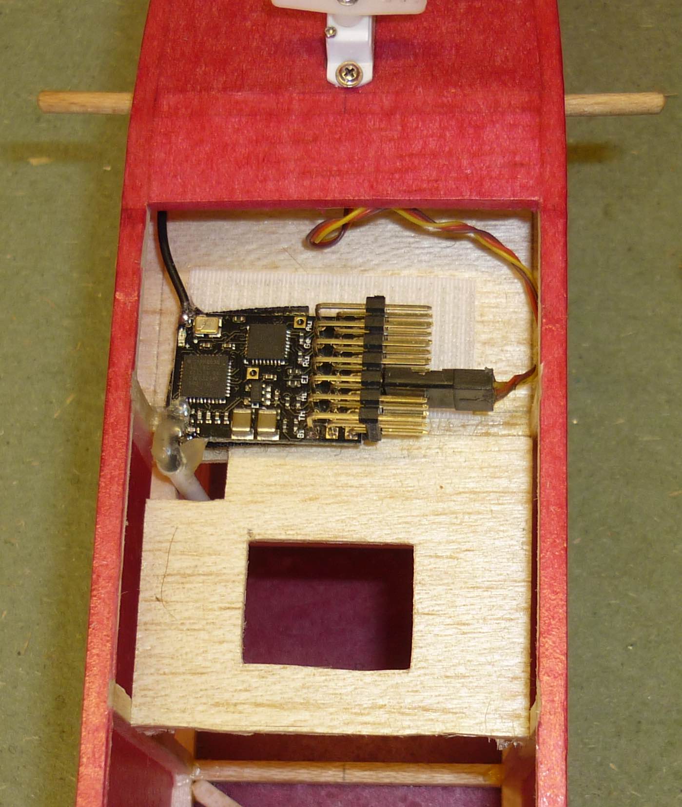

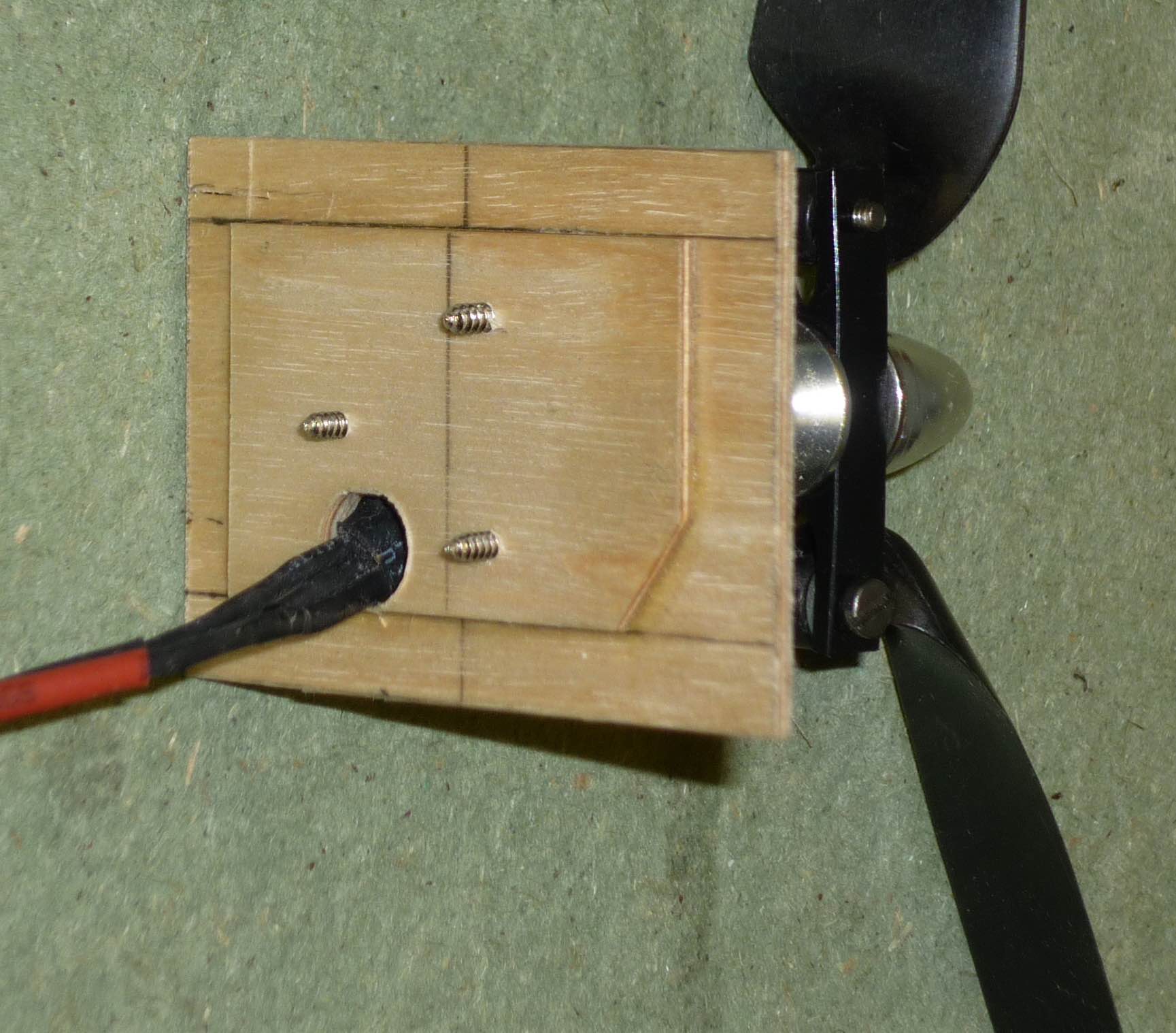

I can change back to rubber relatively easily, as I still have the original nose block & free wheeling prop. The GWS propulsion unit slides into the nose, retained by 4 screws. The Rx, servo & ESC are on rails above the line of the rubber motor.

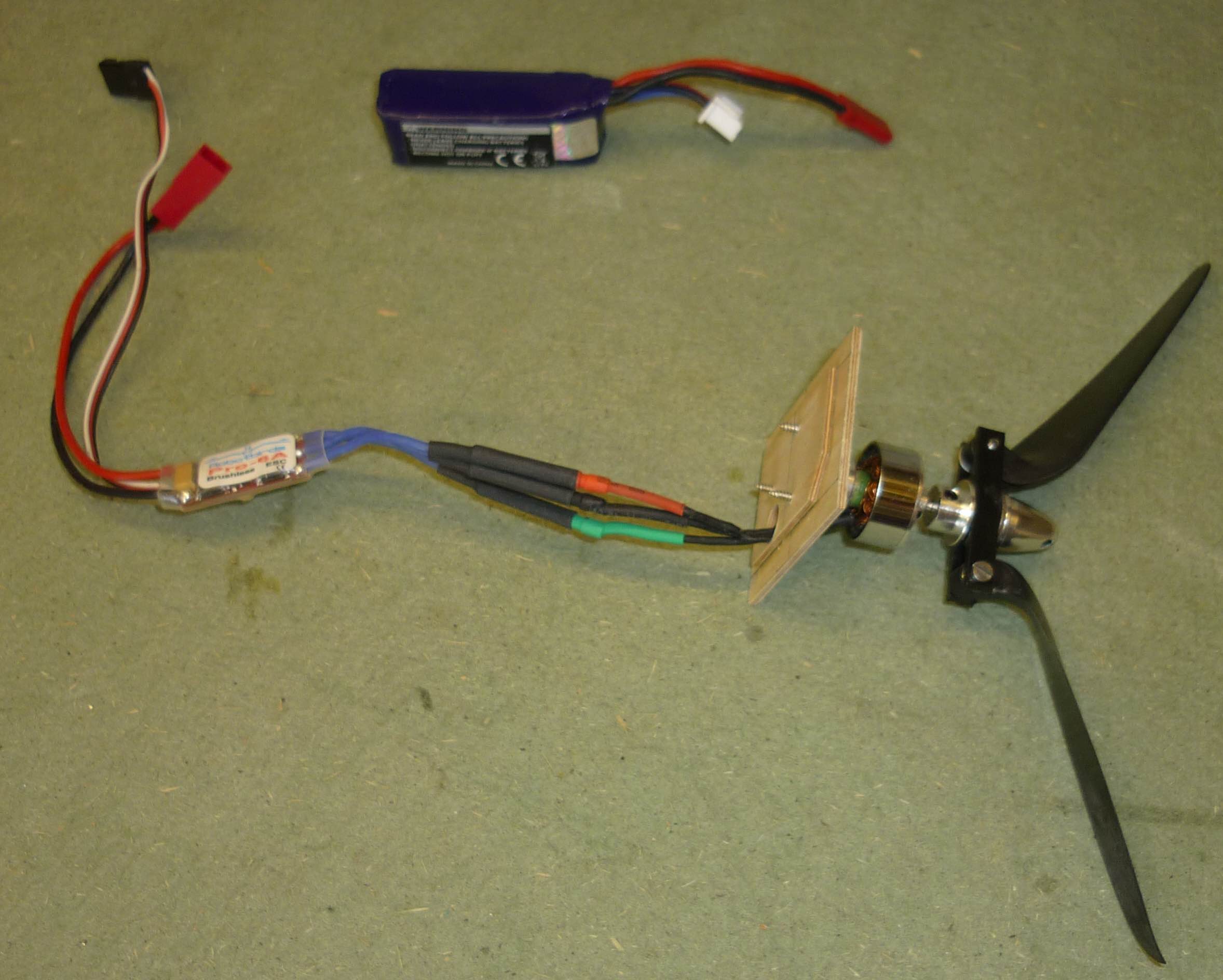

Just measured the Balance Point and it's 54mm behind the wing L/E. No alteration to the tailplane angle.
Weight in EP mode 124grams. I've posted a few photos that might be interesting.
Incidentally, the LiPo I use is a HK 2S 300MAh type; can't remember what the motor is, except that it it's about 2200K and cheap. It drives an Aeronaut 6" x 3" folder. I dare not give it a full can of beans - far too powerful!
To re-iterate an earlier comment, the Senator is a potent thermal-sniffer; I wouldn't risk flying it in any mode without a Dethermaliser.
Hope this helps
David
