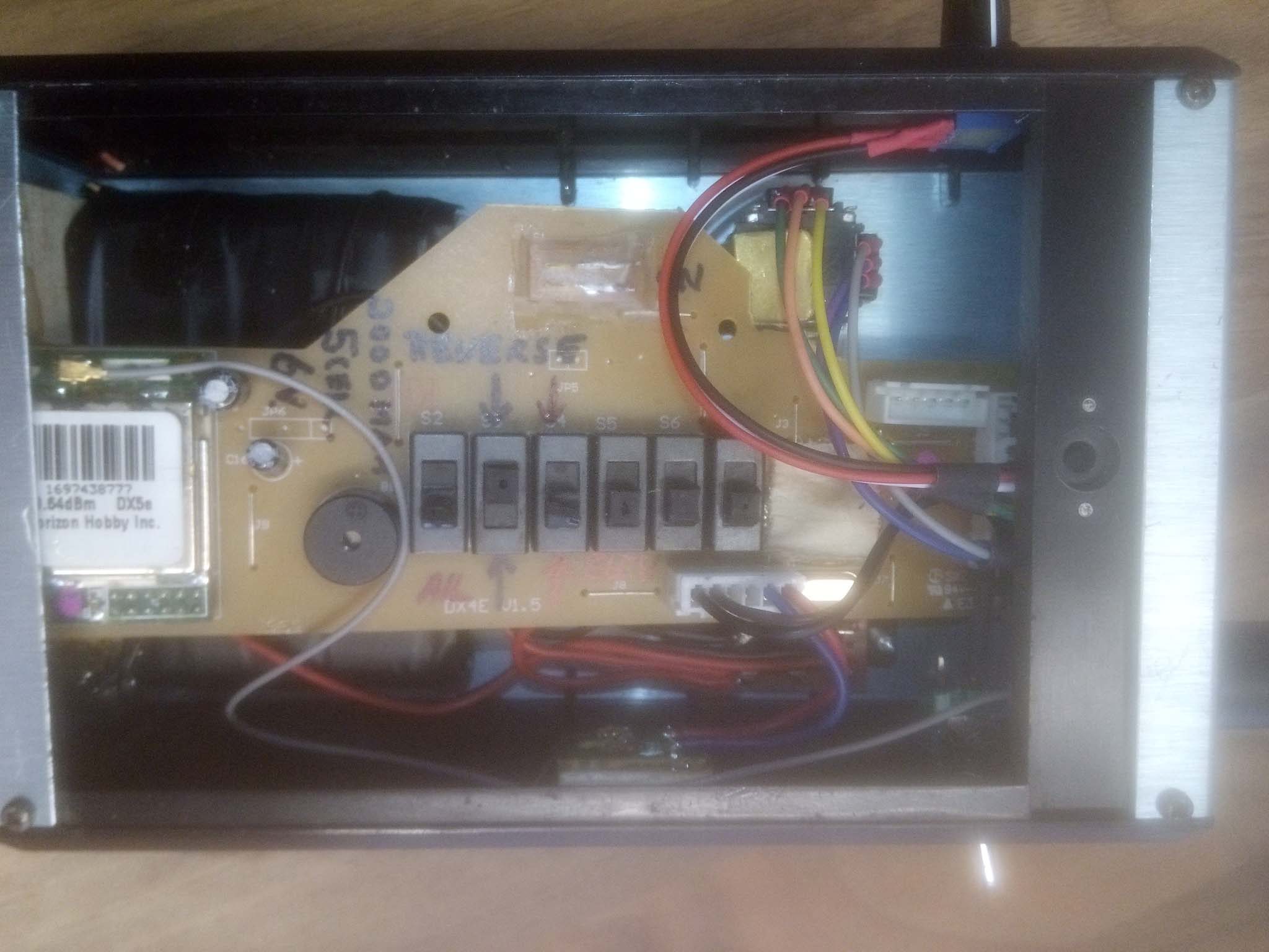

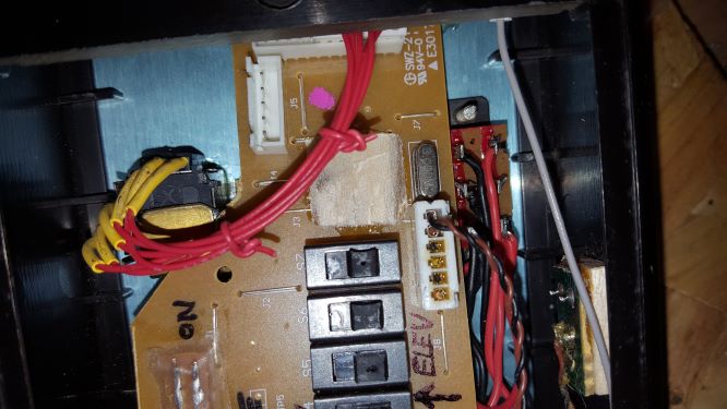

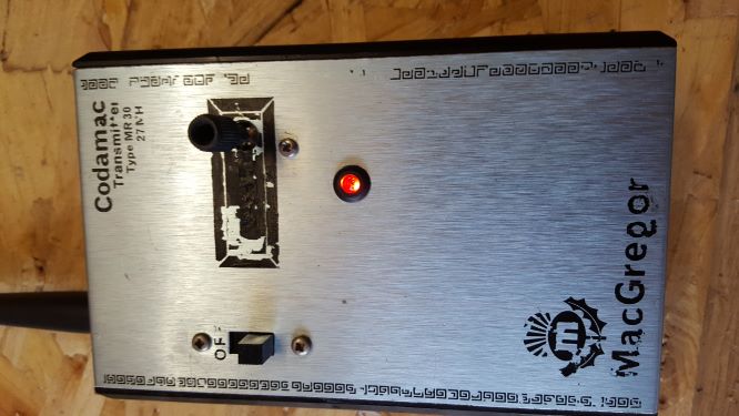

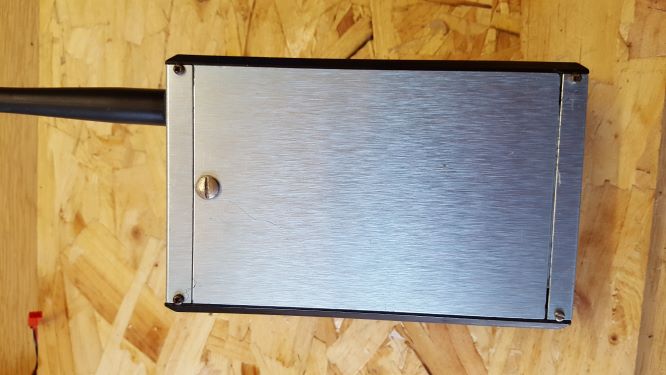

This is how I got the unit

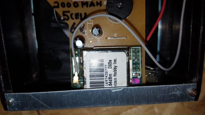

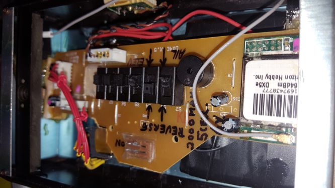

Re: Macgregor 2ch, conversion to 3ch?

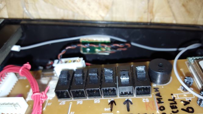

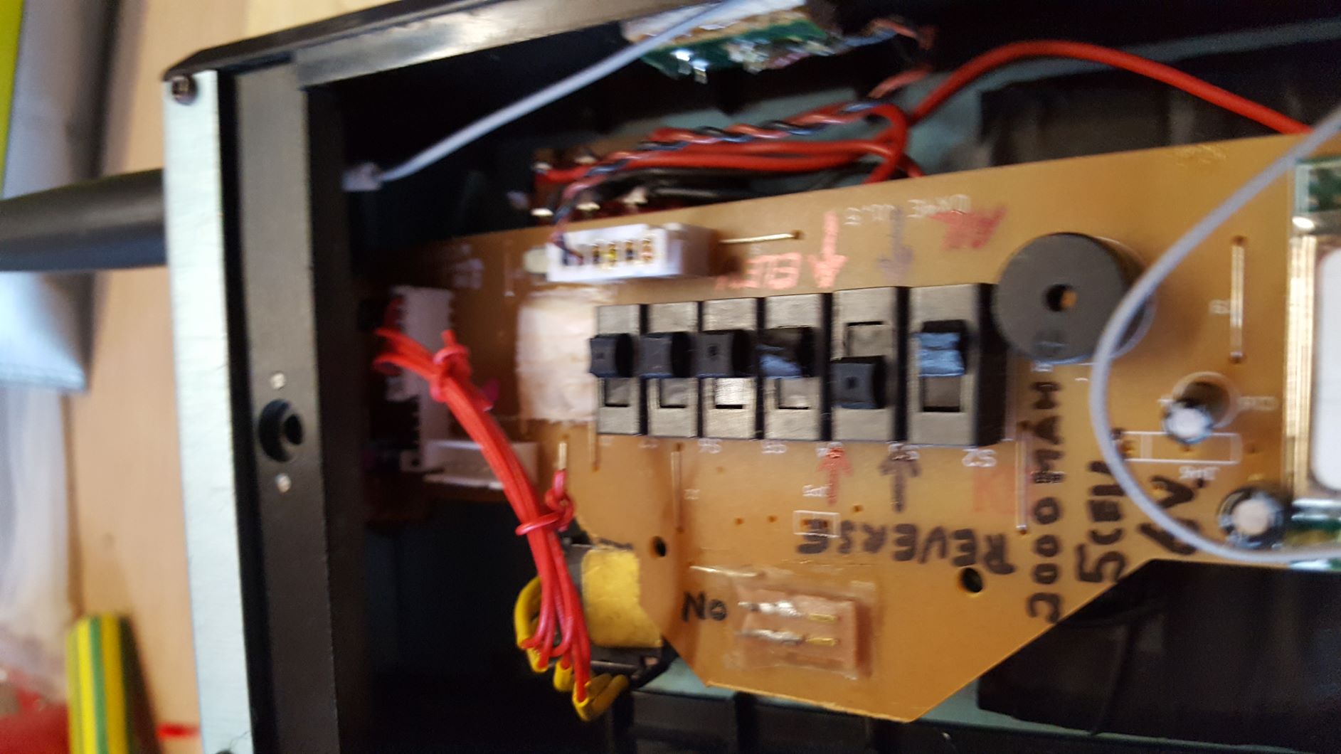

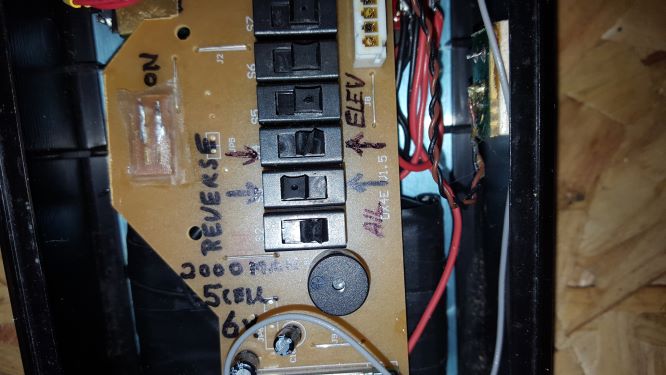

hi Shaun see attached photos. I am disastrous with a soldering iron!!!!
Is it something you or Phil could do for me or would suggest a different stick. Ideally looking to add a throttle or throttle button .

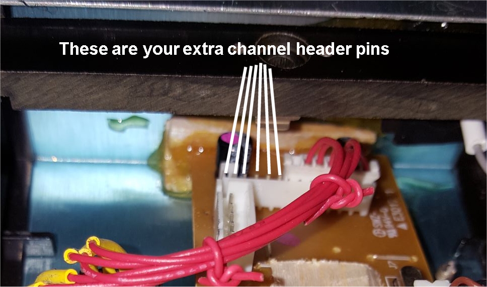

Thats quite unusual Bill, its not just a Spektrum module but a complete DX4e board.
The case is typical of the Macgregor S/C transmitters, taller than it is wide, and the stick unit looks very small, much smaller than a Macgregor stick. Most unusual!
An extra channel should be just a case of wiring the extra pot, as the DX4e expects 4 pots. Maybe the converter has put small presets on the unused channels under the board, in which case its just a case of moving 3 wires. Either way, it looks like the pot connections simply continue along the header where the bundled red wires go (who uses red, red and red for pos, neg and signal?
The stick connector has 12 pins, 3 of which you're presently using for rudder and 3 for elevator.
The remaining 6 are the same for the other stick unit, so for throttle you'd just use the next 3 adjacent
to your existing red wires.
You need a header socket with wires attached, this kind of thing, with 3 to 6 connections. You'd need to find pos, neg and wiper with a multimeter, its unfortunate that the converter has used red throughout so there are no visual clues.
Once the new pot is wired, it will need calibrating - I dont know how this is done on the DX4e, maybe one of the Spektrum lads will know.
Actually, now I think about it, the DX4e has two switched channels, it might be much easier to arrange an on-off throttle via a toggle switch. No messing with pots, no calibration, easier to mount a switch...
(contrary to popular belief, the DX5e and the DX4e are both 6 channel sets)
Hi Phil,
That looks magic will PM you. Bill

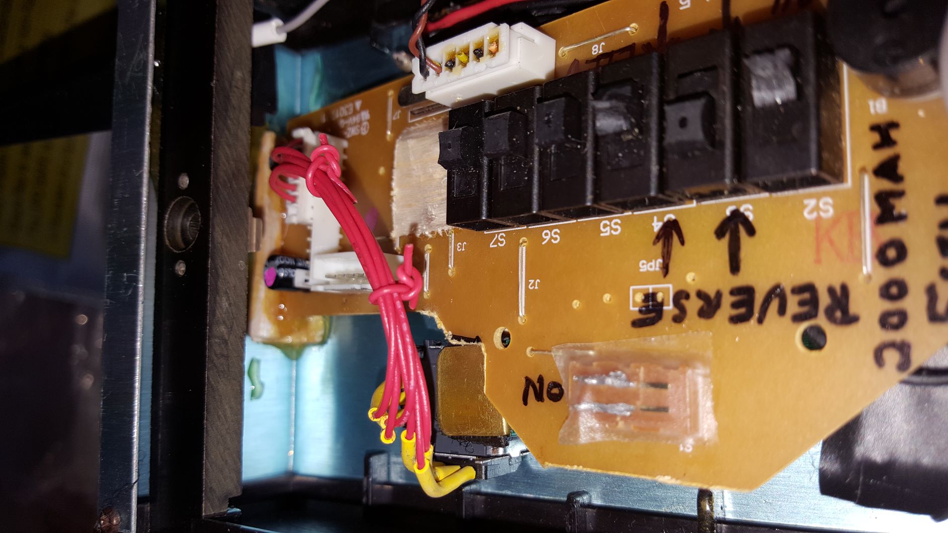

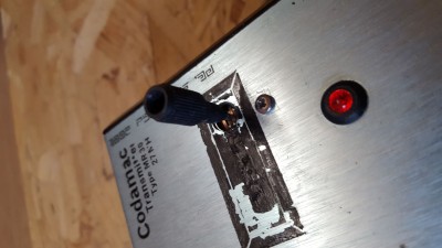

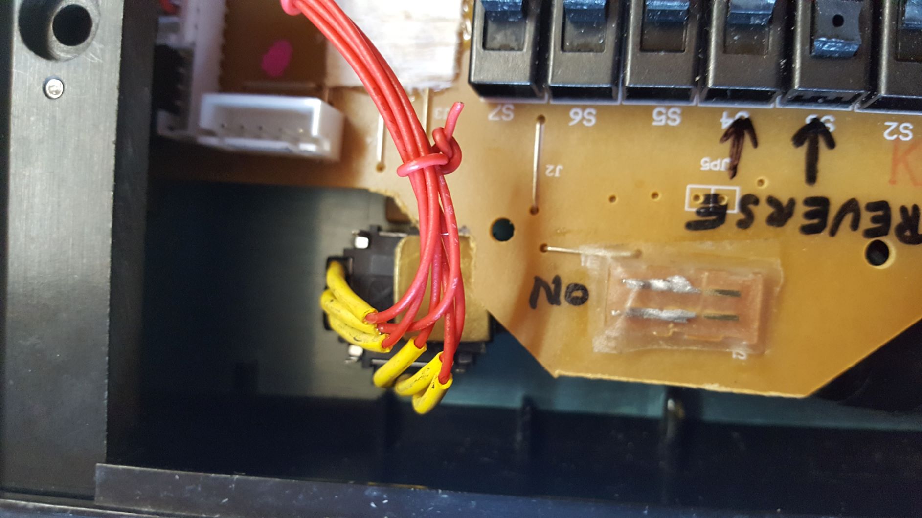

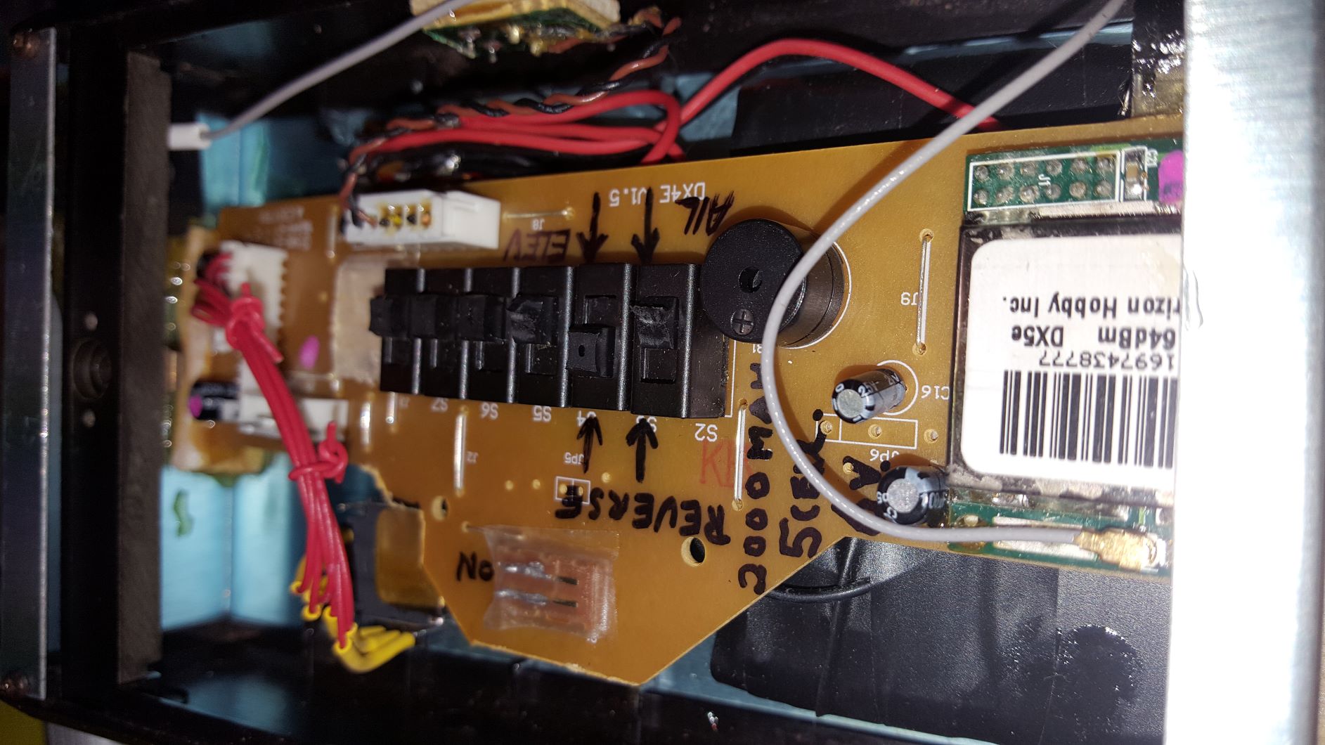

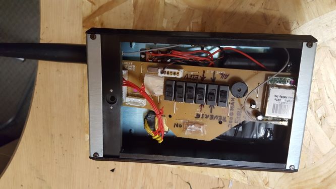

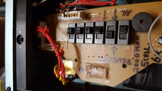

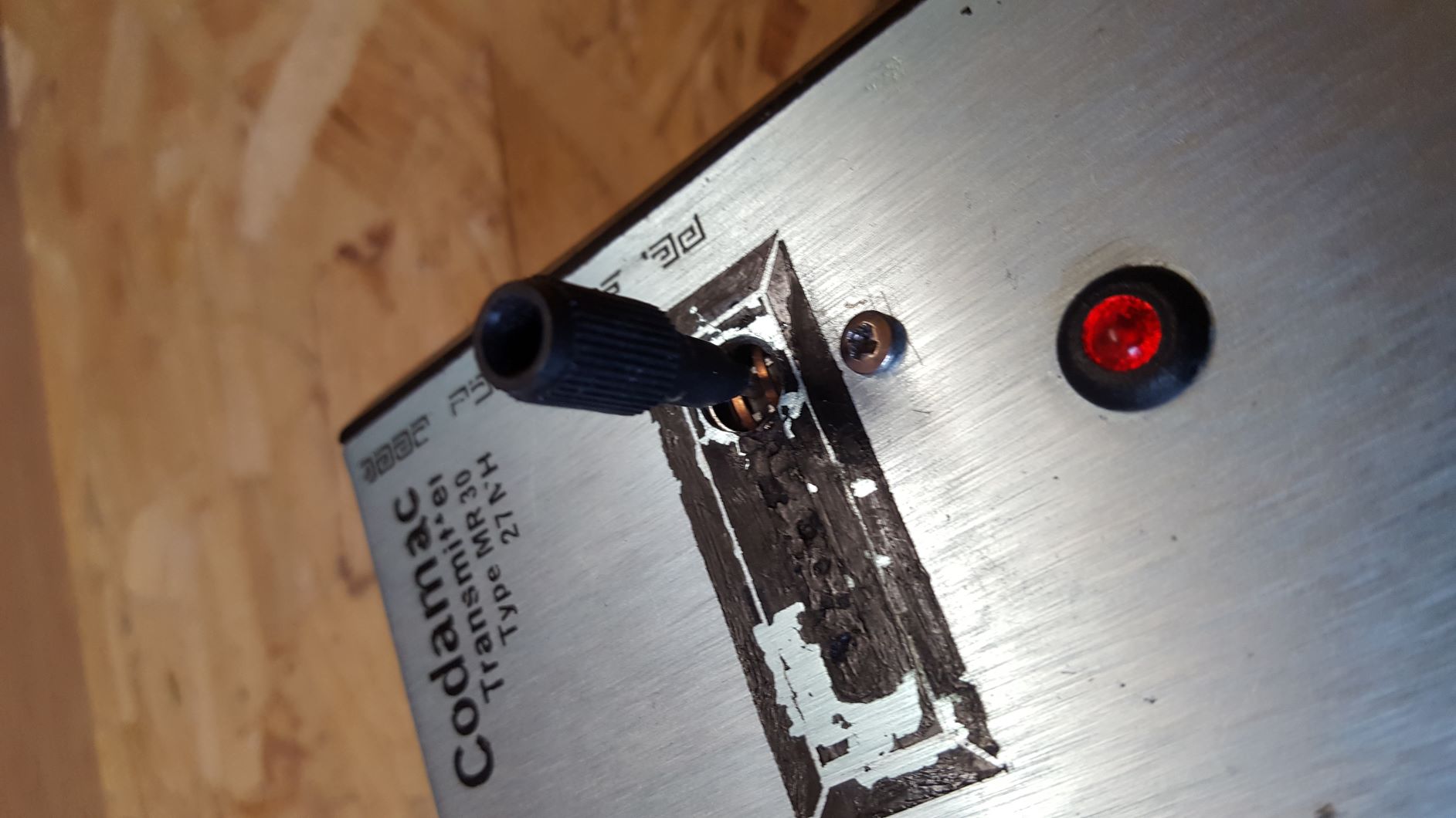

Added 3rd propo channel and a switched 'aux' channel on a toggle so its a 4ch now
Gosh the is neat. Considering the board was epoxyed into the case.
Wow!!! many thanks#Bill
