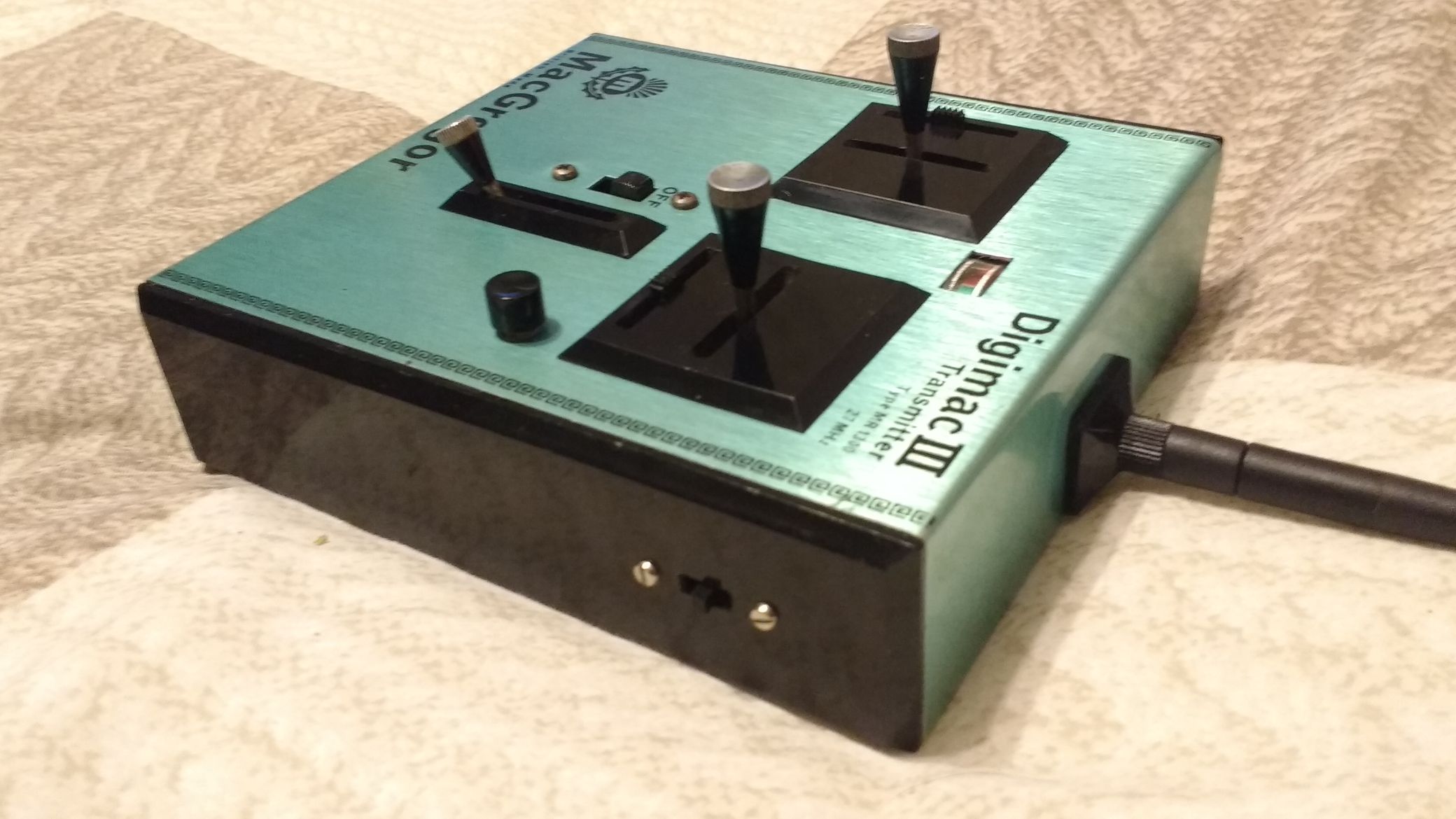

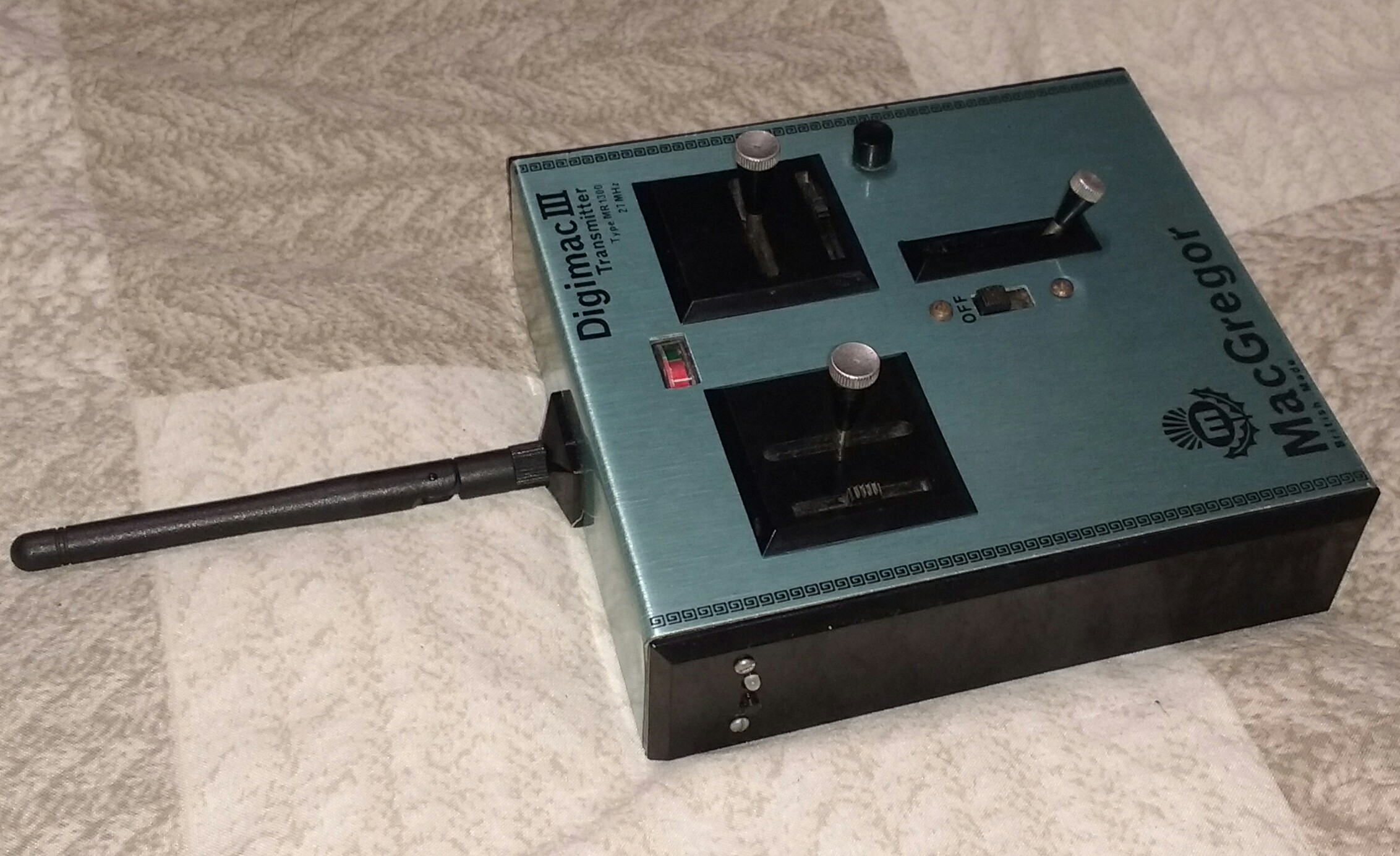

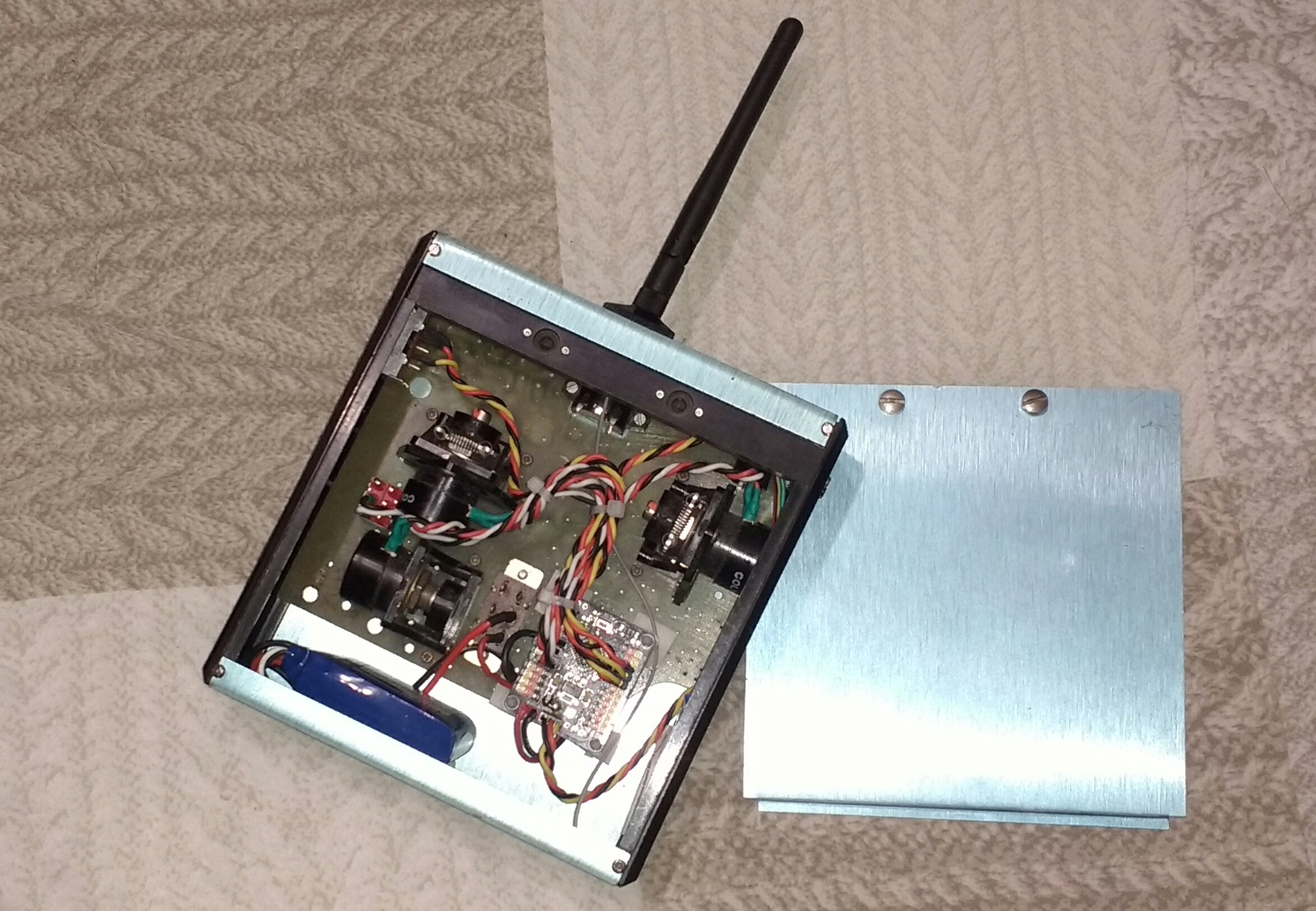

This is a minimal conversion of a Digimac III, using a 3 channel subset of the 7ch encoder, just rudder elevator & throttle, with S/C emulation and with Vtail & elevon mixers. Gary had already done the prep, it just needed a bit of fettling:
Bind/low-power button
Mixer 3-way slide-switch: 50:50, off, 75:25
Not as neat as Rons but its ok :D
All ready for a test flight Image
