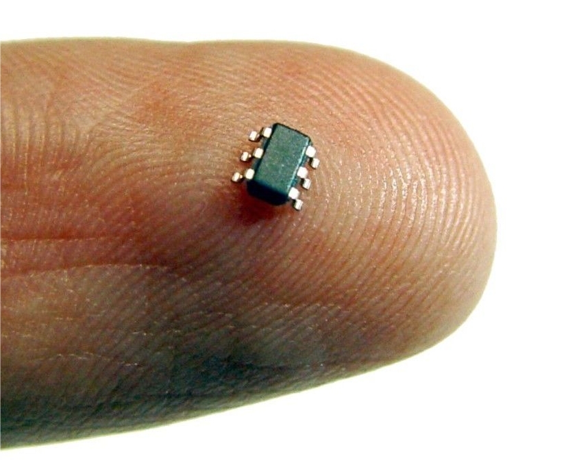

The ATTiny10, ideal for onboard mixers, servo-slow, reversers, switches, lights etc
16 bit timer but only 8 bit ADC. Looks like it could be loads of fun!
I've ordered one to play with :D

Is that a really big finger or a very small chip :lol:

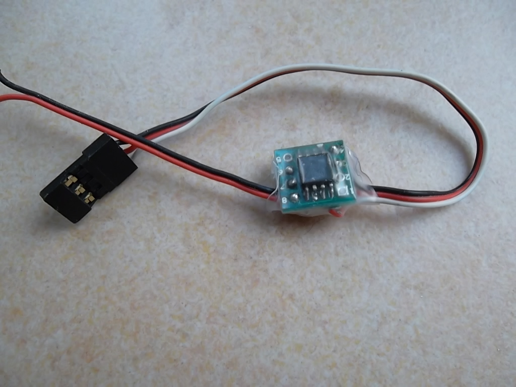

Hi Phil,
I am already interested, because I like small and tiny things.

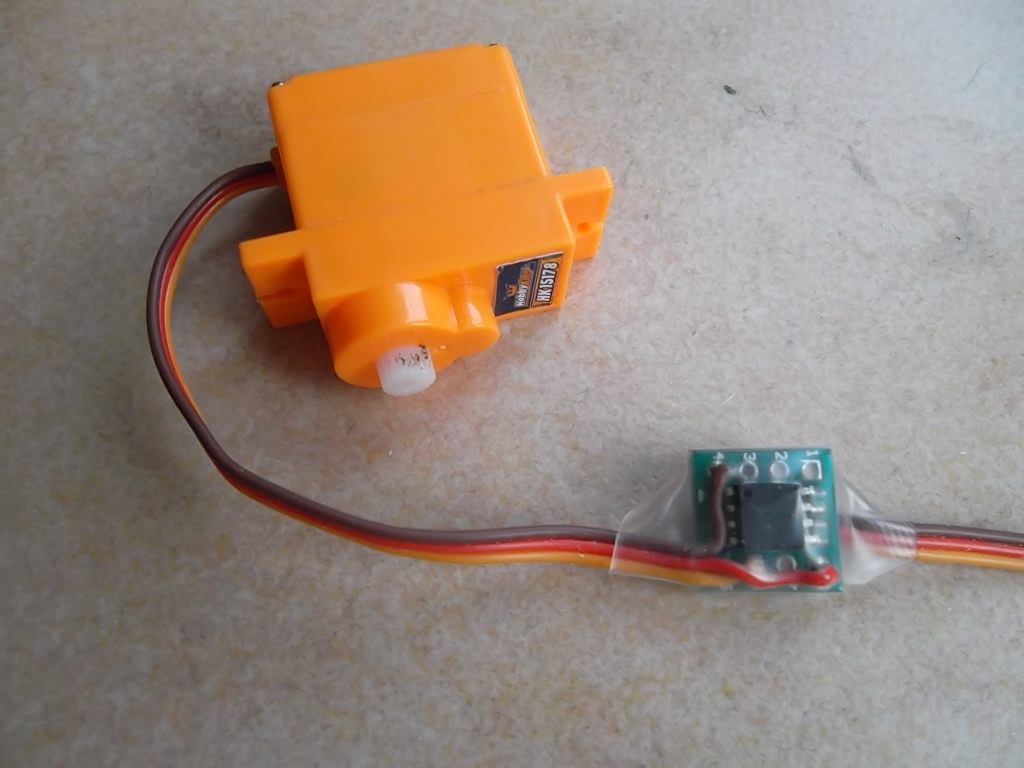

I used quite some solo Attiny85 in SMD chip form, which are only slightly bigger for some small applications like home made switches, or converting a normal micro servo into a 180° proportinal servo or a 180° two position servo, or to make memory switches for retracts, which can be operated by the monentery button on the stick of my Spektrum DX10 tranny, which is very convenient.
Homebrew micro-switch for rubber escapements
180° two position servo or 180°proportional servo
