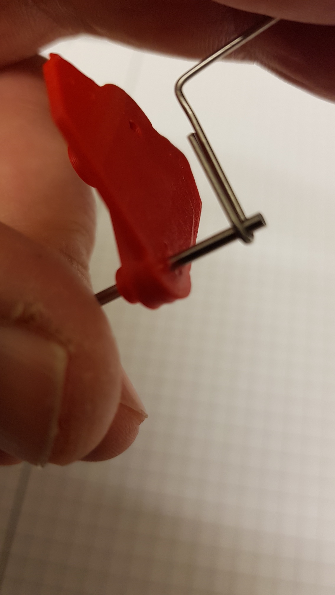

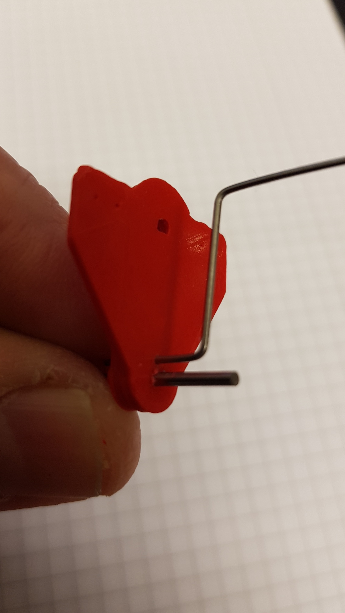

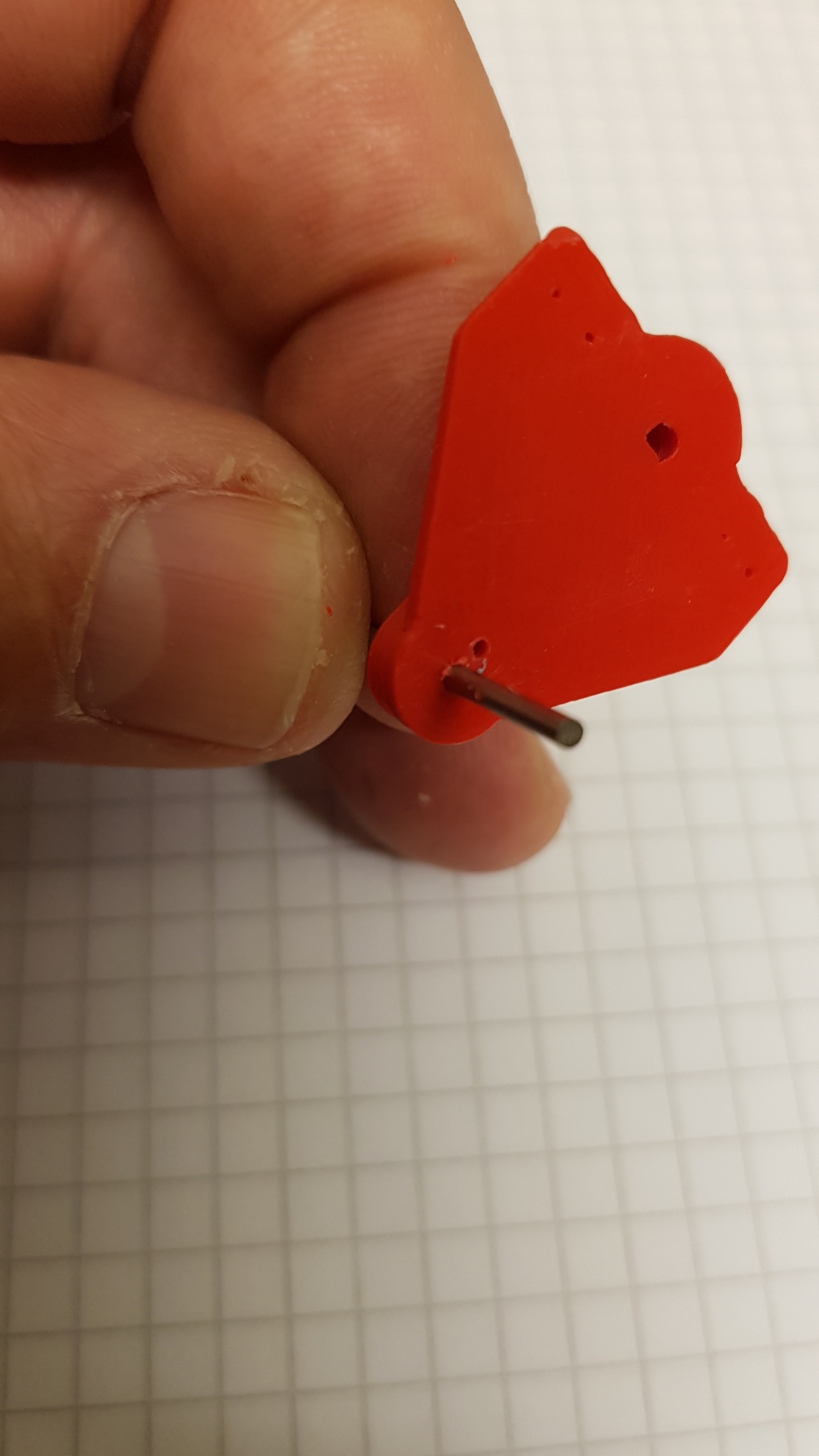

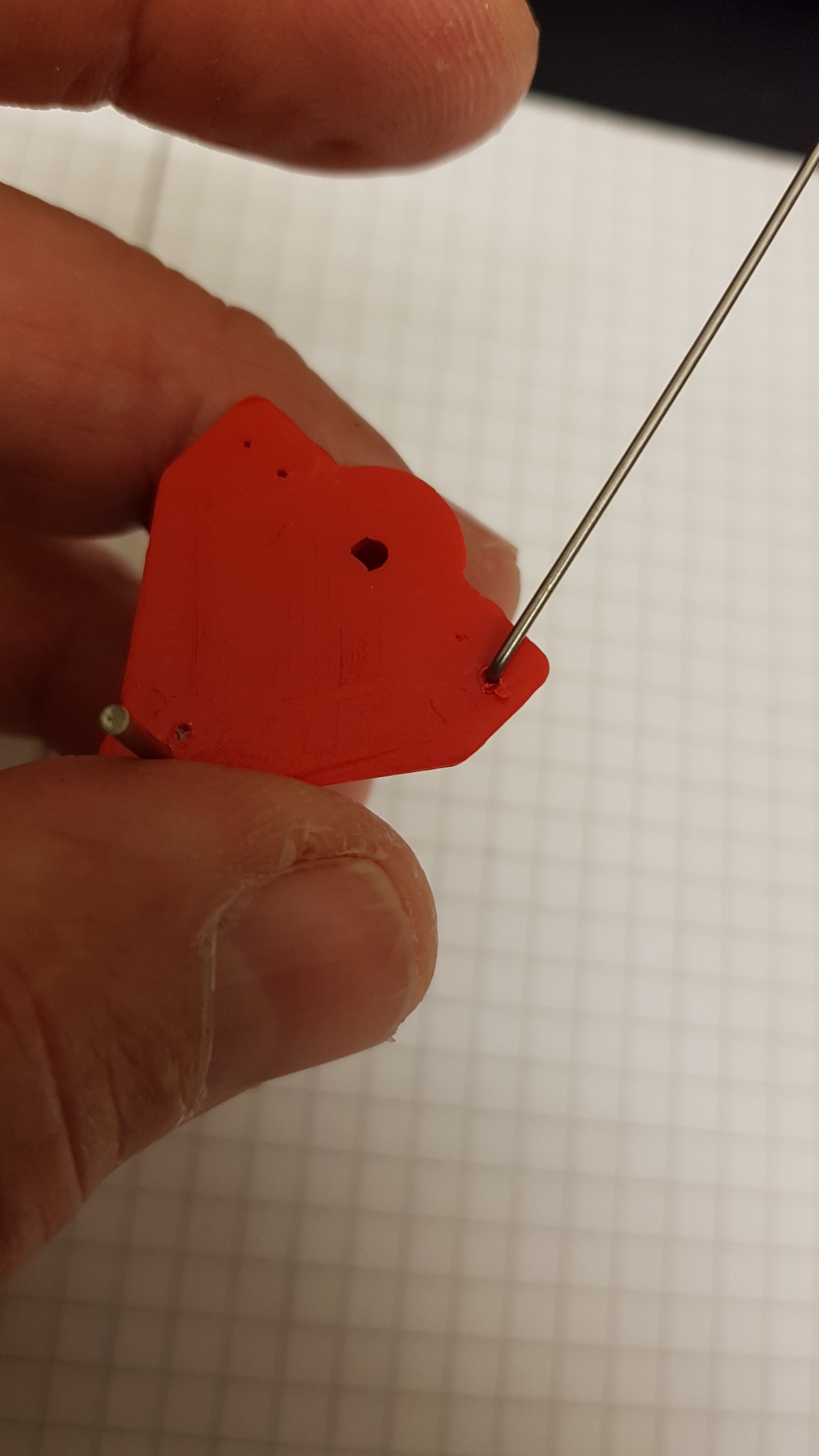

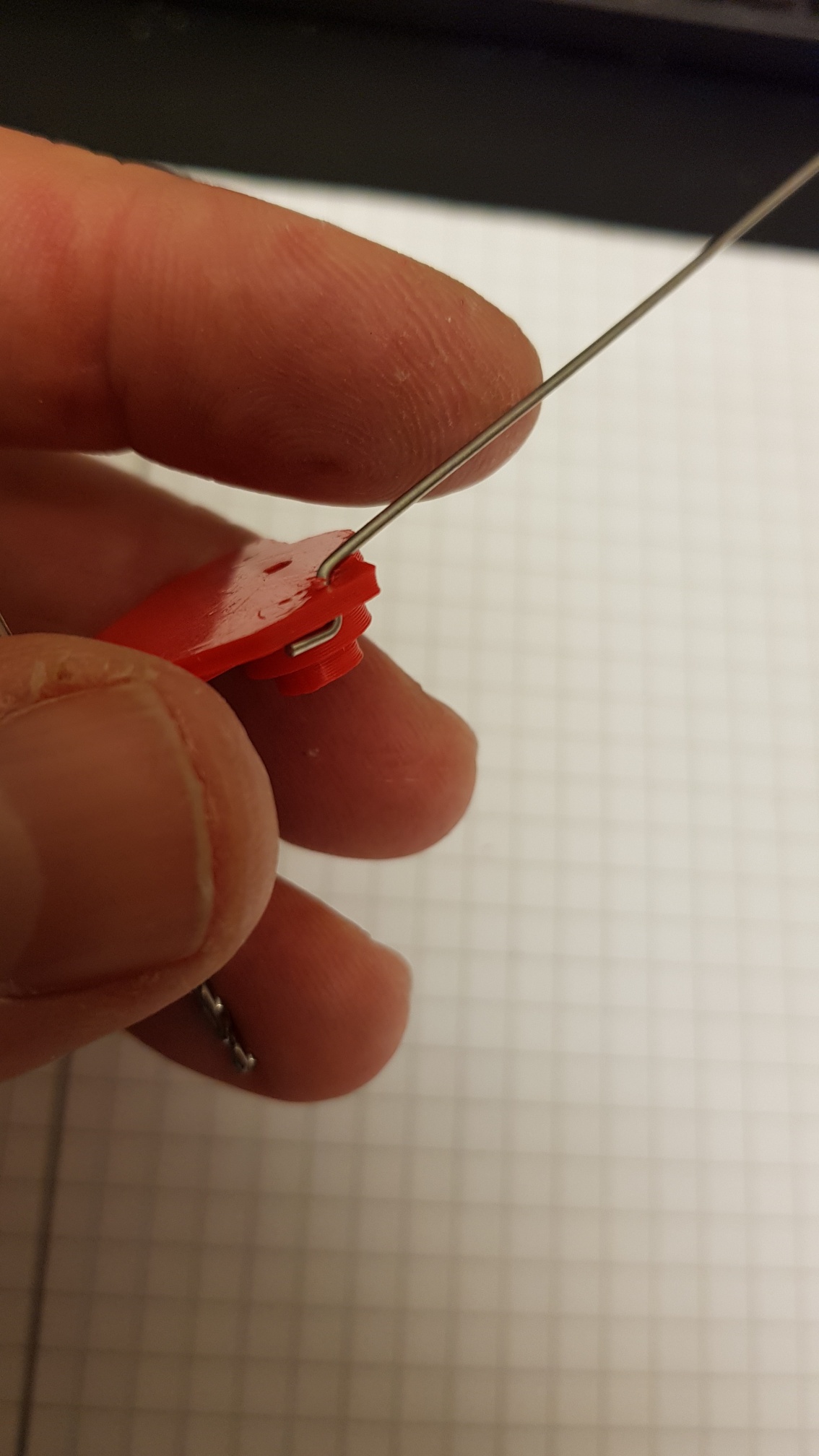

The Adams clone is intended to be connected in the same way as the original. To simplify things you will find just above the pin in the plastic a smal hole that appropriately resized could also fit the the bended end of the torque rod.
