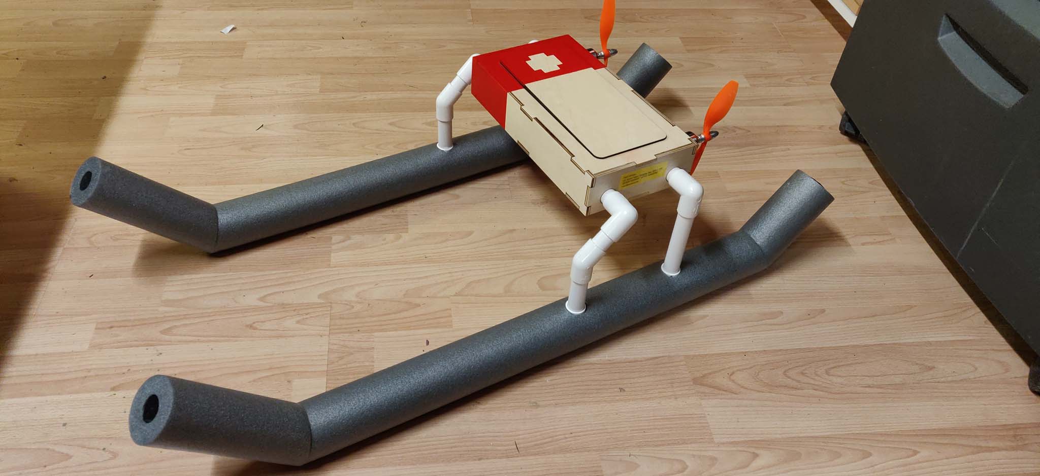

Thought this might interest someone. Not original (kind of based around Andrew Newton's version on youtube), but based on available UK stuff.
It's essentially a framework of 22mm overflow pipe and fittings (except that you can't get stopped ends, so I 3D printed some :-)
The foam 'pool noodle' is actually 20mm ID 70mm OD pipe insulation. The central box is a bit of 6mm laser cut liteply.
Motors are a pair of 2826/10 1400Kv motors and a pair of 30A esc's from HK for the Bushmule twin foamy. They're reversing - which was one of the points I wanted. All running off a ubiquitous 3S/2200. Rx is an el cheapo orangerx 618XL v2 and one of the brilliant OrangeRx Tx6i transmitters. A bit of mixing for everything on the RH stick and Robert's your auntie's husband.
This all started because I picked up a real bargain at one of our local B&B's - an eflite Carbon Z Cub - 2.1m - only 1 flight under it's belt too. I've always fancied a go at floatplane flying - bottom of my garden is literally in the river Forth :-)) Having lost a couple of slopers to the river, I thought it would be pertinent to have something that might be able to retrieve the model in case of a dunking :-) My neighbours have boats and rib things to get out to them, but it takes ages to get them fettled and started - NOT electric for some reason ???
Anyway, it works fine on wet garden grass - still to get a soaking on the real stuff :-))

Brilliant Neil! I love it :P I don't actually need one because I have a small RIB for the job but this is a great idea!

As it was raining yesterday, I spent 1/2hr down at the old model boating pond in Rosyth.
This was a REAL maiden voyage, an OD boat and my first boat as such :D
It worked out extremely well - had around 20 mins with still more power left from a 3s/2200 - must be a lot more power frugal than my 3D aerobats :lol:
The thing was very responsive - much better than when it was in the bath :shock:
Apologies for the video, I was 'controlling' the boat at the same time.
Neil
https://youtu.be/gFhbm626xnU
