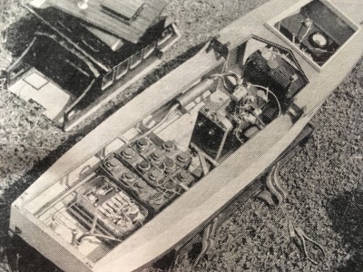

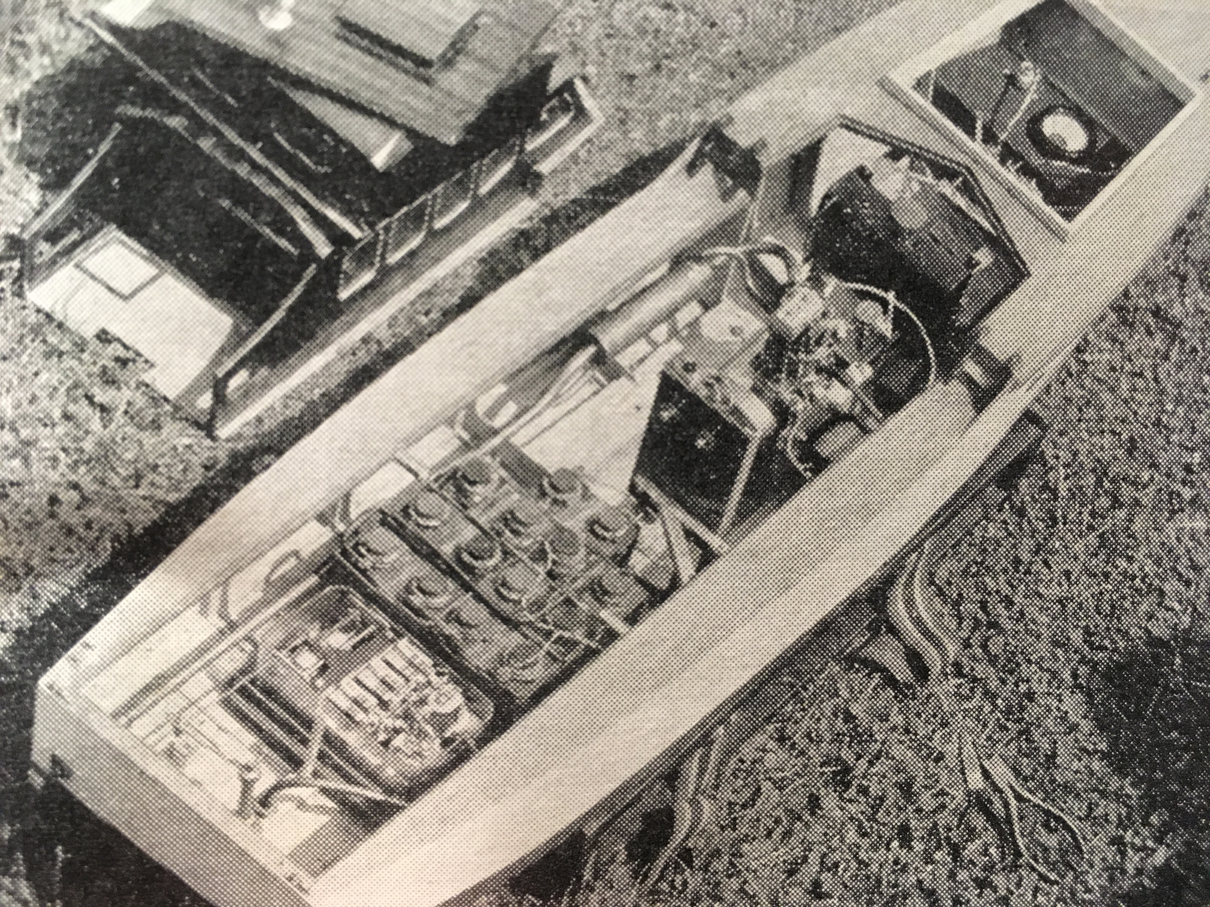

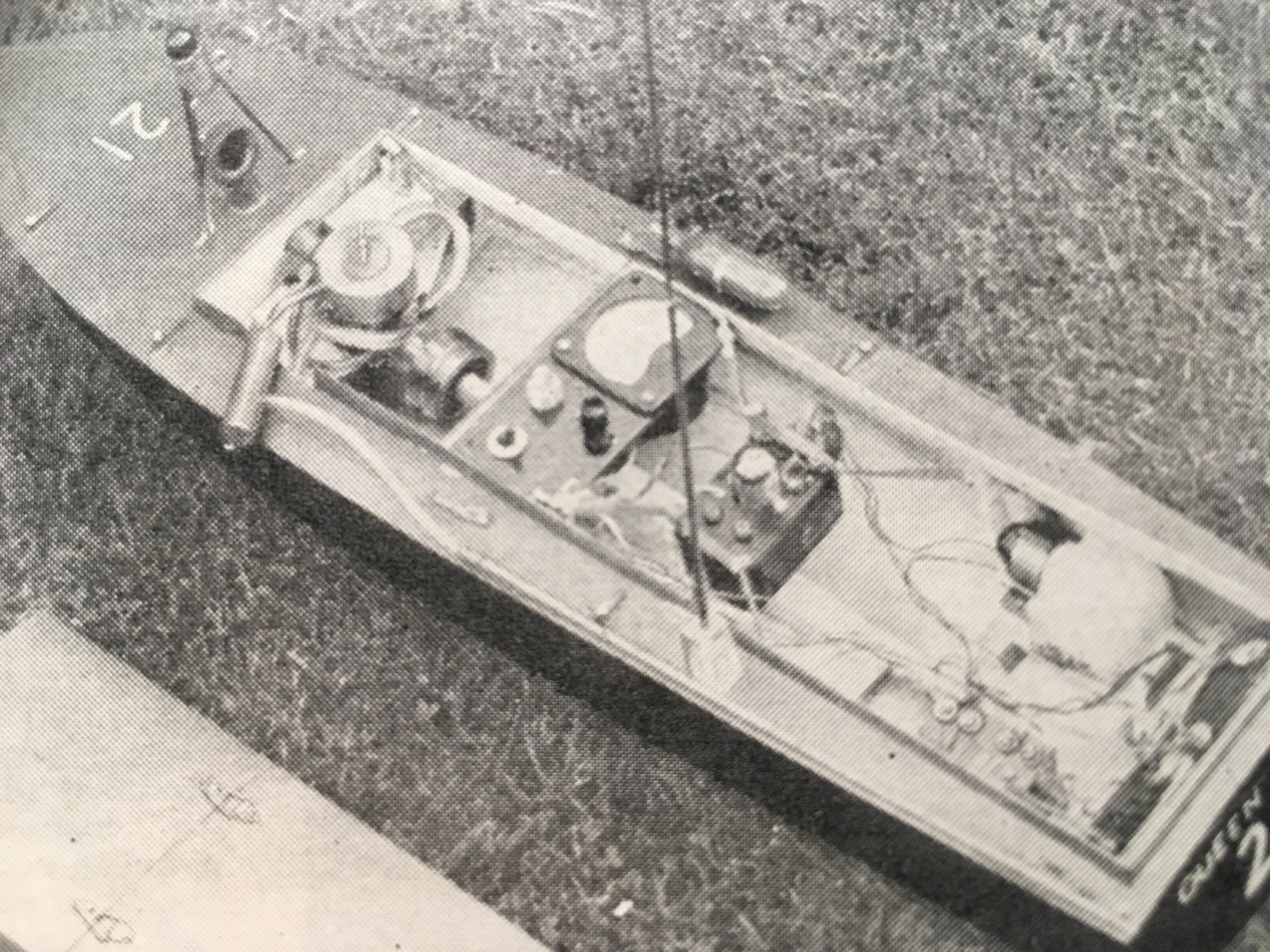

I’m appealing to all you great minds to help me with my thoughts on the making of a SUPERHET valve receiver suitable for A model boat. You see I have an idea that I would like to make a predominantly valve radio set up in a vintage format. Those wonderful 1940s photographs showing model boat hulls Absolutely stuffed with all the gubbins that made them work. Most designs of the time where of course Super Regen receivers using usually a single valve. I’m thinking that if I were to obtain a small broadcast valve radio. Dismantle the front end and insert a crystal oscillator It should be possible to turn that radio into a really good superhet Model receiver? My problem is that most domestic broadcast receivers have an internal frequency of 455 kHz. If I want to use 27 MHz ( my preferred frequency band ) Then I would need it to operate at 470 kHz. Therefore my question is it possible to re-tune the internal frequency of the broadcast receiver to operate at 470kHz hopefully without modification to this part of the circuitry?

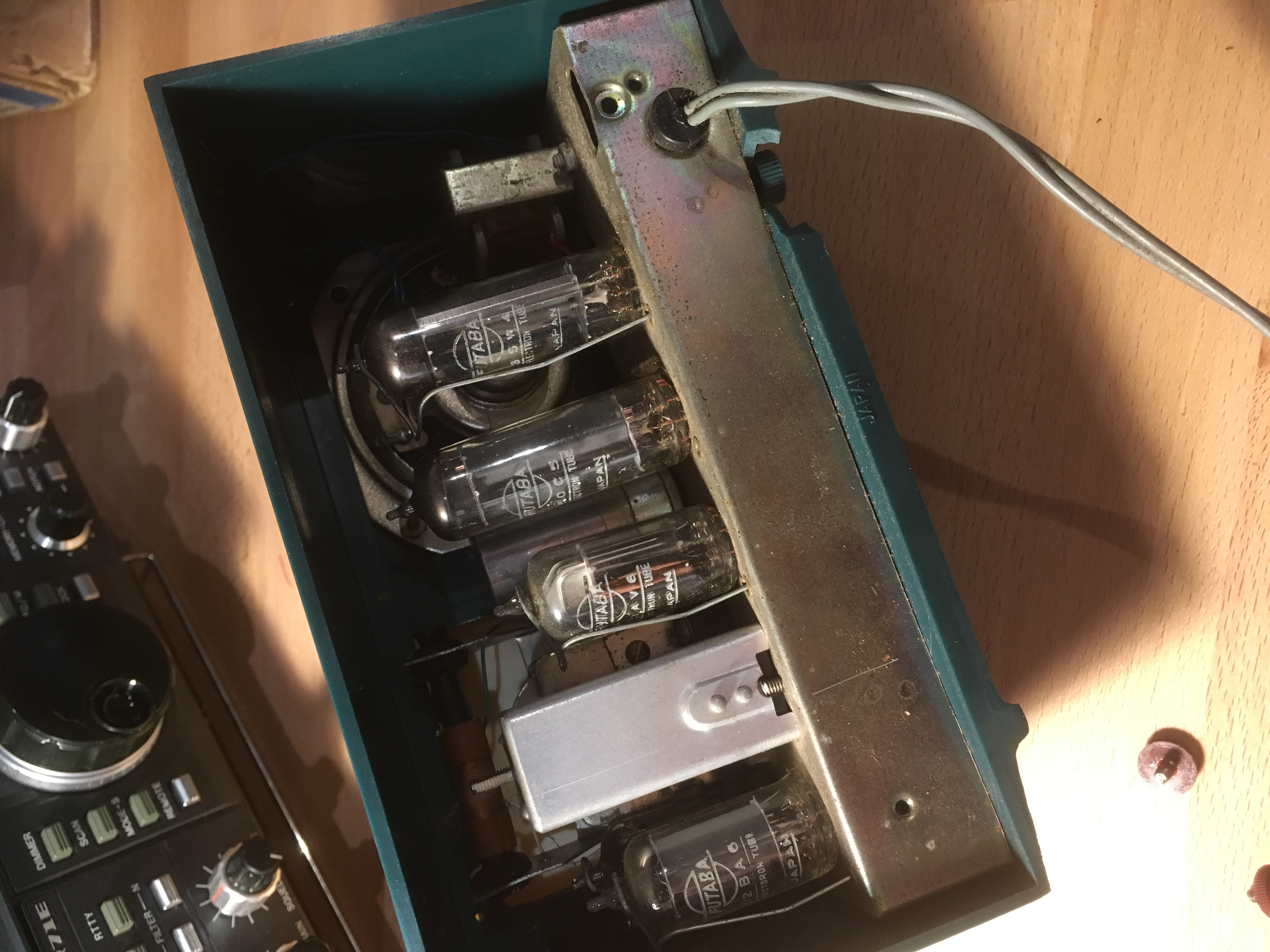

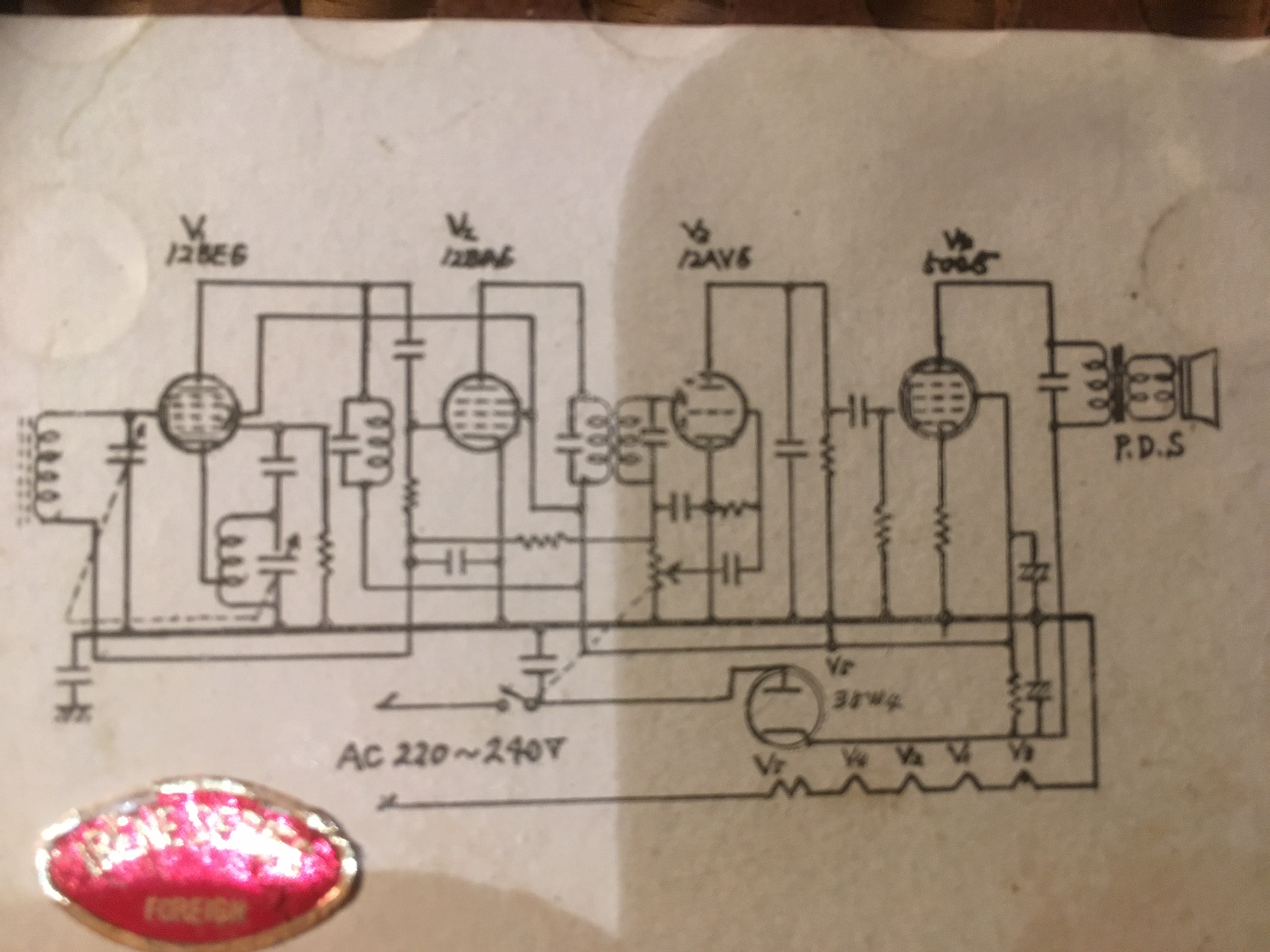

Re: Vivacious Valves

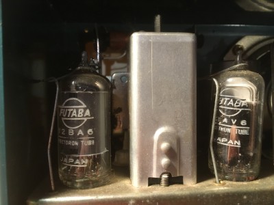

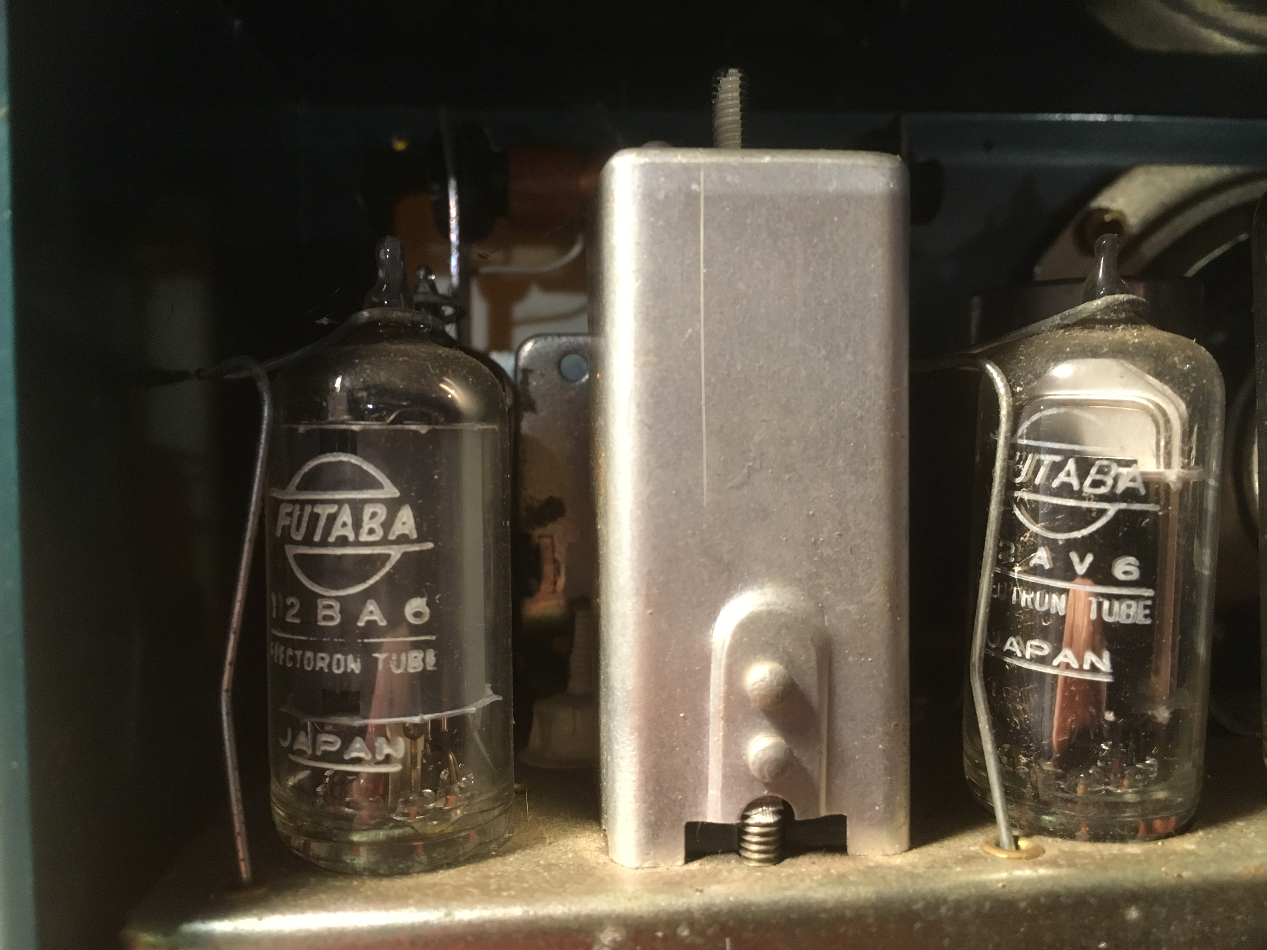

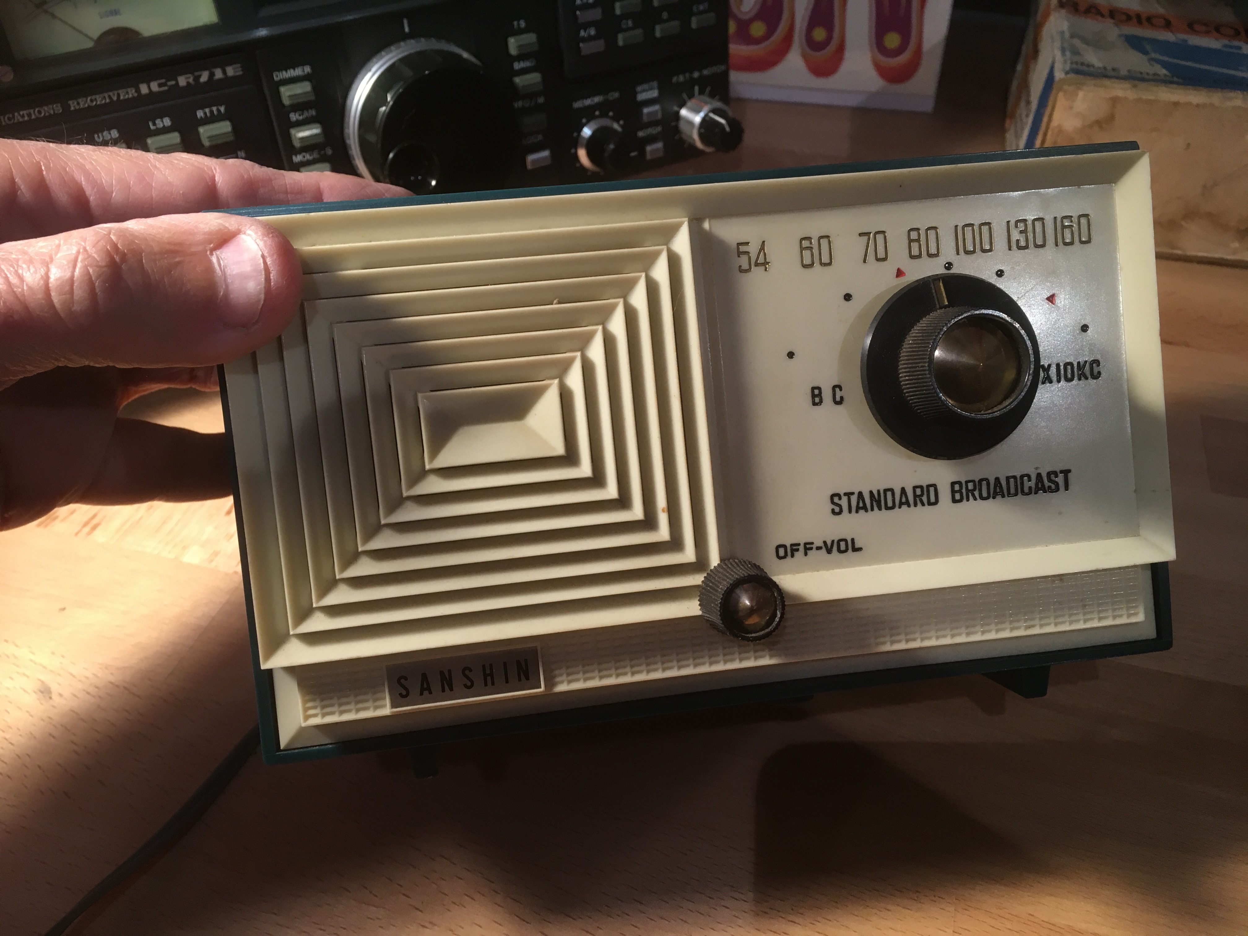

Well today I secured my little Sanshin ‘donor’ valve set. It’s really quite sweet. Works great and has Futaba Valves! Now what I intent to do is make a xtal oscillator for 27mhz and splice it on the front end. If it works I will proceed to extract a digital pulse from it and feed into a decoder board and then on to the servos . I will then have a valve superhet to put in a vintage format model boat
