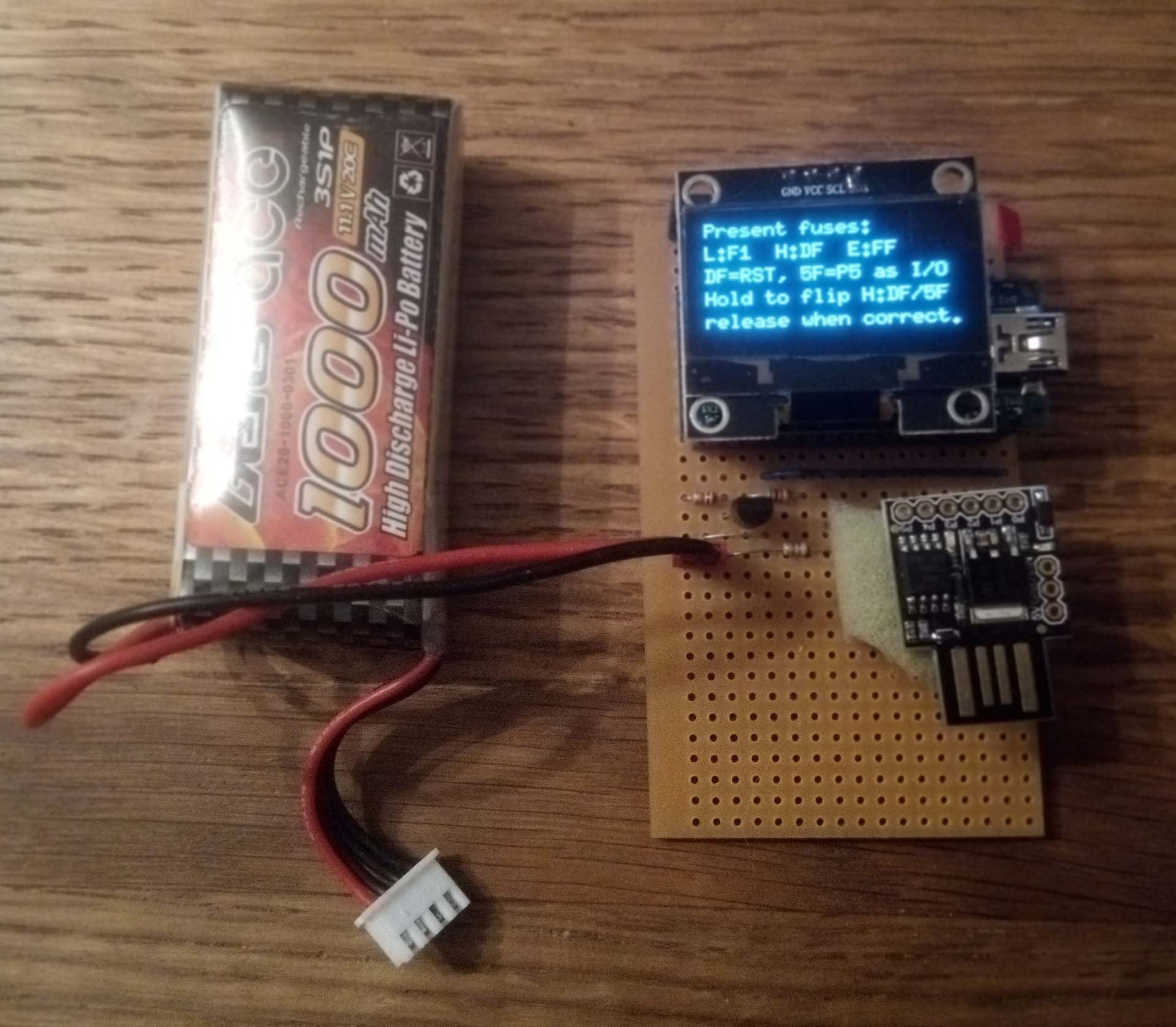

Its powered from something very near to 12v, I use a small 3S lipo which is perfect. It has to be close to 12v as thats the fuse programming voltage.
Initially the screen displays the current DigiSpark fuses. The one we're interested in is the hfuse, and
the hfuse values of DF and 5F. After showing the current fuse settings, if the power is held on,
then hfuse is set to DF. If the power is still held on, then hfuse is set to 5F. The programmer only powers up the DigiSpark for the duration of the fuse-setting - you can see the DigiSpark power LED going on/off.
An hfuse value of DF means P5 is RST and the DigiSpark can be programmed, 5F means P5 is I/O. Simply remove the power when desired setting is shown. I use a tiny 12v battery via a momentary push-button, so to read the DigiSpark I press and then read the screen. If hfuse is as required then the button can be released. If hfuse needs to be changed, just keep the button pressed until the desired value is shown.

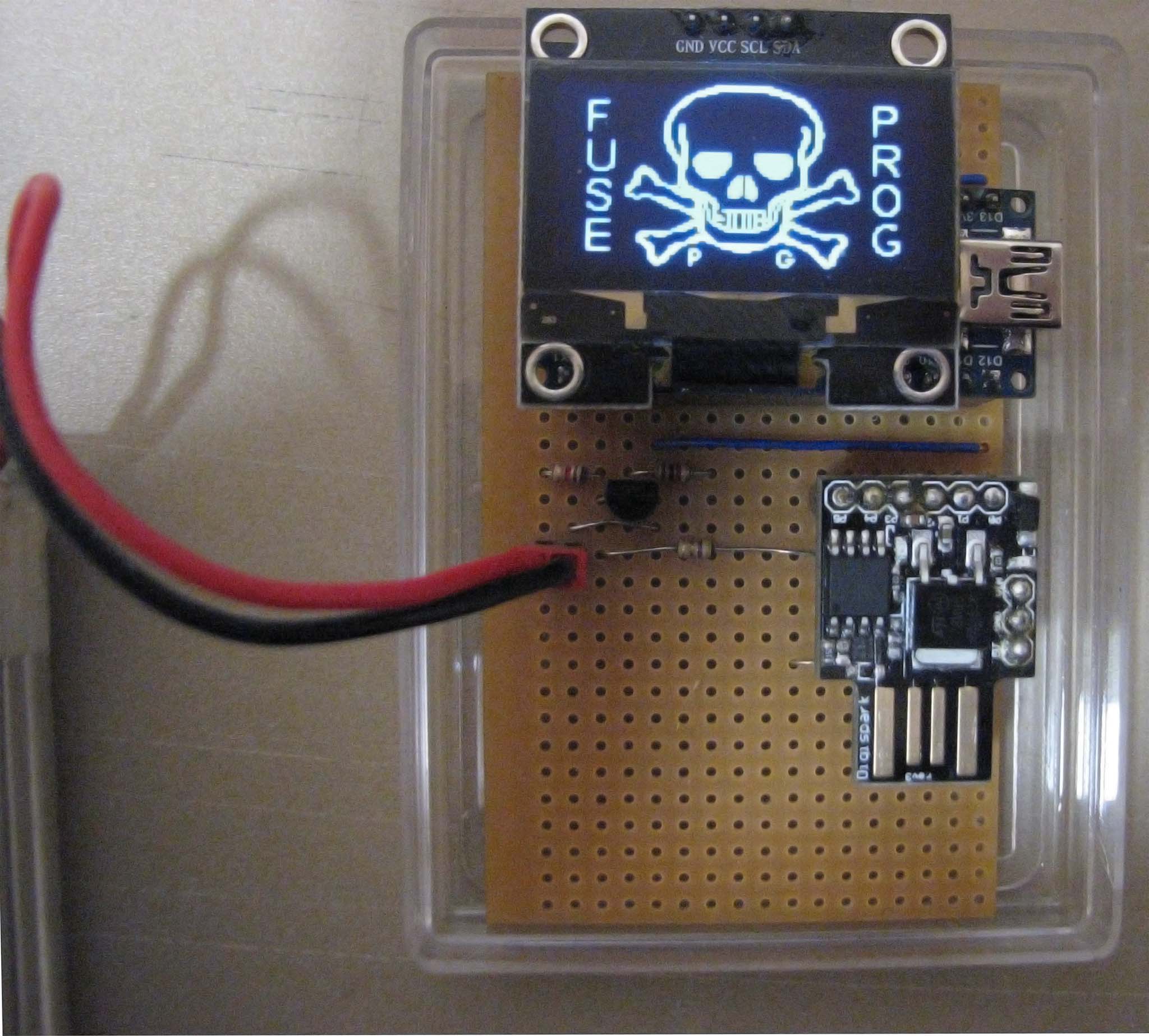

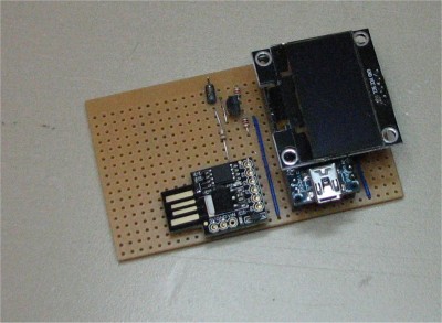

Here's the project, I'll upload the sketch and do a vero layout (its very easy to make) and maybe a
video of it in use. Its much easier & quicker to use than to explain :D
... and a 20% increase in I/O capability is well worth having ;)

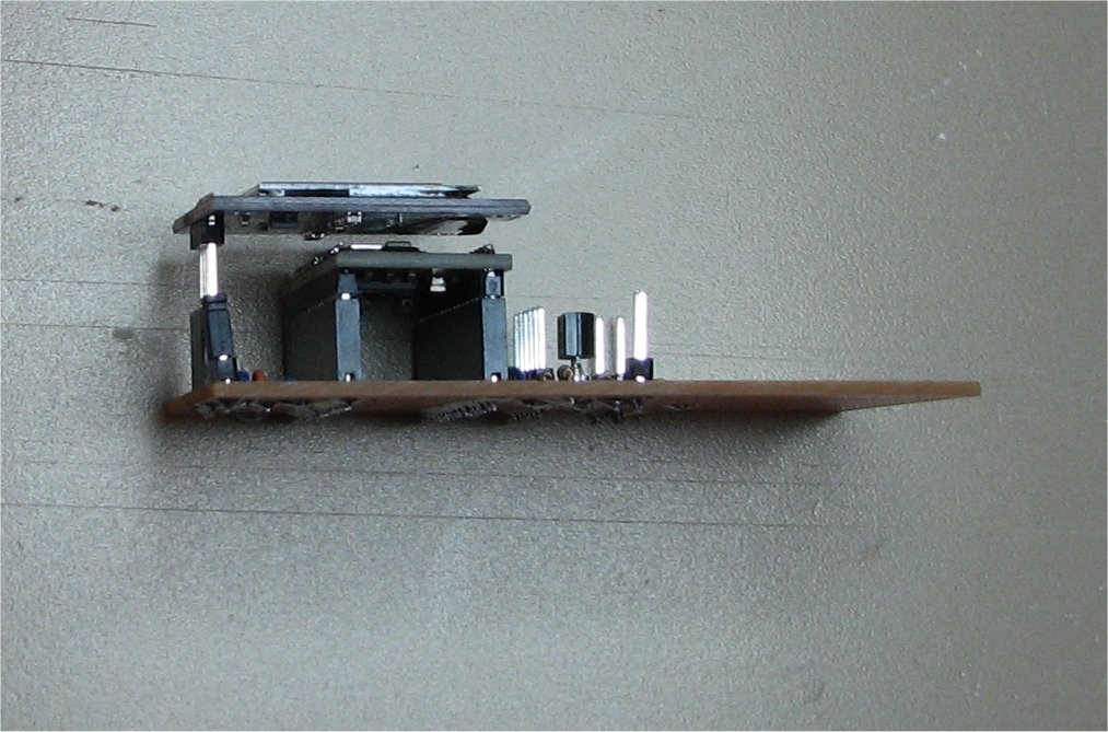

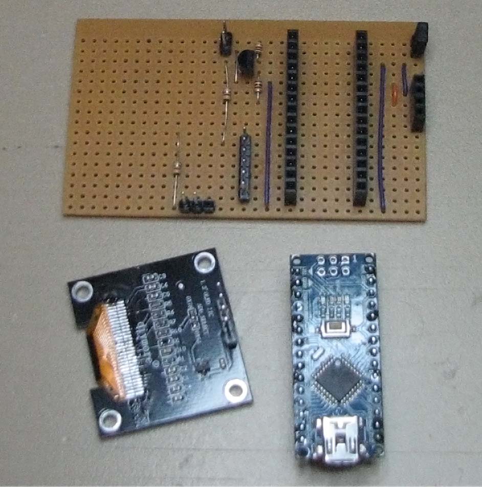

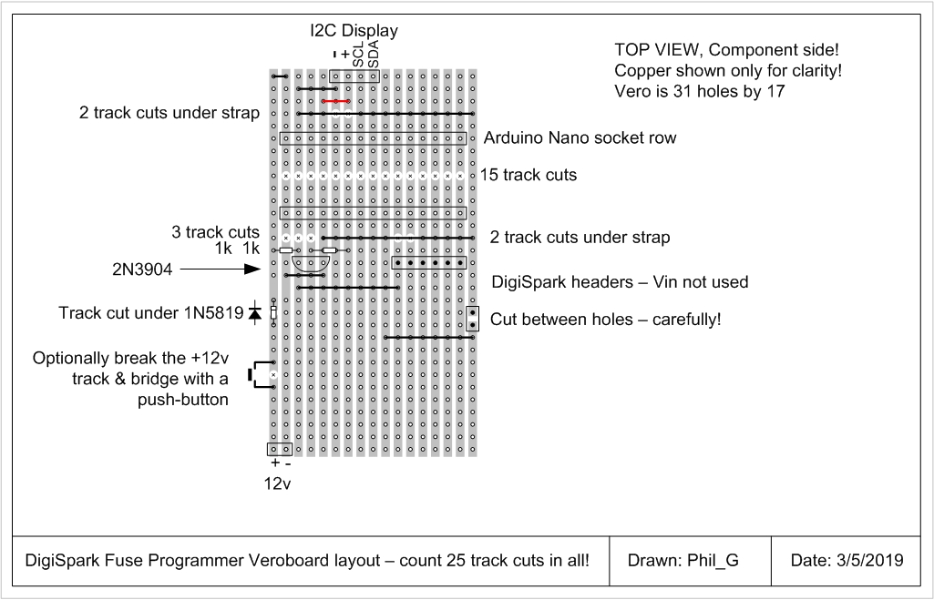

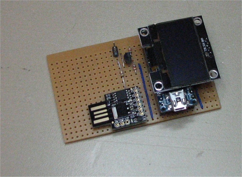

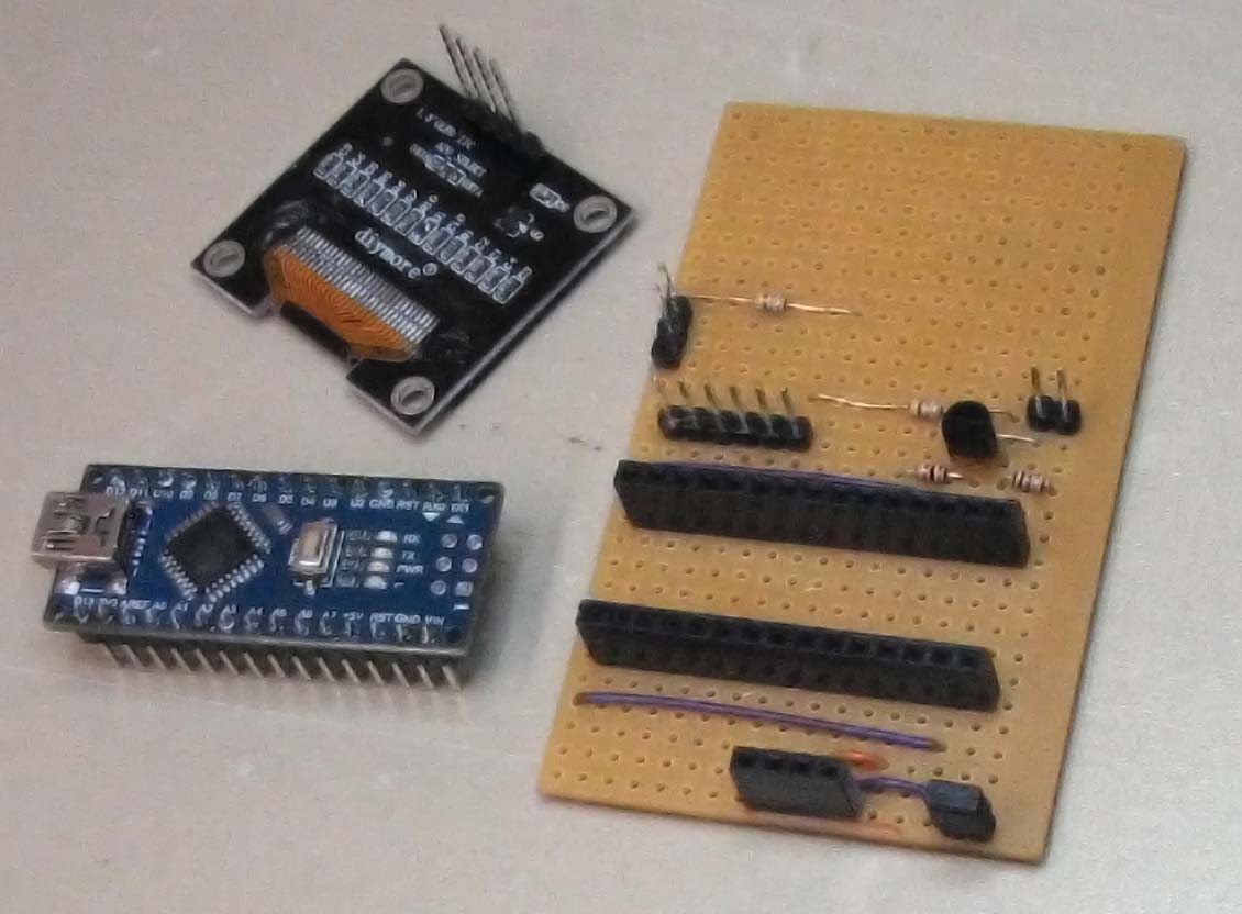

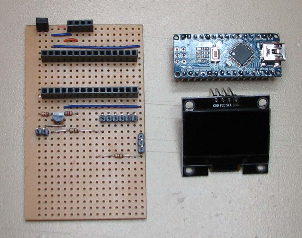

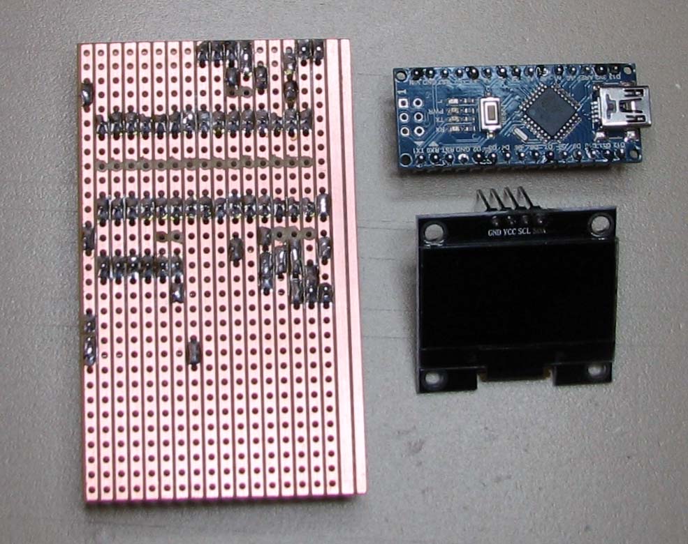

I've posted a few pics so the stripboard layout can be seen. Note the cut between vcc and ground on the 2-pin DigiSpark header.
The two resistors nearest the transistor are both 1k, and the two leading to the DigiSpark P5 and Vcc are zero-ohm links. The transistor is a 2N3904, the same NPN as we use as a buzzer-buffering tranny.
The 12v battery will be replaced by a 27A 'fob' battery in a holder, On the two-pin header, the 12v rail is nearest the edge of the board. The link in the top-right corner connects 12v from the 2-pin battery header to the Raw input of the Nano - its not necessary, a solder bridge will do. I just used the link in testing.

I built mine yesterday, but I can't get it to work. [Fixed two posts on...}
I wrote a little test 'blink' style sketch to verify that the 12V is being switched - and that seems okay. I made it switch the built-in LED (13) high at the same time as switching RST (3) low and vice-versa, with 5-second pauses in each state. Sure enough when the LED is on, the voltage is 12V and when the LED is off, the voltage is close to zero.
At first I thought my display wasn't working, but it was just never updating because the fuse-reading routine hangs.
I modified the sketch slightly to display:
Phil_G's ATtiny85
Fuse programmer
on the display at start-up - that gives some confidence that the sketch and display are working.
With no ATtiny present it now hangs on that 'start-up' message display indefinitely.
With an ATtinty present, it also hangs indefinitely till I wiggle the ATtiny board - and then I get random values for the fuses appearing.
I've probably done something stupid, but at the moment, I'm stumped. Any suggestions?
Edit to add: I programmed the ATtiny with a blink sketch that blinks both the on-board LED (1) and the P5 (5) outputs. After trying the board on the fuse programmer, it still blinks the on-board LED, but not P5, and it's still programmable using a USBASP. I've NOT removed the zener diodes and other DigiSpark 'fluff' from my DigiSparks - so although I've erased the DigiSpark bootloader and they work okay for USBASP programming perhaps that's the problem?
