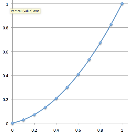

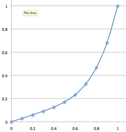

I created a graph in Excel, but was not happy with the result. So I increased the power argument to 5, and that looked much better. A near linear curve up to about x=0.5, then swinging up to y=1 at x=1.

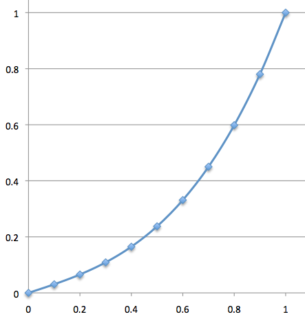

I must confess that I do not really use exponential when flying my models, my interest stems from the "requirements" of a mate who is also interested in a diy tranny.
I had a look at my Multiplex transmitter's graphic display of the expo setting, and it looks more in line with the ^3 formula, not like the ^5 formula I favoured in my earlier post. I considered the use of expo as a "pseudo dual rate", where the first 50% of stick would generate a near linear response (and the dual rate factor is the complement of the expo factor), but it appears that is not what my Tx does. And Multiplex matches Futaba in using a negative expo sign for softened response around zero input.
I made a start with arduino to calculate 10 reference points as setup, using floats. It does take a while to process those few lines...
Max.

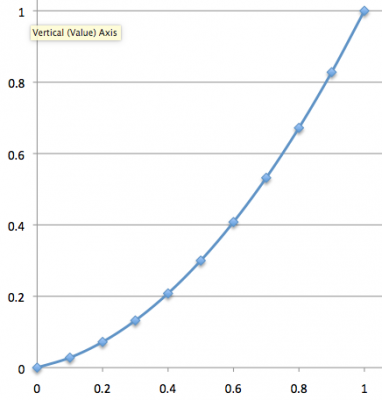

In fact, ^2 is not so bad either, this one at expo = 0.8 :

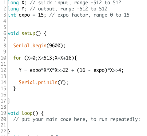

I have tried to calculate the output of an exponential algorithm with arduino. In order to avoid floats, I used long integers with an input x between -512 and 512, aiming at an output y equally from -512 to 512.
I used an exponential factor between 0 and 15. I tried to use bit shifting for divisions, but I must be doing something wrong, since the outcome is not what one would expect.
The expo factor is 16 times the 0-1 factor in the formula, so both terms have to be divided by 16, i.e. >>4.
The first term becomes (expo/16)*(x/512)^3, the second term is ((16-expo)/16)*(x/512). Both terms have to be multiplied by 512 to get the required range for y. Together, the divisions of the first term by 16 and three times by 512, and the multiplication by 512 again result in a bit shift of 22 to the right. In the second term, the division by 512 and the multiplication by the same number negate each other, so there is only the >>4.
This is the code I used, where did I go wrong? I think I am overrunning a limit somewhere, but how to avoid that?
Max.

If you want to build a proportional transmitter why re-invent the wheel? A few years back Phil_G kindly shared his 7 channel encoder that has since been built in the hundreds. It is flight proven, so if you build it and it doesn't work, you know it is a problem with how you've wired it up not the code.
viewtopic.php?f=7&t=4
It implements expo in a different way using float variables and actual mathematical exponential, but the results are very similar (albeit taking more memory). And it doesn't have to have 7 channels, if built with less channels then just ground the unused analogue inputs.
Finally if you use Phil's code and modify it, then you still need to credit Phil for the code he's written. I've seen others on this forum use Phil's code as the basis for their "own" idea, and then shared it as their own without crediting Phil for the 90% of the code that he wrote. Which in my view isn't very polite.

Mike,
Yeah, I figured it was a nice exercise in arduino programming, but I did already conclude that it is too ambitious for me. It's giving me headaches and is keeping me awake at night, and that cannot be a good thing.
Looks like I was just shifting bits into oblivion.......
From Phil's remarks on you providing him with an exponential algorithm I concluded (wrongly) that he did not had that included in his designs yet. I'll have a look at the 7 channel encoder.
As for the credits: I fully agree with you, and I am very careful to keep those intact when I modify code developed by others. As I did with your S/C code, documenting every change I made to it.
Max.
