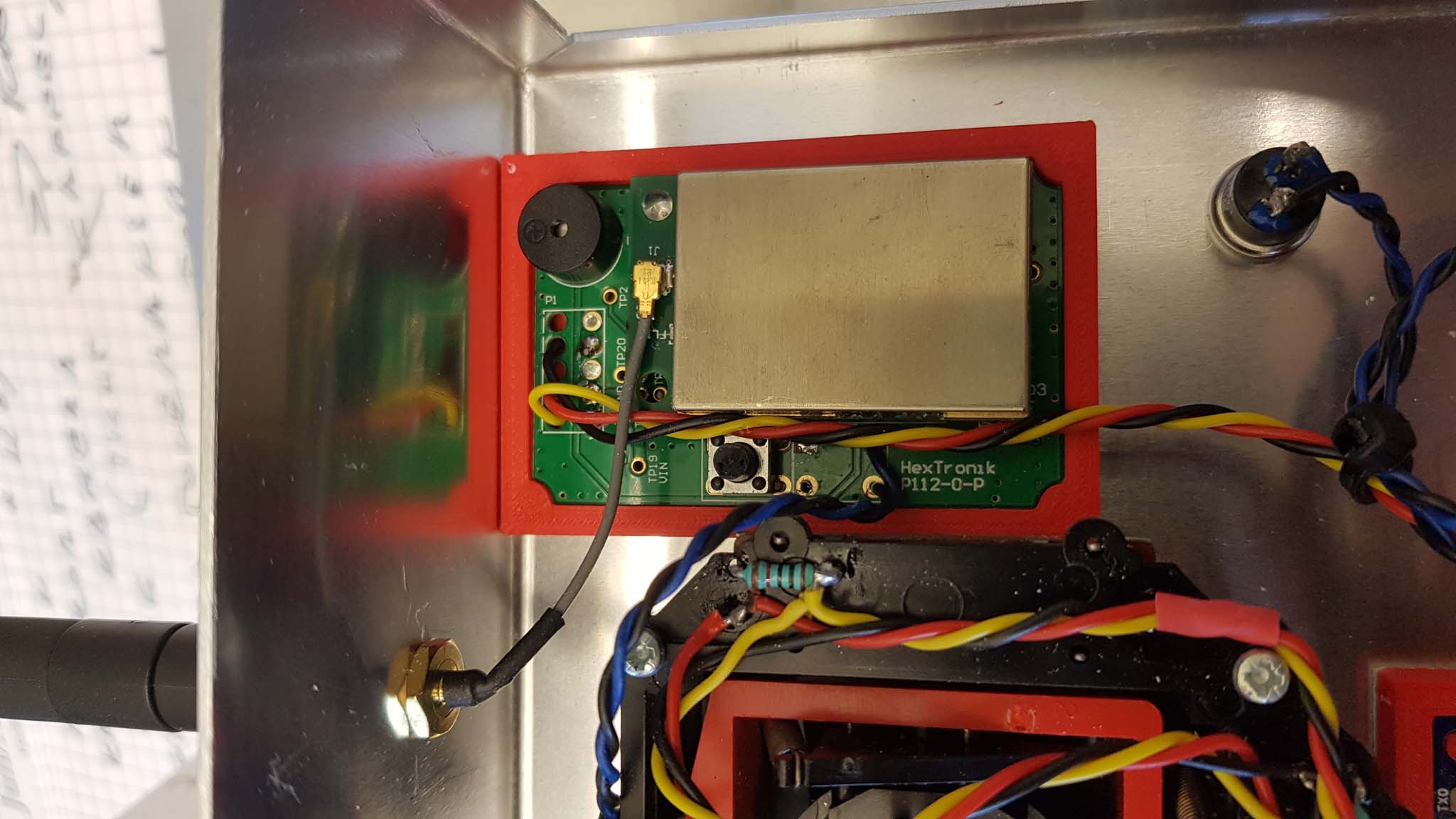

OrangeRX DSMX/DSM2 Compatible 2.4GHz DIY Transmitter Modules are finally back in stock at Hobby King.
I've been waiting since before last Christmas for these and have six old trannies waiting...... At last I can get on with the conversions. :P

I use the "boxed ones" which I unbox and modify accordingly like removing the LED, push button and connector from the PCB and connected with a short wire instead

Yes, the Orange DIY modules are now quite expensive and a lot more than they used to be....... However they make for a neat and uncomplicated installation and I don't have the background in electronics that some have to enable me to "adapt" other modules. Having now converted more than twenty trannies I have a system that works for me and I like the ability to fly any model with any Tx so I am committed. Another factor which might make a difference is that the DIY module has an output of 100mW whereas the other DSM2/DSMX options only have an output of 70mW. 'Not sure how much difference that makes practically but it must help! :?
