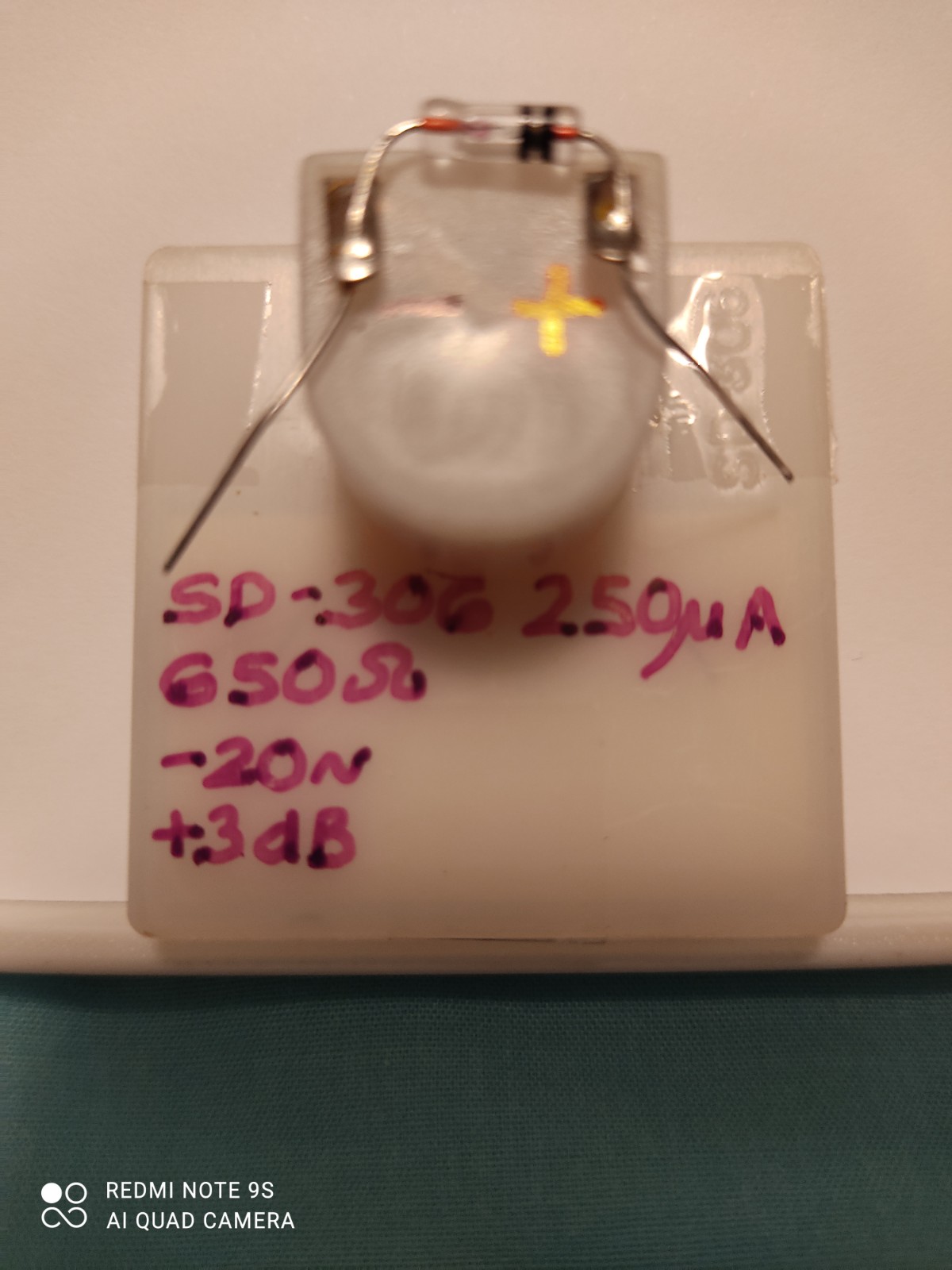

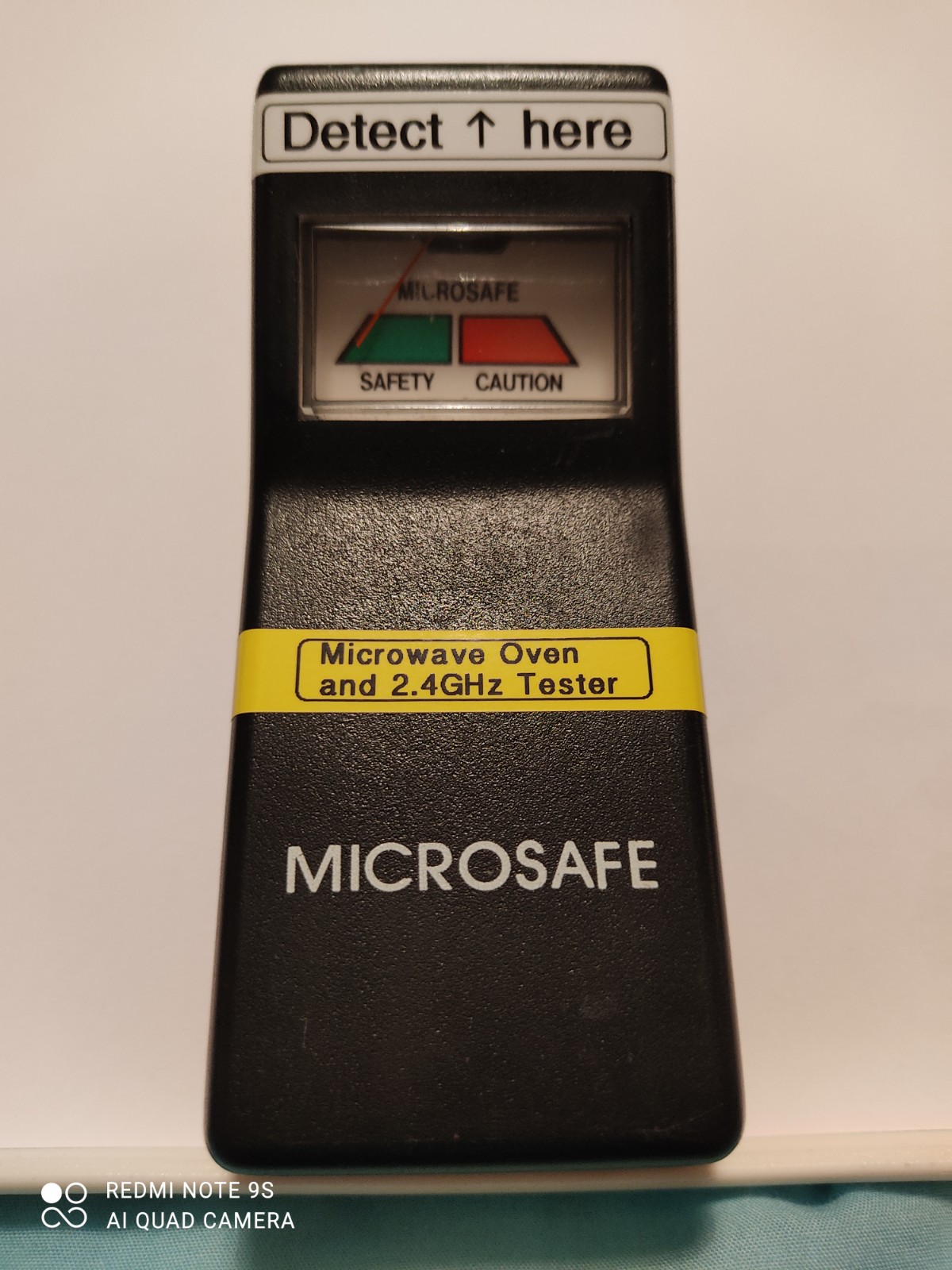

I don't know if this will be of any use to anyone, but may just give an indication of whether or not your 2.4GHz transmitter is radiating at all.
I've had for some time a "Microsafe" device which allegedly can check to see if your microwave oven is "leaking" radiation.
I recently read somewhere that this kind of device can also be used with our 2.4GHz R/C transmitters. When I hold my Futaba T6EX transmitter near to it, the meter on this device does deflect.
Being inquisitive, I opened up the device, to discover only two components - a meter and a diode.
If you're a DIY electronics type of person, the following may be of interest.
The meter is an SD-306, 250microAmp, 650ohm, -20~, +3dB, and the diode, which is unidentified, is soldered directly across the meter terminals (the diode leads are not cut short - maybe they serve as an antenna ?). I guess the diode needs to be a high frequency type, but beyond that I don't have the knowledge to say.

I wonder why the big box ?
Posts: 1238
Re: 2.4 RF meters
It makes it look more expensive 😄
Re: 2.4 RF meters
RON wrote: 07 Jan 2021, 08:15 I wonder why the big box ?
Probably promoted as a safety feature to keep you as far as possible from "them thar killer rays" :ugeek:
Mind you, none of us has ever peered into the mickywave to make our dinner cook quicker, have we, hmmm?? No sir, never sir.... :lol:
Dave

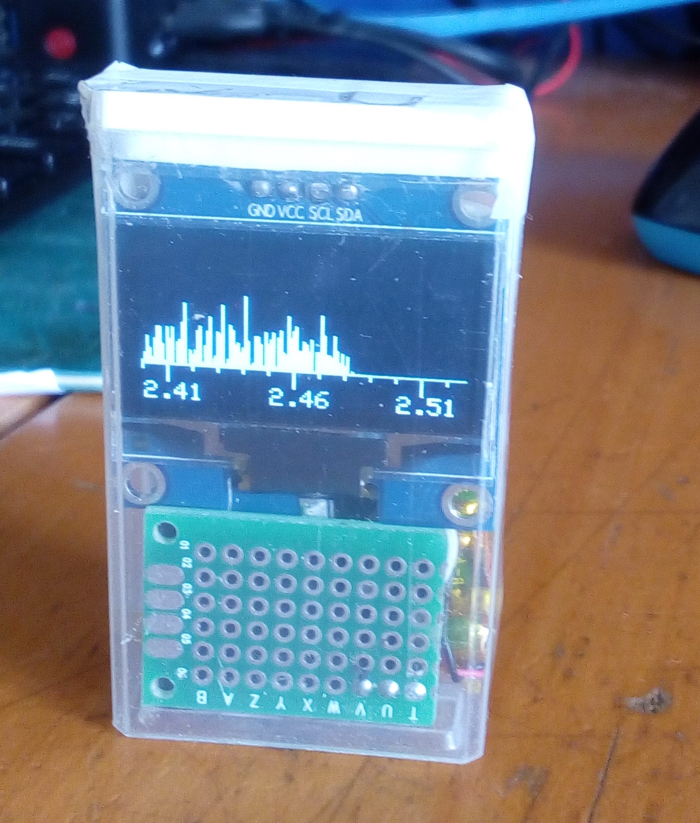

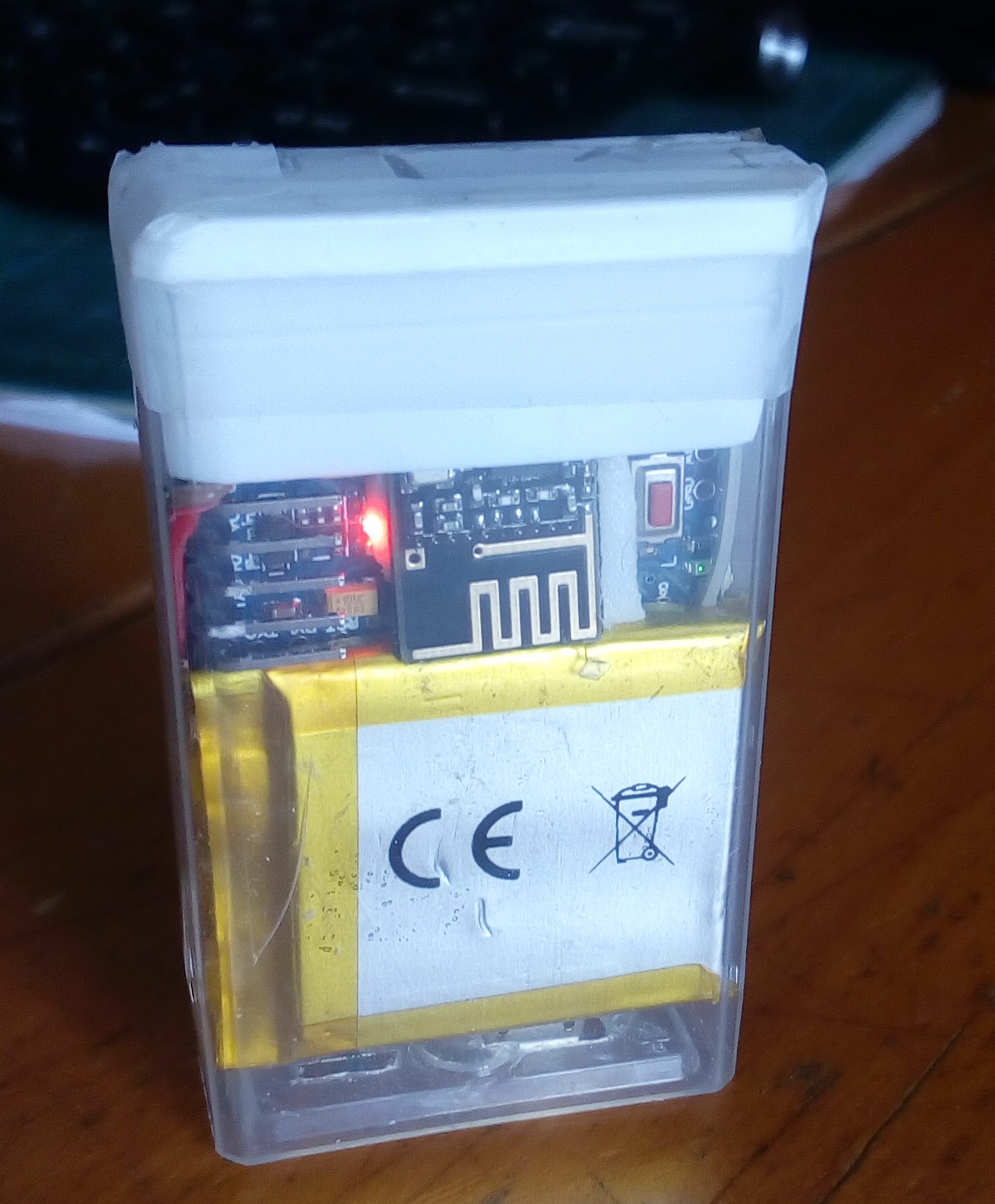

Is there a particular reason for wanting a diode/milliamp meter type of detector? There are quite a few iterations of a 2.4GHz band scanner originally designed by Martin on here that will show you not only the 'pseudo' strength of your signal but on which frequenc(ies) it is on. I say pseudo because it is not actually a signal strength meter but does give quite a good indication of signal strength. Here is my attempt at fitting one in a tic-tac box, I notice Martin also did one in a tic-tac box but I managed to squeeze a lipo in mine too :)
Currently showing the output from a FlySky AFHDS radio.
Lots of info on viewtopic.php?f=42&t=1008
