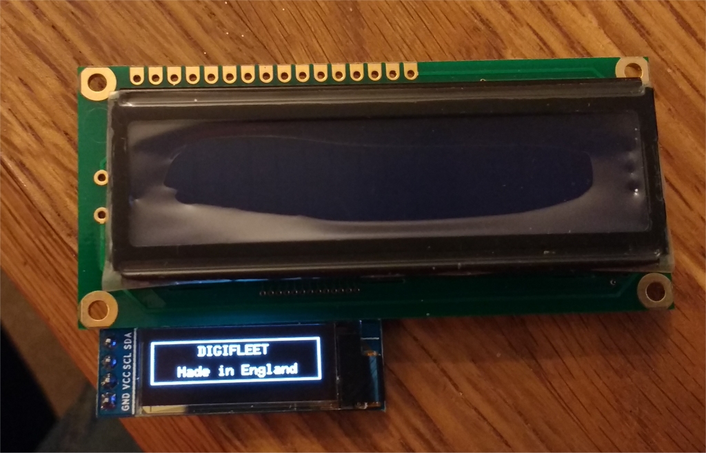

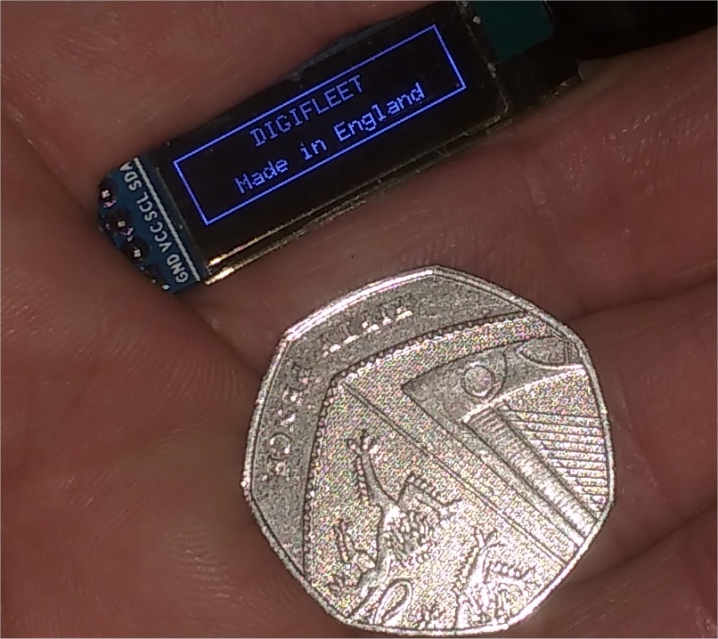

There are two popular sizes, in 1.3" and even smaller 0.96" formats. They're also available in half-height which is 128 pixels wide by 32 high. Heres one alongside a standard 16x2 LCD:

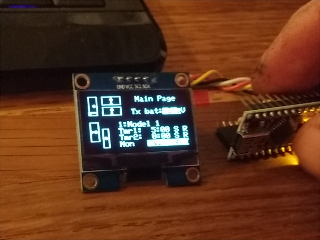

Here are a few graphics created specifically for these displays, with the code that drives them:

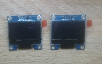

Something to watch out for - spot the difference!

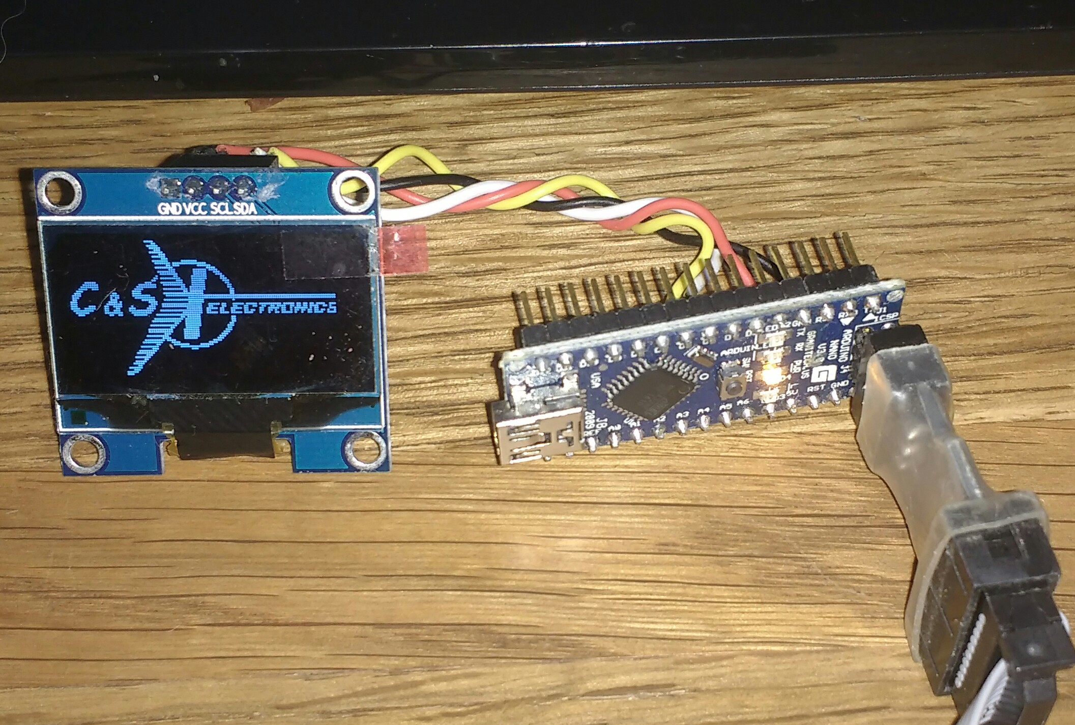

The graphic is created using your fave graphics program, I use Paint Shop Pro. Its sized to suit the display, ie 128 pixels by 64, or 128 by 32 for the half-sized displays. It has to be just two colours, black & white, and saved as .png format (Portable Network Graphic).
Because of the very low resolution (128x64) its essential to 'zoom-in' to pixel level and manually tidy up the graphic within Paint Shop Pro or whatever. If you reduce a photo to two colour levels then scale it down to 128x64 it will hardly be recognisable!
Heres a typical 'manually reworked' 128x64 picture:

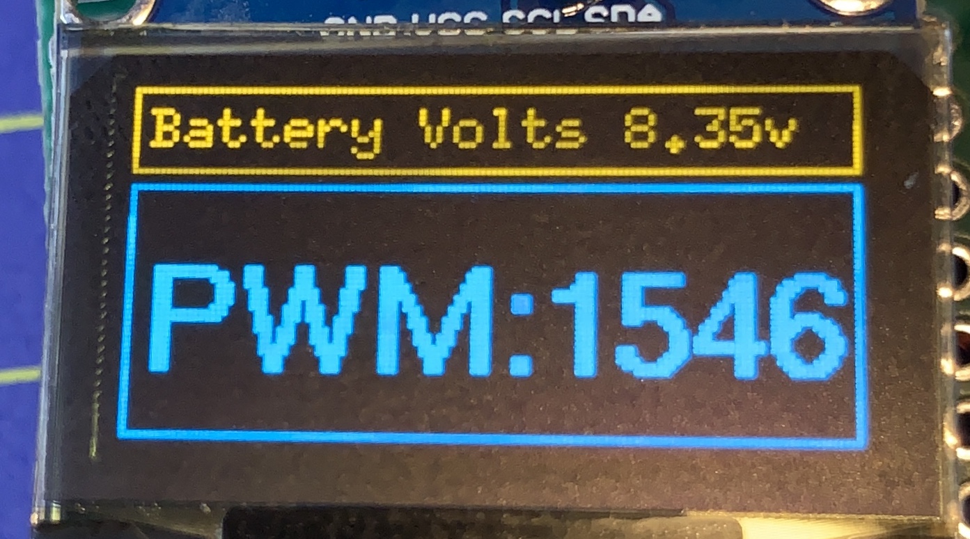

Here’s an addition to the 0.96 oled.
It’s a split screen blue/yellow version, quite common on eBay and only a few quid. This is what they look like.
