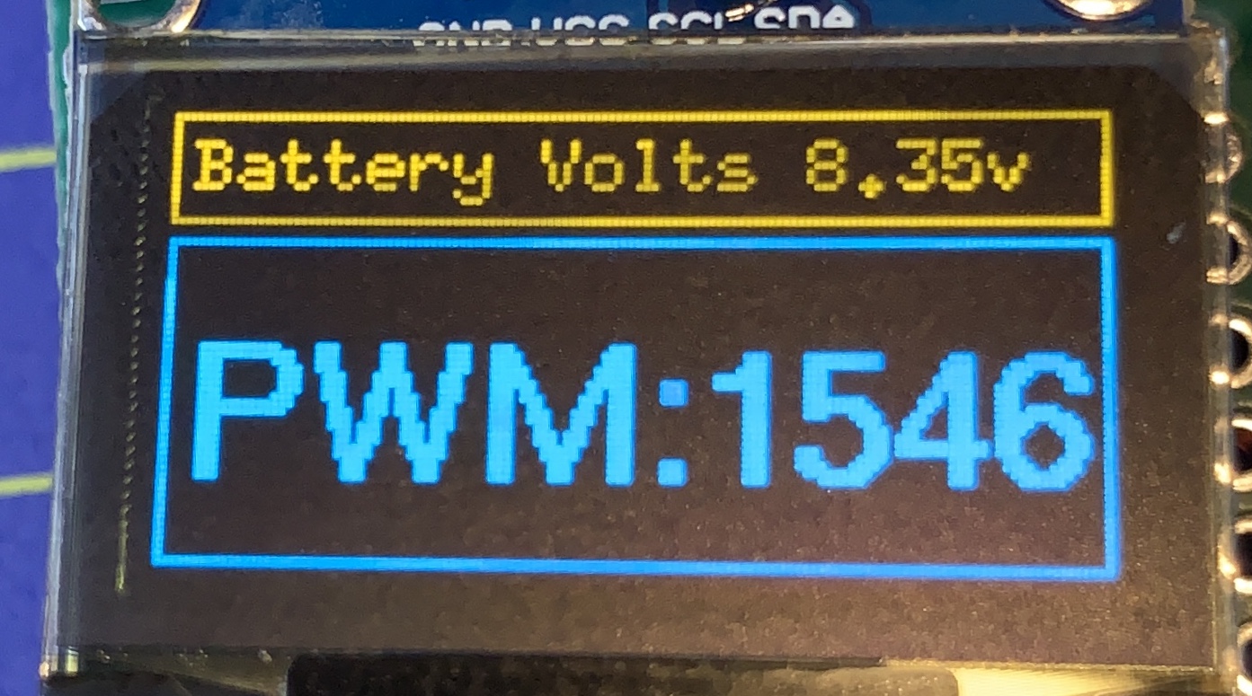

The 128 x 64 will replace the 128 x 32 but it won't fill all the screen, like this...
Thats what I used when I first made Phil's mini tester. I did alter the code slightly so that it all fit in and even added a battery monitor, a bit like this...

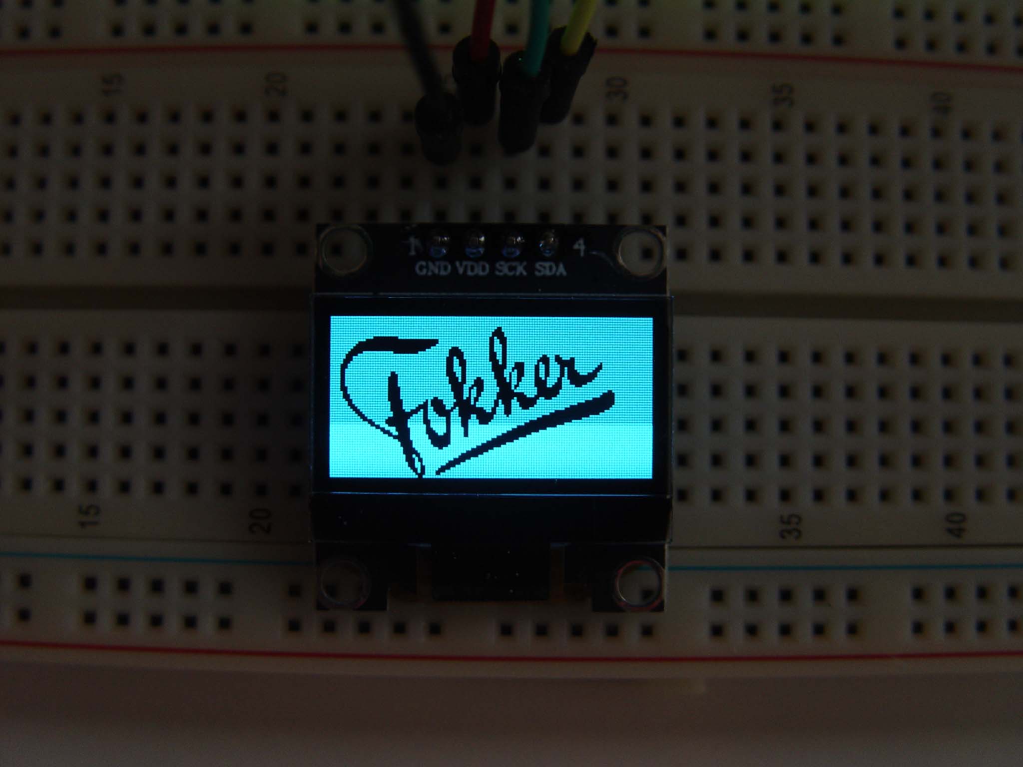

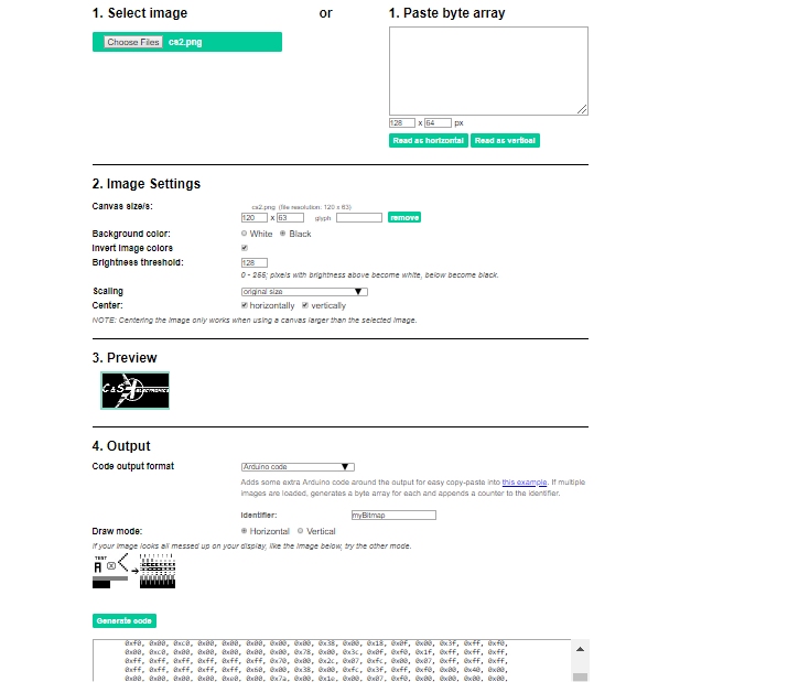

Btw, you included the "Graphene" program in another thread, to create images on the Oled. Unfortunately it is Windows-only software, which my Mac will not swallow. In the search for an alternative I found this http://javl.github.io/image2cpp/. It can be saved as a web archive for offline use, and it should work on both platforms. It will even scale the imported picture to the required size. I have not tried it in a sketch to see how it looks on screen (because I still have to set it up :roll: ), but I thought I'd share it here.
Here is an example of the classic Fokker logo, which took only a minute to create from a much larger size picture:

It worked for me, but only after I discovered that all the commas at the end of each line were missing :o :)
Max.

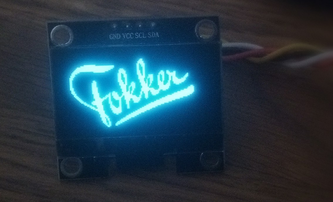

And I found out why, I forgot to pick one of the Arduino formats of the output. I am using U8glib.
MaxZ
Posts: 336
Joined: 31 Jan 2019, 11:48
Re: Learning to use OLED displays
Post by MaxZ »
:D
This is the code I have used, mostly grabbed from Phil's fuse resetter. I only replaced the bitmap info with the one that was generated by this resource.

U8GLIB_SSD1306_128X64 u8g(U8G_I2C_OPT_NONE | U8G_I2C_OPT_DEV_0);
void setup() {
  // Display something to prove that the OLED is working
  u8g.firstPage();
  do {
  u8g.setColorIndex(1);
  u8g.drawBitmap( 0, 0, logo_width, logo_height, Fokker_logo);
  } while ( u8g.nextPage() );

Thing were getting messed up when I copied the whole arduino code as generated, including
Code: Select all
const unsigned char Fokker_logo [] PROGMEM = {
This is a great tool, since its bi-directional you can also use it to inverse any existing graphics:
Also since all of the code is scripted within the html page, you can 'save' the page as a local app.
This is the best find for a good while Max!
I tried your method with one of my graphics and its perfect Max.
These were my settings:
