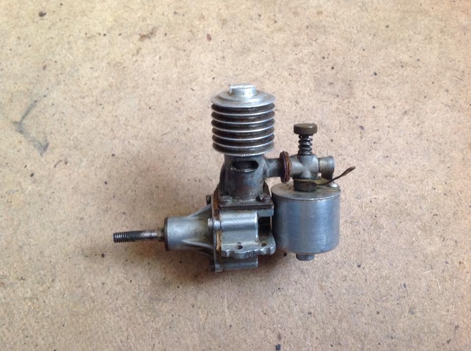

I recently acquired an ED Comp Special as shown in the photo. From the outside it looks in a reasonable mechanical condition apart from the missing fuel tank. I'm yet to strip it down for cleaning as it is still gummed up and unable to turn. The shut off valve is working fine.
Is there anyone on this forum who could tell me how the aluminum head is removed. I'm assuming it would screw off but there are no flats on the head for a spanner.
Also if anyone has a similar engine, I'm looking for the outside diameter of the tank. My intention is to machine up a tank from aluminum bar stock and I would like to make it as close to the original as possible. A photo of the tank would be a bonus.

The head does screw off, there is a good cutaway drawing here......
http://www.controlline.org.uk/phpBB2/vi ... rel=-10000

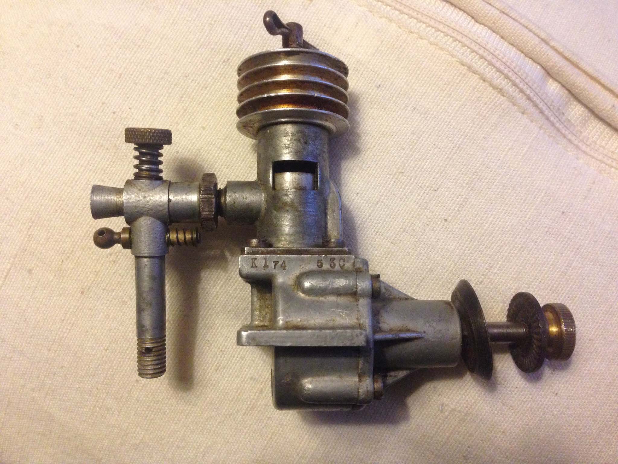

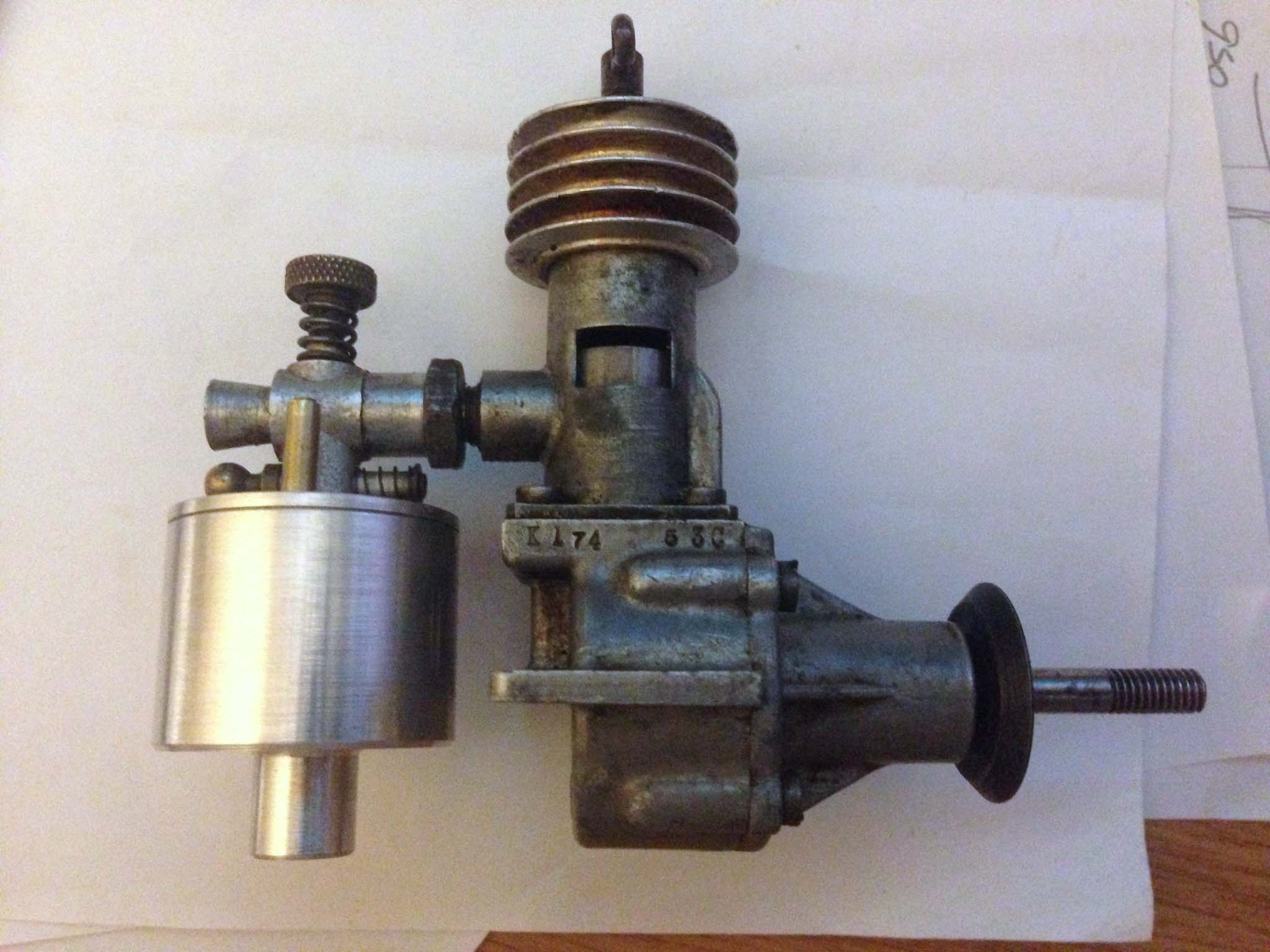

My Comp Special has a plastic repro tank but I have a "Penny Slot" which has an ali tank which I think is the same and the OD is 28.5mm..... or more likely 1 1/8" !
If you need any more pictures or dimensions, pm me.

Head is screwed on liner. It is not exposed to combustion - there is a contra-piston in the top of the liner, it's a diesel. To remove: place engine in plastic bag and put in freezer overnight. Remove from freezer and bag and just heat head with small gas torch or hot air gun(this gives maximum differential expansion between aluminium head and steel liner with the heat from the head softening any old gummy oil in the threads). Wearing leather/suede gardening gloves twist head off engine.
If this fails then you need to repeat the above process but use a 'strap wrench' on the head. Cheap plastic, with rubber strap, 'strap wrenches' are available from Ebay.
You may also find the contra-piston is seized, DO NOT KNOCK OUT/REMOVE FROM LINER. To free up clean well, warm and use thin oil(3 in 1) liberally. Use suitably sized wooden dowel and knock contra-piston back up bore slightly to free.

Thanks to all who contributed to my query. Your advice has been most useful and the engine is now free to turn without the need to dismantle. Wonderful tool the heat gun. The head screwed off easily using the heat and leather glove method. I will need to remove the cylinder however to free up the contra-piston which needs some persuasion from the underside.
To Paul thanks for posting the photo of your engine and the tank diameter measurement. The link to the cutaway of the engine is useful.

I'm please to report that the engine is now complete with a new tank and is running well.
