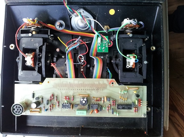

With the original 40MHz already removed:
As I couldn’t properly permanently adapt the Microprop's original board, I went on to plan B., the PhilG Arduino encoder.

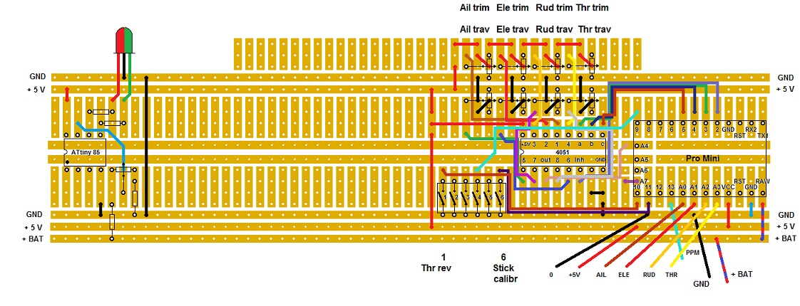

The strip board lay out:

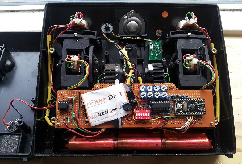

The encoder + battery meter + DHT:

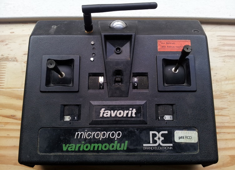

And the Microprop lived happily ever after.
