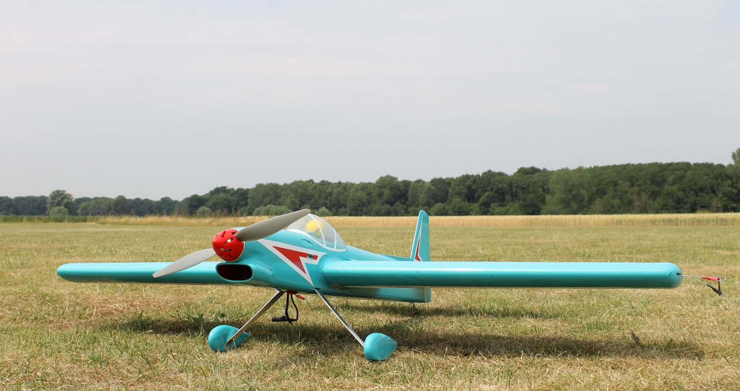

It will prove a handful if you'd be trying the current F2B schedule with the model per plan.
The stab moment arm is -regarding todays standards- very short. For todays standard, look at my avatar >
This results in a lively, rather unstable model.
Therefore, the first thing I would change is using a 4" bellcrank instead of a 3".
This makes the model's behavior a lot 'calmer'.
Use 4 1/2 - 5" handle spacing and the CG at or up to 1/2 " in front of the mainspar.
With that secured, plus the addition of adjustable lead outs and a tip weight box (indispensible trimming aids) I can see this turning into a lovely flying, vintage model.

That way, you'll be diminishing the influence of play, flex and whatever more non control inputs trying to influence your commands. Because of the larger moment arm, the differential forces required in the lines are less (remember, the maximum differential equals your line tension), yielding a more positive control through
Nowadays I'm flying with 100 mm (~ 4") between the lines at the bellcrank and a handle spacing of ~ 5 "
This is slowing down the controls as well, so giving you a much better command at subtle corrections.
My control ratio is somewhere near 1 :1 handle/elevator deflection.
When the response feels too sluggish, you can always open up your handle spacing.
I strongly recommend a tipweight trim box in the outer wing tip and adjustable lead out guides in the inner. There is a world of difference between a properly trimmed model and one that is accurate to the plan but just that...
