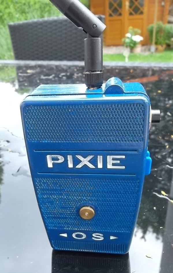

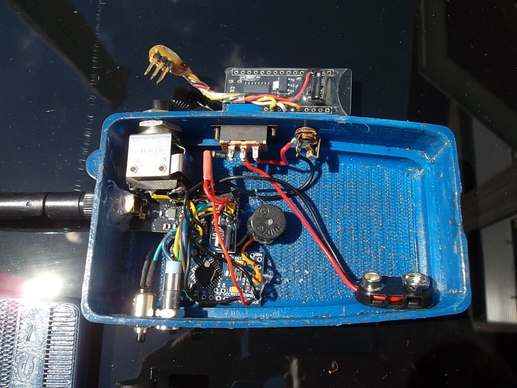

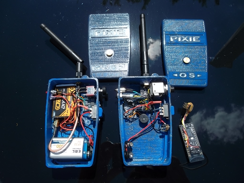

Well, my newest transmitter replica, the OS Pixie MK2, will fit in this topic and in the NRF24 topic as well.

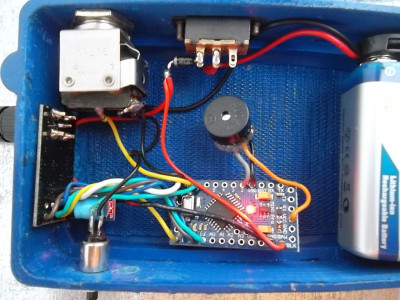

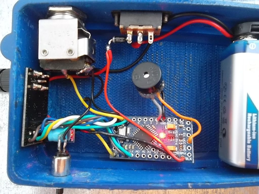

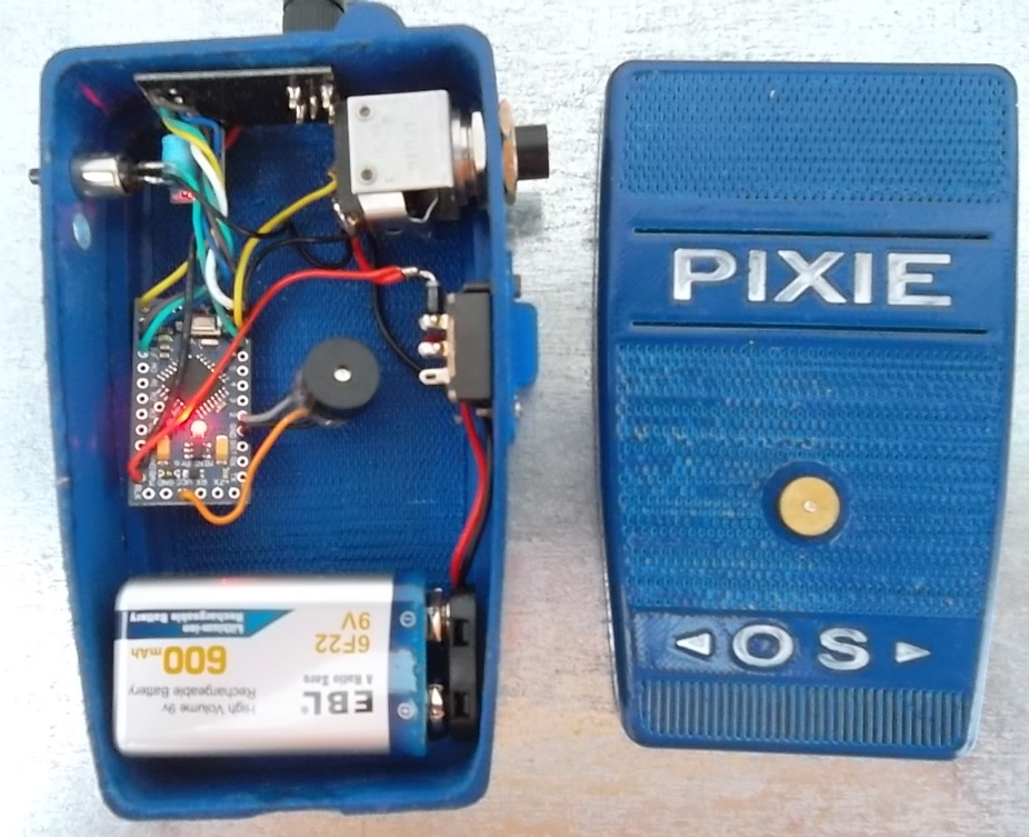

I got2 sets of Mike´s stl files printed some time ago ( thank you Mike for posting ) and decided to fit one of them with the NRF 24 outfit.
I used one of the elder high power modules (from my scrab-box) in a different layout, which fits nicely into the case with one of the tiny 3.3V modules. An arduino promini is the heart of it with a S/C program with extra throttle button.
Works great, flighttest will be next week. Cheers

Very well done there Frank as usual. You sure are the Master of Replicas!
- Posts: 769
Re: OS Pixie MK2 3D printed case
Hi Frank
It's great to see one has at last been built and as usual, it looks like you've made a lovely job of it. And with Phil's NRF24L01, it's a proper home-made transmitter.
