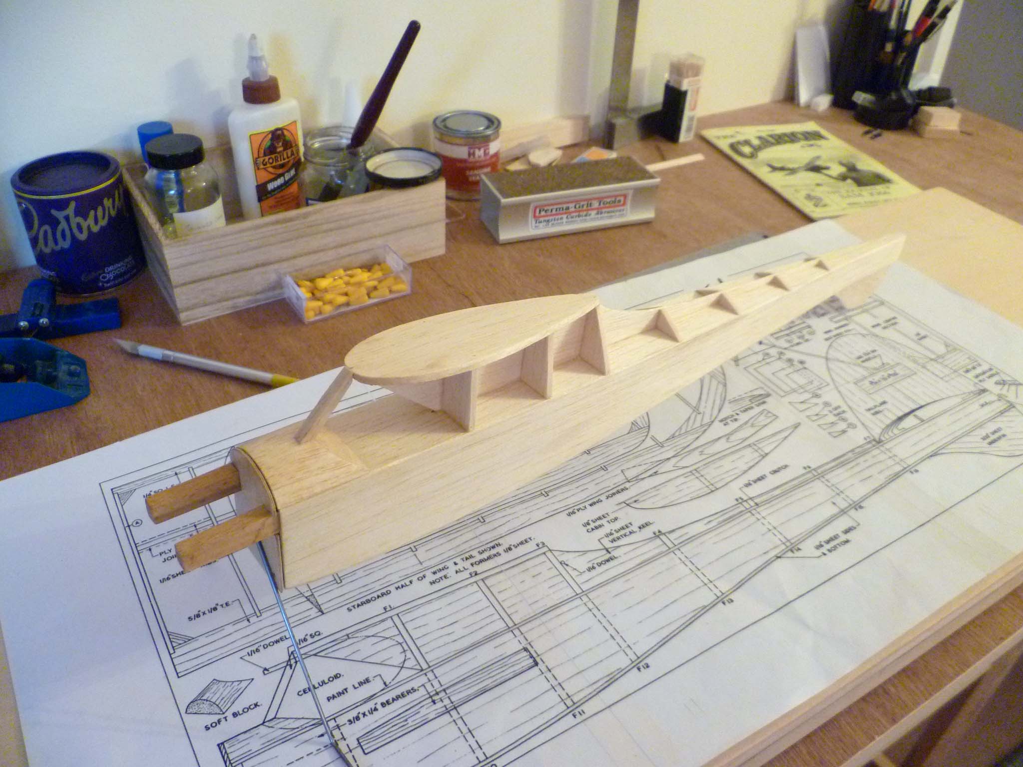

I've been doing some balsa bashing as it's an 'Eric Olthwaite' kind of day. Overcast with lots of precipitation...

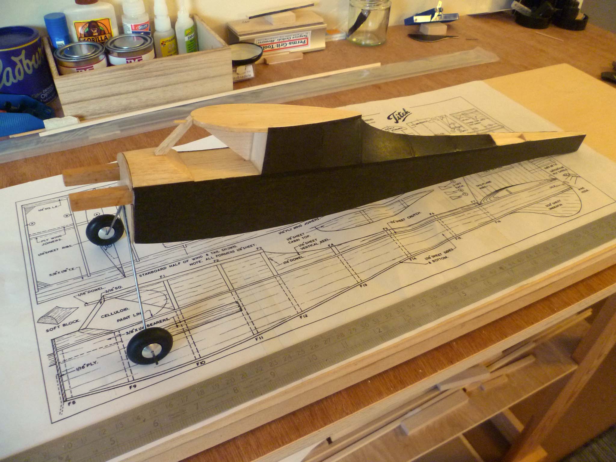

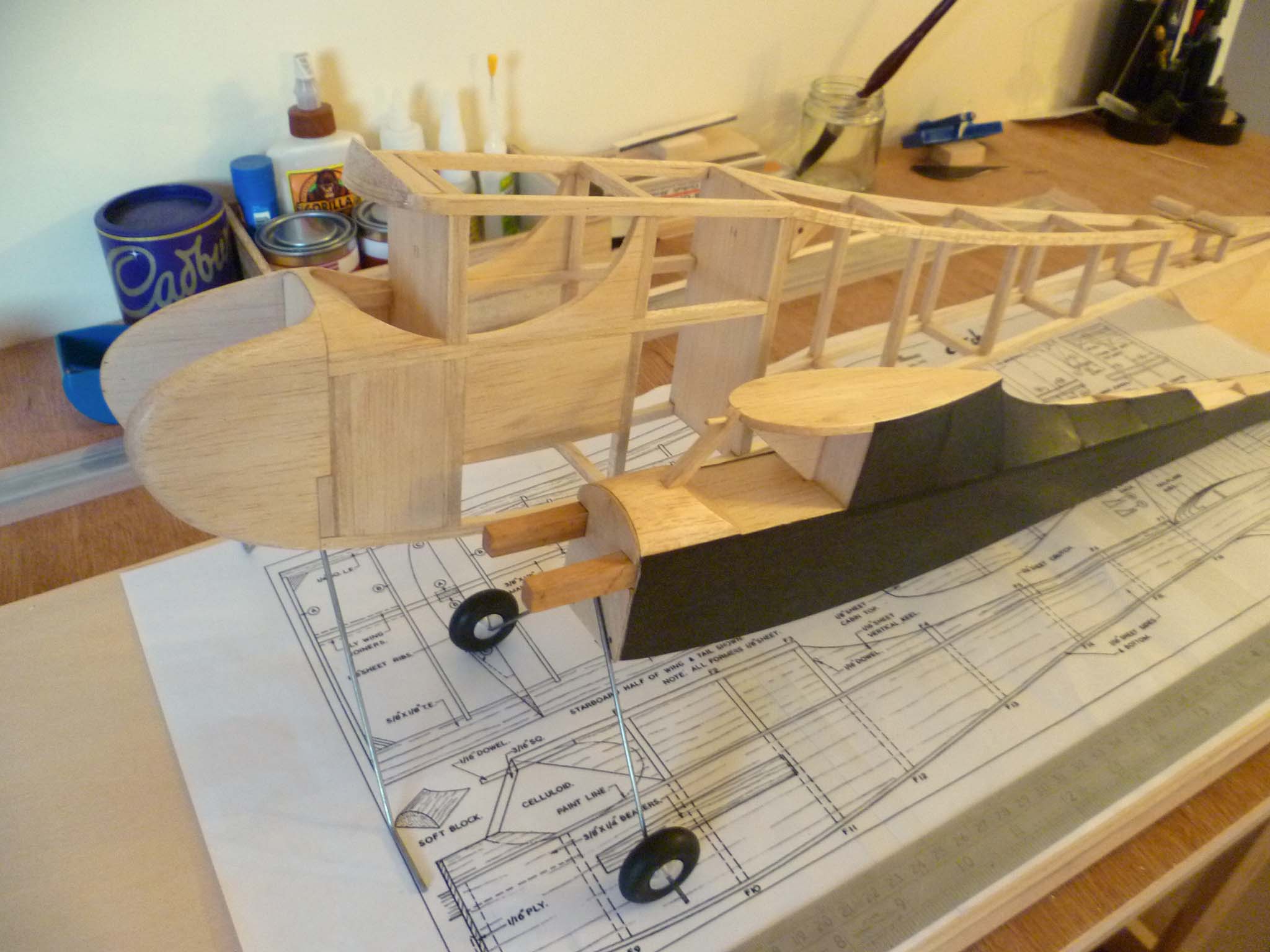

Subjects on the board have been a Ron Warring 'Titch' for sport flying, (and as a test bed for an engine I'm attempting to build) and a Vic Smeed 'Tomboy' for the worldwide postal comp. It will probably get an MP-Jet or a DC Merlin.
The Titch is a fiddly little bugger, and covering the formers behind the cockpit was an exercise in patience. It's a nice little thing though, and quite robust.
The Tomboy was straightforward, and I'll do another post about it soon. There's a couple of little things that help matters...
They're both free-flight. The Tomboy will have a clockwork DT, (that's what the bit if sheet infill is for at the side) and the Titch will have one of those little button DT's.

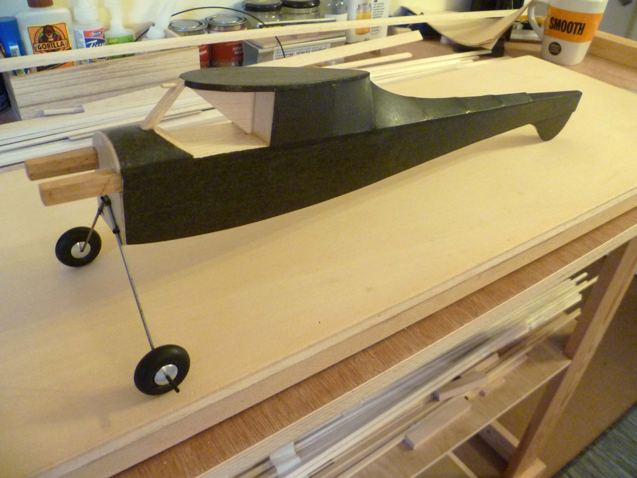

Both will be covered the way I always do it. Single layer of Esaki LiteFlite Jap tissue. Shrinking dope thinned 50/50. No mylar, I can't abide the stuff.
I tend to use black for fuselages these days as I have no imagination.
This one shows how small the Titch is. The Tomboy is standard 36" to the Aero Modeller plan.

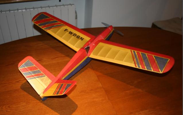

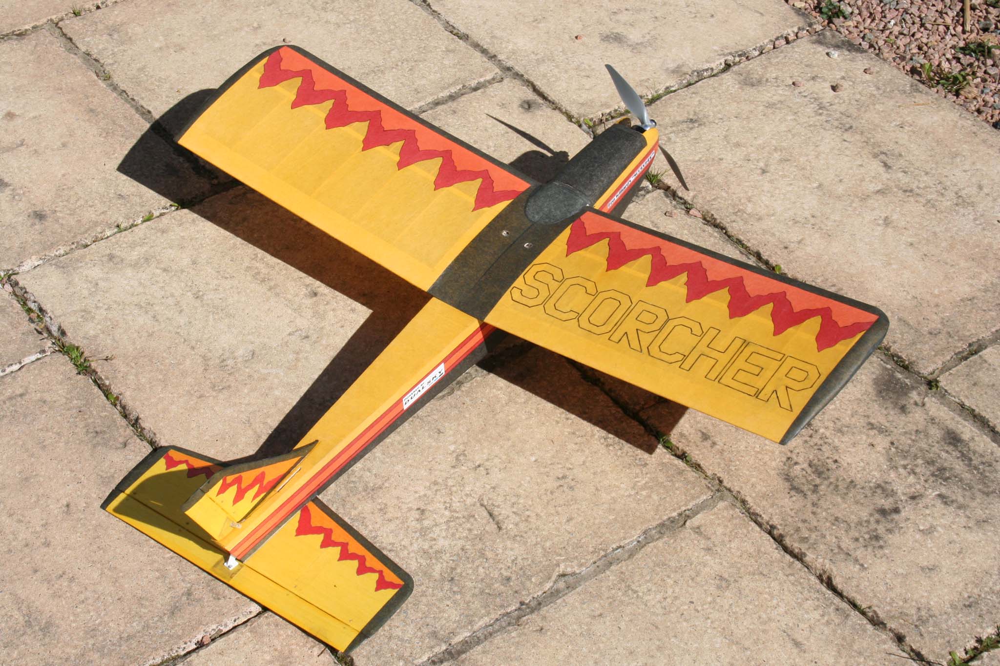

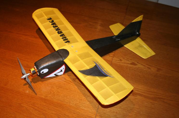

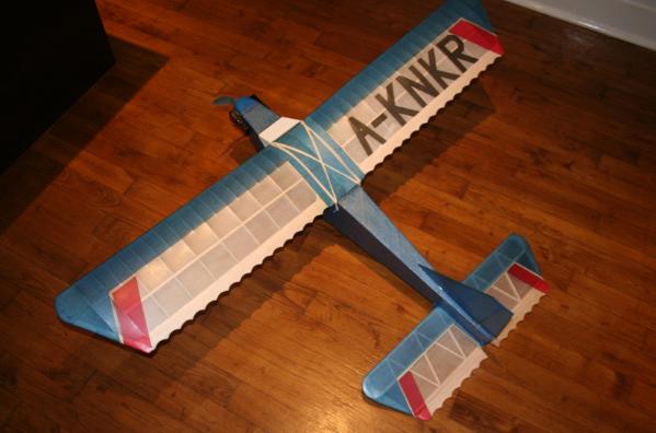

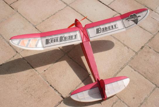

Try using 28-37 micron document laminating film under Esaki or Modelspan tissue instead of mylar Stew. A hundred times easier to handle than mylar, has it's own very tenacious adhesive, shrinks beautifully and very little weight penalty, I use it on anything down to 20 inches span. With Esaki Liteflite it is very puncture resistant, with lightweight Modelspan even more so, with heavy Modelspan - bullet proof! Apply wet with nitrate dope or dry with WBPU floor varnish.
These models all use doculam/various tissues, all get LOTS of flying ad don't have a single puncture between them - OK, they are radio so I (usually!!) keep them out of trees, but they have all had a fair amount of abuse.
