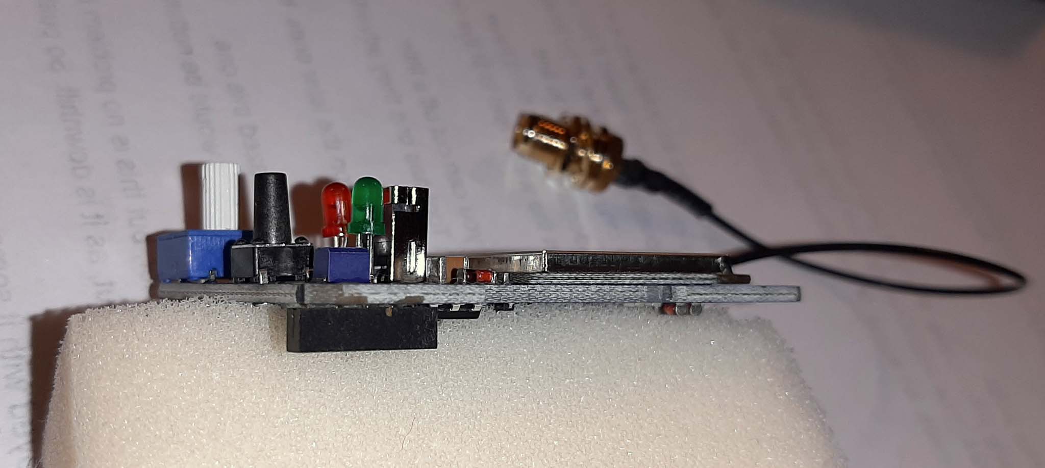

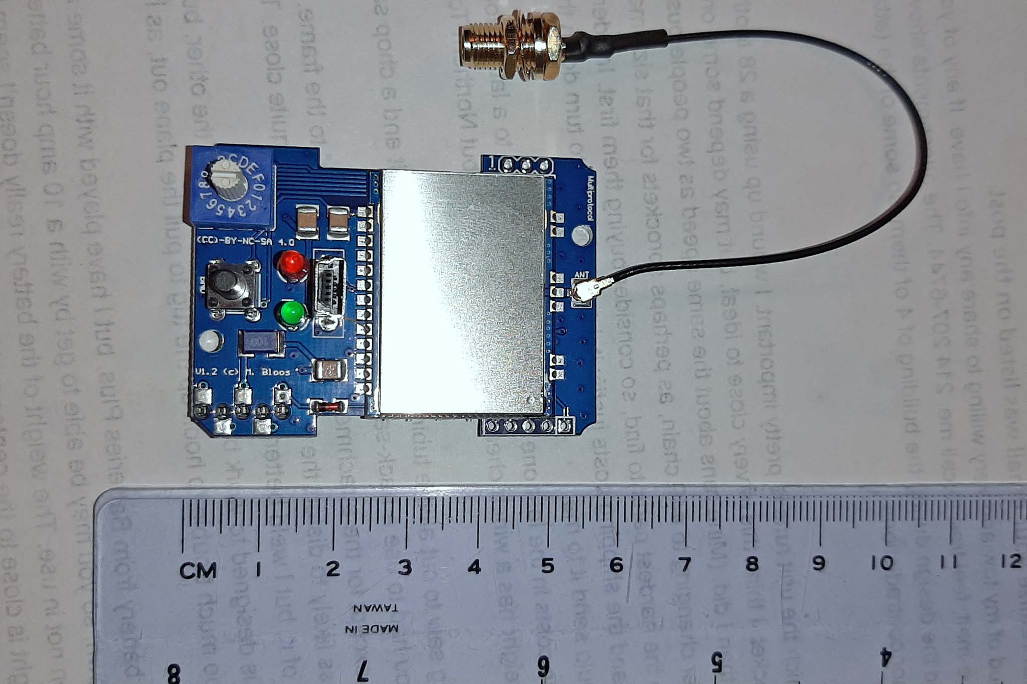

I have nothing against the Orange DIY unit, I am merely offering an alternative. My motivation is to create more of a demand for a variety of units so that competition will keep supplies up and prices down.
The JP4in1 is ok to use in the U.S. The firmware is up gradable as it is open architecture available through Github https://github.com/pascallanger/DIY-Mul ... mitters.md.
It supports PPM pos or neg. Serial, and Telemetry in both PPM or Serial modes.
The case fits FrSky / JR and other similar receptacles, and out of the case it will fit any transmitter. As noted in the photos, the antenna lead is the same as the DHT or Orange internal units. If the unit is to be mounted far from the antenna, a longer lead is easily plugged into the board. When mounted to the transmitter case by double sided tape on the heat sink, only a few holes need to be drilled to accommodate the bind button, LED's, USB connector and protocol selector. I mounted mine with those controls facing the inside of the case, as once it is set up one does not need to refer to those controls on a regular basis.

Just spotted this John, its important to note that Frsky and Orange are not the same antenna lead.
Frsky is RP-SMA and Orange is SMA. A Frsky aerial will appear to fit an Orange module just fine, but there is no electrical connection as neither has a pin, both the aerial and the module are female.
