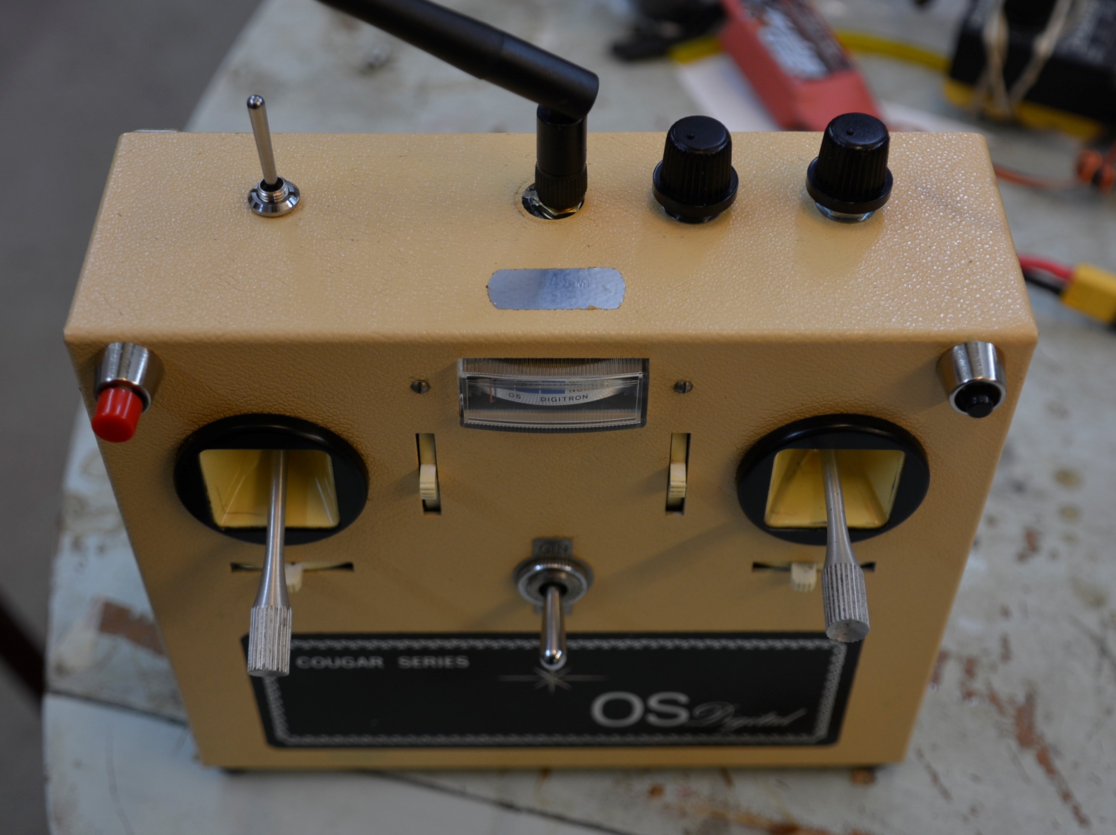

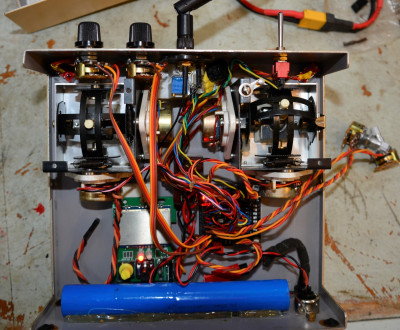

OS Cougar 1 now gigafied
Posts: 596

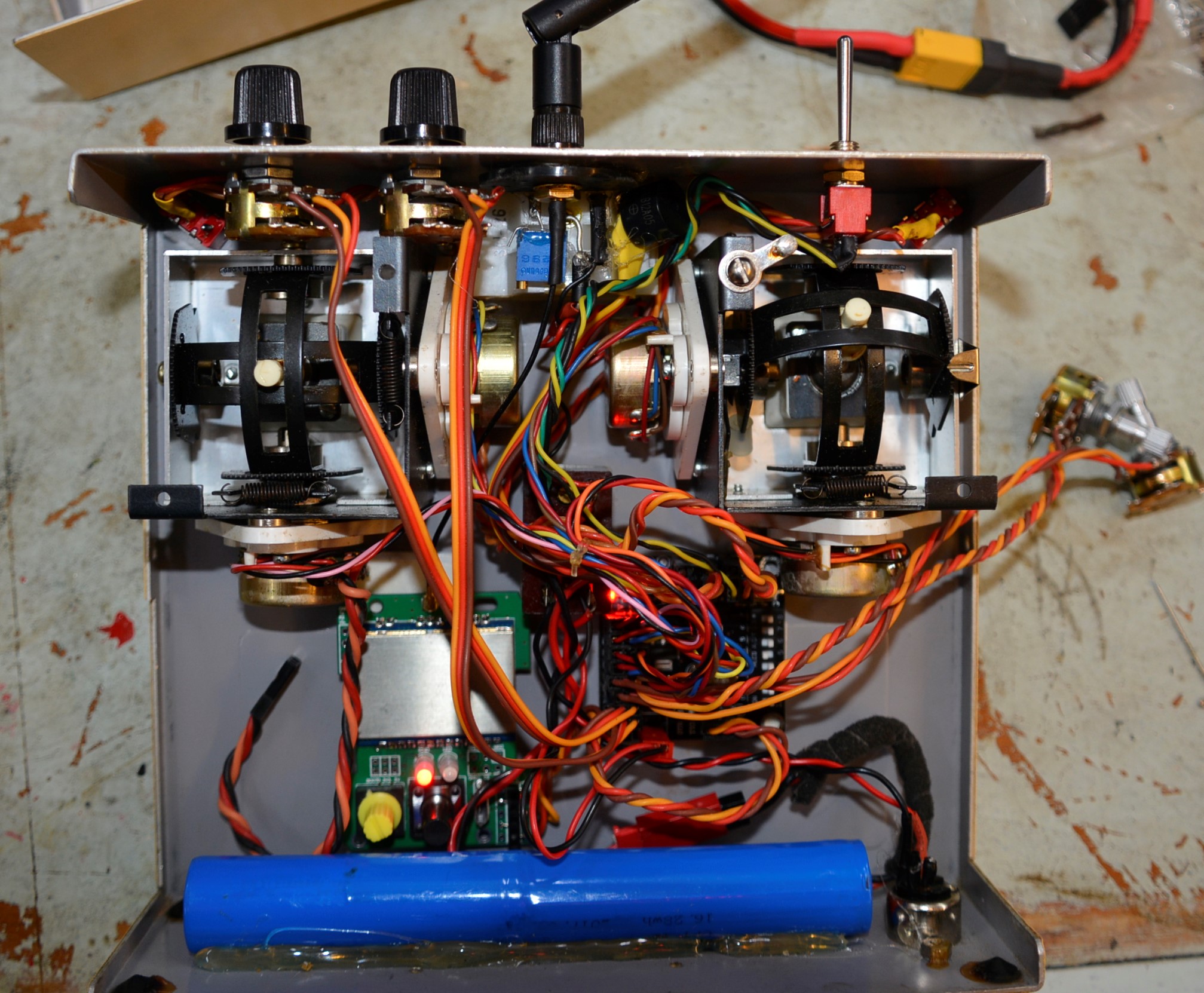

Used Phil's encoder and Banggood 4 in 1 multi protocol RF Module. 2 cell 18650 for power
Still need to tidy up channels 5&6
Posts: 596
Re: OS Cougar 1 now gigafied

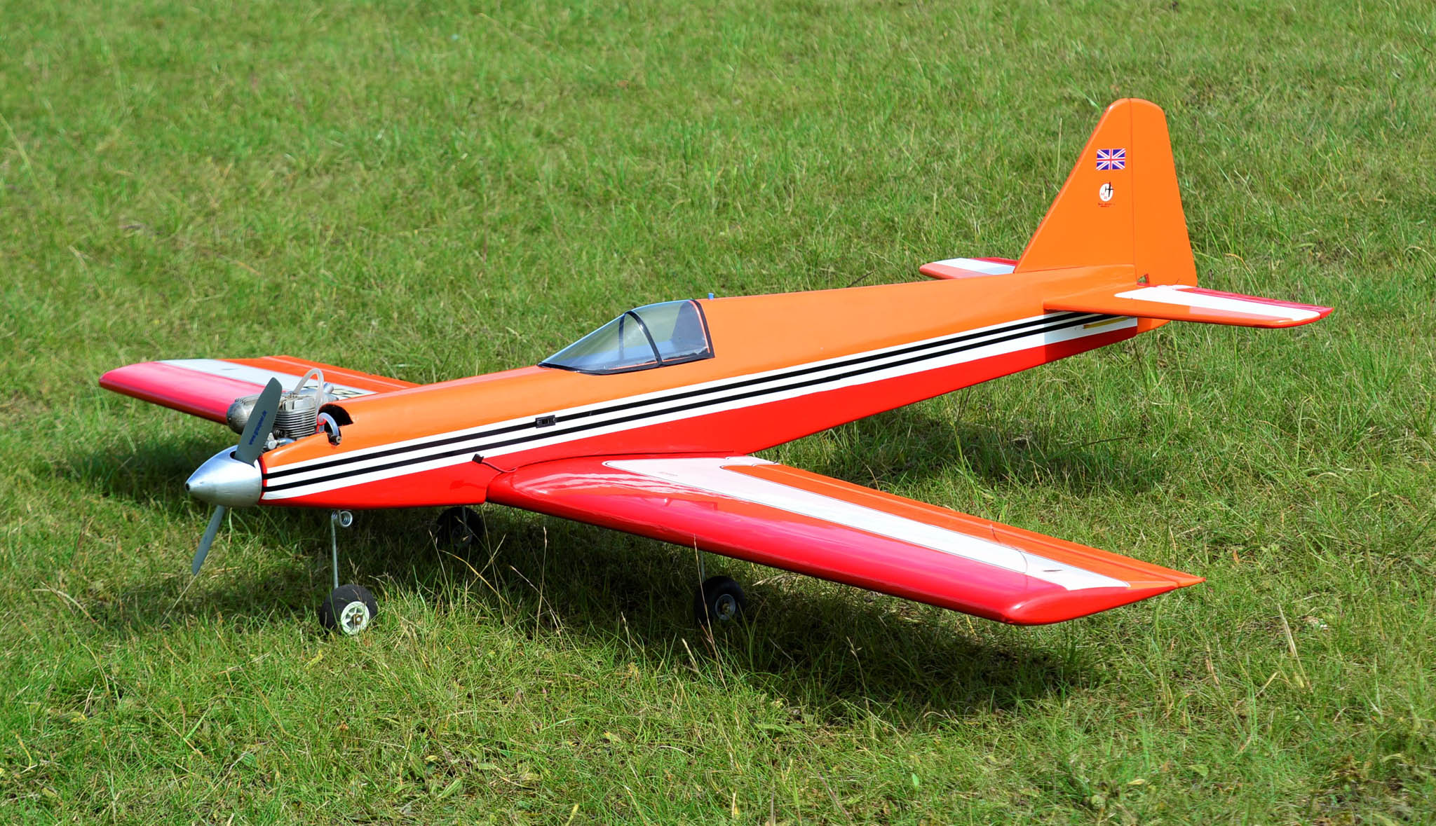

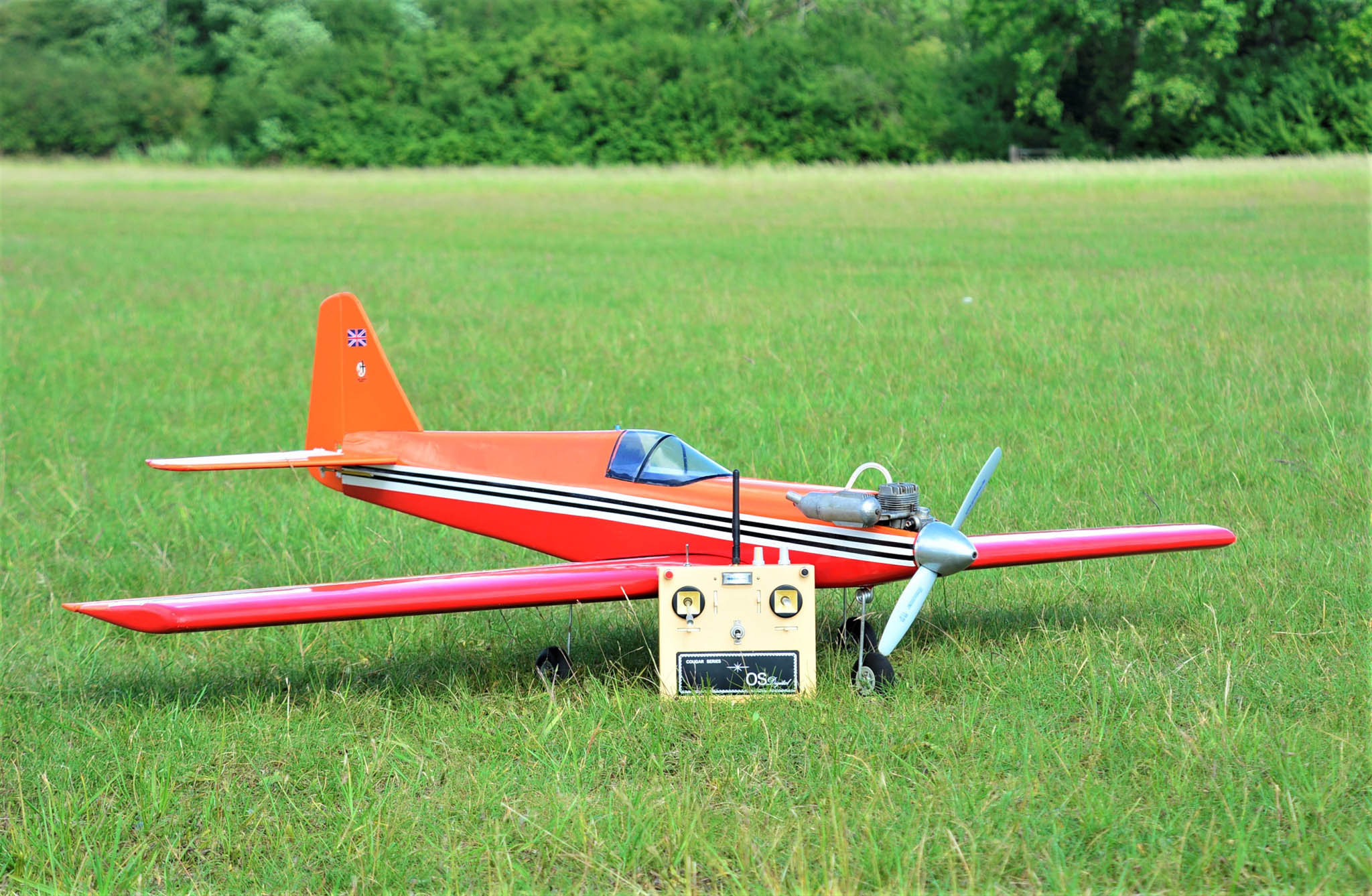

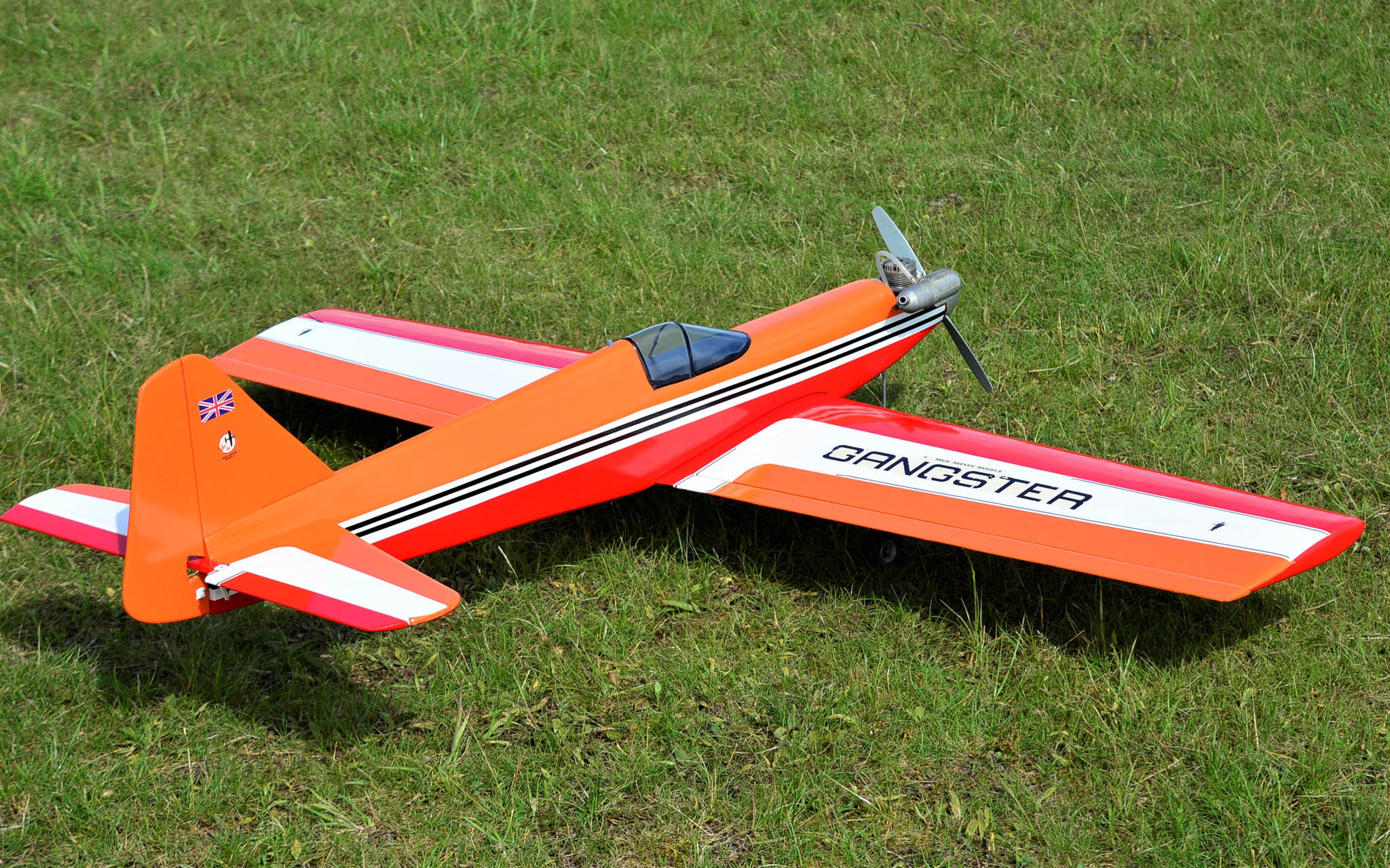

And now flown in a period Mick Reeves Gangster 63 with the Banggood module set to DSM2 and spektrum AR7100 Rx and satellite used.
Great range and solid control feel.... well chuffed :D :D :D :D
