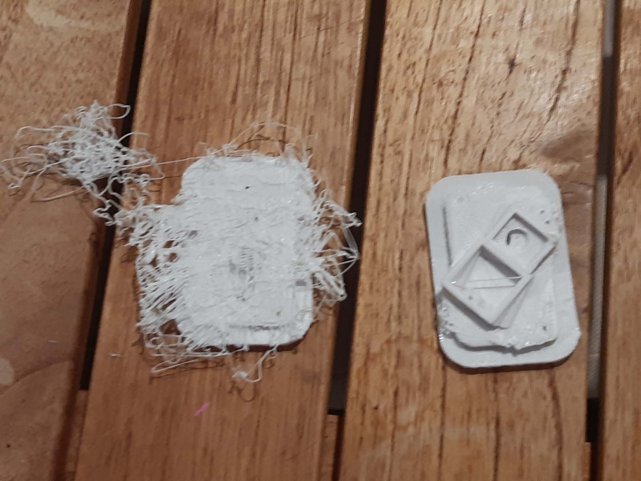

Thanks all for the helpful replies, I am on a learning curve with abs, so I tried PETG, which was a bit more forgiving, not perfect, but better than the abs failures!
Thanks for the new STL. files Tobe, I will spend the next few days trying all the permutations.
I will let you know how I get on.
George
George

I'm so glad to hear that I'm not the only one having trouble with ABS !!!
